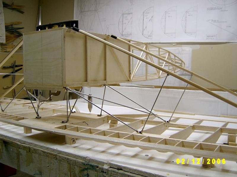

OK. I've built a bunch of kits & I decided it was time to try a "scratch build" It's about what I expected. Ya gotta do a lot of thinking & fitting,etc. Everything has been going pretty good. Oh, yea, it is a Mid West "60 size" Super Hots w/ Super Tiger 75. I have all 'wood work done". I'm now setting the horizontal stab & can't seem to get the incidence correct. Didn't really have to do it with the kits. I checked with Tower & the Robart's incidence meter is 20 bucks. Now I'm not a tight wad but there has to be an easy way without buying the stupid meter. Or am I stupid for not wanting to buy it ?

If you have a flat building board you can jig up the model so the horizontal reference line is parallel to your board and then just measure to the leading and trailing edges. If you also shim the board so it is level, you can use a carpenter's level to set your surfaces. Here is my Morane A1 set up with the level and a plumb bob if you look closely. the blocks under the wing spars set the wing incidence. The top longeron, which is on the bottom in the photo, is level with the bench top. Eventually the stab will go on level with the bench top.
