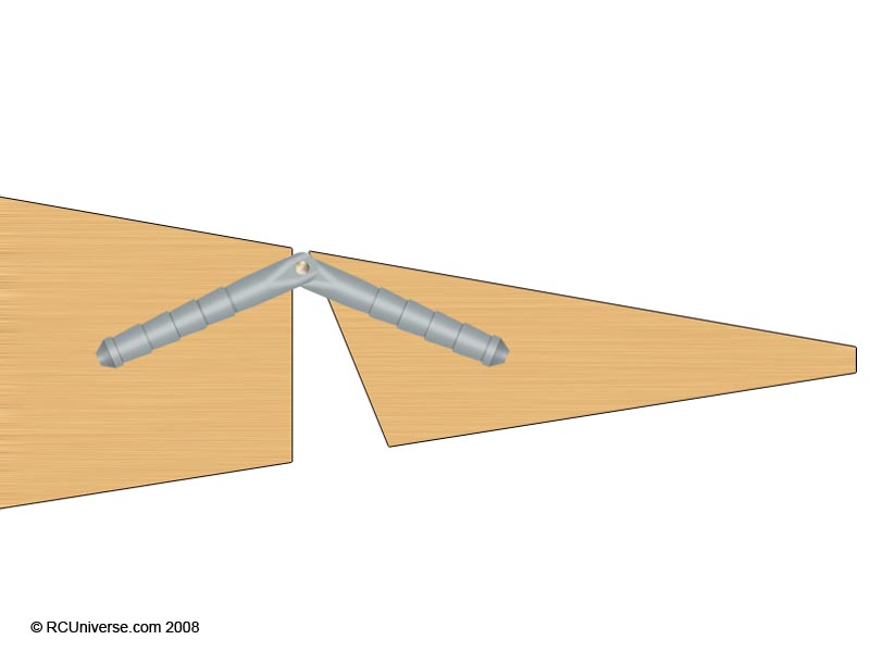

First of all, the "Fat" area doesn't really need to be seated tightly - or even glued for that matter. It's the ribbed section that the glue really grip onto.
As for setting the hinges near the top of a hinge line, angle then downward like this:

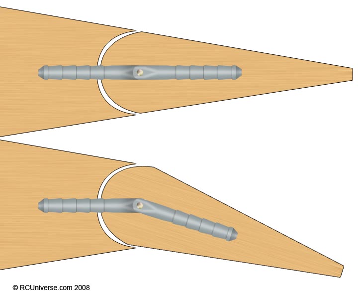

The nice thing about robart hinge points is you can build with scale hinging, just round the leading edge, recess the pin section in the center of the radius, notch top and bottom for throw deflection and set it up to be almost 0 gap between trailing edge. The surface will piviot around the pins centerline, if you've done you homework well, it will move like magic and provide a smooth flying surface for airflow over it.You could even add sheeting lips to the top and bottom of the trailing edge and smooth out the airflow even more.

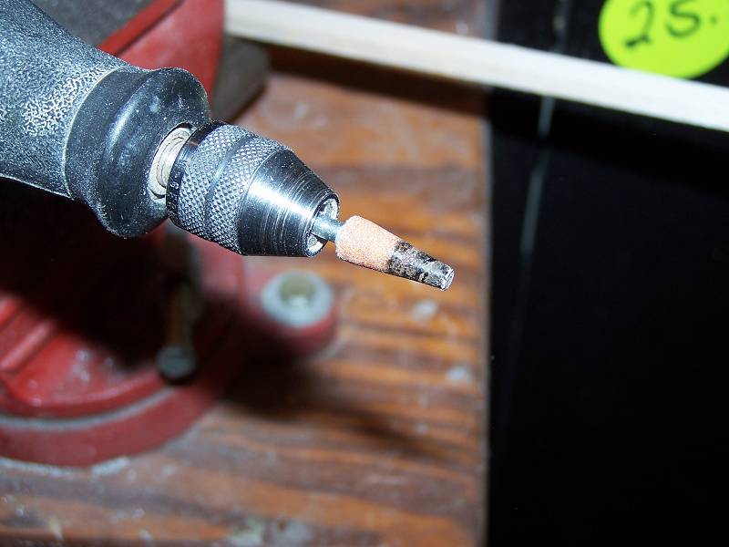

On flat trailing edges I use this tapered stone from Dremel. The taper of the stone matches the taper of the hinge point perfectly. I can seat the hinge fully without an excess of wood removed from the trailing edge. Makes for a snug fit. For the flaps on my JetMach, I made a crude (but works well) jig to drill the 1/8" holes in the trailing edge of the wing and the leading edge of the flap. Puts the hole right where you want it at a consistant angle throughout.
Dan

ORIGINAL: Campgems
2. Set the hinge point into the control surface, not the TE of the wing, or either of the stabs.
Don, what Planebuilder was talking about was IF you wanted to do round LEs on the control surface similar to this illustration. This can be pretty tough to get the geometry right.

I've used bolth applications, the one you talked about and the one I talked about on 1 plane, my topflite P-47, the flaps I used a jig to align the hinge points for the fowler style flaps(even though it's not true scale hinging), and on all the other surfaces, they were rounded and installed like your picture you drew. that bird is rock solid throughout the entine flight envelope, when I drop the flaps to 30 degrees and setup for final, it can actually land within 50 -70 feet it's going so slow, but I have total control, due to almost no gap and havong a lot of throw on tap if needed.
