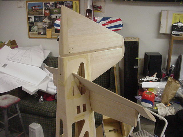

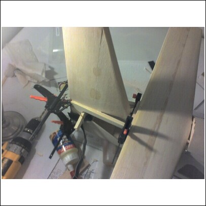

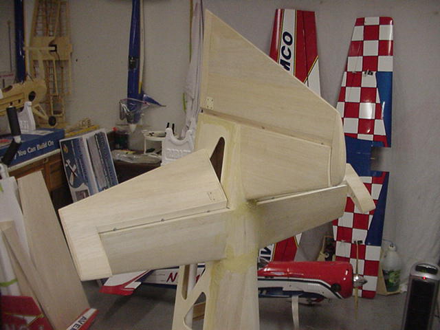

not yet but soon. i am not going to use any wood at the top of the fuse there to help with weight. what i was think of is useing a dowel to come back out of the stab into the rudder there is like a 1/2 gap between to two so i would make a block that the dowel runs though to hold everything down. did you think this will be strong ?? also thinking i just may use that crapy abs cover in the back it wont look as nice but it should be lighter then wood

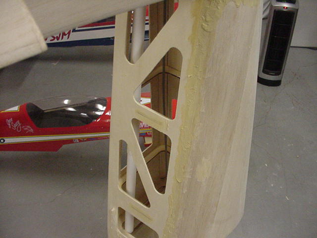

That should be plenty strong enough. Although the weigth your saving by not making a fillet block is minimal, to me it was worth the extra couple grams to look alot better, really its just bit more work!

yeah your right can you take a good pic up close that. becuse am thinking about in my head is a soild block of balsa shape to the air frame thats not what u r talking about right

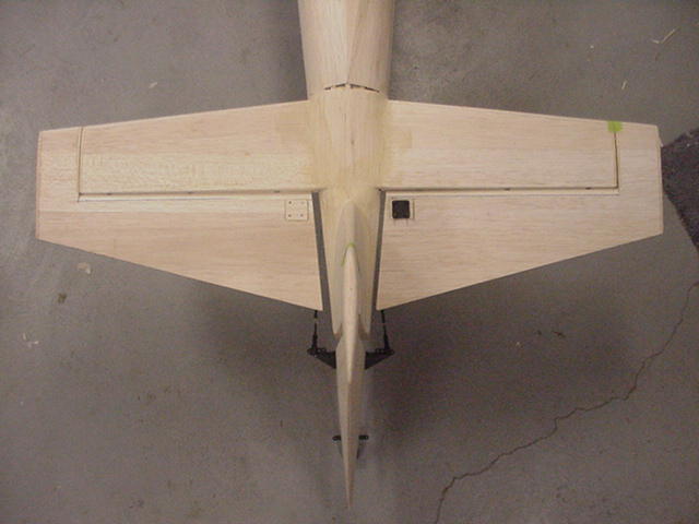

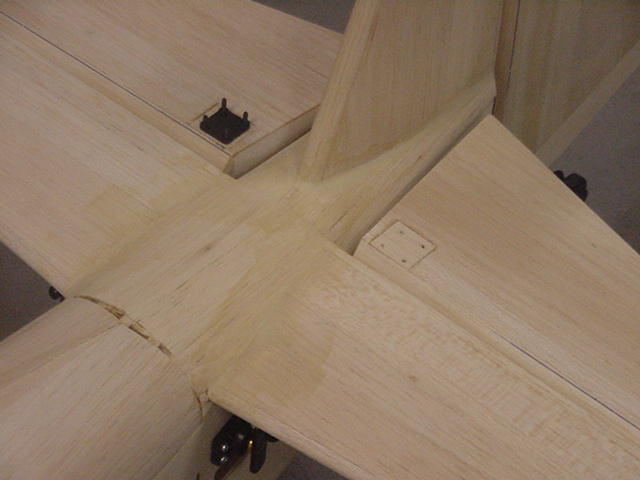

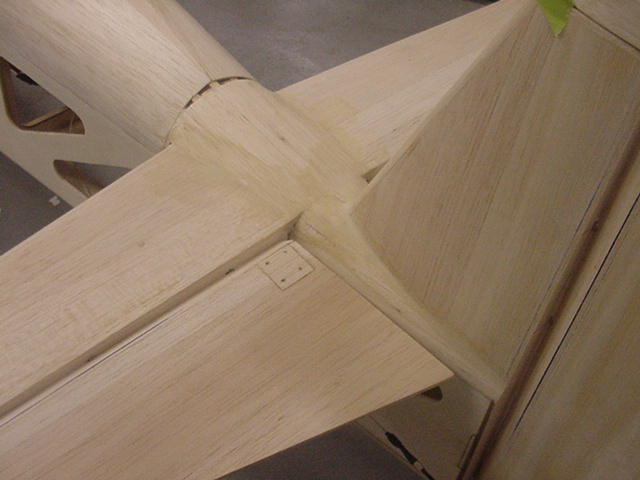

yes and no, I guled a peice of 1/4" sheet to the top of the stab with a small peice under it up front (becuase the stab is airfoiled) them a small block glued to the top of the fuse and side of the fin as a fillet, then sanded to shape. It only weighed about what a peice of 1/4" x 36" sheet balsa weighs and it looks pretty darn good if I say so myself, it just adds a bit of carving to the mixture!
I'll get some better pics and post up here tomorrow!

Default RE: Lanier 81" Cap 232 BUILD
hey guys hope ya had a good christmas!
Dragnbye, heres a couple of pics of the tail I promised ya.
and a pic of what was under the tree this year!

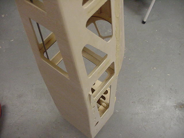

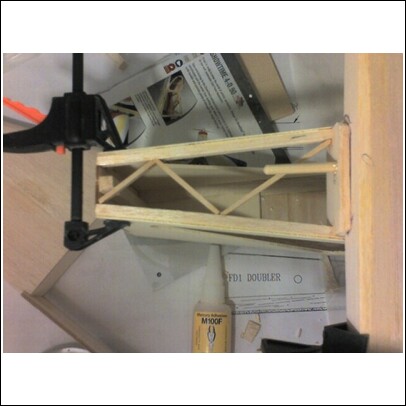

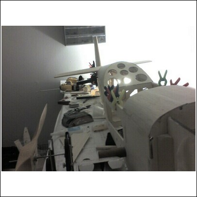

ok well i got the dowels drilled and glued and made my block. i just going over the hole thing b4 i glue it all down. i will try to get some pics up here as soon as i find my cell phone

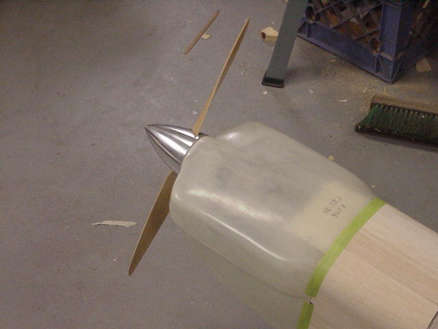

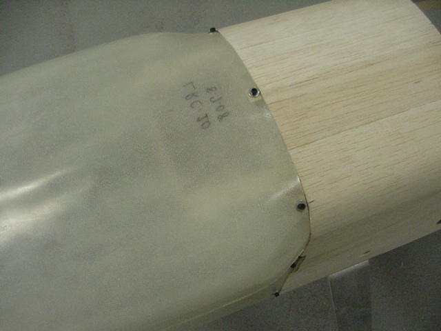

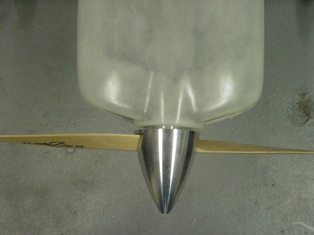

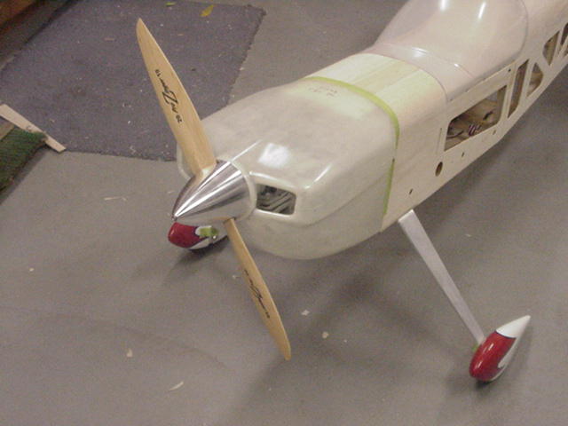

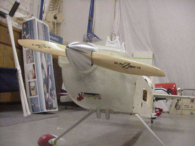

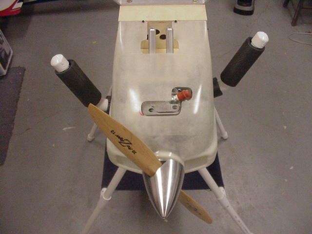

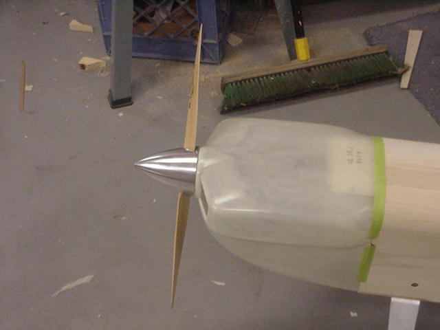

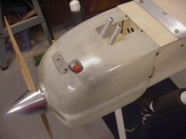

Got the Cowl on and cut and all the pushrods are made. Need to mount the tanks and finish the canopy, and Then I'll be in the strech run for cover!
Here are some pics of my cowl

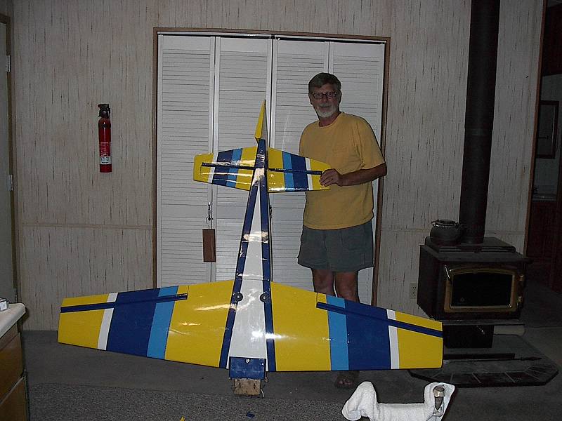

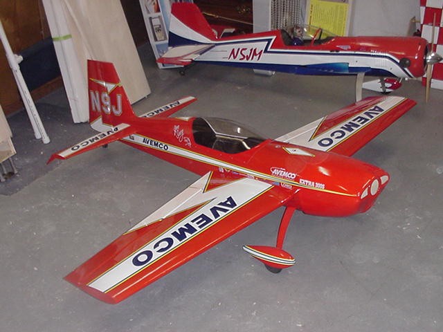

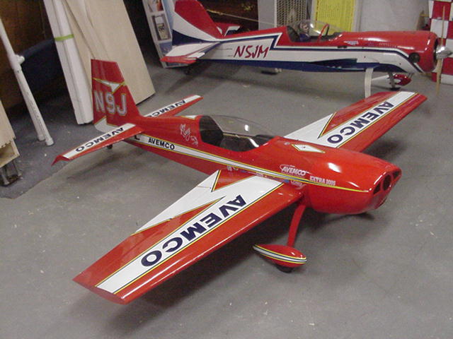

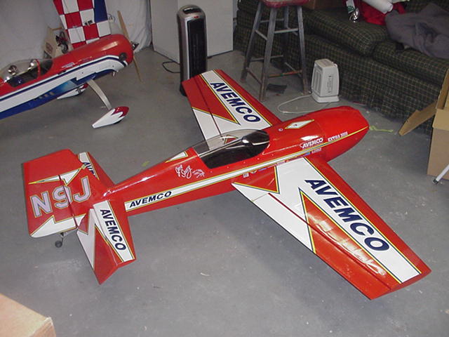

James, I still have a very old 232 kit built plane in Ca. with an 80 inch wing. The kit was made in Mexico way back when. Very old design and one of the kits that were called Snaps for one little reason. Great flying plane but I have to keep the landing speed up or it goes turttle on me in a hart beat. I will post up the photos you asked for soon as I can find them.
Old 01-23-2009 | 08:39 PM
  #42
My Feedback: (-1)
Joined: Apr 2003
Posts: 14,400
Received 9 Likes on 8 Posts
From: Hemderson, NV
Here you go James. This is one of the only shots I have of the old CAP when I was doing a recover job and some minor changes and repairs. I don't have any of the plane when finished. A friend started flying it and really hated the nasty old bubble covering. The Extra is the new one that I am just starting to fly now. It has the G-62 up front and tugs it around quite well.
Gene

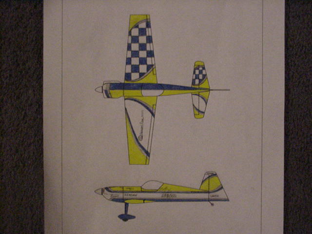

Yeah, I know alot of people don't like monokote but I seem to have pretty good luck with it. and my suk turned out pretty good so I'll stick with it!
yep, I know I bought a barf, but I wanted and extra, to get wild with, but did'nt want to build 2 planes this winter not to metion if I tear it up there aint no sentimental attachment!
here is my trim Idea.
