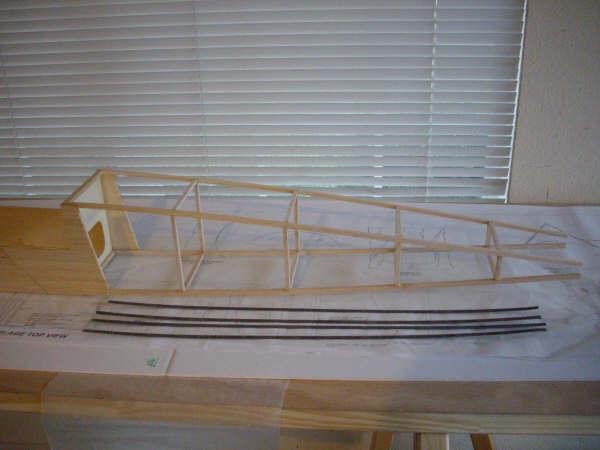

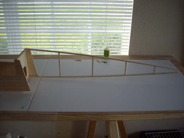

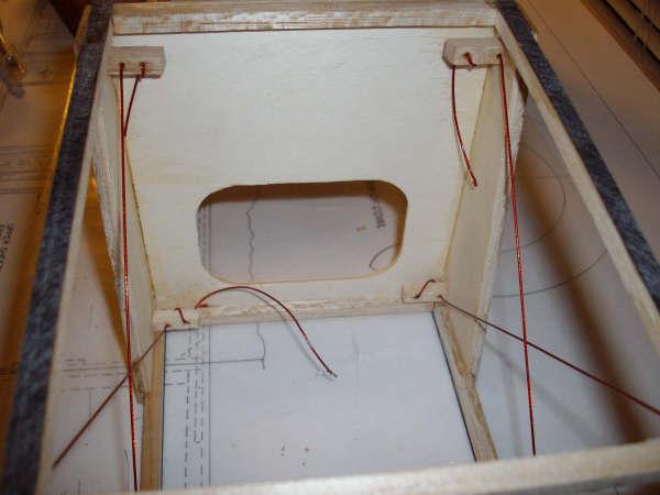

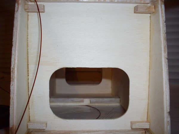

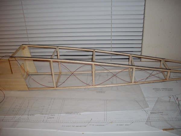

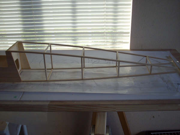

Well, I started this kit before I found this site...but first a little history. I was taking my son (who's almost two) to daycare and he spotted a yellow airplane flying pretty low. It was a crop duster and at first I thought it was real, we pulled into the parking lot of the park got out and made introductions and sure enough there were several RC planes on the deck. The group of guys for the most part are retired. My son and I hung out for about an hour before I took him to daycare, of course he wanted to get down and touch every "car car" (anything with wheels at this point is still a car to him) but I held him. Before I left the guys said if I were interested in flying they'd teach me. So on September 16, 08 I bought my first plane the Alpha 40, 3 weeks later I did my fist solo (thanks to my team of trainiers!) and shortly there after one of the guys sold me his BUSA E III kit out of his collection of kits. So with all that said I gave up saltwater tanks as a hobby after 5 years and now i'm HOOKED on this one!
I didn't find this site until after the build was started so what i'm going to do is post pics of slight changes i'm doing to the kit to make it a little more "scale". I'm also going to do the E III LF 70 scheme, just to be a little different and make the thread interesting. At this point i'm almost ready to attach the wing to the fuse. I will post pics of everything i do from this point on.
In the pics below you will see the rear fuse "framed". The instructions called for this to be covered with balsa sheets and I did infact do that, however; after reading several other threads and seeing pictures of the completed E III's in flight where changes had been made, I decided I wanted to see the structures under the fabric...to look more scale.

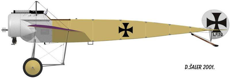

E. III LF 70
Considering using Solartex fabric in matte finish, however; the closest to purple is light blue...perhaps paint for that color?

Be aware that the yellowish/beige Solartex that most people use on EIII models comes in two version: Antique and Linen. The antique is semi-transparent so you'll see all the underlying structure which isn't so great if it's non-scale structure or wood where it's supposed to be open structure. The Linen Solartex is the same color but completely opaque.
I'd recommend that you cover the whole thing in Linen Solartex then paint the colors and markings with custom matched latex from the hardware shop. Then give that a final fuel-proof coating with Nelson's Flat Clear.

Ok, after some further research I decided to remove the diagonal braces I placed on the sides of the fuse to make it more scale. I was bestowed some 1/4"x48" carbon fiber and i'm going to epoxy it to the two bottom 1/4"x1/4"x30" balsa strips. I will cut the carbon fiber in half, thereby having a 24" strip on each side for added strength. Reason behind this is to add support because A: I feel removing the diagonal braces will reduce the strength of that part of the plane. B: I probably should have used 4 spruce strips inplace of the 1/4"x1/4"x30" balsa strips since I removed the original fuse sides and since spruce is stronger. Overall reason...I want to prevent the rear end from breaking off in the event of a hard landing. I will be adding diagonal cross braces in the top sections of the rear fuse (make sense?).

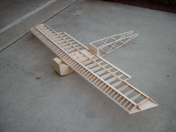

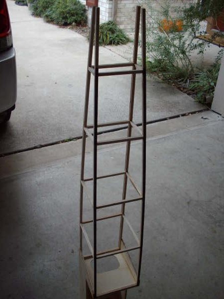

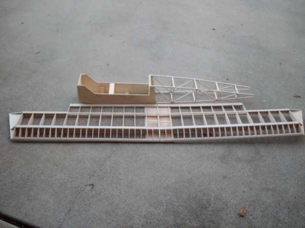

To bring my pics up to speed...here is where I am at in my build.

Looks great so far!
It'd be unwise to remove the (non-scale) balsa diagonals without replacing them with something else. It's not just a matter of "strength" but also lateral rigidity. That is, it's important that the tail can't twist. So just strengthening the longerons isn't enough.
One possibility would be to replace the single diagonals with crossed pieces of bamboo rod/skewers. Look for something about 1-2mm in diameter. Each individual piece doesn't have to be strong as it the net effect of having these cross-bracing pieces on every open frame (top, bottom, and sides). The thin bamboo will also look reasonably scale with backlite.
I've seen another builder here on RCU using kevlar threads to do the bracing and it looked very strong. I think I ended up using fine gauge music wire, which was probably not the ideal solution. But it looked good. I even wrapped bits of tape around the ends of each wire to give the effect of turnbuckles when seen in backlighting.

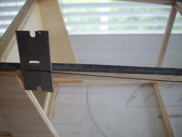

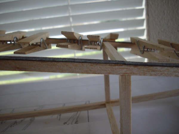

Ok I have made some changes. It's amazing the amount of information I have found from old threads on E III builds. I went ahead and removed the diagonal braces I had in place on the sides with the intention of putting up some rigging. I also added carbon fiber strips for some extra strength. In the pictures you will see the carbon fiber strips used, the placement, trimming, and completion of the carbon fiber.

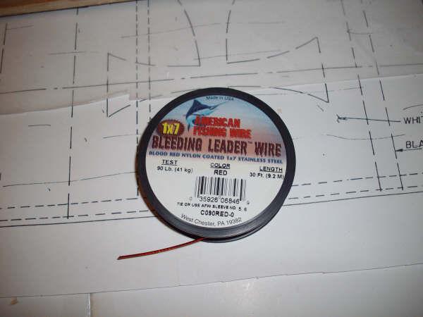

After doing the carbon fiber I tackled the rigging. I used 90# fishing leader wire for the rigging. I used a 1/16 drill bit to make holes in the top and bottom of each and every vertical balsa pieces (can't remember the technical name for them). I used my thumb and index finger as my "drill" there may have been an easier way, but I went with what I had and like the end results. Once the holes were made I then treaded the wire through the holes towards the rear of the plane and then worked my way back forward. I ran in to a problem though...how was I going to take the slack out? Necessity is the mother of invention, as they say, so I made some "anchors" out of scrap 1/4X1/4 balsa. I drilled two holes in each anchor, worked the slack back towards the anchors, and threaded the anchors allowing some tension to be held and thereby getting rid of any noticeable slack. Once again I worked the length of the wire (one length of wire for each side) from one anchor to the other, rechecking for slack and using CA at all points where the wire came to a vertical balsa strip securing the wire in place. I think it looks pretty good and will show nicely through the fabric. I'm going to add tape to simulate the turnbuckle as Abufletcher suggested. Questions? Comments?

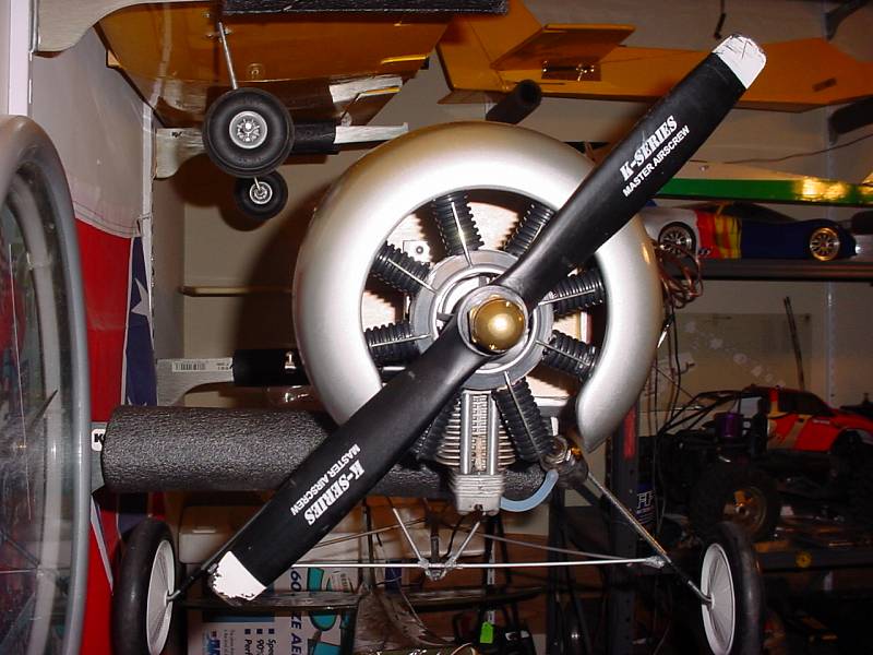

Looking good ! A flying buddy of mine just maidened his Eindecker. We plan on flying next season together at Warbird rallies. I scratchbuilt a dummy engine and so did he, however he one-upped me on his. So after I finish building my Eindecker I will probably redo my dummy engine . He also started his based on his using a 12.0z aluminum can for the center section with all the paint sanded off. Then instead of using 1/8 plywood cut out like I did , he used 1/2" dowel glued and screwed to the can to simulate the cyclinders with 1/2" spilt conduit covering the dowels. Of course he used one wire to simulate the pushod instead of the 2 I did. So the following picture is his. I'm so jealous

DeadEyes: It's pretty funny that you bring up the engines. By the way, be sure to post some video on your flight with your buddy! I was doing some searches and came across this scratch built DH-2 with a rotating engine. I thought is was photo-shopped and emailed the owner, Ian, and this is what he told me:
Hi Charles, my DH2 was scratch built by myself and Kevin Wesley, started back around 2000. It was drawn up using the Windsock Datafile. The motor is a Zenoah 62, with a 1.75 to 1 belt reduction drive and a 9.5" extension shaft to get the heavy bits infront of the CofG. It also allows it to swing a home made 30" x 14" scale propeller. The dummy motor does indeed rotate. It freewheels on a bearing off the propshaft. The dummy motor itself is made out of foam, blue foam for the crankcase and cast 2 part foam for the cylinders. The dummy motor is extremely light so doesn't load up the Zenoah much. Heres some pics
I posted the pics he sent me below. I may mold a Williams Bros. 1/6 scale engine and attempt to make a foam twin as the foam can be shaved to fit in the cowl and painted. I've also come across threads where plastic was turned to replicate the engine, however; it didn't rotate. First things first, I want to get access to several units so I can break them and try again...so that is the reason for me looking into molds. One of my side projects is to replicate something like that. I've been doing research on molds and foams, so we shall see! It just seems like it can be done.

Charles, I also thought about doing a rotating engine but decided that idea needed to wait a while. WWI era rotary engines spun at around 1,500-2,000 RPMs. In contrast, our model engines would be spinning a dummy engine at up to 10,000 RPMs. At that speed a dummy would just be spun to pieces.
So there seem to be two main solutions. One, as on Ian's stunning DH2, people use a belt reduction system allowing a larger (scale) prop and slower speeds. The other solution is to not have the dummy connected directly to the engine but instead to allow it to "pinwheel in the breeze." This would seem like the only possibility on an EIII.
Also, a note on the WB 1/6 scale Le Rhone kit. It is WAY undersized for a 1/6 scale EIII with a scale sized cowl. I'm not sure why. But the diameter is a good inch too small. Also, of course, it's a Le Rhone and not a Gnome/Oberursal engine. For my dummy I ended up heavily modifying one of the kits. I started by extending the length of each of the cylinders with styrene. Then I used the crankcase backplate for the front and then modified that to look more like the Oberursal. I also scratch-built new rocker heads and rods. I think there's a couple photos of it in the link I posted above.
