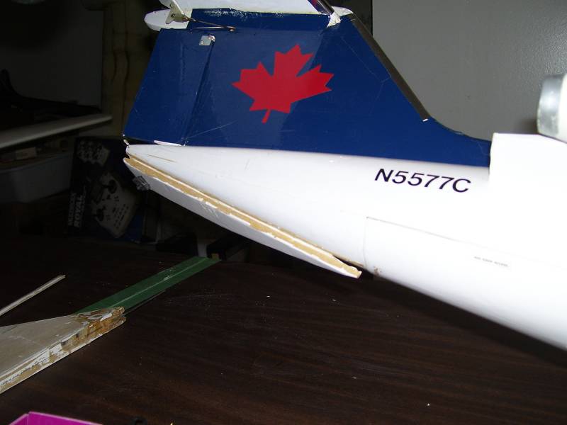

Here we go......
These are present pictures of the damaged model, few months ago i did started to rebuild it but left it with other interests and also to give myself sometime to get over this crash.
I did worked on the wing, internal structure was cracked badly, root rib/spars were also cracked so now i will make newer ribs to reinforce cracked and damaged ones and use my nib kit as template source to assist this rebuild.
Fuselage is as is, i didn't do anything to it back then, now i am going to redo it all. I think it will be good to strip off all of the old covering and re-cover it with fresh newer covering. I am also planning to extend the fuselage about 5" in front of wing, this way this model will truly replicate real Learjet 35A/Bs...

Sam, do you predict any balance issues by moving the engine out that far? Also where do you need to lengthen it to be scale, in back of the canopy, or front or both?
#235
Pat,
No not yet, i am still thinking about doing or not doing it. C of G will be at the same point, so with addition of fuselage plug more tail weight will be needed from what i can think at this time.
Extension plug could go in front of wing or right behind cockpit former. Basically that is where it needs to be extended.
It took me this long to get the damn engine out!, i have to cut one mount rail to get it out, screw heads were chewed!, then i also took 3/4 for the covering off all the way to engine pylons, well now if you see the way fuselage sits, it's write off basically!. It's swelled, twisted, mostly all formers are damaged, right fuselage side stiffener is badly damaged. really all that is left in this fuselage is rear end intact!, whole front is gone pretty much. Left side is also damaged in front of of engine pylon....
I will post these pictures before i do anything with it.

ORIGINAL: hawkpilot
It looks like you may be able to scab it back together.
tacked up at key joints where most breaks were. I am still going to make newer formers about 3 of them to reinforce damaged ones from the back.
Some of the sheeting will have to be re-done as original sheeting is pretty cracked and beaten up at some areas.
