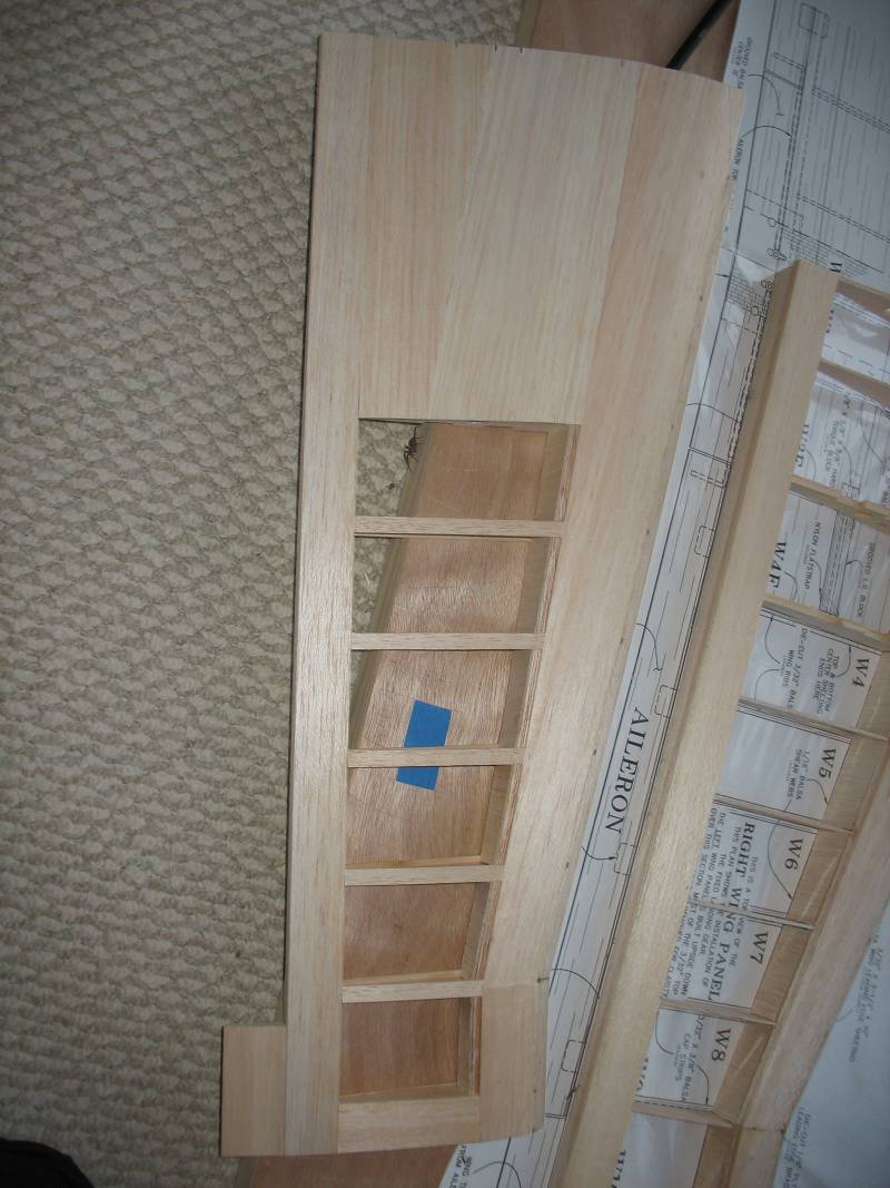

Over the last couple of days I've completed the wing LE and TE sheeting. Took a while to do. I basically glue a section, clamp it and come back a couple hours later and do another section. I dragged the process out over several days.... glue/clamp, glue/clamp, rinse and repeat etc, etc.
A while back I bought a bunch of clamps at Harbor Freight for about 2$ a piece. You cant go wrong with these since similar clamps sell for 15-20$ Just wish I had bought more.
Next step is to install the tip tank mounting structure within the last rib bay then sheet the last bay at the tip

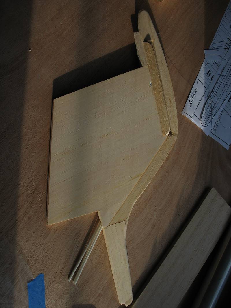

Spent the evening installing the tip tank mounts and sheeting over them. I sheeted the top then the bottom before I realized that there is also a bottom mount so I had to carefully remove the bottom tip sheeting to install it. The instructions dont say to install the bottom until 3 steps later...dummy, always read sevral steps ahead of the one you are working on. I should know better.
Also installed the main landing gear mouning blocks and reinforcement. Drilled the hole required for fixed gear legs and test fit.

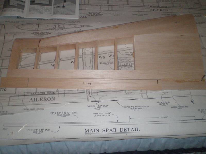

More sheeting. Sheeted the wing center sections today. Also, made and installed the wing rib cap strips.

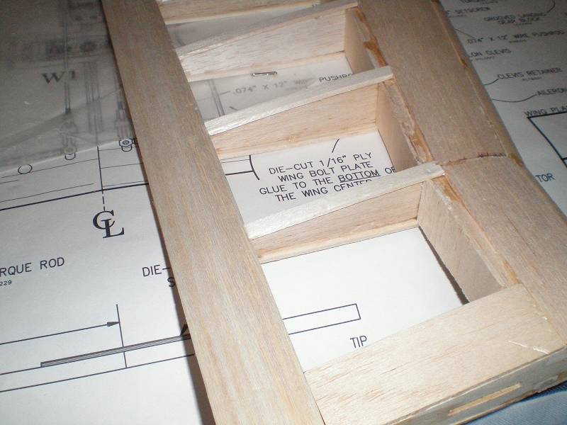

Chris, I am at about the same point you are, I noticed that the #1 wing ribs are upside down in your post above, dont know if you know this or not, just thought I would point it out. I have my fin and stab built and ready to sand, first wing section almost complete (cant sheet the bottom until the end of this month, not allowed to have my retracts intil dec 29~my b-day [sm=tongue_smile.gif] ) I have pics, but it has been years since I put pics on here so I will have to re-learn.

Good eye on the number one rib. I noticed this a day or two ago also. Not sure if its worth flipping over, would require lots of careful cutting with the exacto knife. It may be easier to modify the servo cutout. The rib is symetrical as far as I can tell so I dont think it will have any negative effects on flying if left the way it is. Once I join the wing no one would ever know but me....well...until now....didnt think anyone would notice.

OK i looked at that nuber one rib again. May not be as symetrical as I thought, I think I should cut it out and flip it over. I'll put a sharp blade in my exacto knife and do some surgery tomorrow. This is exactly why I dont think I could ever build a full-scale kitplane.

Im not concerned with the aileron servo mounting, just the airfoil shape. I just cut out and flipped one of the ribs that I installed wrong, its a pain in the neck.

I didnt get back here quick enough with my other idea. Do you still have the punchouts from the ribs? If so you could use it as a pattern to mark the new opening, and use it to fill in the original, then re-cut it right on the marks from the pattern. I looked at my airfoil shape and didnt see any difference. I looked in the manual to see if they specified a proper orientation for the ribs and the only one they specify is the #1 due to the servo openings. Hope this helps.

I thought of using it for a pattern as well. I was able to get them out and flipped without breaking them. I wish I had just left them alone which was my original plan when i noticed them installed wrong. Since you noticed it though I thought I would fix it right but the wing is symetrical so it wouldnt have made any difference in really.
I am installing the torque tubes, ailerons etc right now, still going to use a single aileron servo and the torque tubes simply to keep the look of the wing more scale. Since I am going with fixed gear I may even make fixed gear doors so it looks more scale when parked on the ground. That will come after I have had several flights on it.

Ailerons, torque tubes and rest of trailing edge installed. Need to sand a little more clearance between the inboard edge of the aileron and the TE. Going to drill and install the aileron on the other half before going to bed tonight

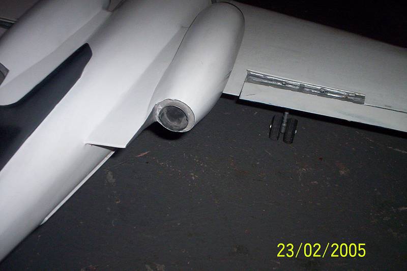

Ok here we go with pictures of my baby LJ....
Now these are from almost 4 years by the end of this month, i will try to find one from the actual build and model competitions when it was just brand new!...
Enjoy these for now.

Thanks guys, yep it's my sweetheart model and keeper for sure. I have a lot of emotional attachments to this model.
No i don't have any drawings what so ever for LJ, what i did there was from all the pictures i took of real one at Pearson Airport and from a LJ book i may still have some where. But like i said i would not do another one of these like i went all out on first one due to weight restrictions unless i extend the fuselage 4" behind the cockpit and then do it just to get proper scale down version of LJ 35A/B.
There are few other improvements that i could do now better then from that time due to more advanced skills and material now available but again it wont be DF or EDF by any means if stock nacelles are to be used!
If you guys want to use same pictures that i used, le me know and i'll find them again, i know i still have those somewhere.
