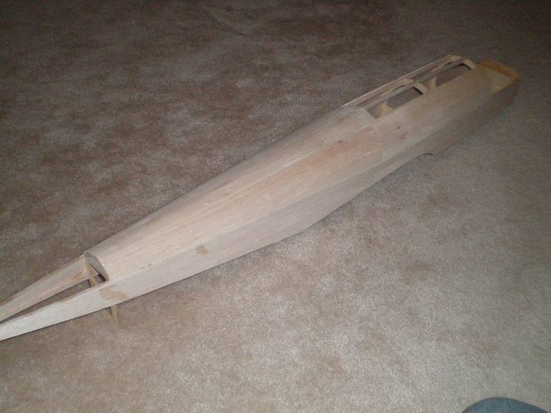

Wings are ready to be joined but I need to get some 30 min epoxy so I went back to work on the fuse.
Spent the last two evenings on the fuselage sheeting. I ran out of CyA so I need to go to the hobby shop tomorrow.

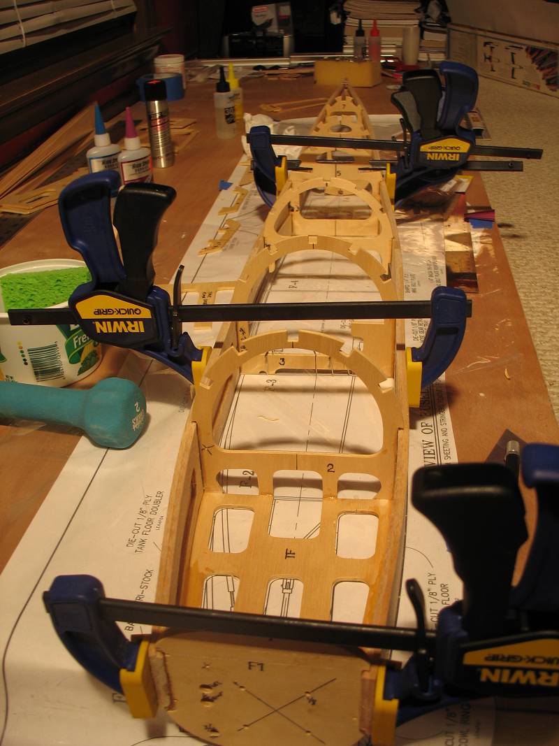

a little more progress from the weekend. I did not get alot built, it was a nice weekend so I had to get some flight time in and try out my new tx (10c). The fuse is interesting! I wet the sides from f2 forward as per instructions, let it sit clamped all day while flying hoping that it would dry in pretty much that position and make it easier to epoxy in, when I removed the clamps it sprang back to the same position as before. The water did not seem to make it anymore flexible either.

HawkPilot,
Looking good. I wish it was warm enough to do some r/c flying here in Indiana. It hit 40ish but was WINDY.
I did NOT wet from F2 forward when I assembled mine. I just applied epoxy and clamped it, there was plenty of flex and it did not crack. When you apply the sheeting to the fuse sides you will have to use the wetting process or the sheets will crack. I used boiling hot water applied with a sponge and it worked great. I think the secret is to use HOT water.
I did almost nothing this weekend on mine. I did some sanding as well as some trial fitting of the wood block for the wing mount and its about ready to glue in place. I spent some time doing some winter maintenance on my other models. I am out of town most of this week as well so I wont get back to it until late in the week.

We were in the 40's today also, no sun and a very slight breeze. I have not tried hot water before, I will have to try that.
There is an article in last months AMA about making a leading edge by curving the balsa sheet. I can't remember but they added something to the water and let it sit 24 hours I believe. I'll see if I can find the mag. and let you know what it was they added to the water.

ORIGINAL: hawkpilot
Chopper, I forgot I had read an article also about an additive...I think it was alchohol but im not sure. Somewhere I saved the link to the article. (was not the AMA article) I would like to know what you find.
Hawkpilot
I found the article. It was in Model Aviation's November's issue. They soaked the balsa sheet with 1/2 cup of ammonia in enough warm water for several hours or overnight. Hope this helps. Good luck.
