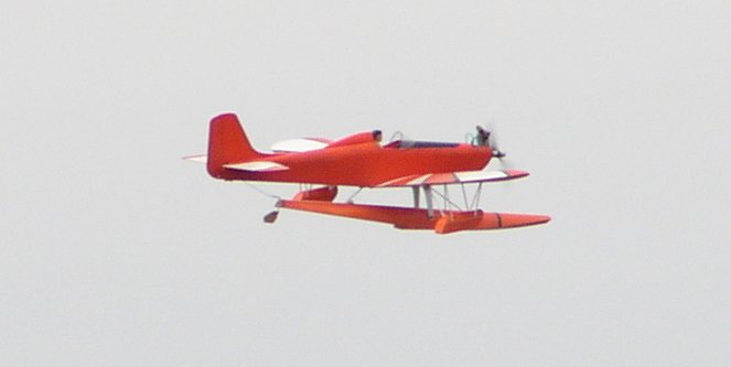

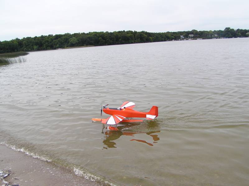

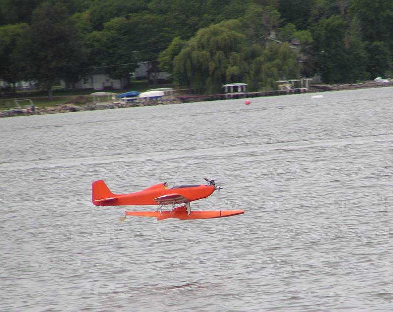

Sorry I have already posted these pics in a Seaplane thread...
This talk of Astro Hogs and floats. I wanted to do something a little different so I made a monofloat and tip floats for my Hog. White foam, packing tape, 3/16 dia aluminum tubing and a couple of shelf brackets.
The hog is covered with Sig Koverall and dope. Saito 91 for power.
Stan

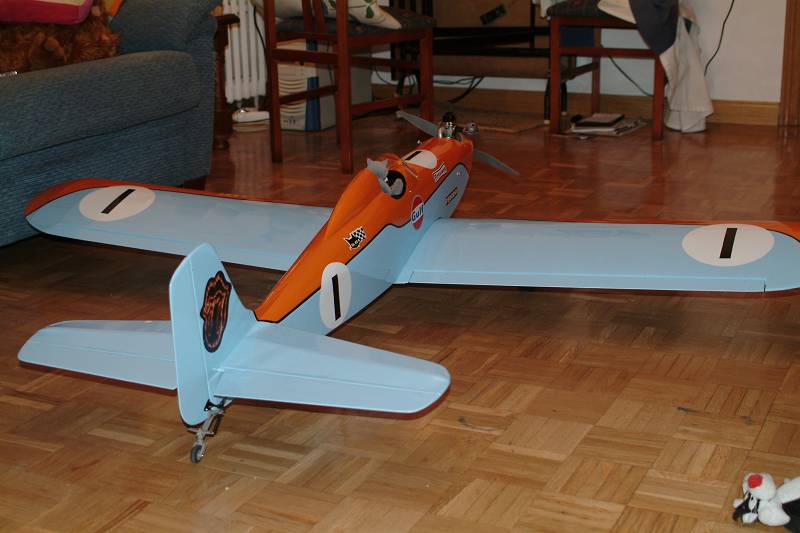

Hello!
My Astro is finished! IΒ΄m waiting to fly it in 2-3 weeks and will see how it flyes.
It has a YS63s for power. Built it as taildragger with dihedral reduced to 6ΒΊ total. Has also 1 servo per aileron and sullivan pushrods.
Weight is 7.85 Lbs/3570 gr aprox, I had to put 250 gr in the nose to balance it. It doesnΒ΄t seem to be very heavy, but lets see first fight...
The scheme is inspired in that old GT40 Β΄68 of le mans, I hope youΒ΄ll like it.
