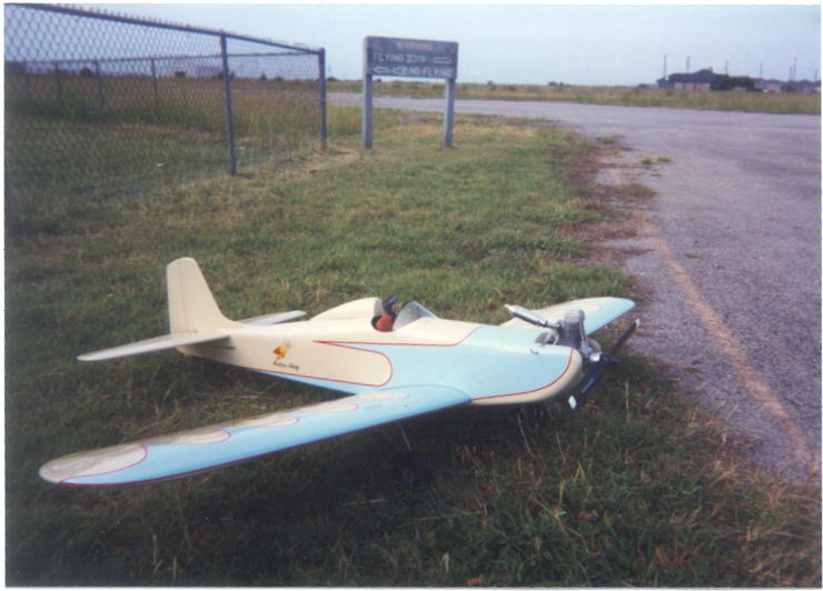

Here's the one I built back in the mid 90's. Went with the "Gee Bee Model D" scheme. Powered with an OS 91 4-stroke.

Nice looking Hog,did you ever encounter problems
with your main gear ? I'm going the tail dragger route
too.
