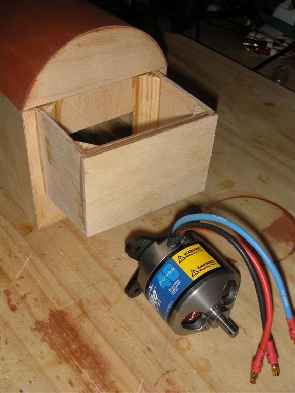

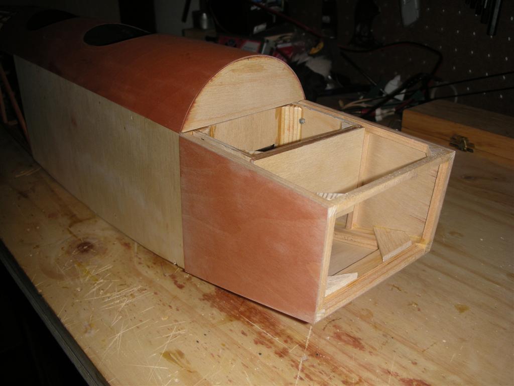

I finally have completed designing and building the motor mount and started on the cowl. Thinking through how to design the front end was challenging because I need to be able to pass a battery through the firewall and I wanted to recreate a Jenny look. It's now starting to come together and I think it should work. The motor mount has down thrust, as already designed into the firewall, and then I added 3.5 degrees of right thrust. The engine will be offset so the prop is centered on the front. The cowl is removable, with internal attachments to keep a clean look. I picked up some doll house hinges and used that to hinge the bottom hatch, which will serve as the battery pass through. The top of the cowl will follow the turtle deck lines and will be held in place with magnets. I'll then cut the very front end (radiator surround) out of a solid piece of hardwood, which will ultimately be painted a metal color.
I still need to build the OX-5 dummy engine so I can fit it in the top hatch, and also need to build some louvers for the cowl sides. These little embelishments should help it look like a Jenny. It's a huge improvement over stock, which has no real enclosure.

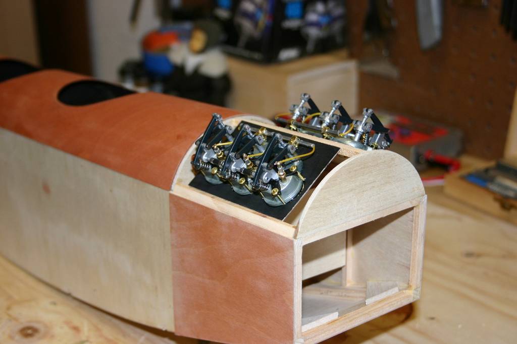

Finally built my dummy engine, modified to 6 cylinders so it fits. I still need to add the exhaust stacks. The detail is awesome. It took me hours to understand how this would go together, but once I started building it it came together pretty quick. Results are better than I could have imagined.

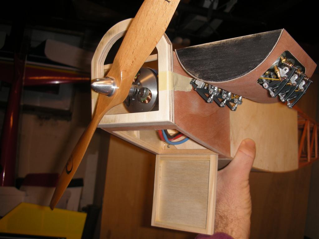

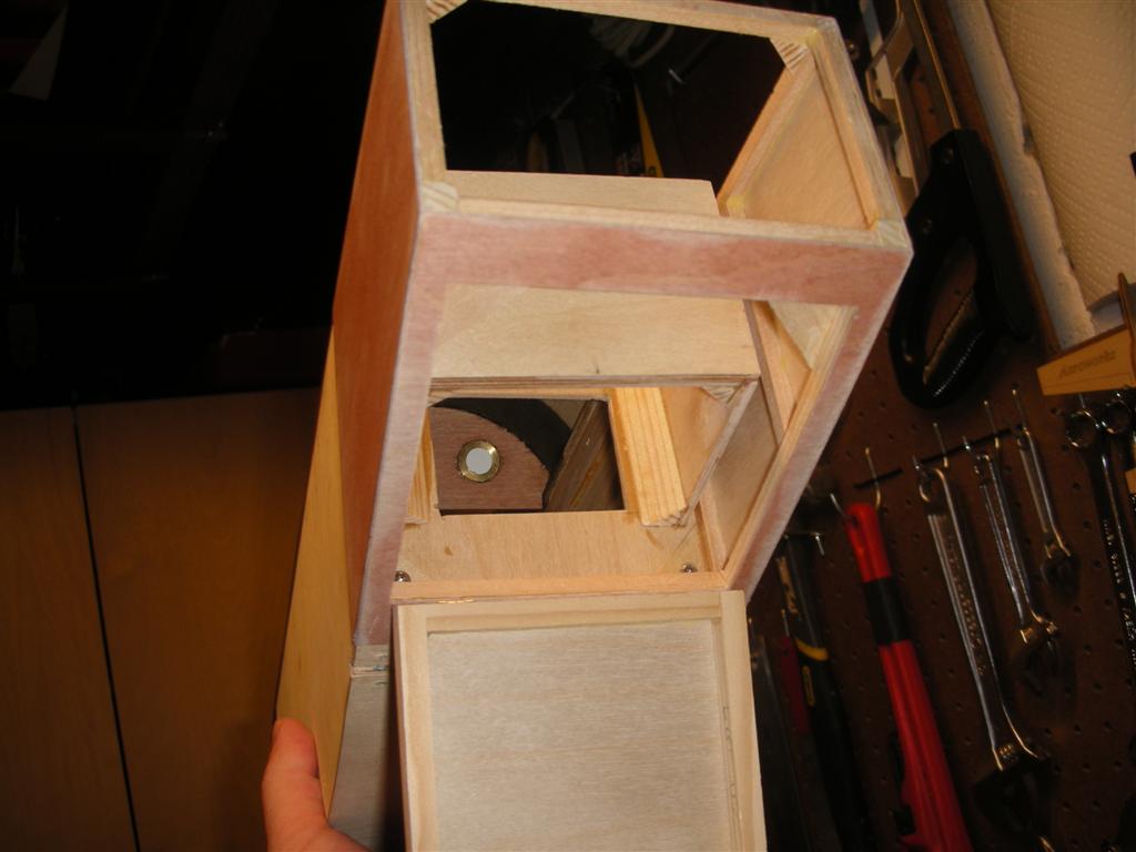

The dummy engine is now mounted and the cowl top is done. The only problem I have is that once I glue on the exhaust stacks, the dummy engines will not be removable, so I'll add the exhaust stacks at the very end. Now onto the front end/radiator.
Steve

Steve, great job on the engine. For my larger Proctor Jenny, I attached the exhaust stacks to the dummy engine and they come off as a single unit with the cowl top. Is there any way you can do that to make access to the electric motor easier? Lee

Lee - thanks. The lower half of the cowl (everything but the domed top) comes off and the domed top is fastened to the lower portion of the cowl, so it does come apart. It will ultimately be hinged on one side and held on with staps (leather shoe laces) . The dummy engine is removable too, but the way I did it is that the lower part is wedged between a stringer and the skin while the uper part is attached with two screws. The problem with this method (which I now discover) is that it needs to pivot into position so the rocker arms clear. With the exhausts glued on, they will get in the way, preventing it from pivoting in. I figure I will not have to remove the engines once it's completed, and if I do, I'll just have to break the glue joint for the exhausts. Please let me know if you have any ideas. The easy solution would be to enlarge the opening in the skin, but I don't want to do that.
I cut out the very front end from a piece of thick birch ply. I was dreading this process but I was able to make the piece in less than an hour with my scroll saw. I'm thinking of epoxying the front end onto the lower part of the cowl (top part will still be removable) to strengthen the entire front end. But I'm going to hold of glueing it in place until I'm sure I don't need to make it removable! This front end piece will be painted brass and will have wire screen placed inside so you can't see in. I'll paint the inside of the cowl flat back as welll so you can't see anything except the prop coming out.
Steve

Good idea on the front part. I made mine from balsa and glued it to the sides/lower sheeting with triangle stock for reinforcement. For the front screen, I made a small "inner" frame and glued some window screen to that, with an opening for the engine. Screening is good for cooling, especially for electrics. I cut some openings in the side where the louvers would be to help cool air flow around the engine. Also, since my engine head projects above the cowl, I didn't make up an OX engine for mine, just made sure there was plenty of clearance for air flow from inside the cowl to around the cylinder head.
Another thought for your exhausts might be to install them (epoxy) onto the OX engine AND the fuselage sides, then carefully cut them apart at the point where the top cowl needs to come off. Then, drill both ends of the cut exhaust for a small dowel, glue the dowel into one end, and it will help align the exhausts. Painted black would make the joint nearly invisible.
