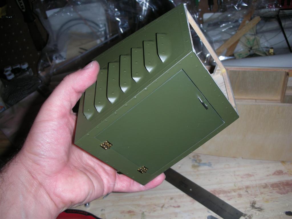

Last night I installed the magnets for my cowl bottom hatch which will be used to access the battery. I forget what you call these drill bits, but they make beautifully clean holes in balsa and it's possible to control the depth. I bought these from Sears. Fostner bits and sharpened brass tubing works well too but only if you go all the way through the piece or don't care about having a flat bottom, whereas these bits make a flat bottomed hole. I bought these when I needed to make some holes for wing tubes and almost forgot about them. Once the holes were to depth, I epoxied in rare Earth magnets on the cowl and washers on the hatch. There is plenty of force holding the pieces together and the benefit of using the washer on one side versus another magnet is that it's okay if they don't line up perfectly. It snaps shut as I hoped!
Steve

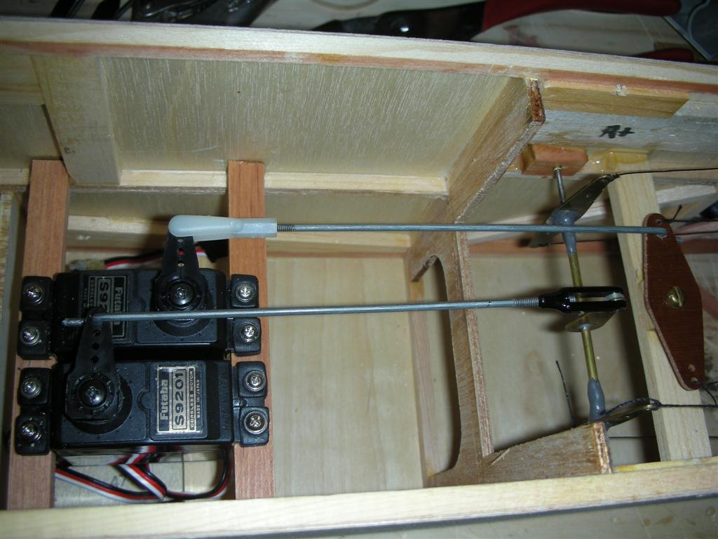

the stock Antic uses an elevator bellcrank setup with the control horns on the outside of the fuse to control each elevator half. I used the same contraption but moved the control horns to the inside of the fuse to be more like a Jenny and to reduce the chance of me tearing up my other airplanes with all that exposed hardware. I really like their system of using brass tubing and brass wire soldered together. I soldered the control horns onto the wire but since I'm not a great solderer so I used JB weld to hold it all together. It would have been a little tight to get a soldering gun in there anyway. I ran thread to the elevator halves to locate exit holes and it looks like I'm going to have to run some short lengths of pushrod tubing so the wires don't rub on the wood.
I installed the servos and hooked it all up - it seems like a pretty clean setup.
Steve
