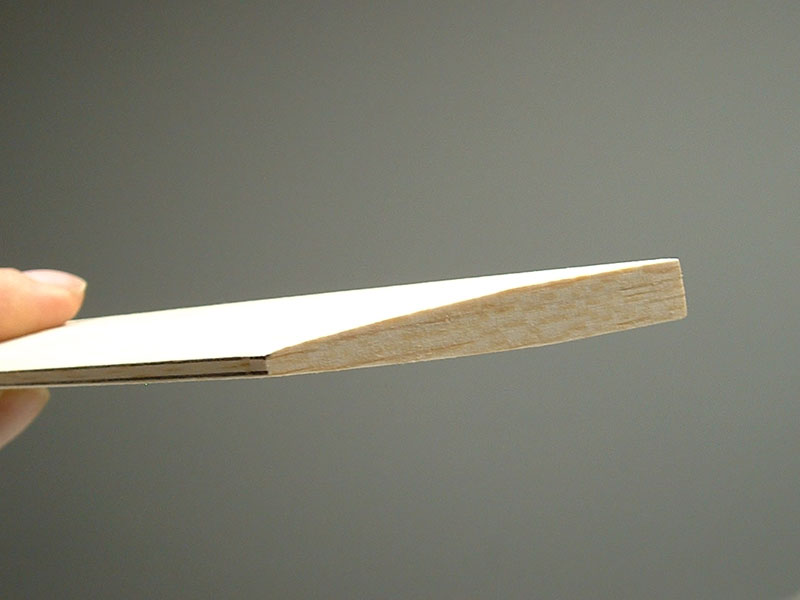

Here is the best way I have found to mark where to sand.
This example is for a hinge bevel, but it applies to sanding the TE also:
http://www.rcuniverse.com/forum/fb.asp?m=8110718
And here is an example of using this method on a TE:
