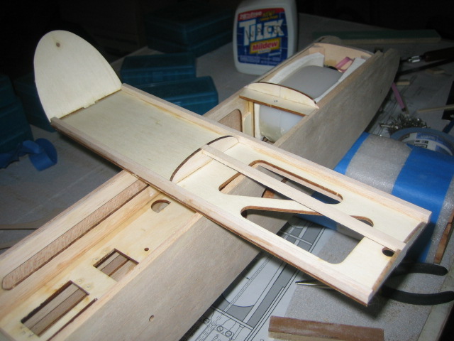

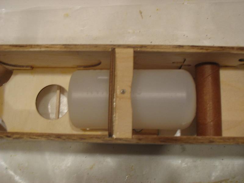

I finally came up with an idea that I liked for the hatch. Hope these pics come out. I used some 3/8 square hardwood to make the "mounting pieces" on each end. I made some edge stiffeners out of 1/4 tri stock. Was really quite easy to do. The only hard part was getting the 2-56 blind nuts and screws. If you want some details, I can post here. Won't be able to get to my computer for a day or so.

Here is the simple solution to the 10oz. tank installation. The need for removal can be satisfieed by cutting away the top and forward 1/3 of the phenolic wing spar carry thru tube. I can't imagine why you need that whole thing as the load is taken by the aluminum tube and the fuselage sides. I would still keep some of the tube to keep the fuselage sides from trying to bow in. Just remove the wing and the tube. Now your tank should slip out and over your cut away wing tube. Why won't that solve this problem???
#29
Remember to wrap whatever tank you choose using reinforced directional packing tape to provide for a rear-facing pull tab.

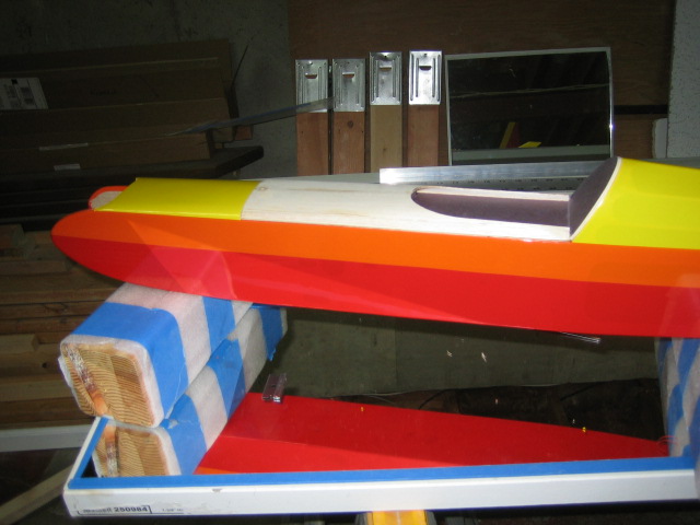

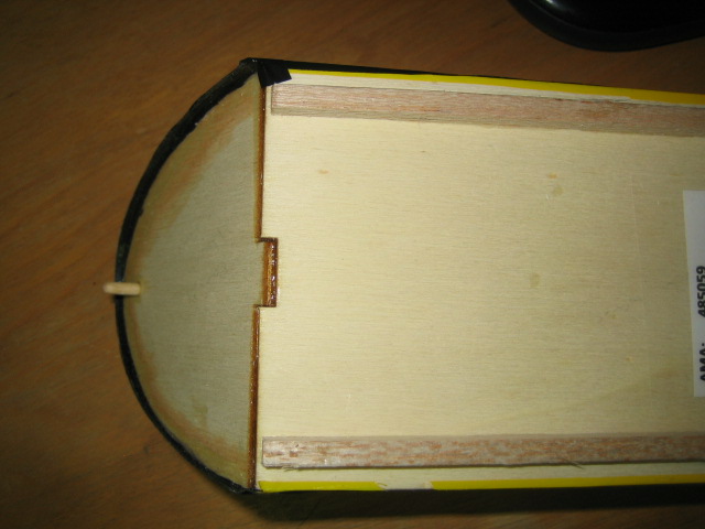

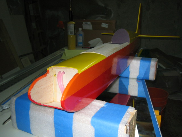

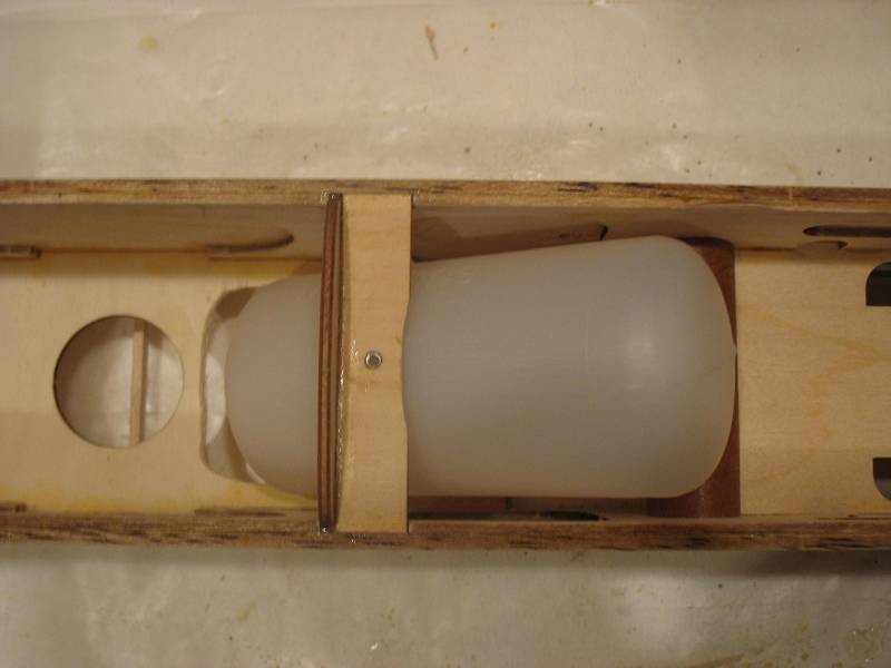

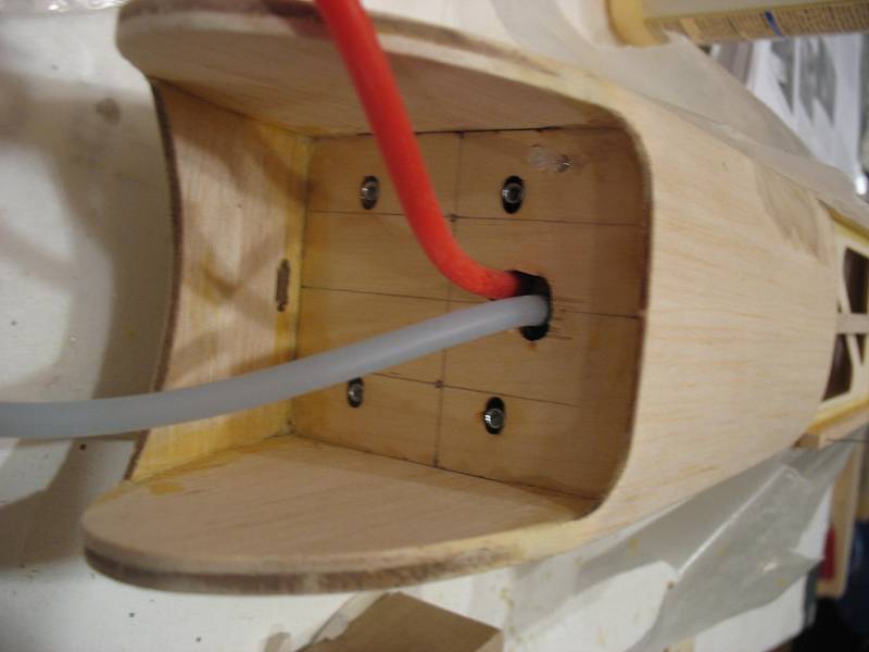

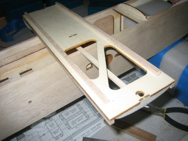

Here is my solution. I used 10oz Sullivan cylinder tank (link on page 1).
Modifications were:
1. Lower floor 1/4" (Photo 1).
2. Expand cut-out in tank floor ply. It needs to be large enough for entire tank to sit down under it. (Photo 2 - marked with removed areas))
3. Shave a bit off the hatch hold-down strip (Photo 2). NOTE: When I was dry fitting, I did not have this piece in place. It causes all kinds of problems as it shrinks the space between it and the phenolic tube. I expected this is why even the 8oz Dubro does not pull out.
4. Shave a bit off the bottom of F-2 (shape link cylinder). I took it down to even with the triangle stock (just in the middle) (no photo)
5. Tape tank per intructions to pull out
6. Added hole to firewall. I wanted to have the fuel line as high as possible to line up to carb so I oriented the tubes vertically versus horizon or side-by side. (Photo 5)
Photo 3 and 4 show the tank being inserted. You have to turn it 90 deg so the bump on top clears and then have it sit flat inside the fuse. Then turn 90 degress back to normal and bump it up onto the tank floor. It is hard but it fits.
I added 1/4" foam on floor, side and roof.
I agree that cutting the phenolic tube would help greatly. At first I did not want to touch this. In thinking about the above comments, I agree it is not structural but definitely gets in the way.
Anyway, I have a 10oz with minor mods that can be removed through natural birth methods.

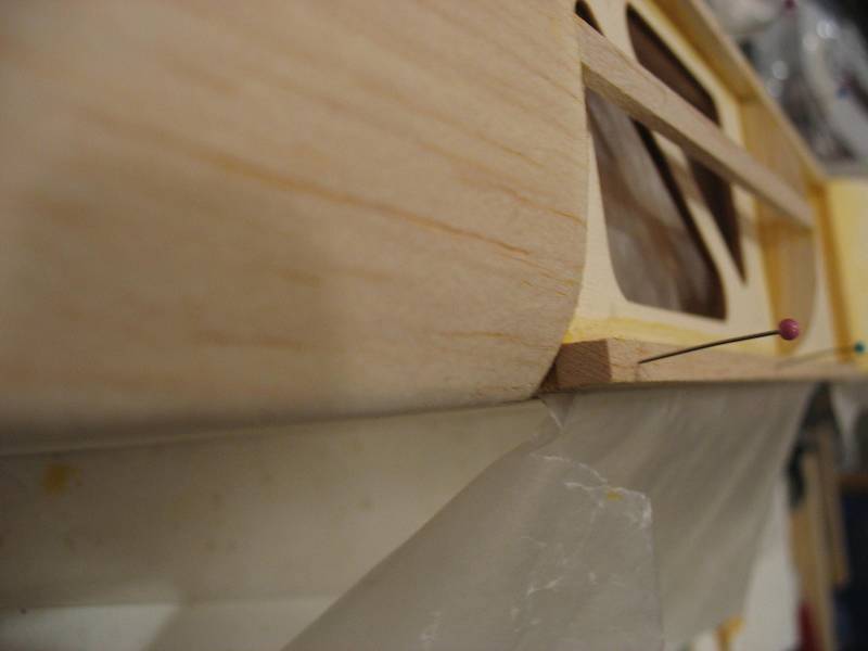

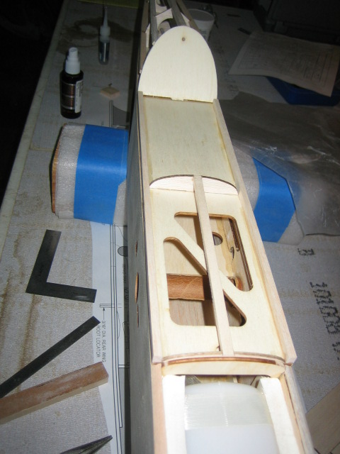

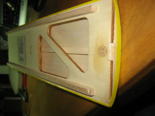

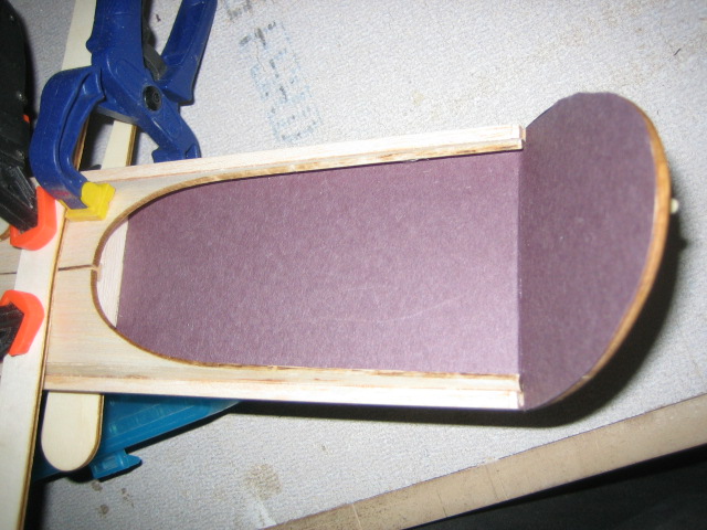

At the risk of hi-jacking my own thread, I am confused on a subsequent step.
I have built the top hatch per instructions. They have you glue down some 3/16"x1/4" strips on the outside edge prior to gluging in the sheeting. However, I do not understand why they are there. When I look at the profile, it looks to me like I will end up removing all the strip when I sand to match the profile on the forward section???
See photo to see that the contour of the forward section does not overlap with any of the strip. Do I sand this away after adding the sheeting (meaning it is there to give the sheeeting something to sit against while gluing but otherwise it no longer needed?)
Or do I sand back on the front endge but then tap "up" towards the rear of the hatch such that most of the strip is there by the back cap portion?
#32
If you were to skip the side rails then sheeting would be glued to the lite ply hatch base along the side of the hatch. Then you would sand the sheeting down to the edge to shape. Not much structure would be left and this hatch is (ab)used frequently. The sheeting is edge is trimmed to fit the vertical backside of the rail. That leaves a bunch of wood to work with before covering.

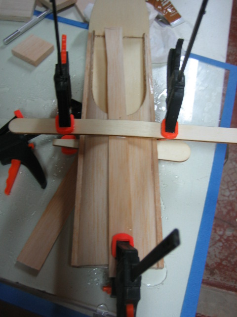

Thanks Seamus: Do you have a photo (uncovered) after sanding? I do not see how you shape the rear portion where the sheeting tapers off..or did you add filler or something? If I follow the angle of the sheeting, you would remove all the square stock and a bunch of the ply too. Still very confused.
Also, I did not like how the end cap had very little support (very little contact due to the angle) so I glued a front 1/4" sq which was cut to the angle to act as angle fillet support (like triabgle stock). Was I missing something there? I agree it will be used a lot and just a small tab with about 30% of wood contact and a bit of glue did not cut it.

I think you must have missed something on the instructions. I am not sure what you are doing. I have built 2 SSEs and that hatch assembly works just fine. It is a little tough to build but seems to fit fine and is fairly easy to remove. I have an outside switch and charging jack. Because of that and the fact that I never remove the wings, I don't need to remove the hatch often. Friends of mine have located their switch inside and use a magnet to hold the hatch down.
#36
If you zoom in on the 2nd pic you can see the detail of the hatch though a bit fuzzy.

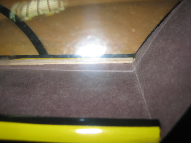

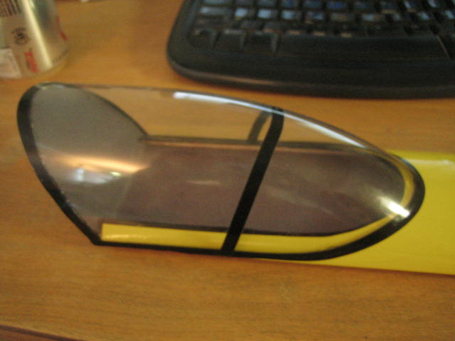

I carpeted the floor and rear cockpit former with dark gray craft paper using 3M 77 adhesive. I covered the entire hatch with ultracote bright yellow which is fairly transparent (shows all my mistakes
). Taking the suggestion of my LHS "best builder in the area" suggestion to keep trimming on the canopy until it fits flush with the hatch without applying any pressure. I repeat, without applying any pressure. Once trimmed I used a thin Sharpie to outline the canopy. Then, after a couple of Margaritas, I used a brand new #11 Xacto blade to cut a thin strip about 1/16" just inside the Sharpie line. I practiced positioning the canopy. Couldn't do it by hand so I added a tape hinge between the peak of the cockpit former and the peak of the canopy. The canopy was then laid back behind the hatch still attached by the tape hinge. I then laid down a bead of SIG's canopy glue on the exposed wood and around the perimeter of the rear cockpit former. Then, very carefully, swing the canopy back over the hatch and into the glue bead. Use tape to carefully hold the canopy in place - not much pressure or the canopy will be distorted.

<edited> Btw, I added the black trim tape for effect. Yes, I could have done a better job on the bead of glue. [&o]

Hi-jacks welcome. You are correct I will need the info anyway. Natural birth seemed to describe; espeically compared tot he surgury option required now the top sheeting is glued in above the tank. Your fule tank section hatch looks like a good solution too.

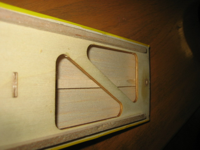

For your main hatch sanding, did you sand away part of the ply? In my case, it looks like even a portion of the ply will need to be sanded to match the front portion profile. If you look at the photo above, you can see both ply and 1/4" stock sticking out past the profile.
Again, any guidance on how to taper this back towards the end cap?
Any comments on how sturdy your end cap was? Mine was very loose (aliphatic glue; after the fact, I thought maybe epoxy would have been better). I will post a photo with the extra support added later.

Not quite sure I understand your question. Hope this isn't getting too frustrating. I didn't need to sand any of the ply, or if I did, it was VERY little. The 1/4" stock is on top, and it gets tapered when sanded. Is your 1/4" stock on the edge of the canopy floor? I think after you have to hatch in place, you will get an idea of how much gets sanded. When you post a pick of your hatch, maybe we can see what's going on?
My end cap was not real strong, so I used epoxy to glue it together. Probably not necessary, but makes me feel better. I would guess that Sig figures that when the canopy gets glued on, the canopy holds the end cap in place.

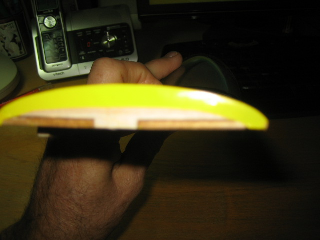

Well, I got the hatch sanded and it looks "OK" but it took a ton of sanding and fair amount of filler (the front part of the sheeting got compressed from my clamps and this caused the front to be too low and need a fair amount of build-up using filler).
I must say, this hatch was my least favorite part of the build (so far). I am now in "assembly" (vs building) mode.

I understand you sentiments. Good news is that it won't affect how well the plane flies. Do a nice covering job and you will be the only one that knows.
