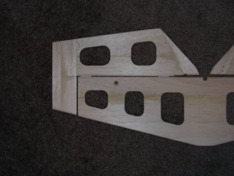

So I would like feedback on this option:
1. Cut out the portion of the fuse doubler where the floor mounts but glue in the "Popsicle" shaped cut outs. This will drop the floor 1/4" giving vertical clearance.
2. Cut 1/16" on each side of F-2 to give clearance. (Suggestions on how best to shave this amount? access is hard)
My worry is with Step 2. The F-2 is 1/8" ply and the vertical sections are only 3/16" wide so 1/16" is not insignificant. Am I making this too weak by going from 3/16" to 1/8" on this strip? I do not want a "new" structural issue....
First picture is the fuse doubler where the floor can be lower 1/4" by removing the marked section. As stated, I will glue back in the cut out to form a new surface for the floor to fit into.
Second pic shows where the 1/16" needs to be removed for the tank to squeeze through.
Thoughts? Other approaches?

Can you shave a little off the side of F2, and then use a small piece of triangle shaped balsa to reinforce it on both sides? One side may even be enough. Either that or some fiberglass reinforcing tape. That is my two cents worth. I am not an engineer, but I did sleep at Holiday Inn last night.

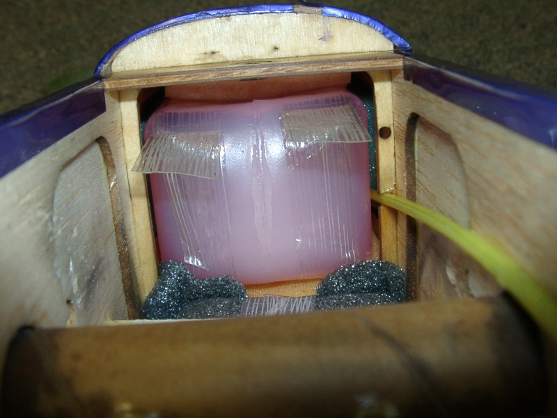

I used the 10 oz soft tank in mine and left the tank shelf out. Glued foam to the top and bottom of the tank compartment and the tank slides between the foam. I used fiberglass reinforced tape and made two pull tabs attached to the tank. I did remove some material from the F2 to get the tank in but have seen no problems yet. You can pull the tank out over top of the joiner tube with the soft tank. I also run the ST G51 in this plane.

Reciever just behind the wing tube and the battery between the tube and the tank. I added some to the tail also.
The tank will come out pretty easy as the foam lets the front of the tank drop down while trying to clear the wing tube. Now getting the hoses out the holes is another story with the built up cowl and engine in place.
