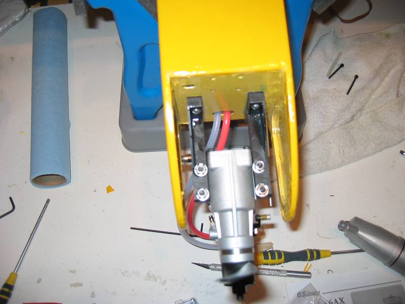

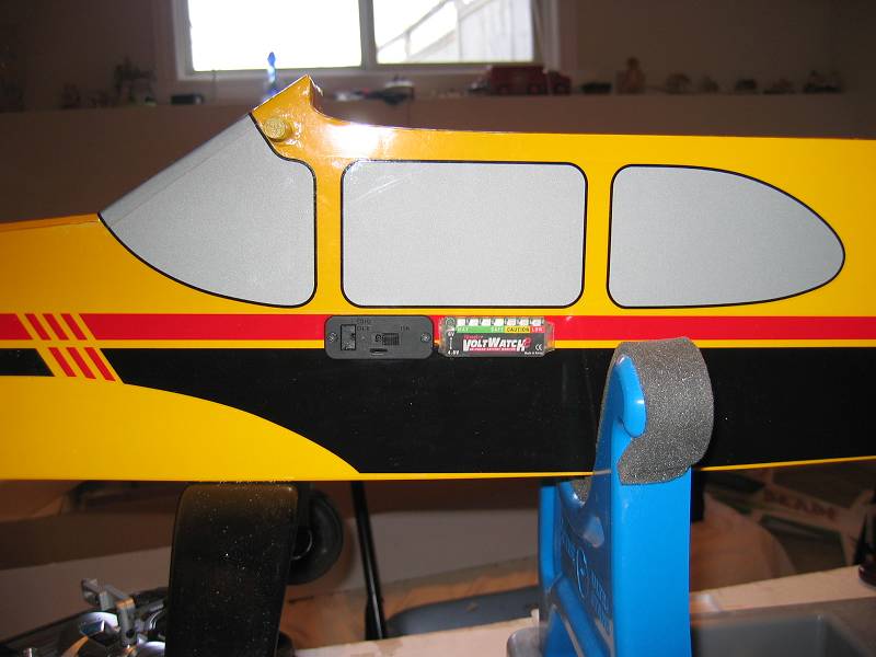

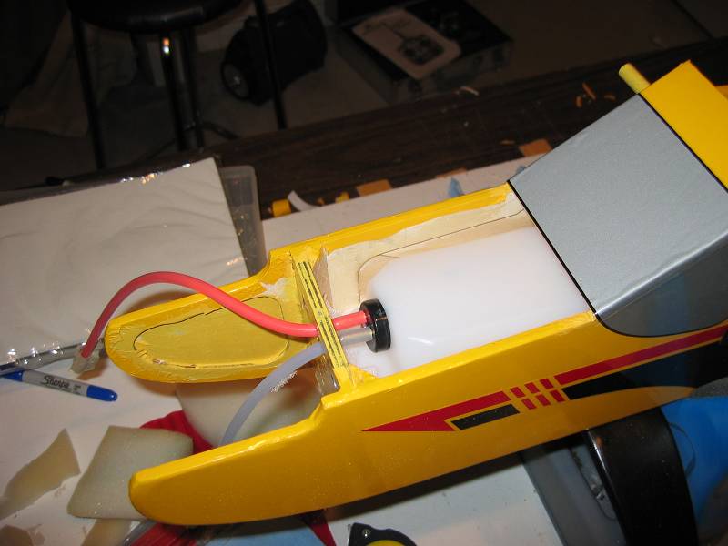

I think so too w8ye. I like the cub yellow, it shows up good in the air. I'll put a couple stripes on the under part of the wing outboard, and put two 5 inch stars on each wing like I did with the fourstar60. I installed the servo for the wing and soldered the connectors on the rods, and installed them. I put a charge switch on the side. I forgot to put the voltwatch on the side. I'll take the swich out and cut a little grove for the wire and reinstall the switch. I put the tank in, I have to put the throttle cable in, when I do that i'll put some 1/2" foam beside the tank. I put some flooring foam, used for laminent flooring under the tank, as I didn't want to raise it much. also the battery, I put in some foam and pushed it as far forward as i could. I'll put the engine on when I balance the plane. I've really enjoyed the build. I'm looking forward to nice weather to get it flying.

I installed the voltwatch. Then the receiver. Mounted the engine. I'm as far forward as I dare go, and I'll have to add 3 1/2 ounces to the front. I'll put on a brass weighted spinner and add some lead. I don't think putting on a smaller tailwheel will make much difference. I have a 1" on there now. I have a 3/4 one here, but I think I'll leave the bigger one on as i fly off grass.
