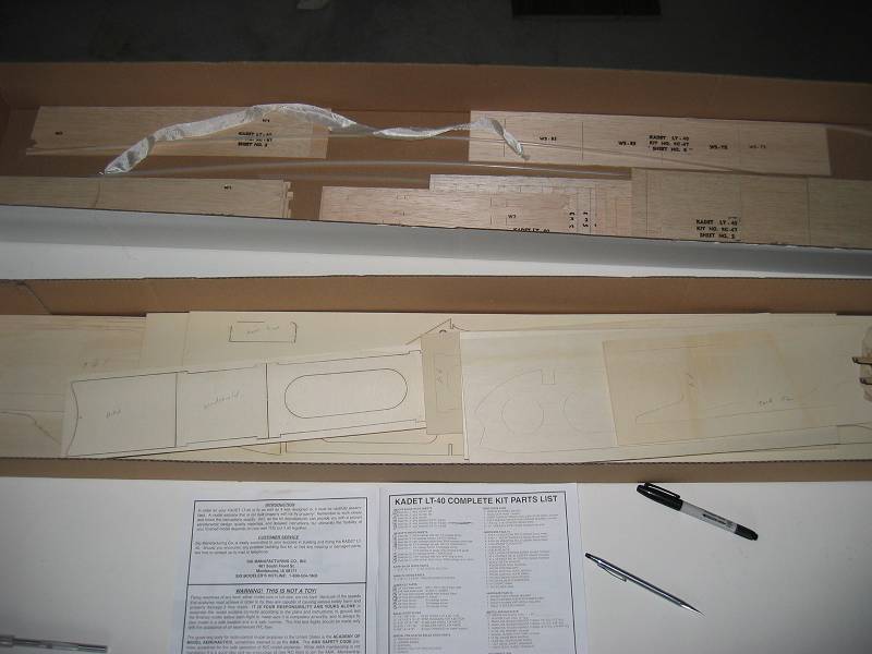

Last year I built a four star 60 and I enjoyed the build. I didn't get hardly any flying in last year, and I misjudged and put my trainer into a treetop. I wanted to build another airplane so I decided to build Sig LT40 and make it a taildragger. I'll post pics as I go along, so maybe it will help someone else. Also I got a lot of help when I built my last airplane. The first thing I did was open the box and get the manual out, then start checking everything off. Putting the wing parts in the lid, and putting the fuse parts back in the box.
Old 01-26-2009 | 08:50 PM
Joined: Jan 2008
Posts: 156
From: Morrisburg, ON, CANADA
Default RE: LT40 Build thread
The pics didn't go in the first post, I'll have to figure this out again.

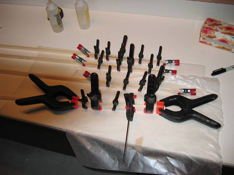

I found the spars and the doublers. I glued them up before putting the plans down. After putting the plans down and covering them with waxed paper, I pinned down the spars, then trial fit all the ribs first before gluing.

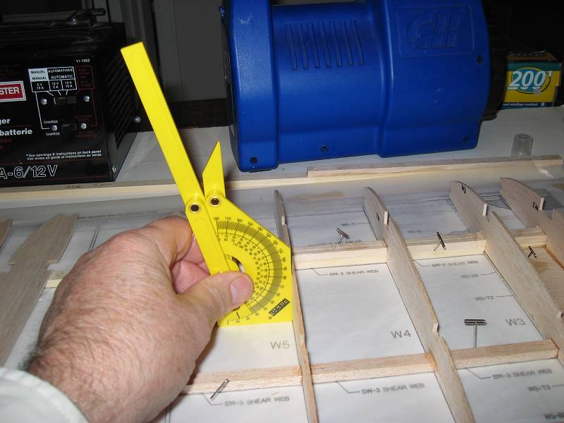

As I glued the ribs in I made sure they were straight up and down. The yellow tool there is handy it is square on the bottom, and you can use it for degrees. I used it to bevel the ailerons on my four star. Sorry I didn't post more pics as I was going on step by step, I just got in a bit of a hurry. The first rib is on a bit of an angle and the template has a bit of a curve on it. so I used the tool with the degrees to recheck. I put it on the drawing in the book as a reference.

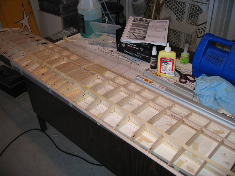

I'll post the rest of the pics, the second wing goes the same as the first one. I did one wing one day, and another one today. On the 3rd pic I found an abs pipe joiner. It works good for making sure the ribs are straight up and down.

Geeze, have you get enough clamps???
Old 01-26-2009 | 10:56 PM
Pro-E's Avatar
Joined: Dec 2003
Posts: 88
From: Lewisville, TX
ORIGINAL: MinnFlyer
Harbor Freight baby.!!!! I have the same set.
They all come in one box.....for like $4.99
.....and the large ones are STRONG.!!!

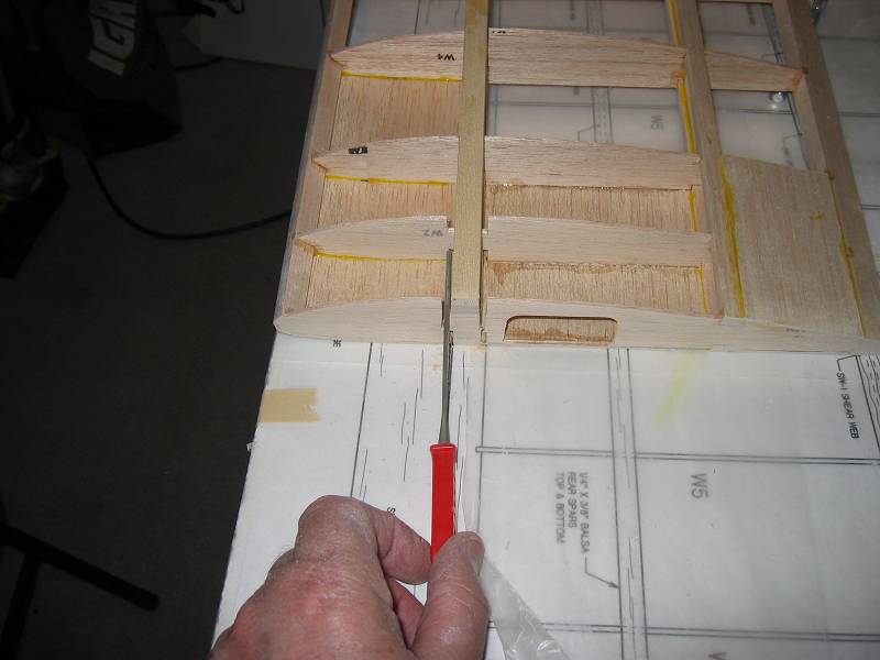

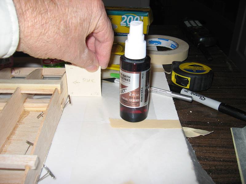

I cut off the spars on the wing tips and in the 1st rib then sanded them. Then cut out the die cut part in the first rib. Minnflyer is seem you never have enough clamps. Is that ever a nice looking Lt40 W8ye. It looks really nice as a taildragger. I have a rounded fiberglass gear for the front. Did you cut a v in the bottom of the rudder? That is what i'm planning to do.

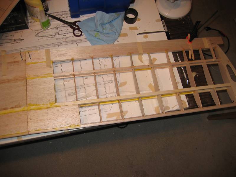

Old 01-30-2009 | 11:56 PM
w8ye's Avatar
My Feedback: (16)
Posts: 37,576
Received 11 Likes on 10 Posts
From: Shelby, OH
You are doing a good job
Old 02-01-2009 | 04:43 PM
Joined: Jan 2008
Posts: 156

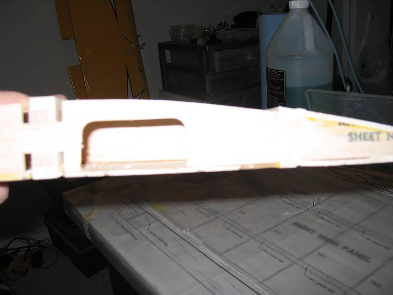

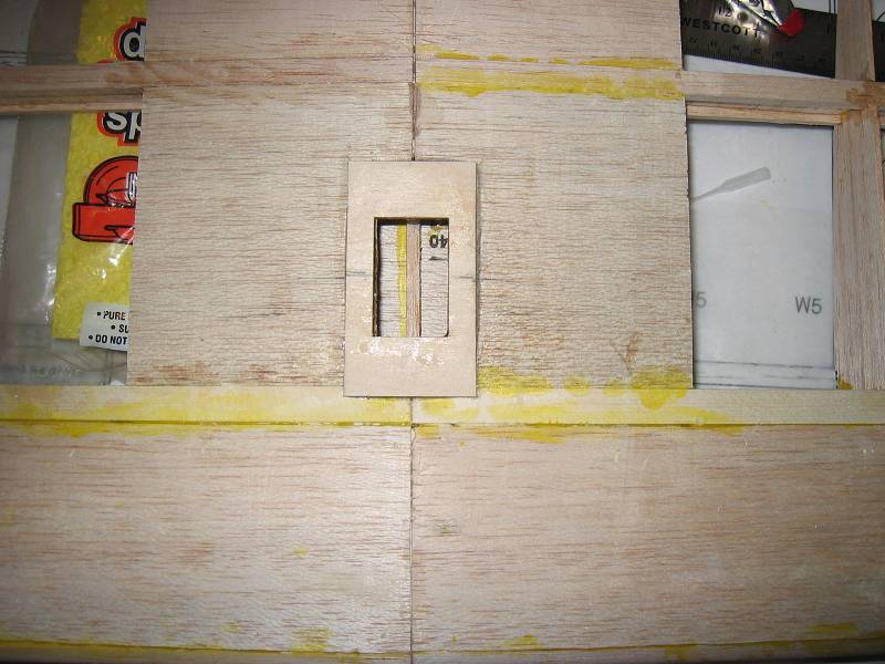

Thanks w8ye. I cut out the area for the wing servo and glued the plate on. Then glued the 2 stiffeners on the top of the wing.
