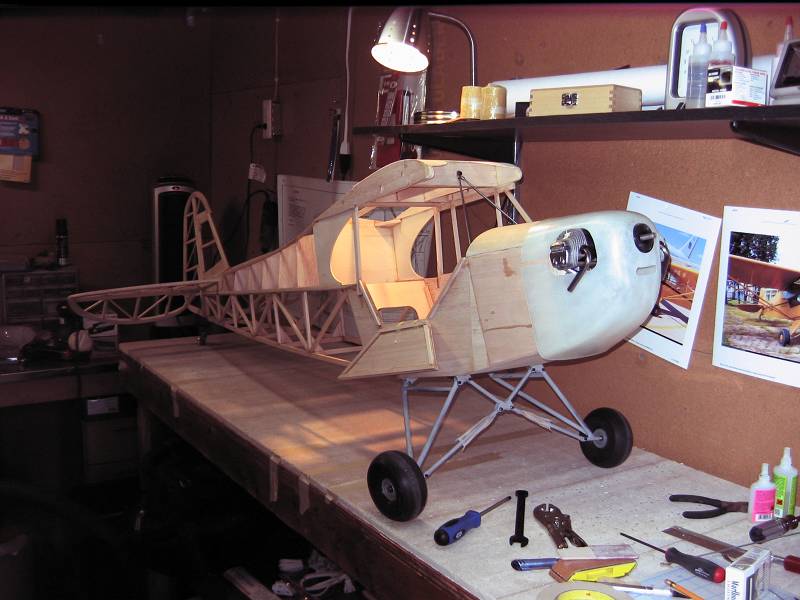

HI Guys, Im having some problems with my cowl ,i bought a fiberglass one and had to split it down each side to get it around the cyl's . It' looks ok but im trying to figure out how to secure it ? Any ideas

I cannot see your split but the original was split top half and bottom half at the cylinders

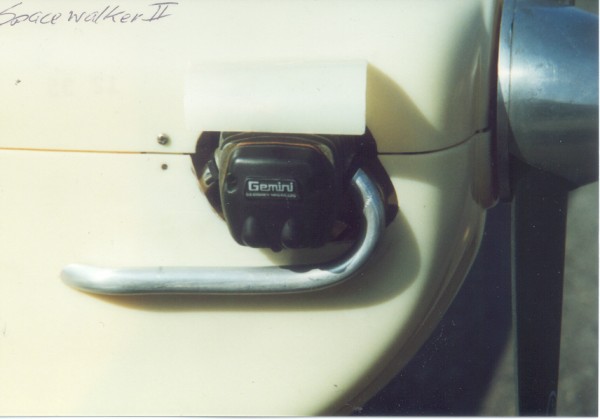

If you look closely, the screw just behind the valve cover is holding a plate of aluminum. Another screw goes into the bottom hole. This is used at 4 places around the cowl. If you wanted to get fancy, you could use a flat head screw for the one that will not be removed, and cover it over with spot putty.
Les
didn't take the photo the first time around. I will try again.
