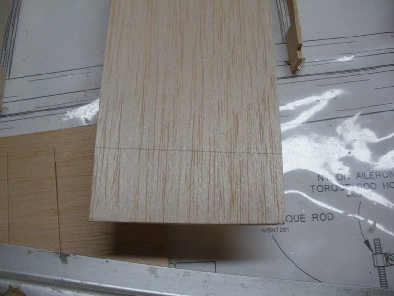

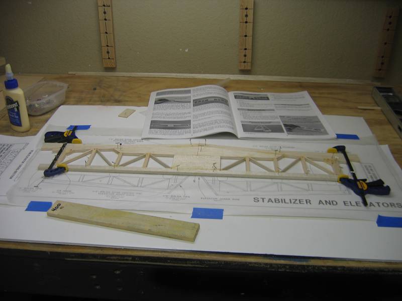

Here are pics of work to date. I may work on the elevators later today. I like not having CA on my fingers!

Very good my friend, looks excellent. I wouldn't have done it any better. As far as the sailing thing, try this, look up marina sailing, CA. It's a chain where owners enrole thier boats into the "time share" of ownership, basically, back in 2000 I lived in Ojai cali, I work in oxnard at marina sailing, they had 22 chains up and down the coastline, from san fran to san diego, you join and book a weekend on a vessel of your choice. I was the mechanic for all the boats in oxnard, so everything form a 22' cat boat to a 36' columbia, my favorite was a 28 catalina with a y-keel. Very fast boat for a rag bagger might I say, about 7-9 knots if trimmed and set right. But the two I own now are in the east coast where I live, the renken 20' I've owned since 16 years old, I'm 33 now. Back then, I worked in a marina, did I mention that I'm a water rat and grew up on boat jargin? Any who, I worked in the marina, bought a small 14' glasscraft off the owner and restored it and used it to zip around, (drink beer illegally at 16) and have a grand old time just me and my buddy. Well at the end of the season, the owner asked me if I'd like to trade my little 14' for the 20' renkin because it needed a repower, I took the boat and repowered it about 2 years later and the rest is history. The pearson is an abandoned boat in a local yard, I bought it for like 500 and redid it from top to bottom, but right now, it sit's out of water, no cash no splash, ya know. I need to put it on a trailer and convert the mast to a stepable plate, I couldn't find a way to get to my house with a mast top 45' up in the air!

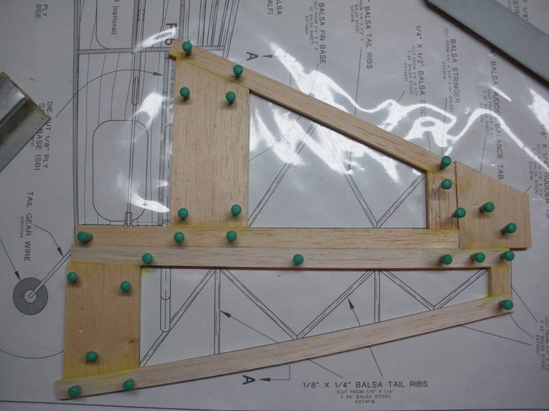

Well, the vertical stab and rudder are built, next is the wing, I'm not doing the hinges till later, If you follow the instructions, beveling the leading edge of the rudder before adding the top is reccomended, but I'm probabily using either robart hinge points or goldberg hinges I have laying around. So I didn't bevel the LE for a reason. You'll see something yellow sitting in the pic's near the top of the rudder, it's a piece of plans protector keeping the top of the rudder from being glued to the stab, just a small piece between the two is all that is needed to keep it seperate. The whole assembly is left to dry and later once off the board, it will get trimmed to shape and final sanded, always better to have more wood to remove than not enough, plus, I'm letting my rudder go to the absoloute bottom of the fuse and not using the wire imbedded in the rudder. Yes,.... the inspector stopped by to verify the work was correct and all the glue joints were tight and wiped clean of excess. Maybe I should just use him as a weight to keep the parts in place.

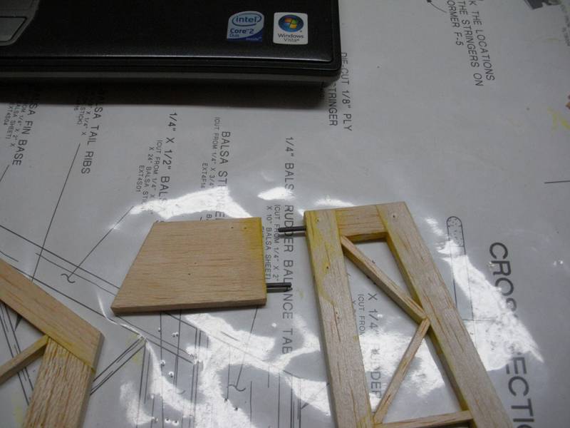

I forgot to add these pic's, it's an easy way to keep your rudder counter ballance nice and solid incase one day you knock it by accident, it only takes about 1 minute to do, and you can use a little carbon fiber rod like I did or steel rod or 1/8" dowel. The dowel and carbon fiber rod are lighter than the steel dowel by far. Just line the two up, make the mark on bolth pieces and draw the centerline of the counterbalance and rudder. Bore the holes and insert the two rods, check the fit and pull it apart and resume building as normal, gluing it in place with the dowels or rods in place. I remember breaking my old counterbalance off one time when I landed in mud on the runway and it flipped over on it's back. That was the easiest and quickest way to make it strong. It's little things like this that go a long way down the road, it turns a great plane into a durable great plane.

I love that counter balance mod. I will definitely do that. You hit the nail on the head regarding what I am looking for - a durable plane. I realize that sometimes it is better to have a weak link that will break; like the nylon bolt that hold the wing on - I have broken this on my scratch built at least half a dozen times and the wing has survived great.

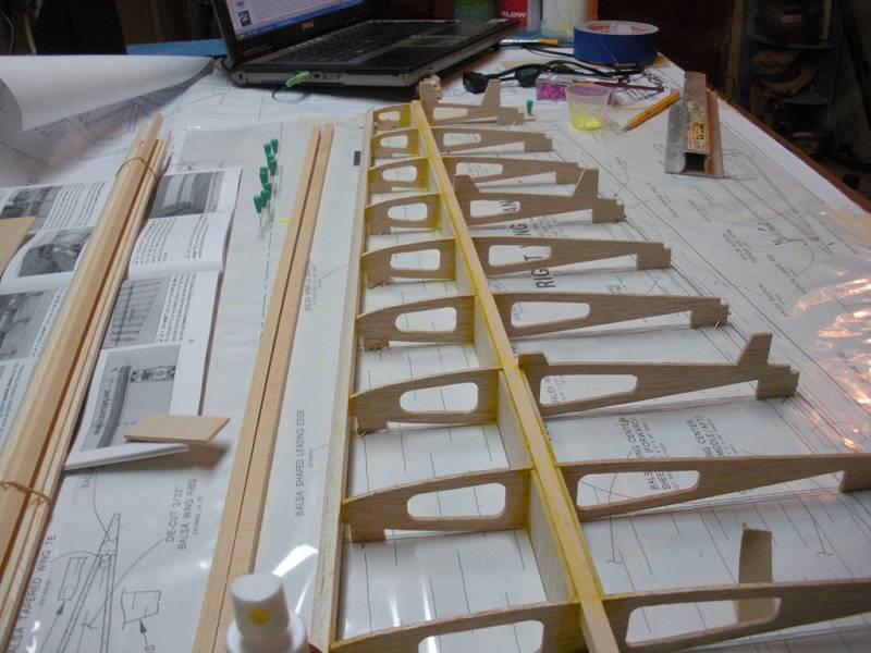

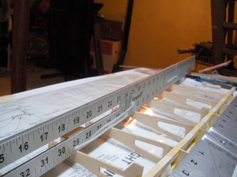

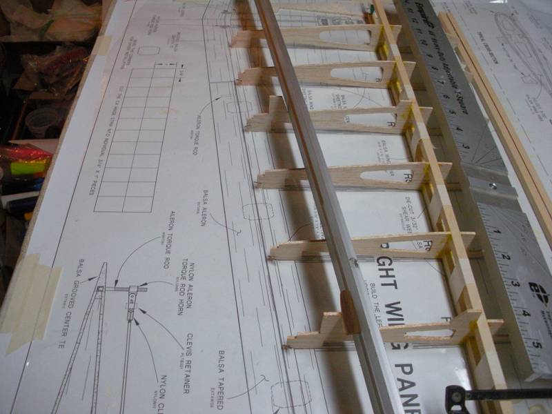

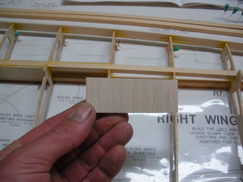

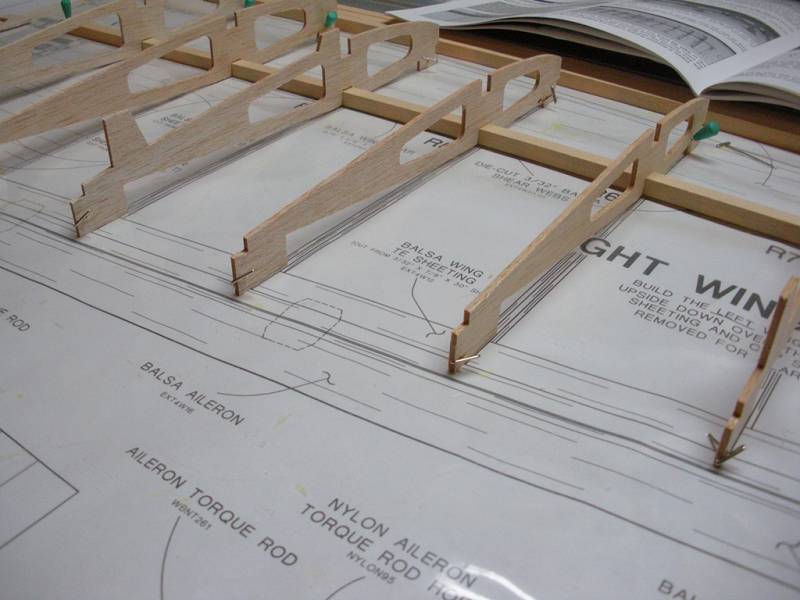

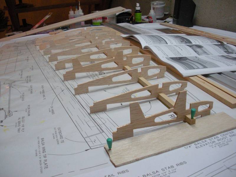

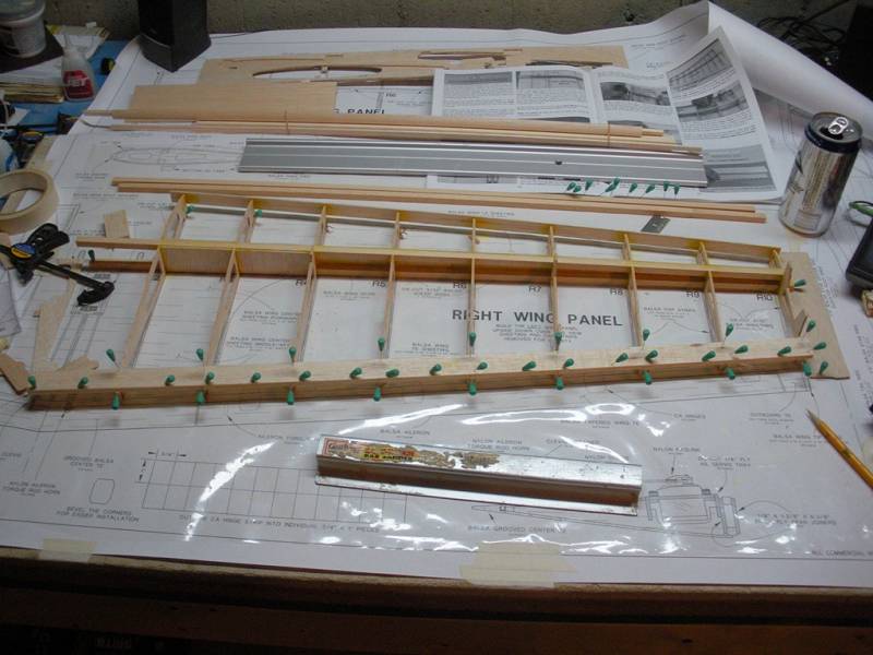

Wings,.... Obviously pop all the parts out for the wing, the jig tabs go down and there are only 3 ribs that have long tabs, those face up and are used for support when flipped over. When setting the spars down, look down them before pinnin them down, they most likely will have a crown to them, make sure you put the bows opposite each other, in other words, place bolth so the bow faces in the wing on bolth sides or away from the wing on bolth sides. I set mine so the crown faces away from the wing on bolth sides. Like this ( ) or you can do them like this ) (, but it will promote lifting at the tips, never set them in so they face like this ((/ )), your wing will set like a bananna. You can use CA to glue the ribs, I still use wood glue, so I have time to line everything up, if a rib feels like it's too tight, don't froce it, sand the spar groove till it fits snug but not splitting the rib. If you are going to use wood glue and not CA, you'll have to think around the issue of holding the spars tight, I use masking tape slipped under the spar and pulled snug around the top it's a cheap clamp to tension the spars into the ribs. Finally, make sure they are all square, lined up and all jig tabs are touching the plans tightly. Now when it's all set in place you can chack to see how flat the wing is by putting a straight edge down the trailing and leading edge matching the wings sweep to see if any ribs are too low or high. When happy, walk away and let it setup. Applying the wood glue takes the most time but has the advantage of letting you adjust parts before it's too late. So all in all it took me about 45 minutes to get it all set and lined up, now I have time to sit back for about 1/2 hour and relax, answer some posts and then go to the next step, or I can look ahead and set up the wing sheeting so when I need it, it'll be done, preassembly is the key when using slow cureing adheasives. Keep looking ahead to see what can be done while the glue is drying so you don't find yourself waiting for that to dry down the road before you can put it on the plane.

Thanks for the tips. I am going to continue to use wood glue because I want to learn how to work with it (as opposed to working against it). It actually works well for my schedule - I can glue a few pieces, clamp, and leave.
Having your pictures and notes is really helpful - it is like I had already built a couple of these.
I like the masking tape idea. I use the blue masking tape for a lot of things.
It is taking me longer because I am dry assembling and figuring out how I am going to clamp things before I use the glue. I have read through the assembly manual several times and will continue to do so until it make sense - after I have read it, looked at your pictures, and thought a bit more, then things go better.
I need to get some pins like yours, and those aluminum straight edges look very neat. I feel a trip to the hobby store and hardware store coming on! A man has to have tools!
One of the best tools I have is one I built - a sanding board that allows me to easily sand wood square. For example, I put the stabs and elevators on it and can easily sand the ends square. It is just a few pieces of board glued together - the design for it was in book that I read before I started scratch building. I expect you have something like this.
The forecast was totally wrong (typical); it has continued - I drove 30 minutes to the field and was the only fool there - I hung out for a couple of hours and did get a couple of flights in. It was actually fun because there was 10 mph cross wind which made the landings interesting

Here are a couple of pics
