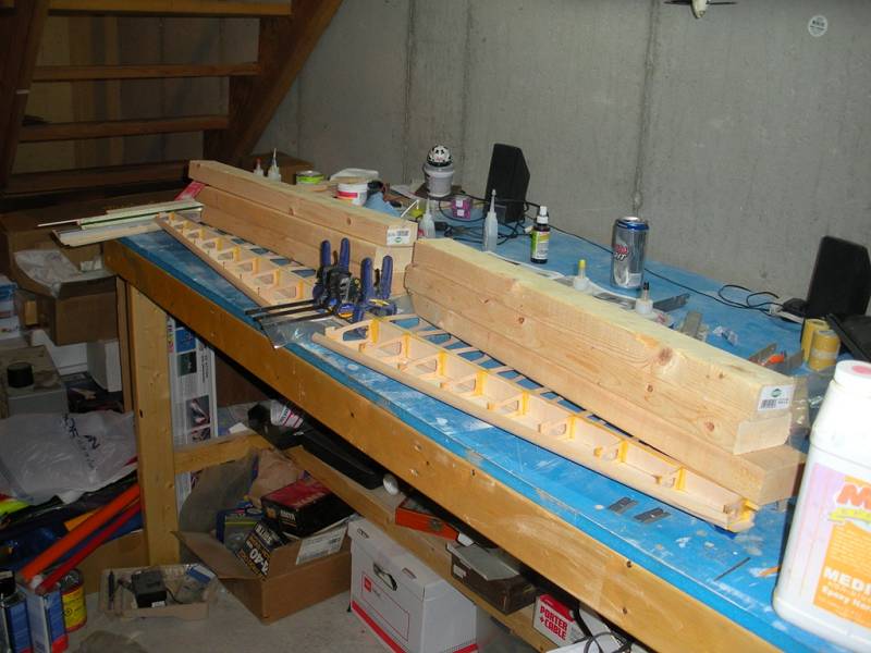

As usual, I did start the other wing panel, but I forgot to throw the camera on the charger till the end of the night, but it's the same process, except quicker. Next stop after tonights building sequence is the fuslage. The fuse is where the major mod comes into play, mainly the gear plate attachment. It's not that it's a bad design, but the lite ply isn't really sufficent to survive rough landings and rough grass runways. The other mod is to the saddle/nose doubler, in the event of a flip over from wheels catching something or just slaming it into the ground on it's main wheels, the whole nose can break off from the notch of the wing saddle former straight up. Really it's a simple fix and just takes a few minutes to modify.

I am almost done with the fin and rudder. I used a couple of pieces of 1/8 brass tubing to reinforce the counterbalance.

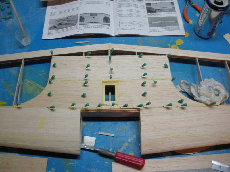

What is the procedure you use for gluing the sheeting on? Are the pins you have in the photos sufficient to keep pressure on the sheet or do you glue the sheets to the ribs separately?

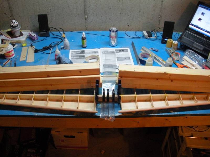

But last night I got the two joined and lined up right, don't go by the plans trying to keep the distance between the two inner wing ribs at 5 &1/2 ". Fit the two panels together so that the W2 ribs are parallel to eachother and the wing joiners are touching bolth ribs W2. If you mark everything per the book and put the two panels together, you'll probibally end up with a 1/8" gap with the joiner not touching the sides. Hopefully tonight after work I can sheet the top and set the alerions, still haven't decided weather or not to use 2 alerionn servos or one. But that decision has to be made soon, due to installing the tubes in the wings for the wire to run down.

Crashalot is right on the money - your pictures a much more helpful than the manual. Tonight I put the first wing together and just followed your photos. The masking tape works great.

The last brew I had that was english, I almost threw up, it was some honey wheat ale,......[:'(] But I guess it's all an aquired taste. I did get the top sheeted and the trailing edge too, but not the center, I was going to take today off, but my concious got in the way. I ended up going to work and playing detective for a bit, seems a customer who bought a new piece of equipment from our company decided he needed the refrigerant out of it for something else, but the funny part of it all is he wasn't expecting me to do soo much leg work to verify that the unit had a charge of refrigerant in it when we started it up. Plus the fact that I did not one, but 6 leak checks at various pressure increases, so there was a charge of r-134a to start, 4 months later, there was nothing, do leak check and find 0 leaks over a 8 hour span. Not even a oil drop to be found, now call the customer and say it lost it's charge due to theft, the problem is the charge for the single circuit is 225 lbs of r-134a, at about $8-9 a lb so it's about 1900 in lost refrigerant. Not too bad but hard for the customer to swallow. I knew I should have stayed home and worked on the extra instead! But alt least I have the weekend to putz around on it. I'm about to place an order for various items needed for the planes I'm working on recently, need a pitts muffler for the extra, and a tail wheel, have the servos, engine and other stuff, need to order a few other servos for the GP skybolt and a heavy duty switch, and a kit for someone I know.

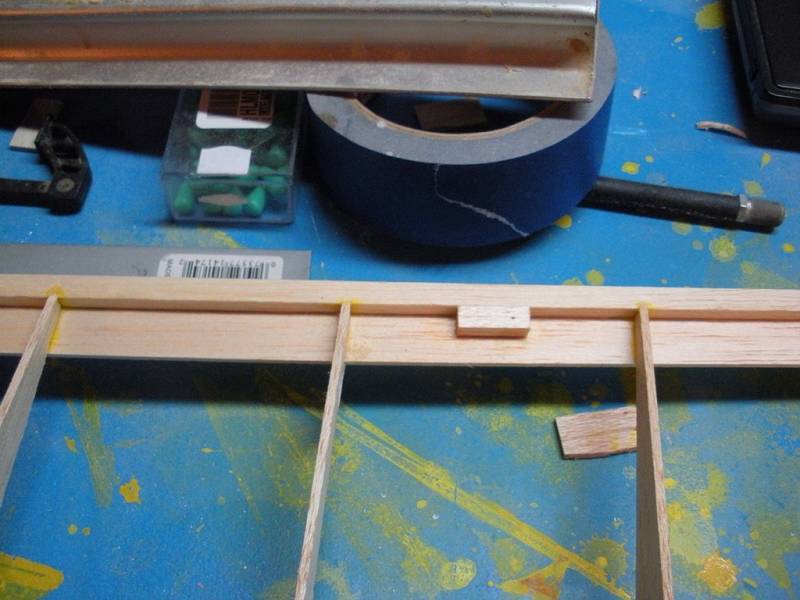

What are the little blocks up against the trailing edge?

Boddingtons, that was the brew, it almost made the night a total waste. But I know where your comeing from on the "getting bored" aspect, I felt that way with the pulse, just had something not right about it, didn't seem to do the moves like you told it to do. Didn't matter how or where you shifted the cg or the throws, the plane is only going to be a second stage trainer no matter which way you slice it. The little blocks are for my hinges, weather I go with CA, robarts or klett style hinges, it gives it a little more wood to bite into and not let go. An absoloute must for robart hinge points.

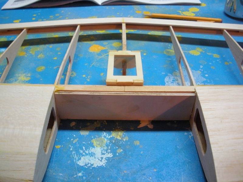

Here are a couple of photos of the wings.
I started cutting the hinge (CA) slots and had forgetten how much I suck at doing this. Forty minutes to cut 4 slots before I started to lose my patience. What is the trick to cutting slots faster? Are those hinge cutting tools any good?

As far as the slots go, first mark the centerline down the liength of the trailing edge, then mark where the hinges are going to go, make the hinge marks about a 1/4" wider than the CA hinge your using. Get you hobby knife out with the #11 blade on it and line it up on the center line you just made on the hinge area marks, lightly start the slot, like your cutting on the line, keep cutting on the same line till your about 1/2 to 2/3rds through, now make the plunge cut with the blade vertically, once the slot has been cut through, run the #11 blade back and forth in the slot to help open the slot up. The blunt back side of the blade will shave it wider and provide room for the CA hinge, they do make blades for making CA hinges, but I do own a Slot Machine, and yes it's the best thing since sliced bread, just line it up and pull the trigger, a CA hinge slot in about 1-2 seconds. But if you do small planes with it, you'll need to buy another set of blades and trim them down to 1/2 the size. But for the 40 and up planes, it's the correct size for standard CA hinges. I use robart hinge points, so I have the jig for centering them on the trailing edge, makes life bearable when trying to drill a centered and square hole in the trailing edge. I'll be back on the wing build tonight, I came home too late to do anything on either plane.

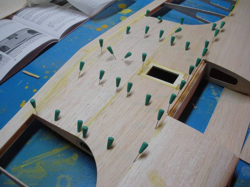

Well, the extra made it back to the bench, servo mount and top sheeting is in place, do yourself a favor, cut the 36" sheet like they say, and then make your curved cut and copy it to the other side, before you glue them down, take the 18 3/4" sheet and trace the pattern on one side. This will give you the same shape part and you can adjust the other side of the lower sheet by lining up the trimmed off curve on the other side of the lower sheet.
