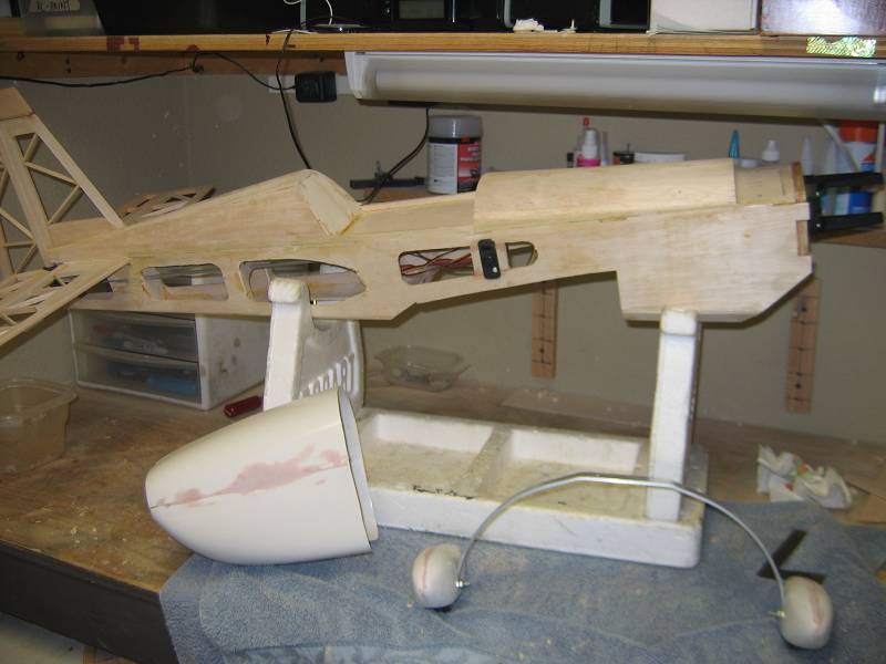

Icontinue to make slow but steadyprogress! The servos and switch are installed. Engine mount is ready to go. The slimline muffler I bought had poorly finished4-40 threads for the two machine screws so I had to invest in a tap. I seem to have bought a lot of little tools along the way with this build - I am sure they are essential and will be invaluable in the future. I guess it just means I will have to keep building kits.

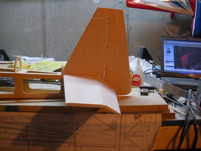

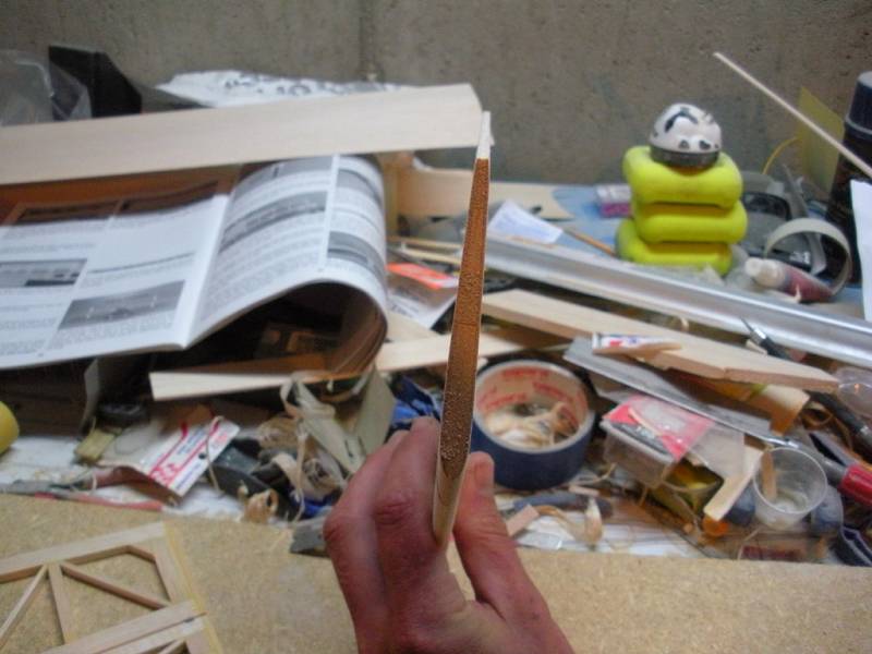

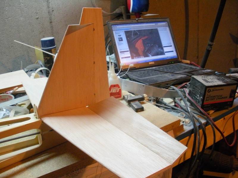

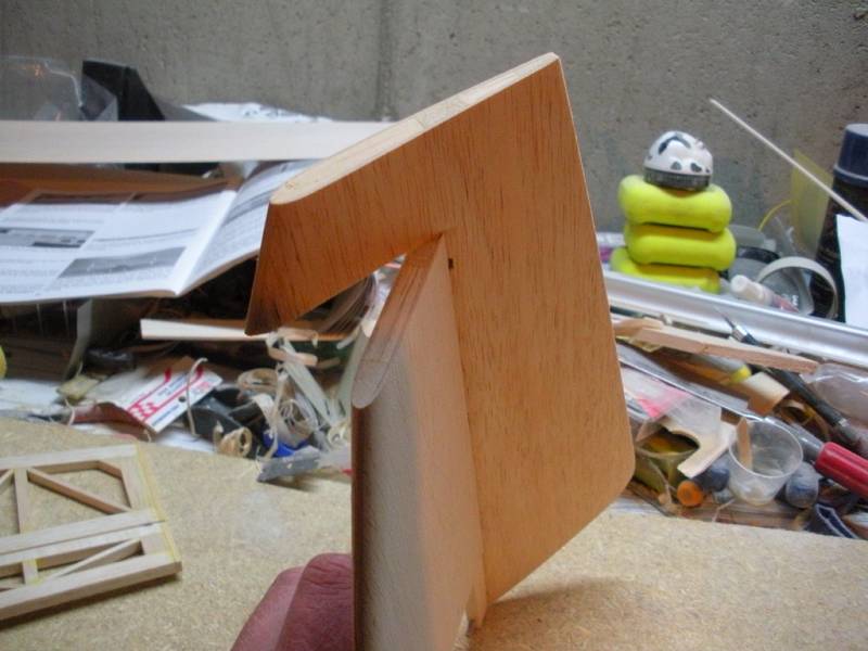

Well, work sucks, I woke up and decided that I needed a break, I've been going for over 1/2 a year and only taken 1 day off in that time, so,.....I called in and told then I think today is my weekend start. So I can do an update on the progress, I had little time to build, never mind taking pictures, so here's where I sit, today the stabs and the turtle deck will be done along with a pull-pull setup on the tail. But first things first, I did the robart hinging on the elevators and the rudder, samded them to an airfoil section on purpose, making them very thin, now I reached back and dug out the 1/32" contest grade balsa sheeting in the 6" wide variety and sheeted the vertical stab making it only slightly heavier but 5X stronger. You don't need to do this if you just sand the vertical and horizontal stabs per the plans, they're plenty strong as designed, but to get it more streamlined, you'll lose too much material to keep it strong, so sheeting is required. So far, I'm pleased with the results, I wanted to do this on the last one, but never did and if memory serves me correct, my old extra needed tail weight, so the .5 OZ added in sheeting isn't going to hurt anything, it might come out to 1 ounce total but I'll remove some of the bottom lite-ply to make up for the weight gain in the tail section. I do have to run next-door to the hobby shop, about 1 mile from my house and get another 2-56 pull-pull setup, can't find mine in the mess! So that is in order after doing the horizontal stab sheeting, clean my shop and again, try to keep it clean?![img]/forum/js/punymce/plugins/emoticons/img/trans.gif[/img]
