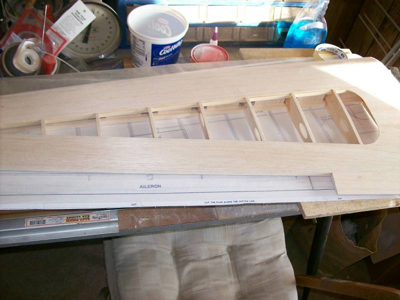

Hi all I got some time and was able to get a fair start on this kit. Heres a couple pics of the progress so far. The wing builds easy but the ribs are fragil. I left only a opening for the servo wire to pass thru in the ribs, the rest I glued in place for added strength.
The wing almost builds itself, everything is already made for a person.
The wings like many are built upside down useing the left plan for the right wing.

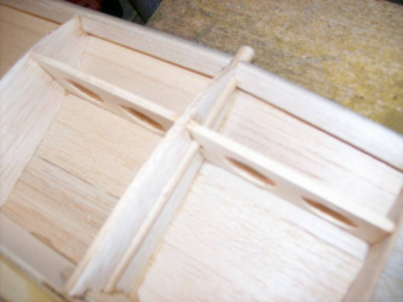

You start out with a basswood spar on the bilding table ,then add 3 ribs 2, 6, and 10 which have breakoff tabs. After pinning these ribs in place you can then add the trailing edge and remainder of the ribs followed by the shaped leading edge.
The leadign edge calls for a 5/16 cutout for the wing dowel. I used a 5/16 brass tube sharpened to cut the half a hole in the leading edge which worked good.
After the leading edge is lined up and glued in place ,next comes the top basswood spar. this needs to be set by useing the step back gage supplied in the kit. This will put the correct dihedral in the wing .
The I added the shear webs which again are already made and fit on the front side of the spars from ribs 2 to 10.
Next edge trim three 3x1/16x36 sheets and glue them together. This the leading edge sheeting and must come out to the correct size when finished, so a little extra measuring will help here so the premade center sheeting will fit good. Next add the trailing edge. Complete the other wing up to this point.

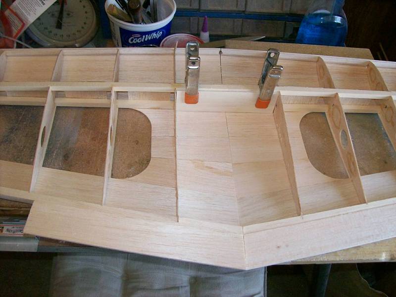

After I added the center sheeting I also added the 1/16x1/4 cap strips and the tapered trailing edge. Useing a flex scale I marked the joint edge of the wing and trimmed it up even.
Next comes the fun part of joining the 2 wing halves. The kit provides some tip saddles and a couple center saddles that work ok, if your carefull.
After making sure the center joint fits good I set the wing in place and before I glued anything in place I used my incidence meter to check things out and make sure I wasn't building in any warps or twists. I had to raise the wing up to be able to do this and use the kit saddles.
After I was satisfied with the fit and 0 degree incidence through out the whole wing, I put the dowel support and lower no 1 rib in place. I then glued the center sheeting and trailing edges together using thin CA ,Make sure you have a sheet of wax paper or plan protector under the wing before you do this.
It takes a little trial and error to get a good fit on the dowel I have made it sound like it falls together ,believe me it dosent.
I then added the 2 center wing joiners useing 30 min epoxy I clamped it together to dry, but I also made a final check of the wing for straightness and twists.
After the epoxy had set up several hours I went ahead and installed the dowel support and both top and bottom half ribs and also the rear dowel support useing 5 min epoxy. I also rounded the front of the dowel before I installed it. I did this by putting it in a drill and spinning it while holding some 80 grit paper against it.
I did add the center ply but only for a strength factor this wing will have 2 servos.
Next I added the trailing edge sheeting while holding the wing down with weights on the saddles. Thats it so far maybe more today since its snowing ,Shakes my head.

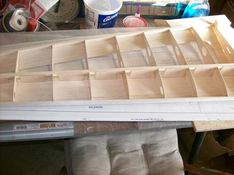

More of the build if anyone is watching.
After making 2 more leading edge sheets, I held the wing down on the saddles with weights and glued them in place useing med CA , A person needs to do this rather quick before the glue starts to set up. So make sure your wood is cut to size and straight before you try glueing it in place.
After both side was done I added the last of the center sheeting ,end tip sheeting and the 1/16x1/4 cap strips .
I then removed the wing from the building board to inspect things and make sure of good strong glue joints all around, and added the wing tips.
Then the put the center fiberglass tape on the center section of the wing, I followed the instructions in the manual.

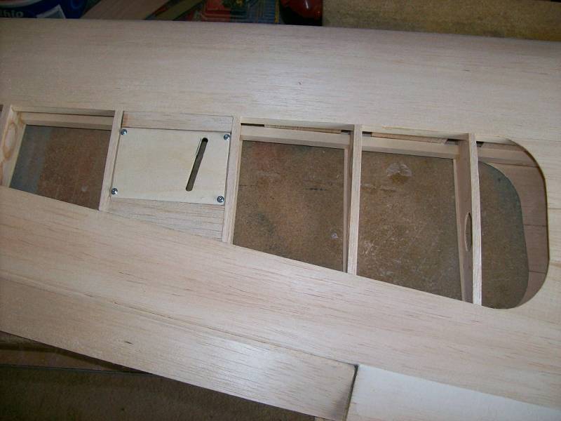

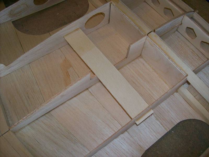

The kit give you some trays ,but I don't much care for them so I make my own, I used 1/8 lite ply this time but 1/16 is plenty. I did use there balsa cover for a template which worked ok.
I then added some basswood sq. stock to the ribs for the servo tray to rest on and attach to. I then sheeted the rib bay on either side of the tray with balsa for ease of covering.
After some final sanding,to help contour the tray to the wing a little and knock off any high spots . I then drilled 4 ea 1/16 holes in the corner of each tray for the hold down screws, after drilling thru both the trays and rails I removed the trays and redrilled them with a larger sized bit for screw clearance.
Outside of some final sanding that completes the wing . I did recheck it with the incidence meter its not bad maybe 1/2 of a degree twist that will come out easy with the covering.
Wasn't that fun now comes the fuse after some cleanup to the workbench.
Oh I almost forgot ,make sure you build a left and a right servo tray they are different . The plane I made earlier this year I made two of the same and got told all about it *LOL*
I then found the airleron stock and marked the center with a line running down the center of it ,I then marked 2 more lines on each side approx 3/16 down this is my ref point of where to cut the bevel to.
Useing the plans I marked the location of the hinges I used CA type hinges , Not the ones supplied in the kit.
I then used a exacto knife and cut the slots for the hinges making sure they were on the center line.
I then transfered the hing lines to the wing and cut the slots in it also. I then put the airleron on the wing for a test fit ,one side was good the other I had to move one hing slot just a tad to obtain center. After being satisfied with the fit of the airlerons I next built the servo trays.
