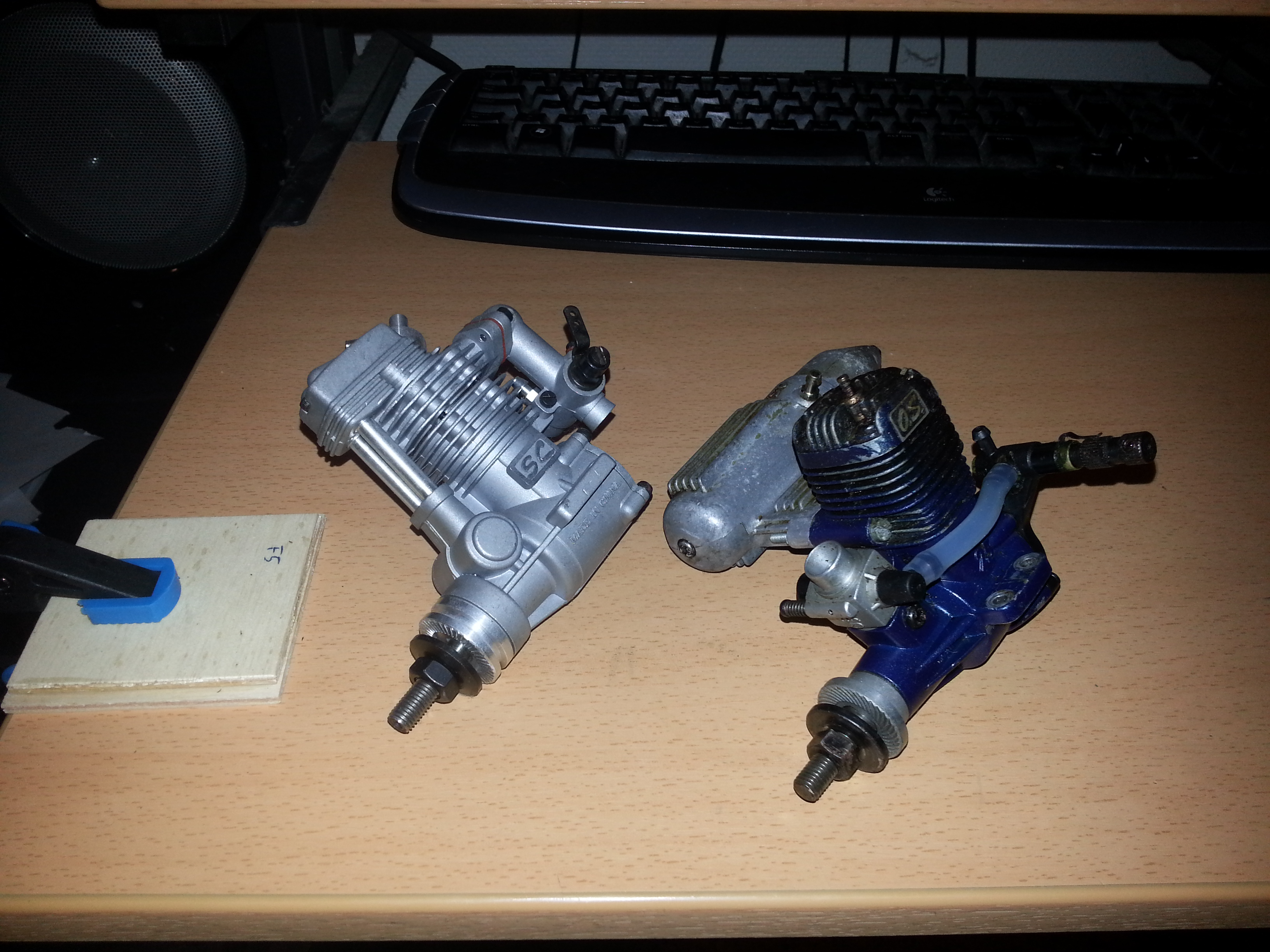

I'm getting closer, I glued the firewall today.
The engines in the picture are my new SC FS30AR and an old OS 25LA. The 25LA is my first engine, from 1998. It has survived several airplanes (I can think of four at the moment). It was very dirty on the outside, but the inside was shiny and compression is very good. I replaced the piston and liner a few years ago, and it probably hasn't been run very much since then. So i decided to clean the outside of it and put it to use again. The big question now is which one to use on the Butterfly. Time will show.

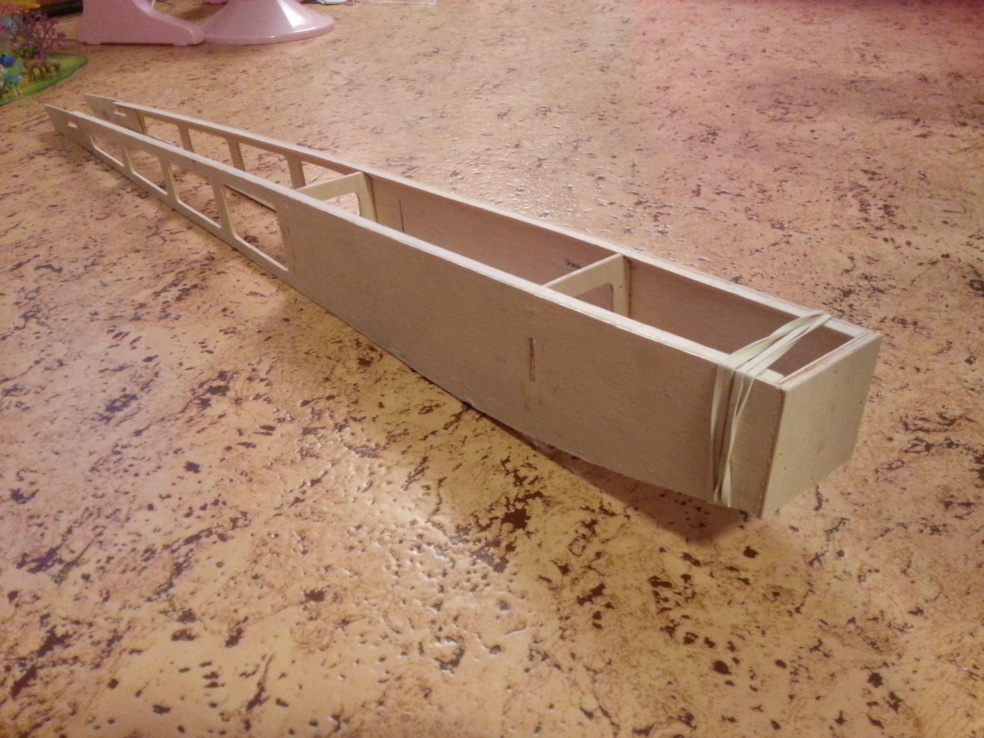

I joined the fuselage sides and glued the firewall in place today.

A question about the plywood fuselage bottom: Am I correct that I am NOT supposed to make any cutouts for the landing gear in the plywood plate? Should I just glue it in place as it is? (after beveling it to fit the firewall angle)
Old 12-22-2013 | 07:42 PM
  #558
rryman's Avatar
Posts: 986
From: Loris, SC
That is correct as I see it. The holes for the LG are in the sides of the fuselage, just above the ply plate in the bottom. Each LG leg is "threaded" through this hole, then sits inside the fuselage and is braced from the inside. At least that's the way mine is done, keeping in mind that I built mine in the late 70's, early 80's. They may have changed something since then. The last time I flew mine, I took the gear off, hand launched it and bellied it in for landings.

rryman,
thank you for clearing that up. The bottom of the fuselage is now sheeted, and I'm starting to think that this plane will fly after all. There's not too much work left to do, it's just getting around to do it...

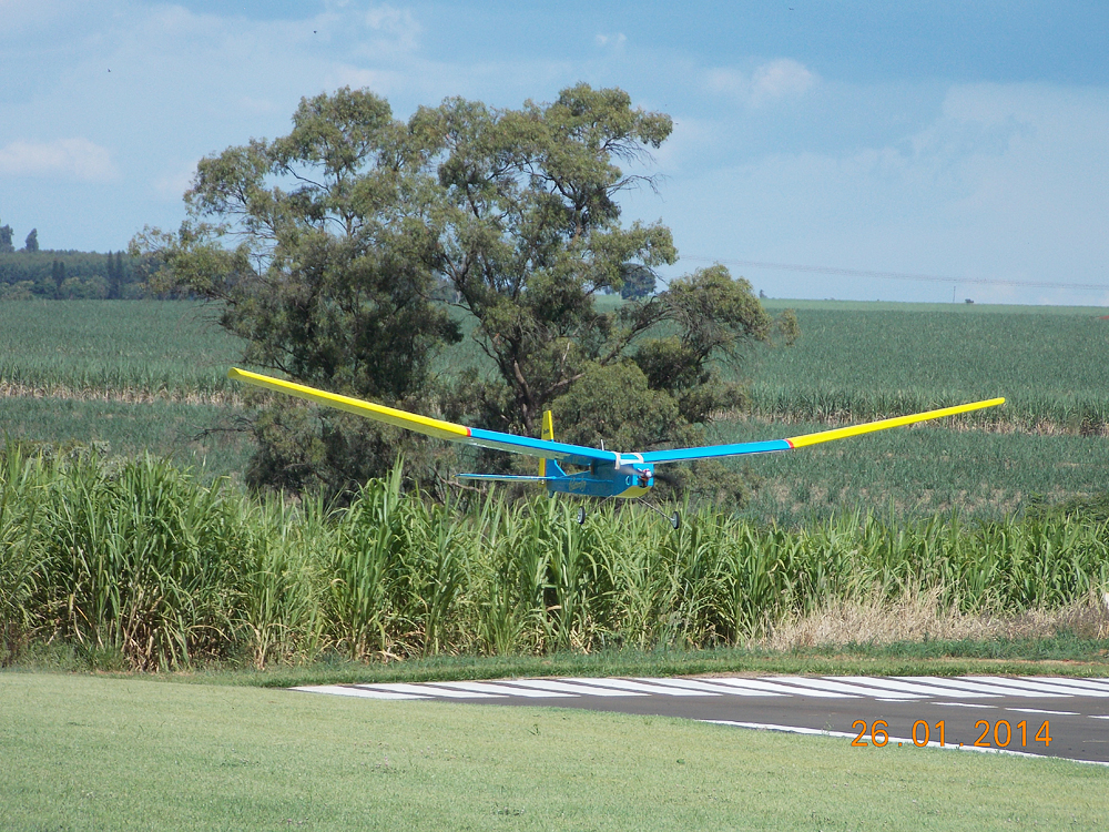

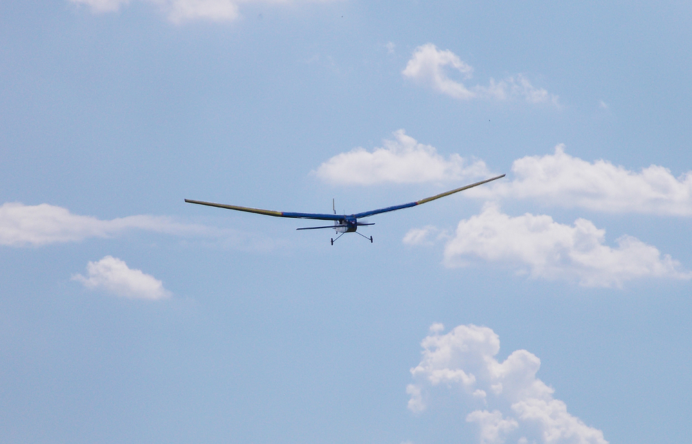

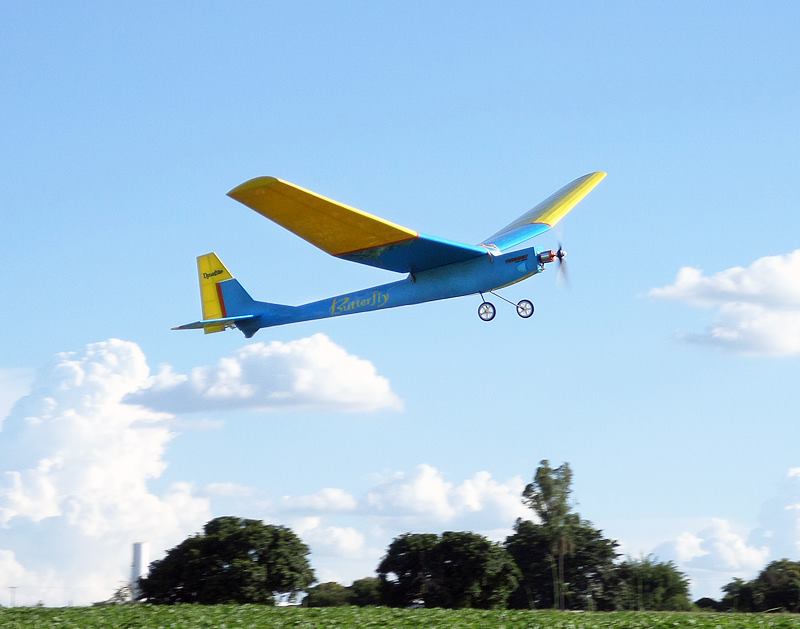

Here's the Butterfly I just recently built for my wife...
ID:	1964226   Click image for larger version
ID:	1964228   Click image for larger version
That is beautiful! I imagine with electric power, you can stay up a long time with a Butterfly.

Look's great Every one that has had one knows the pleasure it's giving .Great photosYours Paul T

Outstanding job on that Butterfly. Between the electric motor hanging out the front, and the super-light-weight spoked wheels, she really looks like she has no weight at all. Hope your wife likes it.

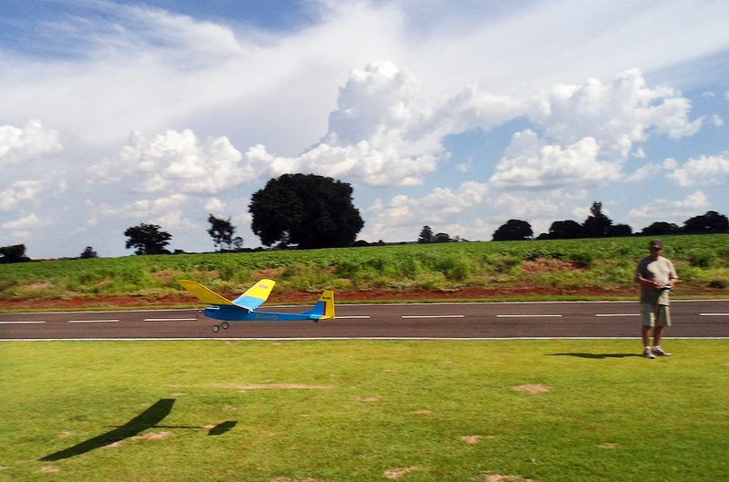

Nice flying site!!!

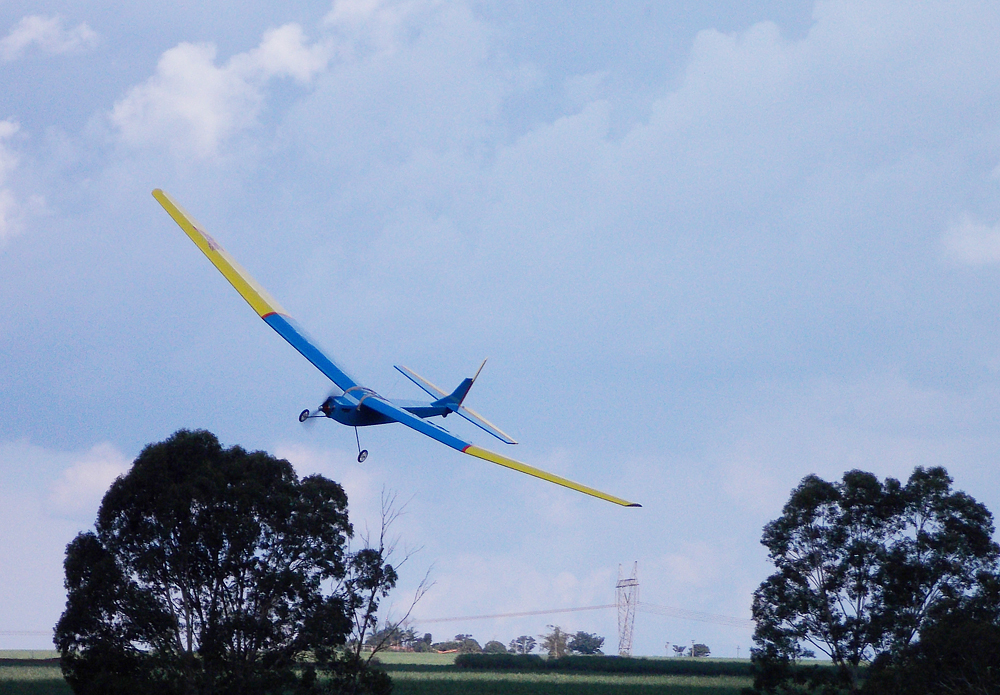

Thanks guys... here are a couple more... and yes, she loves it even though she only has only two flights on it so far...
ID:	1964470   Click image for larger version
ID:	1964471   Click image for larger version
