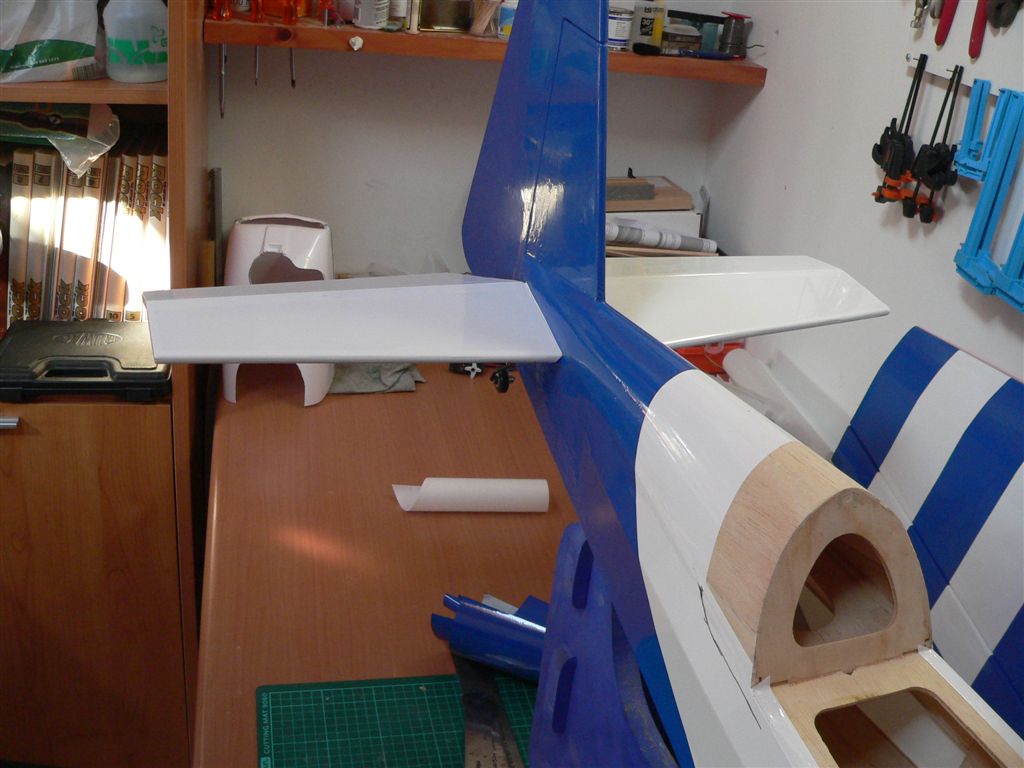

Hi All. I finished my wing today and ive got good help from this thread. Thanks to all.

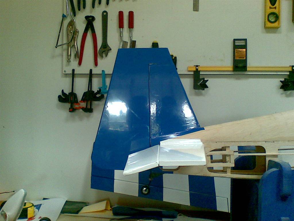

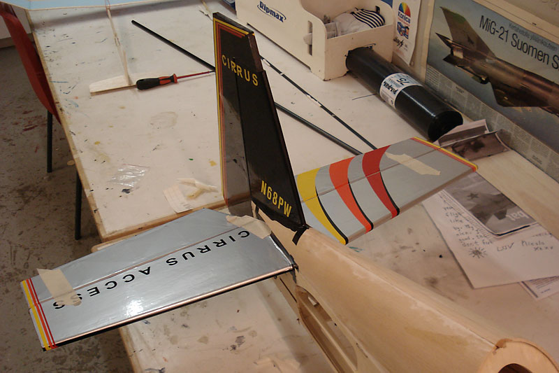

I've done the tail feathers, but rest of the fuse is tomorrow under my covering iron. I have my Saito FG-20 waiting, but no servos yet.
This is my first kit ever and i am learning all the time, as i'm building.
edit...errrr... what i've done with left elevator half ??? "#%#¤&% ! it shouldn't be black...nooooo!

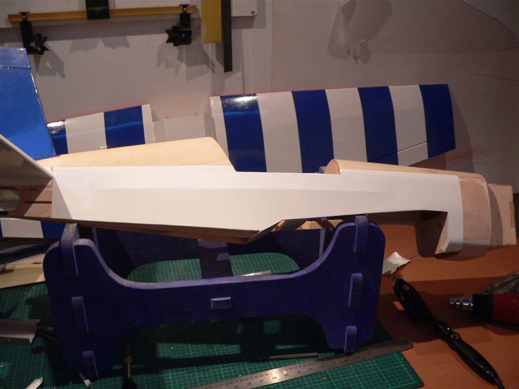

Still plodding along.
Fuel proofed the fuselage from the firewall back to the exposed sheeting and then from the rear of the firewall to the wing supports.
Also have the covering on the tail feathers and have attached the tailwheel and glued in the hinges and sealed the hinge gaps - such that they were!
Having difficulty with the covering the rest of the fuselage. I have added the "scale" side rails and therein lies the difficulty. As I have three different colours over the rail how do you edge join? I have tried to shrink the covering over the rail with an iron but this does not work very well and so use a heat gun - but to get a good shrink the colour to colour joint slips.
Considering taking of the rails but they do actually improve the look of the plane. Maybe change the colour scheme - already done the wing!!!.
Is there an easy(er) way to this?

Hey Andrew,
Nice scheme. Try putting a damp papet towel over the seem and use your heat gun. I like the looks with the fuse side rib too.
Good luck
Alan
Good luck
Alan
#260
Andrew,
Keep the side rail (stringers)! They will make a huge difference in the way it looks.
When I get there, I will also be adding the stringers. On a build like this I would cover the entire open framework of the fuse with white first. Bring the white covering all the way up the solid (sheet) material enough to incorporate the trim scheme and make sure I have at least a half inch of covering material overlapping the solid sheeting so it will adhere well enough not to pull off when shrinking the open framework. After the white is done then add the blue over the white and the red of coarse will over lap more in some places than others.
I hope that explanation makes since. I don’t have any pictures to show the process.
Good Luck, it is going to look sweet[8D]!

Hi Rick that is exactly what I have done - just didn't leave enough overlap. I will redo this evening and try a more conservative approach with the heat gun, also try the wet cloth on the seams although for the inner seams this is not really practical.

Here photo of the side wall of the fuz with the white added and shrunk to my satisfaction.
You can see how much the side rail enhances the appearance of the plane.
Thanks to all for their input.

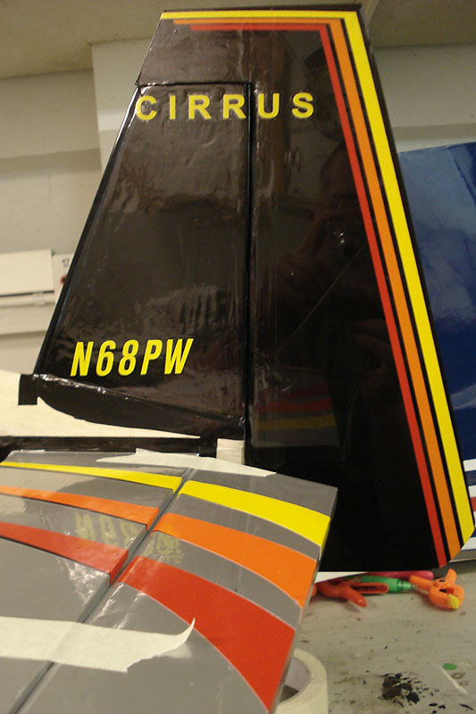

Finished the rear turtledeck - took two hours. First drew the outline of the blue trim profile on tracing paper then cut out a right and left hand version from the roll of covering. Lined up with the bottom corner of the rear of the wing saddle and slooooowly stuck down using a trim iron on low heat, adding as little pressure as possible so as not to stick the covering to the fuz frame and loose the hard fought tent shape over the side rail.
Now for the red.....
