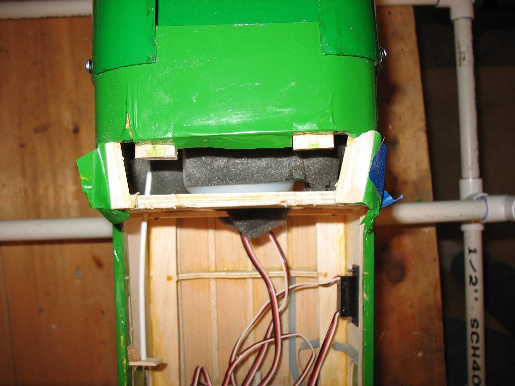

I had to put my Rx under the servo rails so I could move the tank in and out without a complete gut. It all depends on where you happened to mount the servo rails. Mine were fairly far back which helped; the tank can sit in there and then slide forward into the tank compartment.

The Du bro 16oz fits easily into the front compartment without having to remove servos or other anciliaries. The tank does touch both the firewall and therear former of the tank compartment though. But it goes in without stressing anything so all is good.

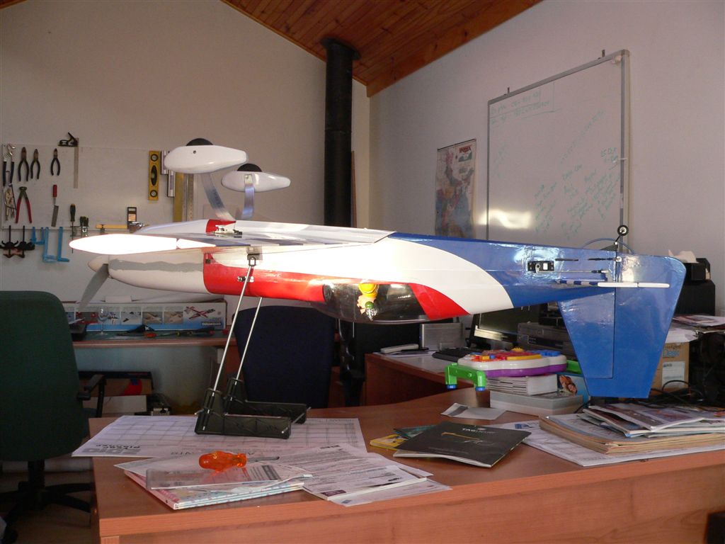

Pretty much finished now except for spraying the cowl and wheel spats. Fitted the remote glow and 16oz fuel tank. Glued on the canopy using canopy glue - this did not work as well as I would have liked as after applying the glue and taping down, then leaving overnight to dry the canopy was not seated all the way round as it had been before applying the glue. Some of the glue had also leaked out and made smudge marks down the fuselage. I popped off the canopy and removed the glue from the covering using laquer thinners. I was wary of using the thinners on the clear canopy and scrubbed using only warm water. The glue came off but the nice new looking canopy finish is gone [&o].
I have reattached the canopy using 18 servo screws and may or may not try the canipoy glue as well.
I rechecked the CG and adjusted to 4 1/8" from LE by positioned the battery just behind the fuel tank (photo).
AUW 3,850g (8.66lb).
Ready to break in the engine.[8D]
#283
Andrew,
First, C'mom now
, Show me a picture with it right side up settin on the wheels
You were right to keep the thinners away from the canopy. Chances are they would have killed it. Especially lacquer thinner.
My luck with the so called canopy glue has been the same as yours. I once used it to glue in flat panel side windows on a 40 size Super Decathlon. The next day, all I had to do was thump them, and they popped right off[X(]. There is obviously something that I am not getting right. Reverted to CA. That stuff will ruin a canopy too. If you trap the fumes it will fog the inside of the canopy.
Anyway, upside down or not it is looking good. Did it balance where you wanted it? What will you use for paint. If you have already told us.....Sorry[:-] Oh, one more question, do you recall the weight of your engine?

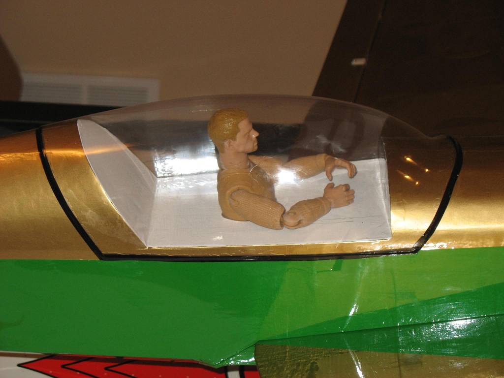

My pilot was too "tall". In fact, I had to perform a "Hemicorporectomy" (cut off at the stomach area). So I positioned where the height of the canopy was at a maximum. This gave the most head clearance so I did not have to cut so much off that it would not look right. This was a "modified" GJ Joe.
..besides, his arms have to be able to reach the instrument panel, otherwise I might crash

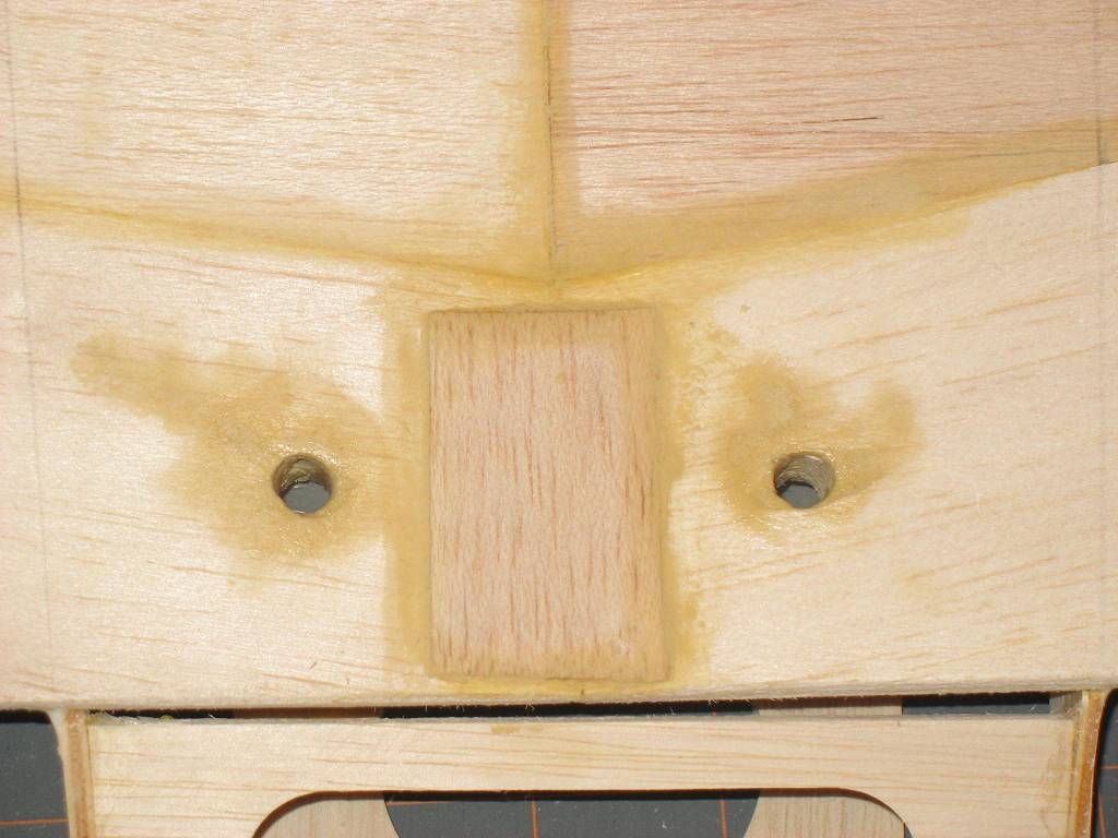

Hey guys...need some repair help.
Background: I tried nylon bolts (#8) but on a greased landing, as soon as wheels hit the grass, the gear was toren off. I went back to #8 bolts.
This week-end, I would not really call it a landing, it was hard and off the runway into the heavy brush but here is what I am left with. I suppose using the blind nuts weaken the ply a bit but I did not like the idea of the woods screws provided in the kit...
Anyway, I do not want to tear out the the firewall sheeting ply and whole under belly to replace the entire rail....alternatives?
#297
I thought about a few different approaches but settled on this:
Made some 1/4" ply from 1/8" ply by laminating (one side at 90 deg) with gorilla glue and clamps.
Glued a 1/4" ply strip under the existing rail (it did not go all the back to the next former).
Glued in a stub 1/4" piece on top.
Glued a 1/8" ply on the side over the joint for strength in the vertical.
I put the blind nuts only on the stub piece and cut the bolts so they only went that far. That way, there was full strength on the bottom rail.
Some photos on the steps...
In the same "landing" the wing tore off the fuse too. I was surprised the nylon bolts did not break but instead the mounting plate tore out (I had epoxied that too). There is not a lot of strength on the fuse sides where the wing bolt plate mounts. Anyway, that just glued right back in. A bit of covering on the wing to fix too.
Back in the saddle.
(PS I have only had this one out twice and both times parts came back in the bag and I spent the next few days fixing...not to mention the ribbing from the wife and kids about "crashes".)
Back in the saddle.

I tried to add tri-stock but it was hard to get at now it is covered.
By gap, I assume you mean between the wing and the wing mounting plate. I added some balsa on the wing because I was worried about stress on the wing from the bolts (wings dihedral meant it was not flat on the plate).
