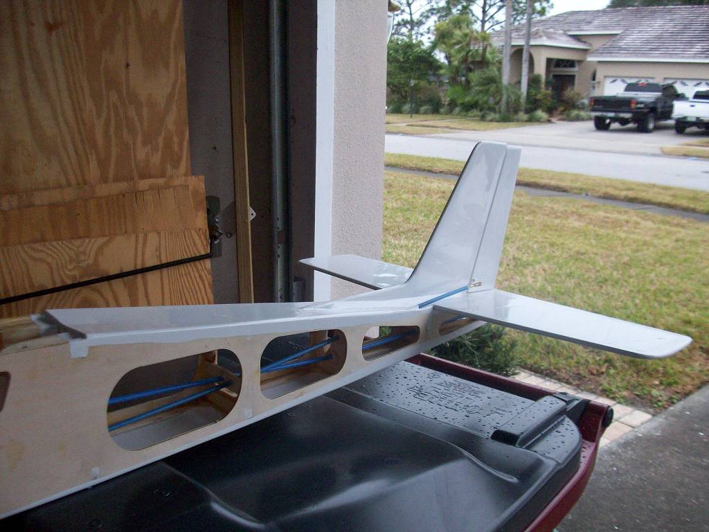

I'm back agian... and started covering. Since it's been a little bit.. i realized I hadn't done much with the front windshield when I startd the fuse. I decieded to pass on the plastic windows and fill them in with some balsa and make a windscreen from balsa up front. I did run the two pushrods to the rear permanently and covered the top and bottom The tail and all pieces are covered and just need to be hinged permanently. I started covering the wing and since my building area is a bit small (on the honey do list to clean up!) I thought I would try something different. I tacked the covering in place and then hung the wing on end. This worked out pretty I thought as it was like having an extra hand. I was able to access any part i needed while sill having good control over the iron. The top is covered and needs the edges ironed down final shrinking. Well the glue should be dry on the formers for the windscreen so I'm going to see about some lite sheeting. I'll post some pics this evening.

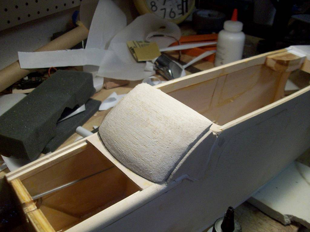

Is there a problem with the plastic windows they supply or are you guy's just filling in the voids to make it stronger? I've had 3 eagleII's and none of them ever broke or failed because of the plastic windows in the side of the fuse.
Old 01-30-2010 | 07:32 PM
  #104
Joined: May 2009
Posts: 41
From: Castle Rock, WA
Default RE: Build thread for a Carl Goldberg Eagle II Trainer??
ORIGINAL: planebuilder66
A little bit of both.
Not so much due to a weak trainer design, just makes it easier to manhandle while working on it for me. Personally I think they should revise the plans and delete the pastic side windows and front screen, or maybe have a option, for those who would rather choose to have the see-thru's. Would make a nice new selling point for a already proven trainer.

I filled in the windows with some balsa and titebond II. I made up a front windshield from a balsa block. Pearl Crafts was going out of business in Tampa and all there wood was over 50% off. single and bags of blocks... bags of sticks, etc so i bought a few. The front window needs some final shaping / sanding but its smoother than the pic looks. You don't really feel where the diff pieces meet up. Need to cover the bottom of the wing, and add some color, stripes, etc, mount the motor and radio and it's done.
This wing has a farily sharp leading edge which I thought oes not do well in regard to stalls. The more blunt the more stall resistant. So it's odd that a thin leading edge would be on a trainer??

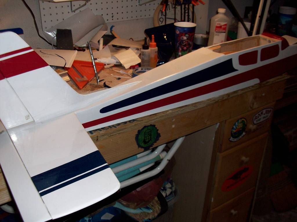

Here is some progress on the covering. it's not my strong suit but it's coming out ok. I need to put the stripes on the elevator and do the bottom of the wing. I think I'm going to bring down the red on the front window so it better lines up with the side windows. Rudder and elevator need permanent hinging still. If the weather cooperates, I'm hoping to take it up next weekend. It's been very very windy or rainy here.. much more so than usual.
I ended up doing something diff on the color scheme as I thought this was easier for me to do.
I was reading some hints and tips from my 95 RCM. What someone did was cover the fuser in white monokote as well as the window openings. They then took some acetone on the paper towel and wiped off the color and andhesive on the back side of the windo cutout. They were left with a clear "window" of monokote. They outlined the window with some black pin striping. Has anyone tried this as a way to make clean / neat windows.

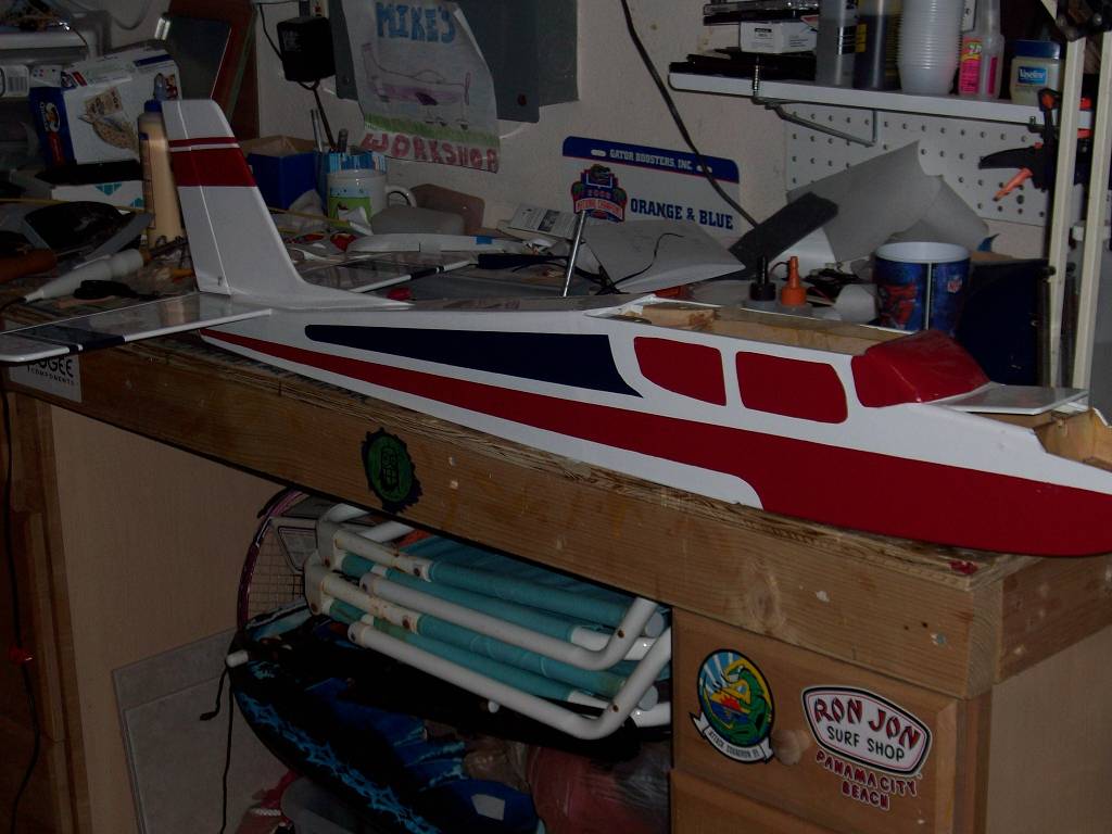

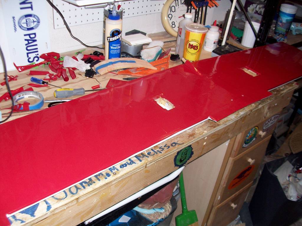

Here's some pics of all the covering. I ran out of red and just left the top center sort of the way it is. I was hoping to fill in the center with a radius at the leading edge like the tips. Need to permanently install hinges, servos, etc,motor and get all the throws correct. I don't have EPA so it's a bit of work especially on the throtle to get it "just" right. I am hoping for a first flight on Sunday afternoon but still lots to do. It always seems like the final pieces and getting everything in working order are as much work as building the kit.
