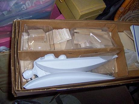

We'll see... . I plan on cleaning off the bench tonight and taking some pics of what's in the box and start laying out the wing.

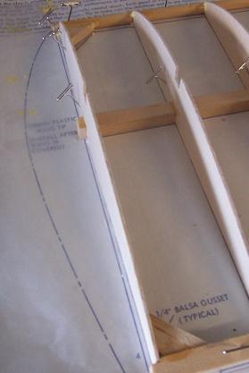

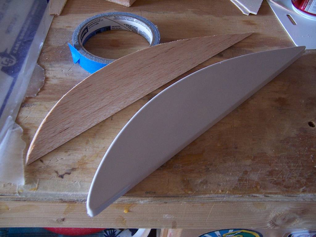

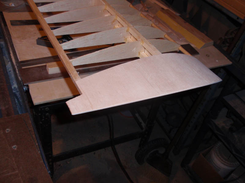

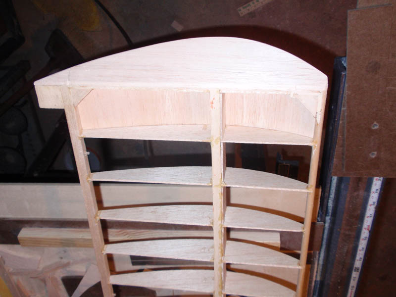

Here are some pics of how I did the wingtips. I'll try to find the ones of the finished plane.
The angled end piece is 1/4", the top sheeting is 1/32, it lays on top of the last 2 ribs. There are a couple of braces inside the tip.

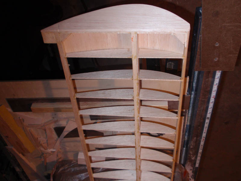

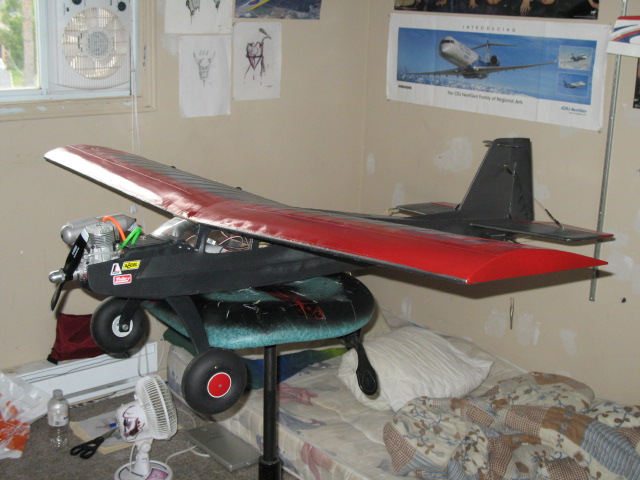

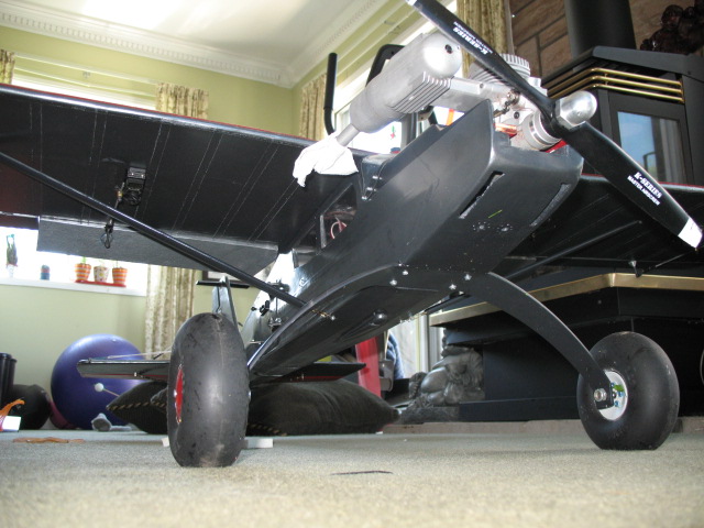

i love the eagle i would defenently go with the bolt on wings. heres some pics of one of my eagles. i have a build going on check it out under eagle 2 mods
Mr. E - I like the bush plane effect with the struts and those huge wheels..
Crossman..- nice job on the wing tips.. I was going with solid balsa hollowed out but built up would be a lot easier as you have done. I checked out the eagle mods thread.. lots of changes.. i didnt relaize it wasnt sheeted.. I will probably do the same from the LE to the spar.
My 1/4 x/14 bass for the main spars each had a slight bow so I'm in the process of correcting that with some clamps and a lil water. I'll get going in earnest tonight on the wings nd post pics. Homecoming football game tonight and need to chaperone my daughter and her friends at the football game so I'll be posting later on. I can't wait to start building! Love it as much as flying.

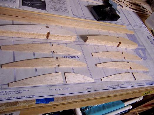

The manual in this kit is very comprehensive. It covers everything from selecting radio equipment, field equipment, how to read the plan, a primer on adhesives and gluing techniques, pinning
techniques and trimming and flying complete with diagrams. Simple jigs are included (to be built by the modeler with included parts) for getting the V shapes in elevators, and ailerons. There are even clamps die cut in the scrap ply if you wish to use them. The manual has comprehensive pictures with each step. It's 60 pages for a basic trainer build! They don't make manuals like this anymore. [

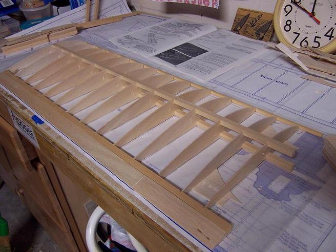

I thought I would start with the wing because I usually never do as I don't like building them.
The wing allows for 3 versions. A 3 channel (non-aileron) large dihedral version, a 4 channel less dihedral version and another 4 channel almost no dihedral version for "increased stunting ability". Each has its own corresponding dihedral gauge. I am building the last version
as I hipe this will be a nice fun fly plane.
The Trailing edge is notched balsa to accept the rib, there are two spars of 1/4 x /1/4 bass and the leading edge is hardwood dowel with the fronts of the ribs scalloped to accept the dowel. It's very straightforward construction and the instructions are very clear on how to proceed. Something I learned long ago was to verify the sheer webs (balsa rectangles between the ribs that attach to spar) were square and of proper size per plan. I use these to verify the rib is perpendicular to my board and to assist in rib spacing by checking rib locations against the plan. I found if you assemble all the ribs and then install the shear webs you end up having to modify every web to make it fit since ribs will not be perpendicualr or spaced exactly. Saves a lot of time.
The plans show a double rib on the wing tip to prevent it from bowing inward when you apply covering. I chose to go with a single rib as I plan to use balsa tip blocks instead of the more flimsy plastic wing tips which would have required the double end rib.
I build with yellow wood glue and expoxy. Something new I tried was a tip I saw on one of the boards and that is to use syringes to apply the yellow wood glue and it worked great. I just use those that we get from the drugstore to give liquid medicines when the kids get sick. Makes it easy to control and apply nice clean fillets. You can buy better ones with all kinds of applicator tips online.
I sanded all ther ribs, shear webs, and laid the wing out. It was then I realized I didn't have any pins! [:@]. So I'll pick some up tomorrow.
Pics show progress so far. I'll try not to be so wordy going forward!

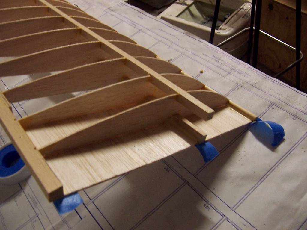

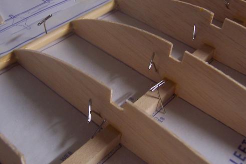

With pins in hand I began assembling the wing. The wing tip has a gusset front and back on the last rib. The instructions did not mention but I recessed the front to better conform to the leading edge dowel. Just wrap a piece of finer grit paper around the dowel and run the balsa gusset back and forth a couple times for a good fit. At the root edge, the balsa placed under the first two ribs keeps them level as they are smaller in width along the entire ribto accept the center sheeting top and bottom. There are two lite ply pieces that fit between the third rib and the trailing edge. not sure what these are for but I have not been able to find them in the kit. The third rib is short by the width of the ply so i just made one. When dry I'll add the top spar. I could do that now but the fits are tight wihch is nice and I don't want to disturb the alignments. In cases like this one could go on to other part.. tail, etc while your waiting. I just realized I forgot to make holes in the ribs to run the servo wire. I'll cut them next and in the next set of ribs before I forget[
The pics show wingtip stock running a bit long. I like to sand back to the plan line to get everything nice perpendicular at the wing tips when it's ready. The wingtip pic shows the end rib short of the plan line b/c I only used one. It also shows not being lined correclty with a slight bow in the middle which I corrected. I'm still not sure why the pics are posting large so I'm re-sizing them in MS Paint.
].The pics show wingtip stock running a bit long. I like to sand back to the plan line to get everything nice perpendicular at the wing tips when it's ready. The wingtip pic shows the end rib short of the plan line b/c I only used one. It also shows not being lined correclty with a slight bow in the middle which I corrected. I'm still not sure why the pics are posting large so I'm re-sizing them in MS Paint.

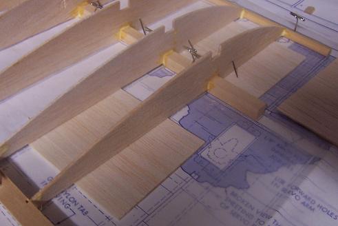

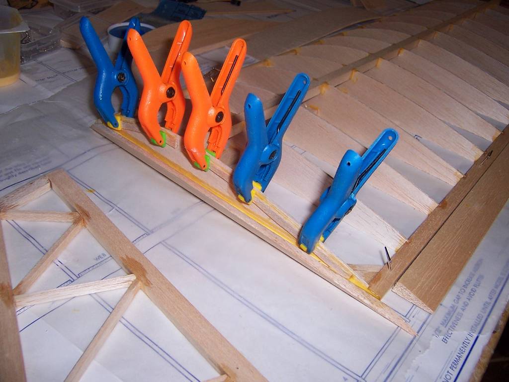

Today I added the top spar and bottom center section sheeting to the left wing panel. The painters tape is stop any glue from leaking out of the joint keeping the fillet in place. I also began making up a wingtip from balsa shee and aileron stock. The angle at the bottom is to mate with the bottom of the rib while keeping the upward angle. The balsa sheet with the scores running across was needed to allow the the sheet to form more easily ove the curve. The scores will be on the bottom side and not seen. I am planning to put some bulkhead type braces inside.. I will post pics of this as it gets made. The wing is angled on the leading and trailing edges to allow the glue to set up against the spar and leading or trailing edge where the sheeting mates up. I also put the vertical stab together and did some rough shaping on it. The front and top need some rounding over.

As far as bracing I put small blocks at the LE and TE (about an inch or so wide) and a 1/4" brace at the spar. I guess I should have taken a pic before I covered it all up.

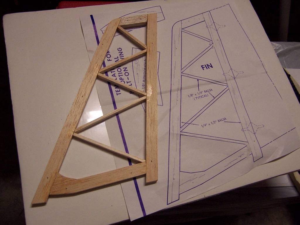

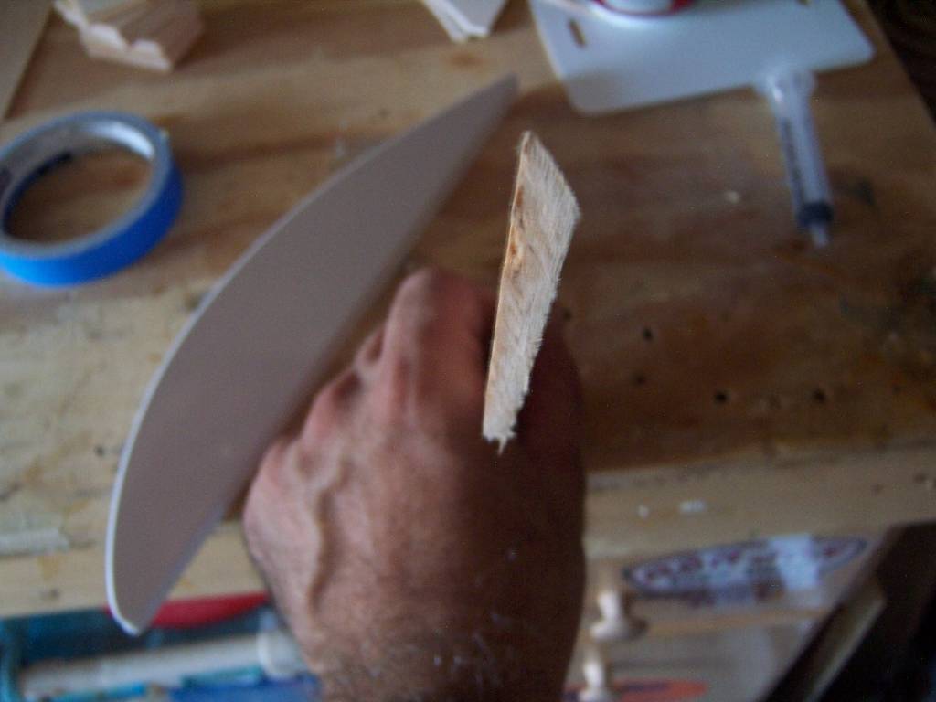

Got some more done tonight. Created the built up wing tip though since i usually shape balsa block or shape from laminated pieces I'm not sure how it will come out until I remove the wing from the board. I placed a thin doubler just below the rib outline the spacing equal to the thickness of the sheet balsa. I added a couple cross pieces for support as well. I finish shanded the vertical stab rounding over the leading and top edges and also started the horizontal stab. The three center pieces and tips were die cut for me.
Mr E. - Form the pics it looks you sheeted your leading edge. Is that correct? I have a feeling the wing will be a bit twisty w/out some thin sheeting up front.
Crossman - It looks like you did not... did you notice a tendency to twist?
