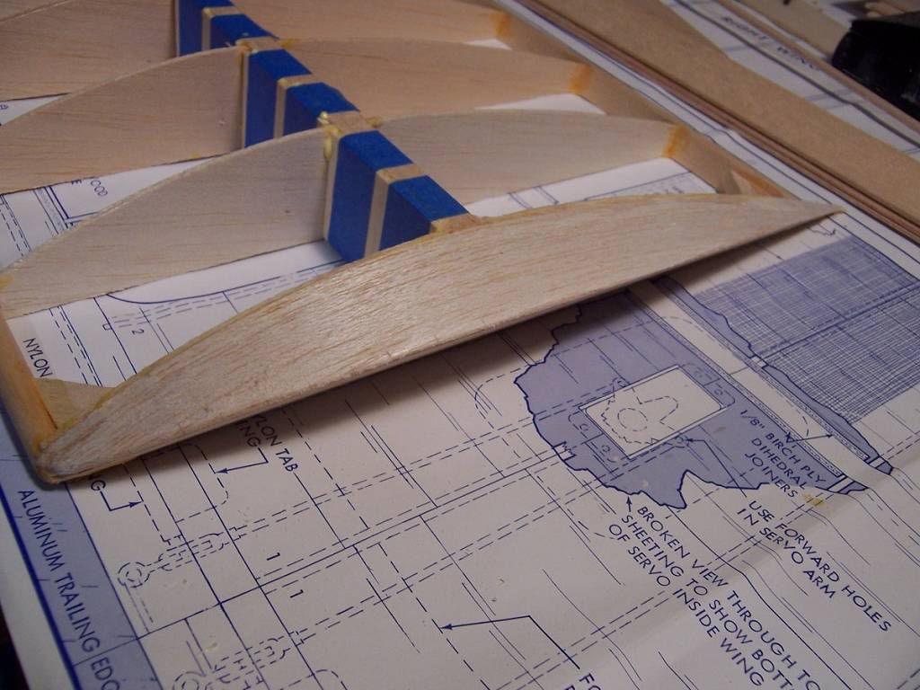

I pretty much built the wing according to the instruction (no sheeting on the LE). Any twisting that I found I was able to correct with the covering iron.
#27
Crossman.. thanks.... By twisitng I meant a weakness lengthwise as if you grabbed the root and tip and twisted. I was thinking of putting some sheeting up there but I'll pass to move the build along since it's a very well tested design..

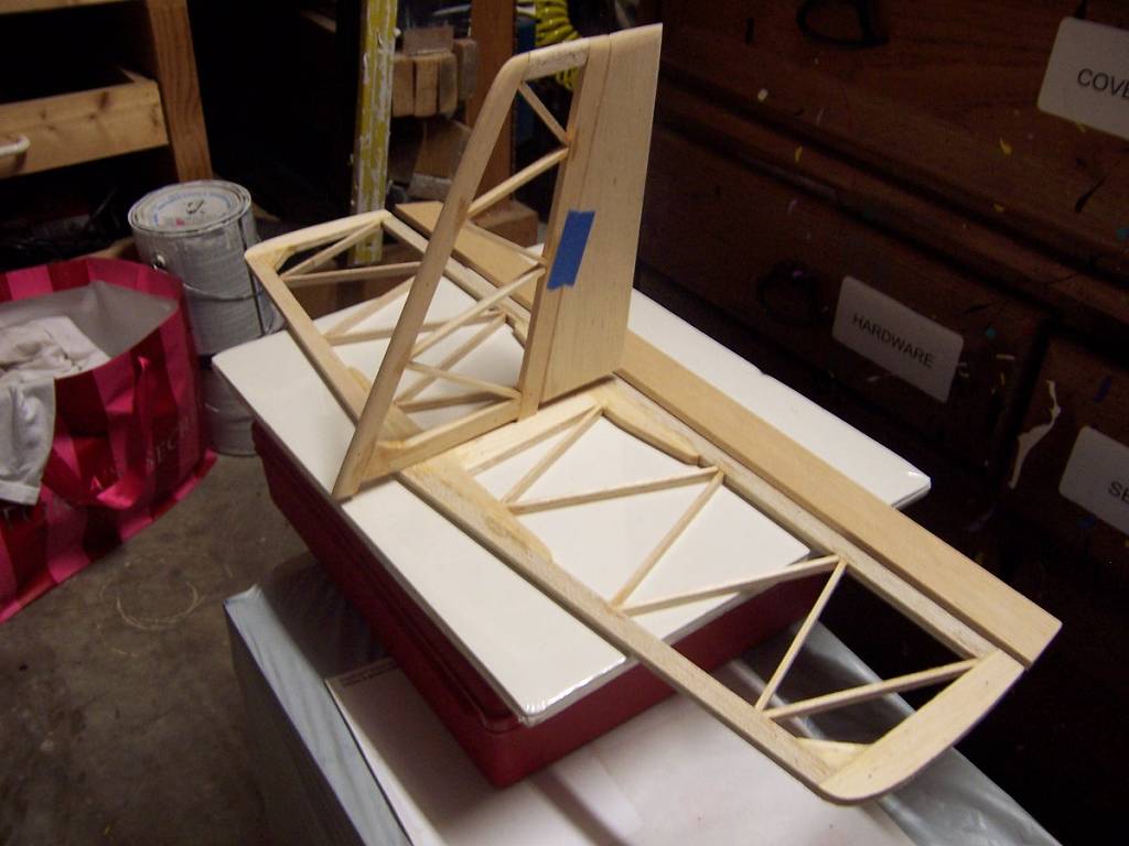

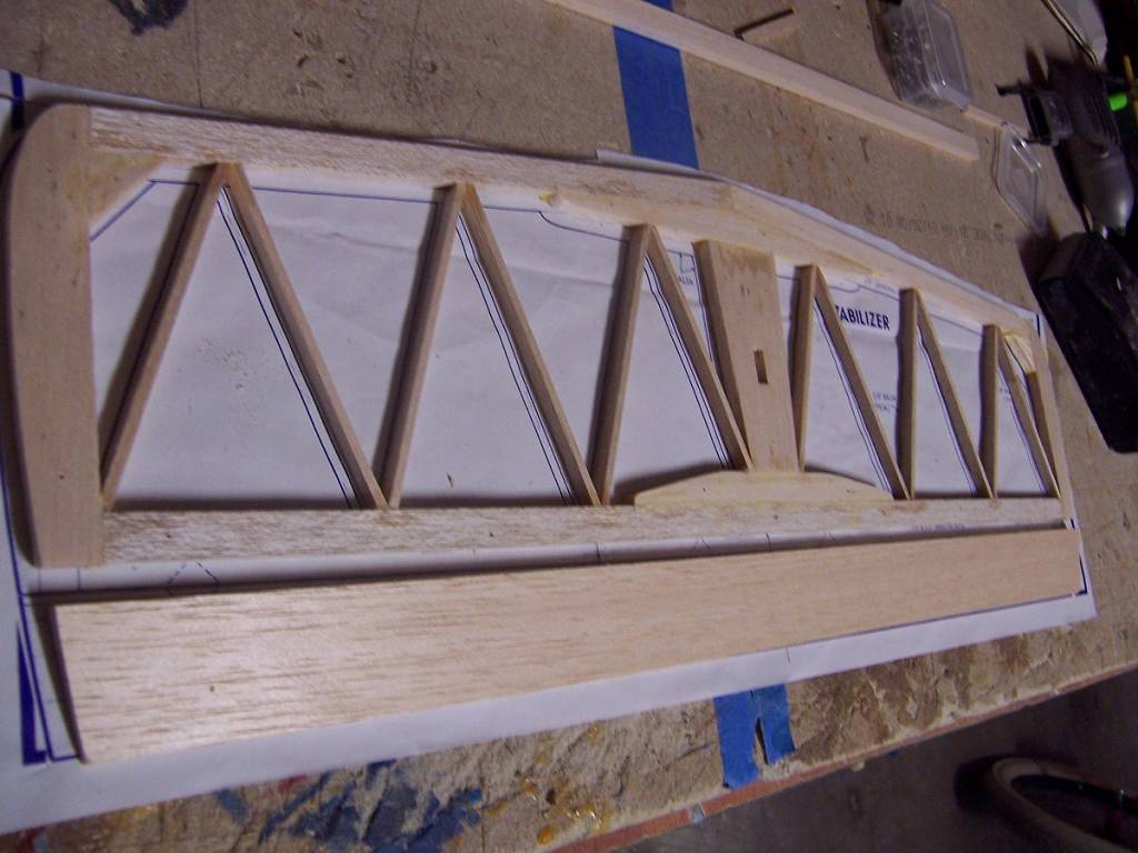

I made more progress. The horizontal stab is complete with initial sanding. I need to round over the leading edge and streamline the tips and ends of the elevator. I sanded the V in the leading egde of the rudder and rounded over the top. On the wing, I added all the shear webs doing the backside which go out until the 5th bay. I let those dry and then did the front side which run the entire length of the wing. I stood the wing on it's leading or trailing edge depending on the webs added to be sure the glue would not run and remain in that web / spar joint. I used blue painters tape to hold them tight to the spars as it comes off easily but sticks well. The clamps on the end held one side with tape on the other due to the sheeting being in the way. The wing tip came out real nice. This seems like a very light wing as wings go. Should make for nice performance.
I was studying the manual and I think I'm going with the bolt on option. I've done this enough to know where I need to add strength above and beyond what they show in the addendums. For instance, they have the dowel just butt jointing into the bottom spar. I plan to angle the dowel a bit more and let it be captured / expoxied into a hole in the ply dihedral brace. I also will add another brace farther down the dowel by the leading edge for add'l support. Then pick up with the instructions again and sandwhich the whole shebang between ply ribs. I will add additoinal doublers in the frontal area of the cabin as well. It looks like I can add all this after the basic fuse is built so I will point out what I am doing that is extra.

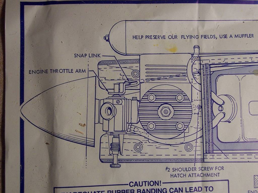

I was thinking more about the engine mounting on the drive home today. I realized I cannot rotate the engine 90 degrees as i did wth say my 4 star. 40 (RIP [&o] ) taildragger as the nose gear will be in the way of the muffler. So I'm still going to rotate the engine maybe 75 degrees or so. I will need to do some trial and error ands see how close I can get the muffler to gear w/out it interfering.

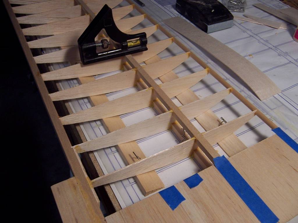

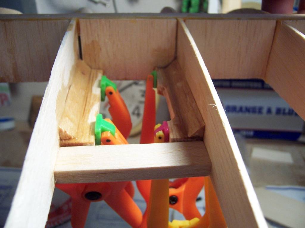

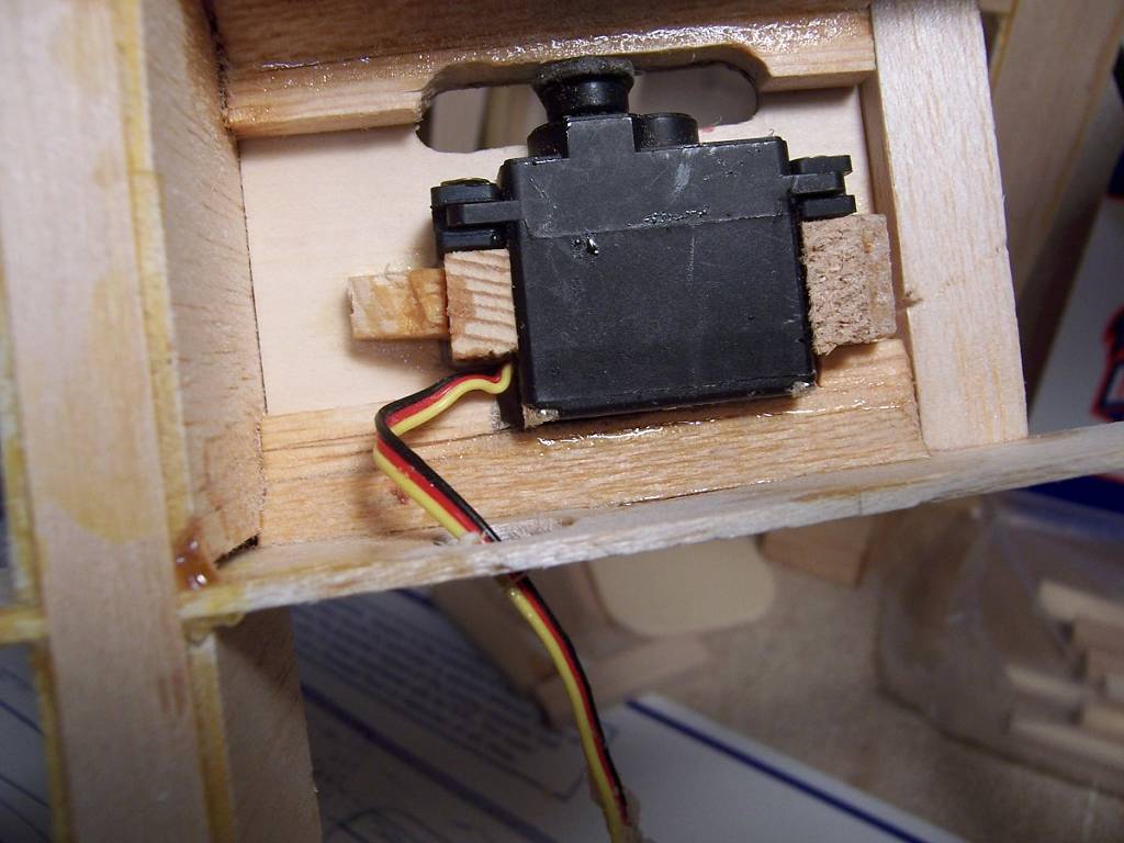

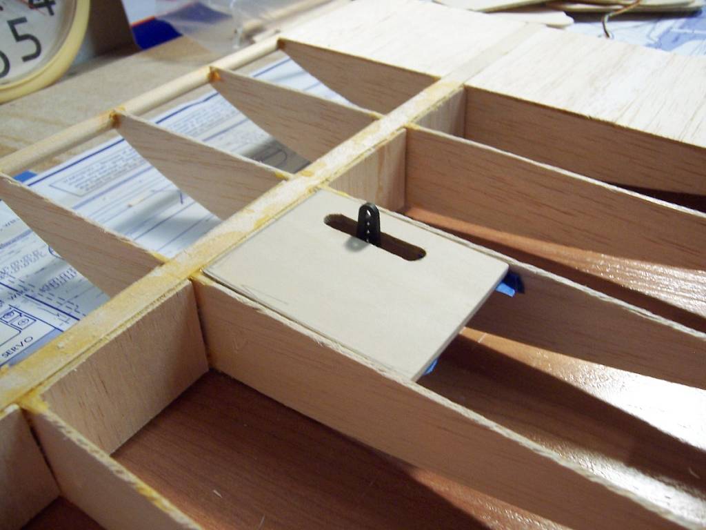

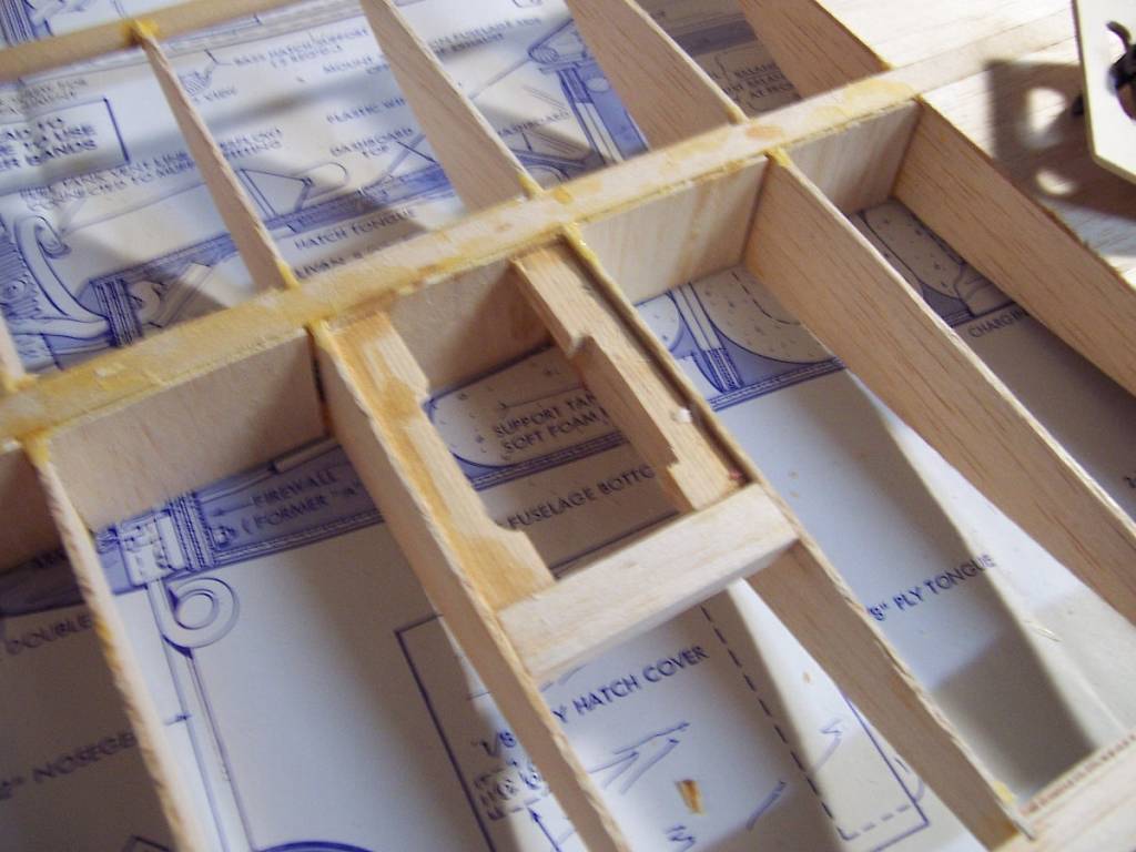

The wing servos are completed on both panels. I'm going to work readying the panels to be joined tonight, being sure all the conact points meet and have the proper bevel for the required dihedral and being sure the leading / trailing edges are in a straight line with each other. Instructions state the least dihedral option is 2 and 1/4 inches when propping up one tip meaning 1 and 1/8" for each top from horizontal.
Pics show the opposite hardwood rail relieved to accept the bottom of the servo. The servo is screwed in place into the hardwood blocks epoxied to the hatch floor and the hatch itself and rails have holes drilled and screws in place. I mentioned in an earlier post to drill holes in the ribs before assy' and i forgot to do it on both panels. No biggie.. just easier before they're iin place. I used a forstner bit to get a nice clean hole. My girls put the halloween costume (tinkerbell) on Lana, tha family furball and asked that I post her too

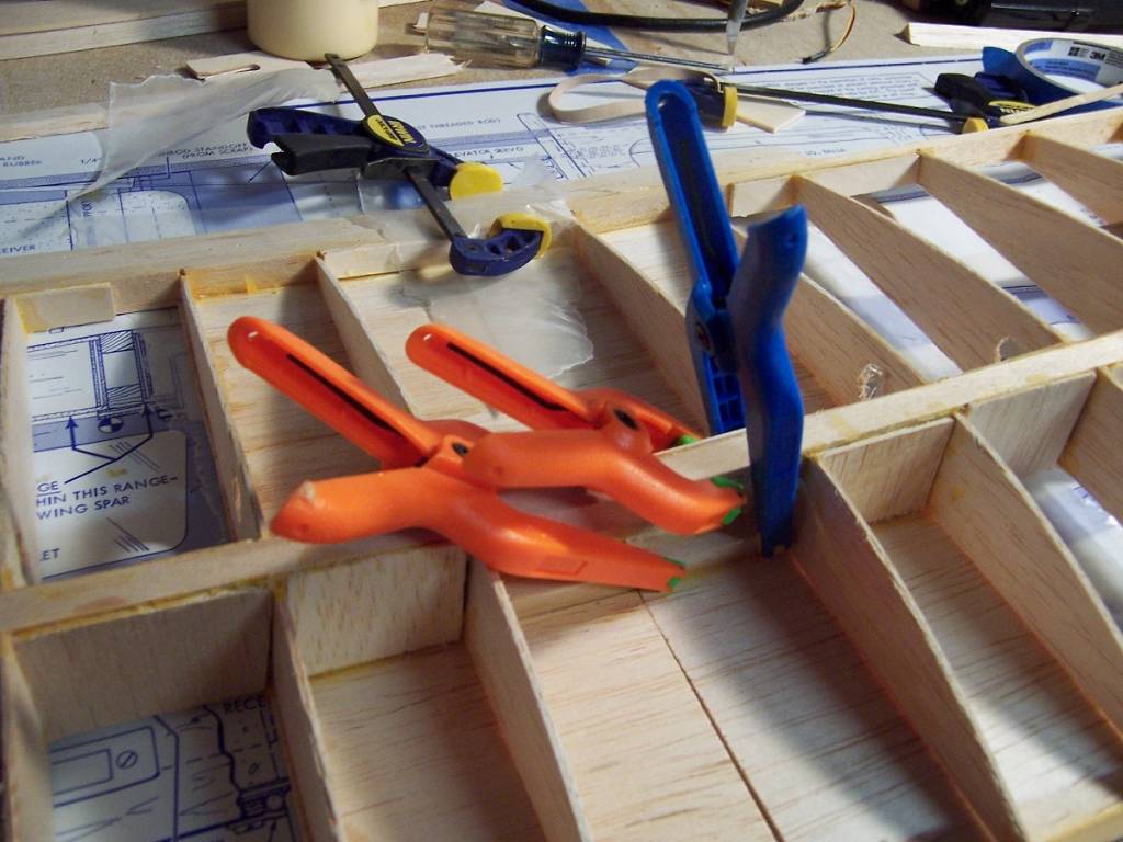

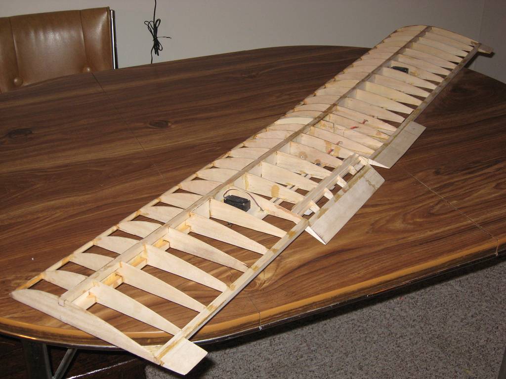

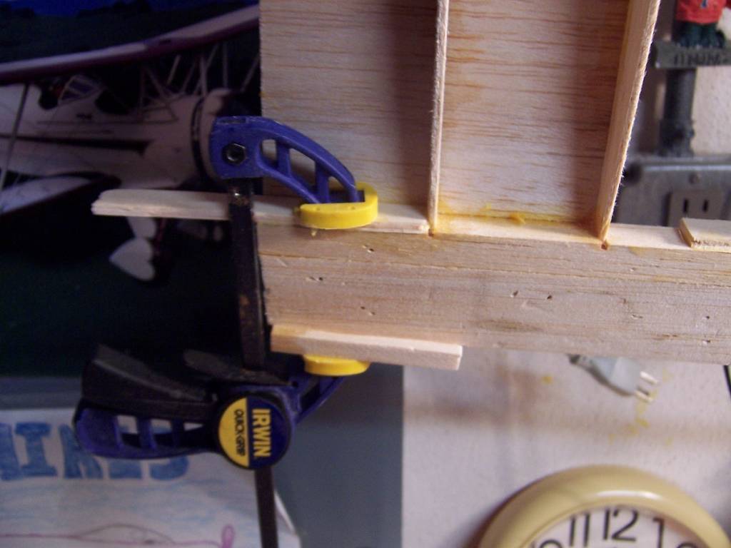

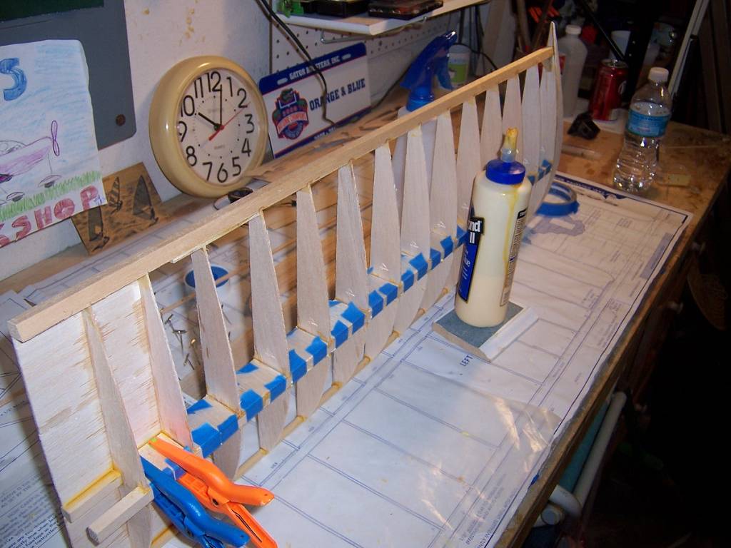

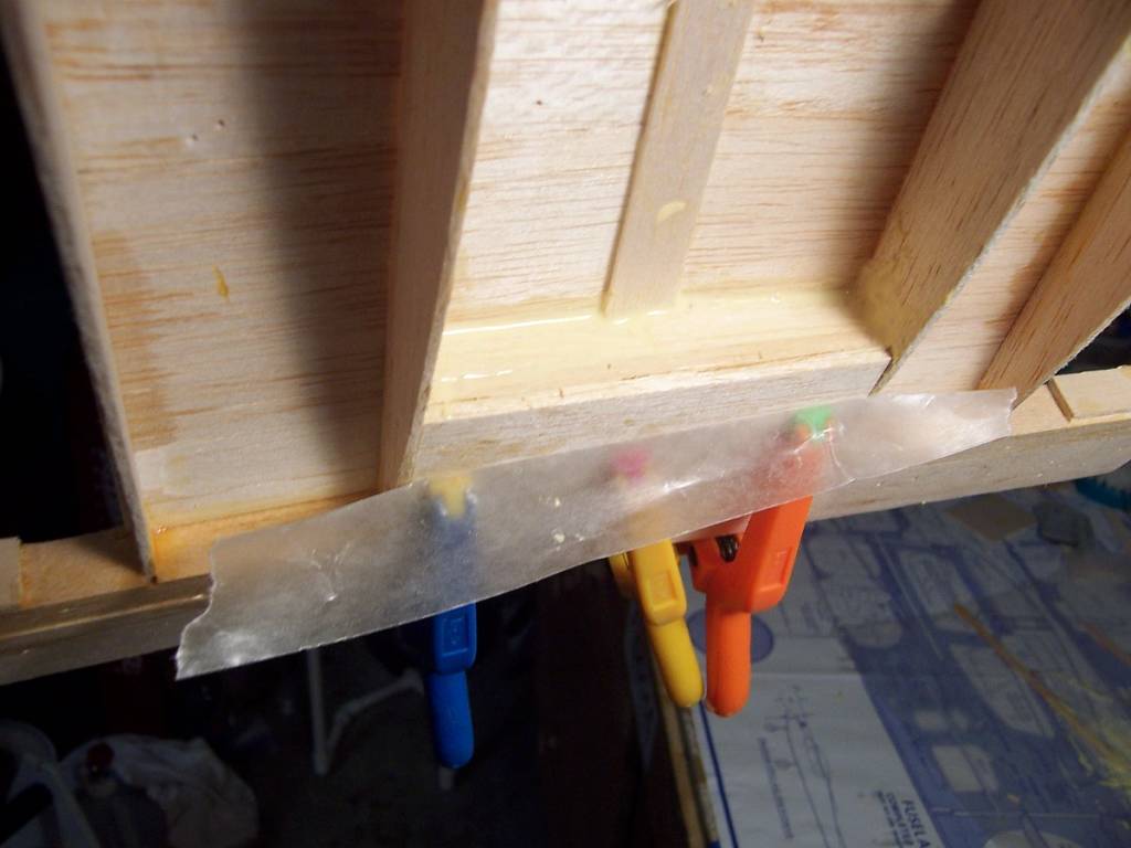

I started the wing joining process. I prefer to take it slow doing one joiner at a time. If nothing else it allows me to get a good fillet on that one joiner since the other is not in place and I have access inside. I also added a ply brace not in the instructions to the trailing edge area to help stiffen that connection. When thiis is dry i will add the dihedral brace to the other side of the main spars and balsa block to the trailing edge for the rear bolts. I'm going to leave the top sheeting off from the main spar forward for now so I have access to install / fit the dowel once the fuselage is completed.
I read the instructions for the fuse and it should go together real quick since it's all ply sheet sides, top and bottom with alignment tabs and lightening holes.
Pic1 is adding the rear brace. The balsa block at the rear is grooved and just for protection so I didn't crush the rear trailing edge with the clamp. Pic2 is adding the main dihedral brace to one side. Pic3 is joining the two wings, Pic4 is creating the fillet on the one dihedral brace. The fillet is shown not fully running the lenght but I fixed that as well as the gaps between the main spars.
This is the first wing I have built where the shear webs did not butt against each rib tightly and I thoiguht this strange but that's how it is on the plans.

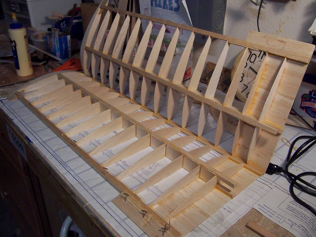

I was thinking about it but oh well.. I went with the design... tThat looks like a nice covering job on the striping . On the strips.. do you cut those yourself or are they precut pieces?
The wings are bascially now joined. The maine dihedral braces are in place and I added some rear balsa block at the trailing edge for the bolts. I used some trailing edge stock I had and laminated a few pieces together to make the "fll" needed. I put a balsa strip lengthwise over the balsa sheeting where it butts together in the center. I will sheet the rear top this weekend.

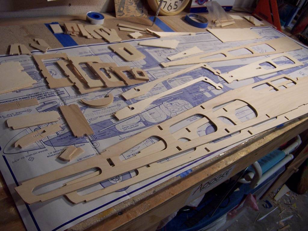

I cut them all. This kit was given to me and I did not what to build another trainer so did it a little differently.
#40

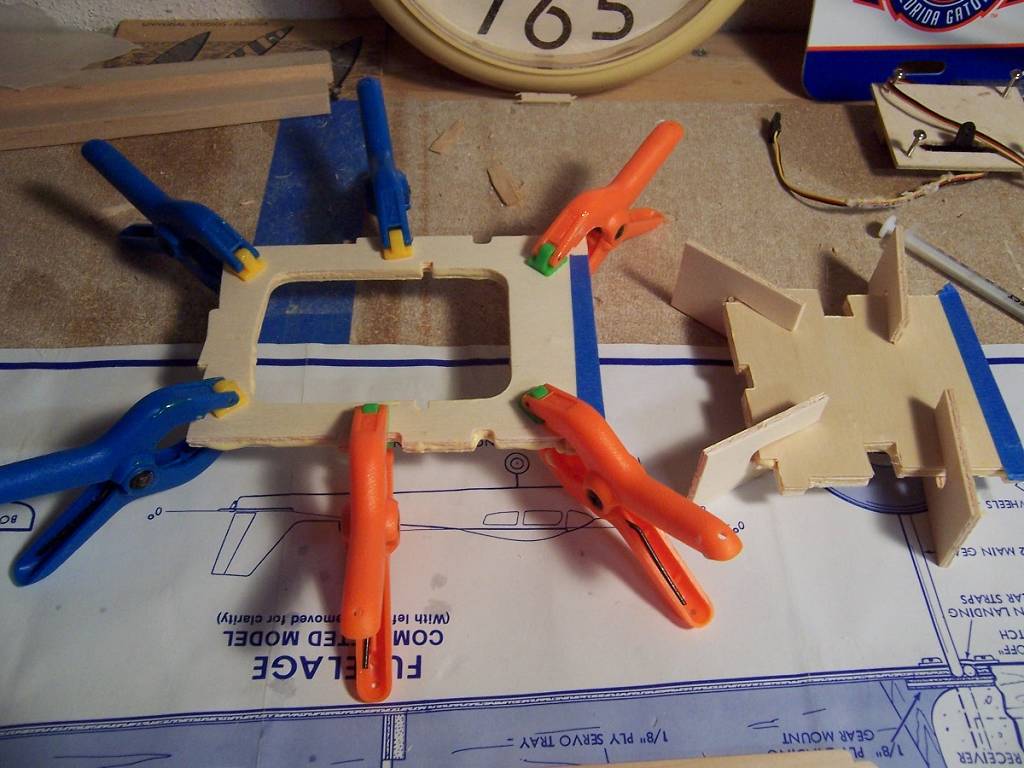

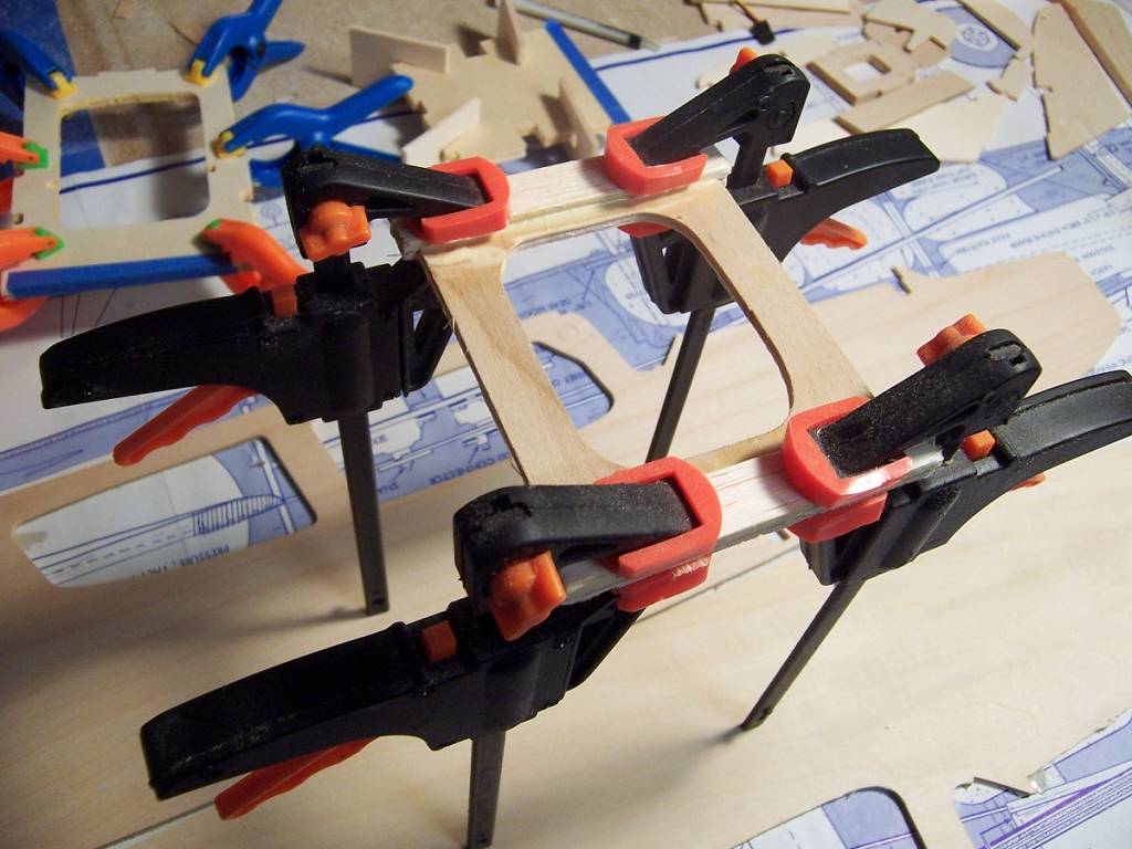

I finished the remaining former and pieced the fusealage together with all the pieces loose fit and rubber banded per the instructions. I was not wanting to remove the diecut dowel holes but having the wing hold down dowels in place helped aling the wing saddle doubler more precisely so I'll close them up later. Eerything fit nicely. I'm still deciding if I want to take this route of glueing while it's all together as the instructions state. Most construction is adding formers to one side then adding the other side to it. This has its challenges because while the front and rear formers under the leading and trailing edge are usualy 90 degress to the fuse, the farther aft you go, the farther from 90 degree the remaining formers (3) are (depending on which side of the former your going off of). This angle can be duplicated by looking at the top view of the plan so I'm going to sleep on it. [sm=confused.gif]. I just feel a better joint can be obtained by adding formers to one side, then adding the other side as things will be less likely to shift around and fillets can be better applied
#41
This brings back fond memories! My first plane was an Eagle 2 (Actually an Eagle 63) and the construction photos look so familiar! My Dad actually build this plane for me, as everything I touched I screwed up hahaha. Our second plane was an actual Eagle 2, and I still have it (over 20 years old now!). I recently recovered it when Dad decided to start flying again
#42

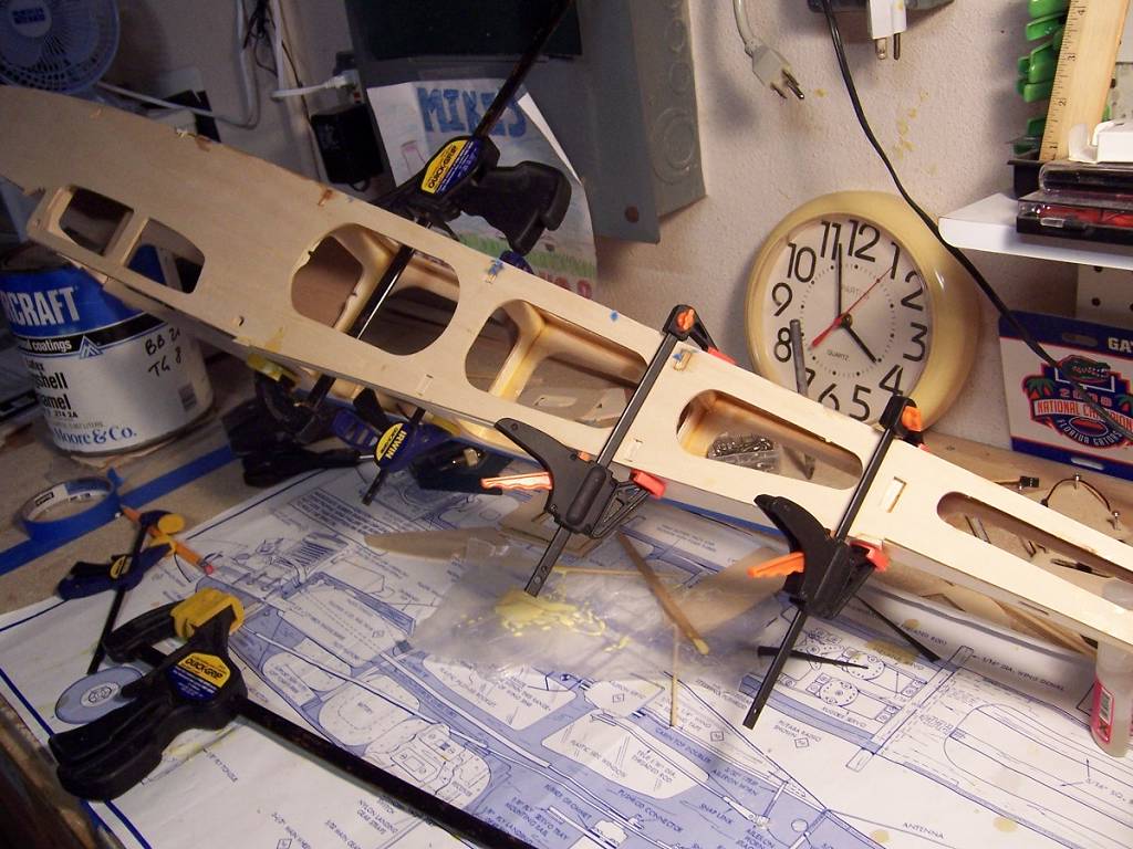

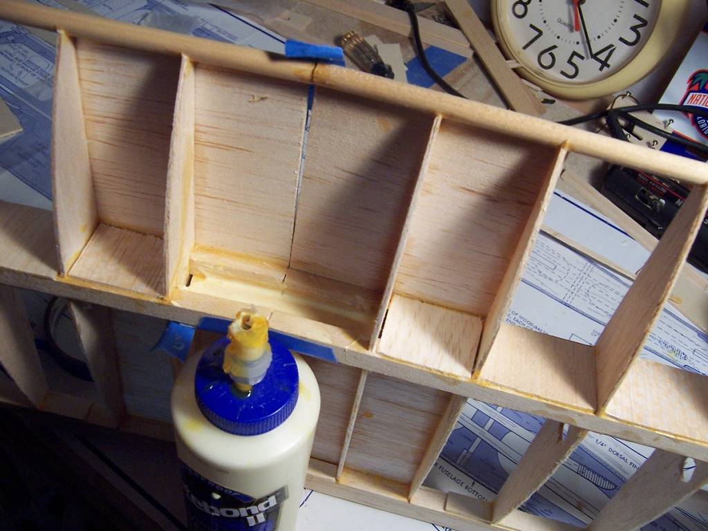

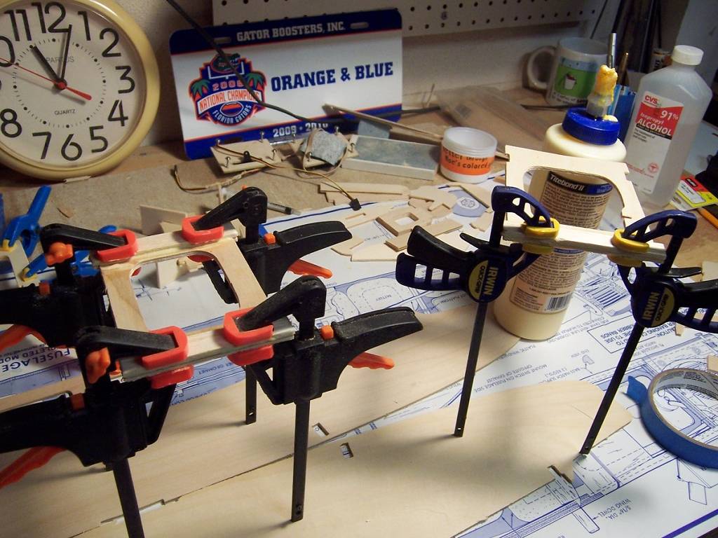

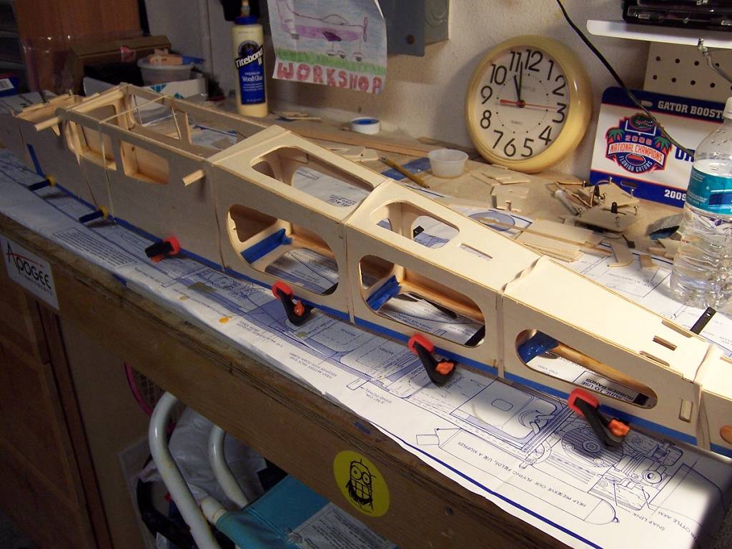

I went with glueing up the fuse with it all together using rubber bands to hold it in place and then used clamps. With the ass'y on the top view and lined up. I ran small dabs of glue on the front side of the former sides and fuse and let that dry (all but firewall). The aligment was then bascially locked in place. The pic now shows the fuse angled slightly toward the front of the bench with painters tape running along the bottom corner front to back with clamps every few inches to keep it tight. The fuse is angled sligly so the bottom corner is the low spot front to back. I put some expoxy along that joint and hit it wth the heat gun a few seconds which turns it into a thin type syrup. This allows the epoxy to seep fully into the joint and the wood while the tape keeps it in place. This part was my dilema as I wasn't comfortable with not having glue on the contct surfaces themselves but heating the expoxy solves that issue. I also do this with the heat gun when fuelproofing the tank area as it again seeps ito all the nooks and crannies and is easier to paint on the wood w/out using thinner.
When this is dry it will be safe to move more easily without affecting alignment and will I will then:
1) Do the other bottom side (angling fuse to other side)
2) Do the front of the formers (bottom and sides - fuse point up resting on tail very slightly forward and angled to one side, then the other)
3) Do the top of the fuse (fuse turned over and each side angled once one side is dry)
4) Do the top of the formers (fuse bottom is up and nose slightly up.
5) Do the backside of the formers. (nose pointing down)
By doing it in steps I can angle the body as needed so the expoxy stays put and does not run or drip where its not needed. This is just how I do it for sheet type fuselages and there are many diff ways. I'll post pics of each. Stringer type fuses are another can of worms.
Once the formers are done, I'll go about adding the bits and pieces like the wing saddle doublers, hatch supports,, etc. then onto the firewall and figuring out the side mount of the motor. ( I need to reset that clock!)

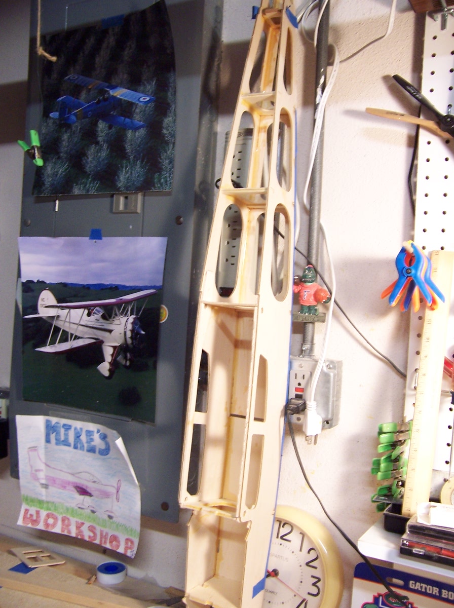

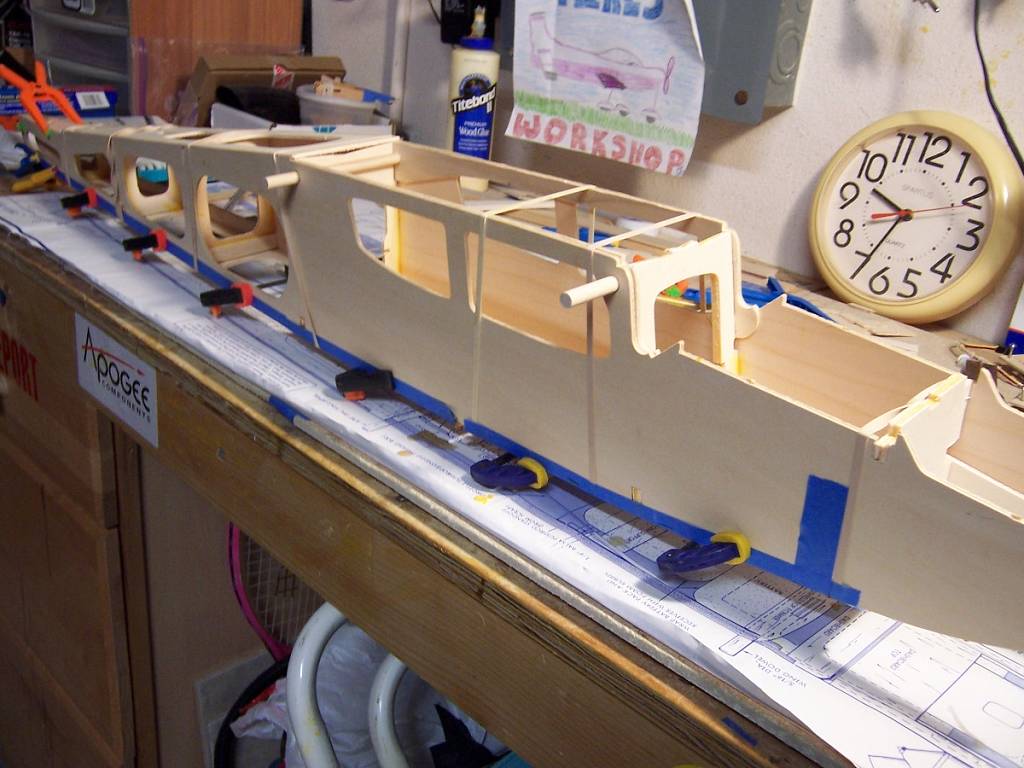

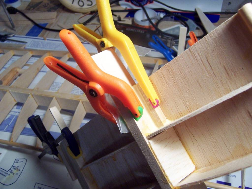

The fuse is coming along with the other bottom side done and and now fuse on its nose for the backside of the formers. Hoping to setup the front sides later tonight.
I started looking at the angles for the firewall both down and right angles. I don't think it will be diffiuclt to make a Wedge to put on the front of the firewall with the correct down and right thrust.
We have company coming this week and the Fl / Vandy game on Sat but I plan on hitting the garage when they ht the sack for some more fuselage glue-ups.

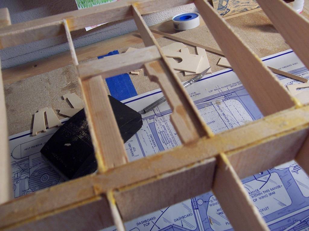

One last pic of the fuse for the last joint and its bascially done on the main part of the glue up. I figured the angles I would need to build into the firewall so I can rotate the motor, at this point approx 75 or 80 degrees.
I added thickness to the firewall with some pieces of ply and will transfer the angles needed onto the sides for down and right thrust. Using a belt sander it "should" be a "somewhat" easy operation to sand in the down and right thrust needed.
I will need to add a shim for the bracket to mount the steerable nose gear to bring that back to vertical as it mounts to the firewall. Plan pics show the right and down thrust built onto a mostly vertical firewall and the nose gear attached.
