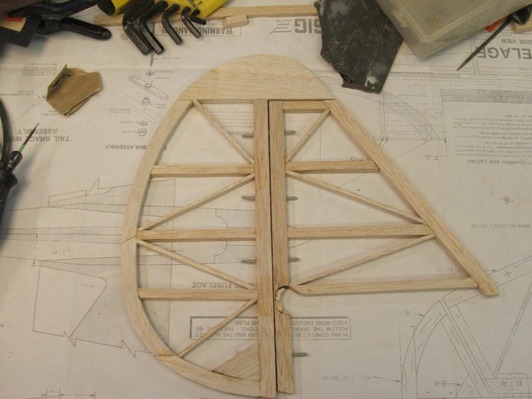

ouch! I was assembling the elevator to the stab and see that the post on the fin is cut alot so the elevator joiner moves freely.it would seem that weakens that entire fin? did you follow sig on that.it just seems like alot of wood removed.I was planning to use robart hinge points for allareas including the ailerons..also do you cover and paint the rudder and tail befpre final install?

I built the fin post per plans. After notching it out for the joiner, 1/32 ply was laminated to the outside of the rudder post for a little added strength. The tail bracing wires will also help to keep things rigid.
I, too, used Robart hinges. Large on the ailerons, and smaller ones on the tail surfaces.

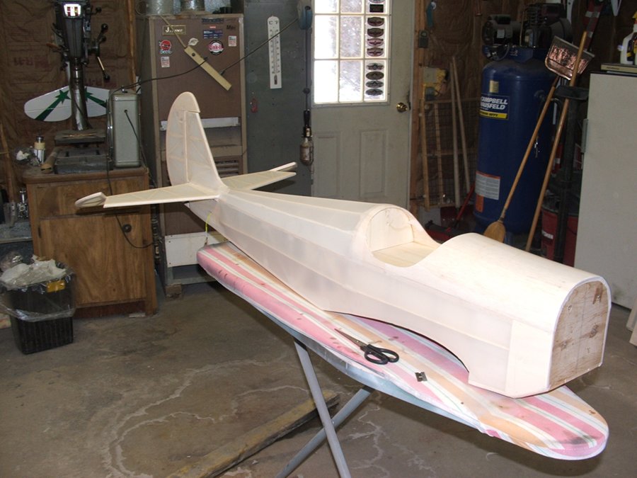

It's kinda funny. Looking back on this thread, I had just completed my Spacewalker II. Right now, I'm building the 1/3 scale Sig Spacewalker. The kit is every bit as good as the smaller SW II.

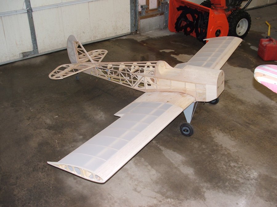

My third scale is now fully covered. I'm working on the radio and motor installations.
Soon, I'll have to set her aside, and wait for warmer weather to do the paint.
