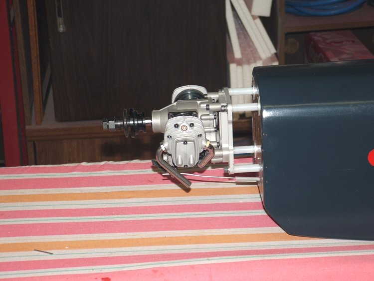

I have a Magnum 1.60 twin in mine. It provides plenty of power, for my flying style.

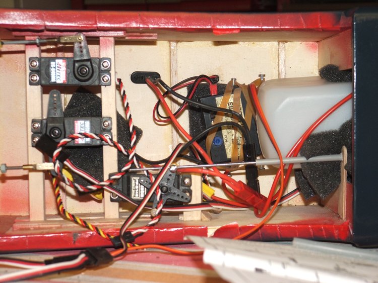

I would not place any servos in the tail area. Even with the 1.60 twin up front, I had to place my RX batteries in the fuel tank compartment. My servos are located in the stock location.
The pic illutrates my installation, before things were cleaned up.

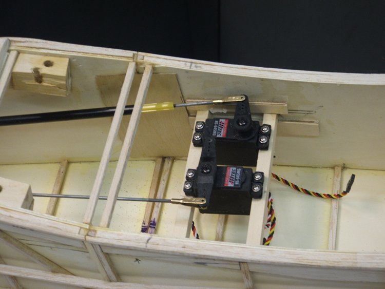

I'm running my 645s on 4.8. If you can catch them on sale, Hobby People frequentlsy has them for $29.00. http://www.hobbypeople.net/gallery/759413.asp
Yup, I used a 1/4 scale Sullivan nyrod, on the rudder. Elevator, too. I like the simplicity of the installation.
My SW is covered in Solartex, painted with Nelson Hobby Specialties paints.
Haven't looked up the specs, but I wouldn't worry about the 150's weight. On mine, I adjusted the balance by moving my RX pack, until I got it right.
Here's a closer look at the pushrod installation, and the paint.

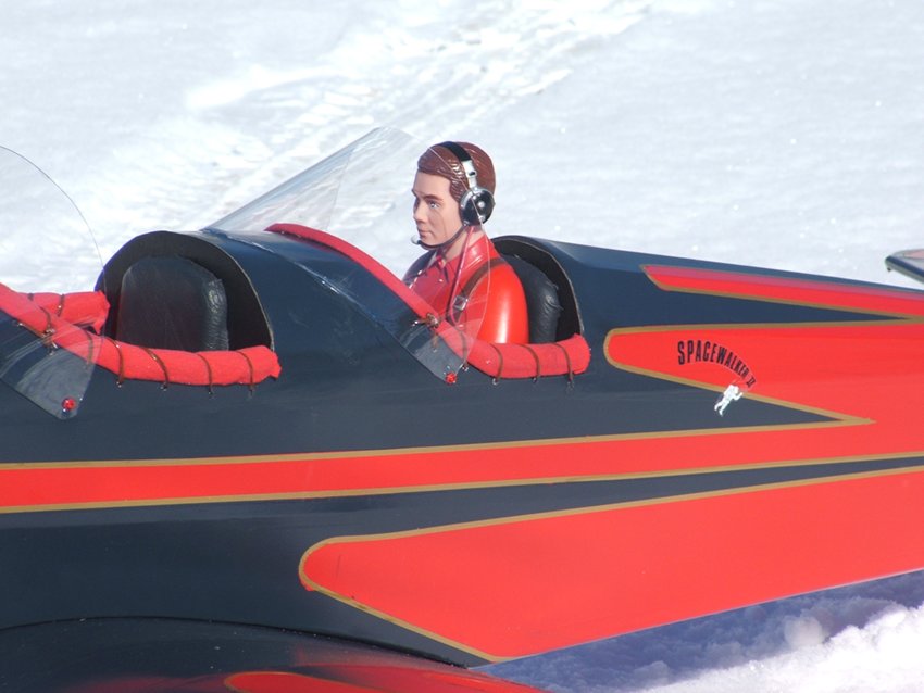

I used CA hinge material for the gussetts.
I had a little fun, adding a few cockpit details, using walnut burl for the instrument panel. The guages were from stuff that I had on hand.
I used leather from a garage sale purse, on the seat backs. The foam, used to line the cockpit edges, was lined with a T-shirt. I used foam safe spray adhesive to hold it in place.
