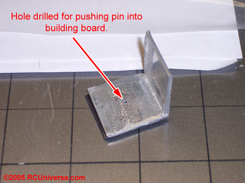

Imade my own jigs.Go to Lowes and by 90° extruded aluminum. Cut them into 1" sections. Use a bandsaw, hacksaw, or chop saw to cut them. You can drill a small hole in them to put pins in to secure them in place. Them simply place the piece next to the rib, pin it in place, and put a small clamp on it to hold the rib securely to the aluminum piece. For less than $10 Imade about 50 or so, as best as I can remember
The ones Iuse have been converted for a magnetic building board, so you can see the magnet on the bottom of them. But you get the idea from the picture

I too have those orange ones they sell, but my problem with them is that the ribs (pending size of wing)are sometimes too tall to allow the jig to sit on the building surface. I did make some taller ones, but when I'm not using ca glue, I use my aluminum ones I made. I did just as RC Ken has done. Allows me to pin things down tightly while glue dries. At times, ca glue fumes mess me up & thats when I'll use slower alpa-glue for a build. Bill
