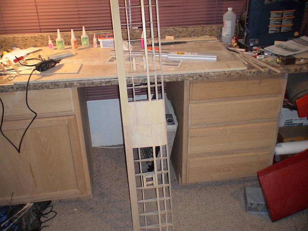

Trial fit on the wing joint.

Fit check looks good.

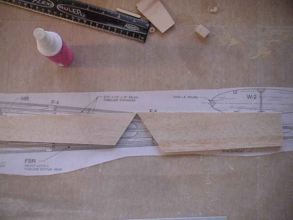

Normal vs. extended elevator. I added 1/2" here also.

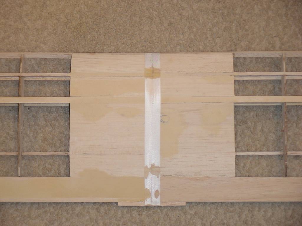

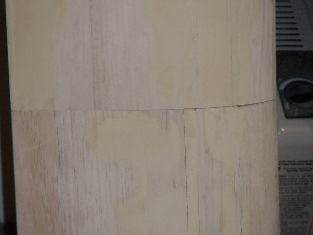

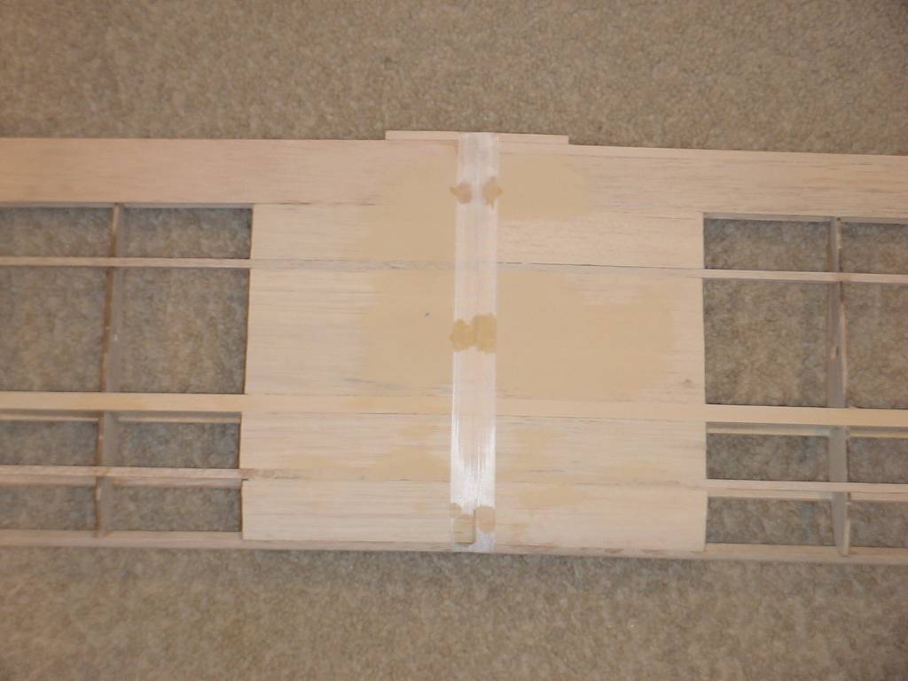

Pics of wing joint tacked down with thin CA before epoxy and after epoxy.

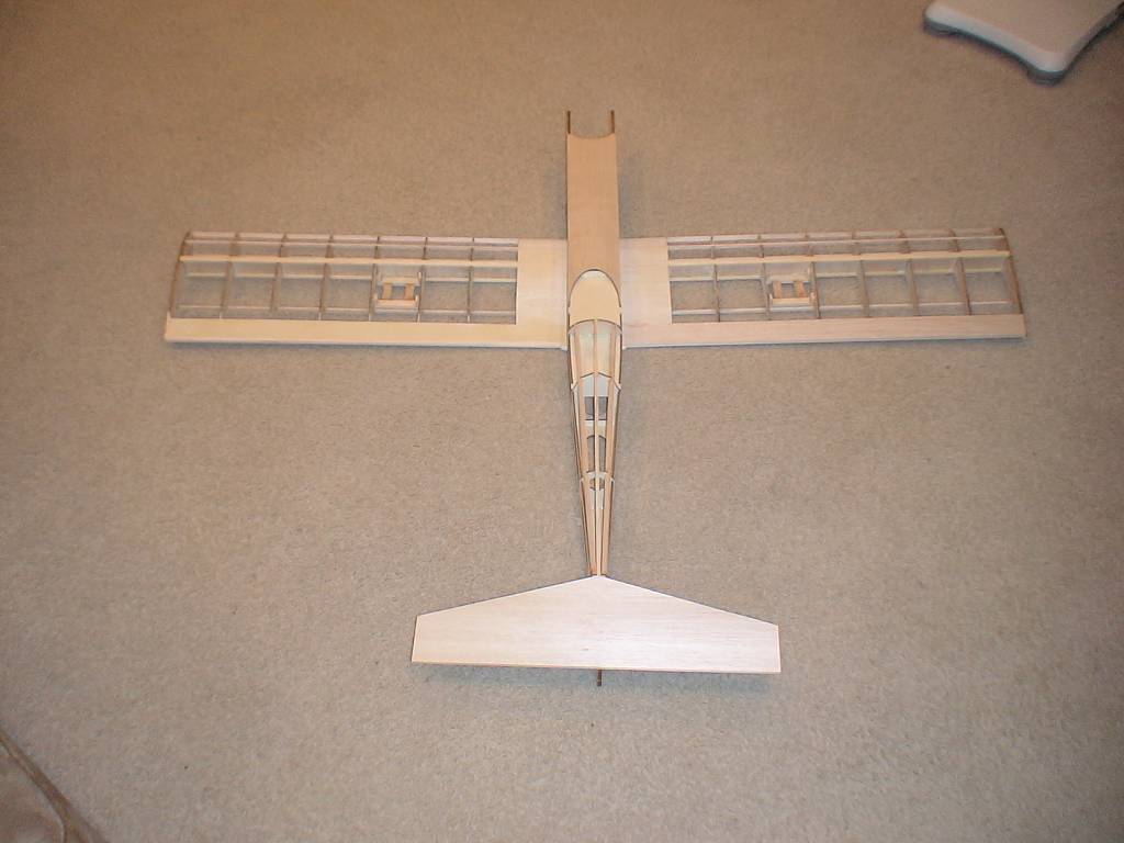

Getting closer. The tail is not mounted yet, just there for looks. I'm almost to the point I need covering.......... UPS man not scheduled to be here until Tuesday...... Should definately be ready for covering by then. Hopefully ready to fly on Wednesday, weather permitting.

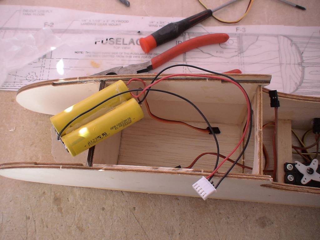

Did some peliminary servo and receiver installation.

I just realized that I have to move the back receiver wire, can't get it out once covered, DOH...... Once I get the 7 channel receivers from Hitec, I'm only going to have the one receiver wire under the canopy.
