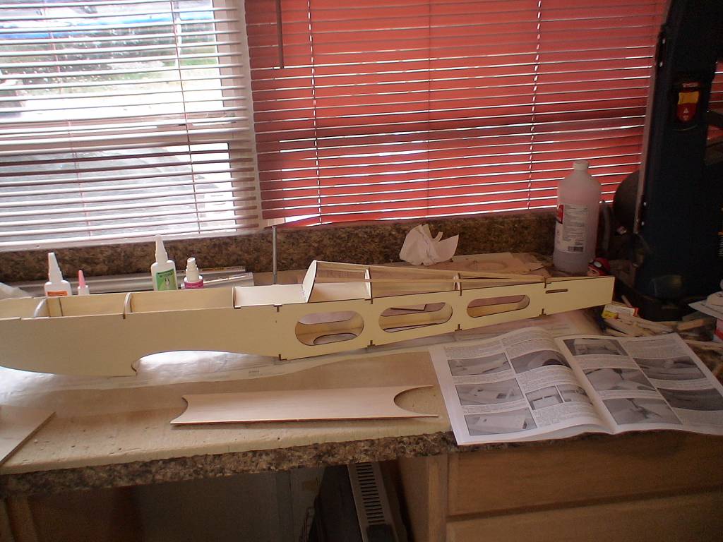

The build starts Monday. My 8 year old son is going to help me. I didn't realize that the tail was one piece balsa like that, should speed up what I expect to be a fairly quick build. I'm on vacation for 2 weeks so if the weather's bad, I'll be building. I'm cutting 1 bay on each side and adding probably 1/2" to elevator, aileron and rudder surfaces and servos in the wings. Many pics to follow.

Dropping one bay in each wing, really improves the roll rate on the 4 *'s , probably the best mod you can do. The elevator is pretty good stock , ,but I added 3/8's of a in. to mine and a 1 in to the rudder, which it did improve the knife edge . One other thing I did was reinforce the fuse. behind the wing saddle, as I have broke both my old .40 and .69 there doing hard snap rolls. I have a few pi's I can post if you like. their on the shop Laptop or I would have already. lol

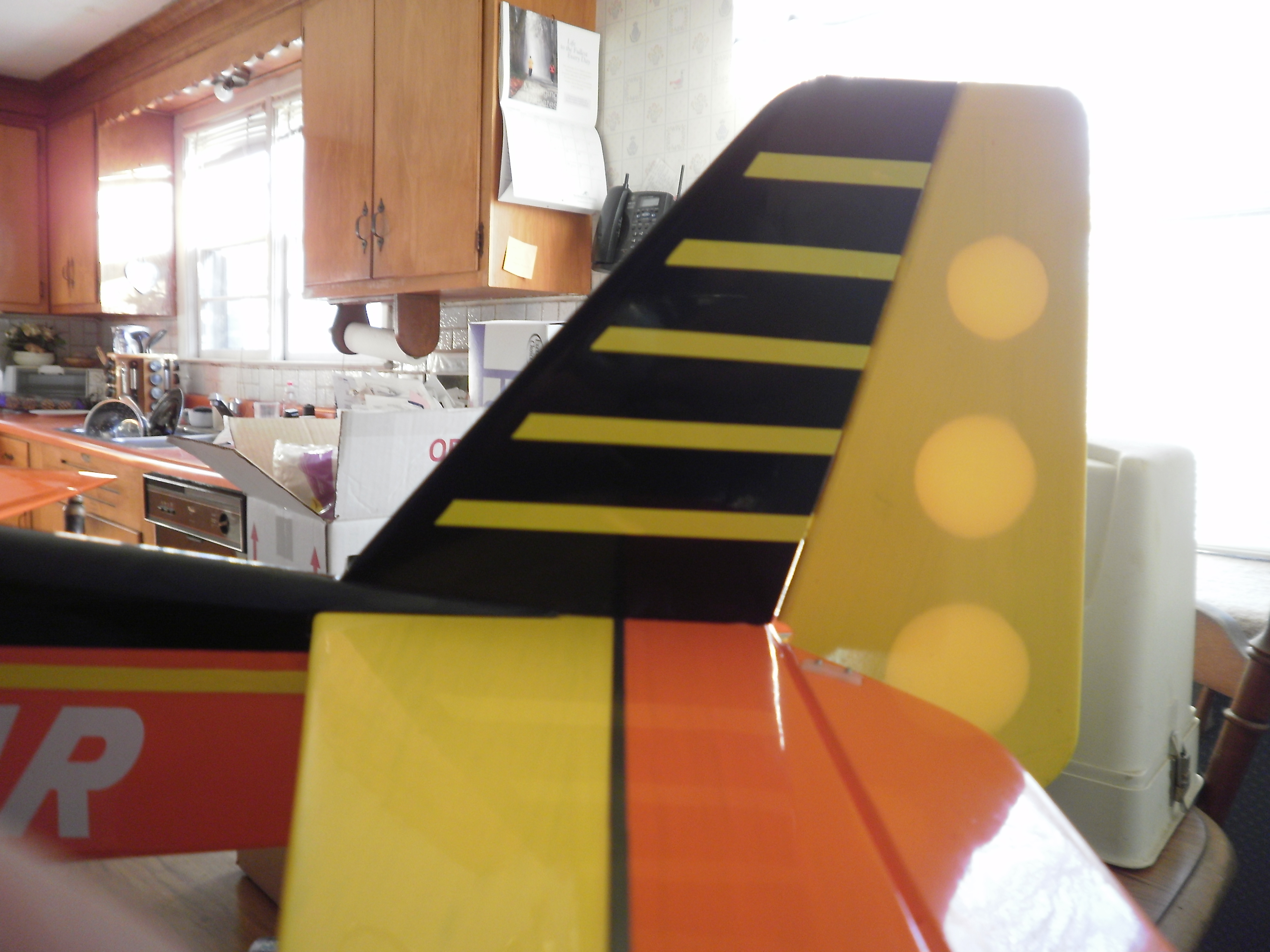

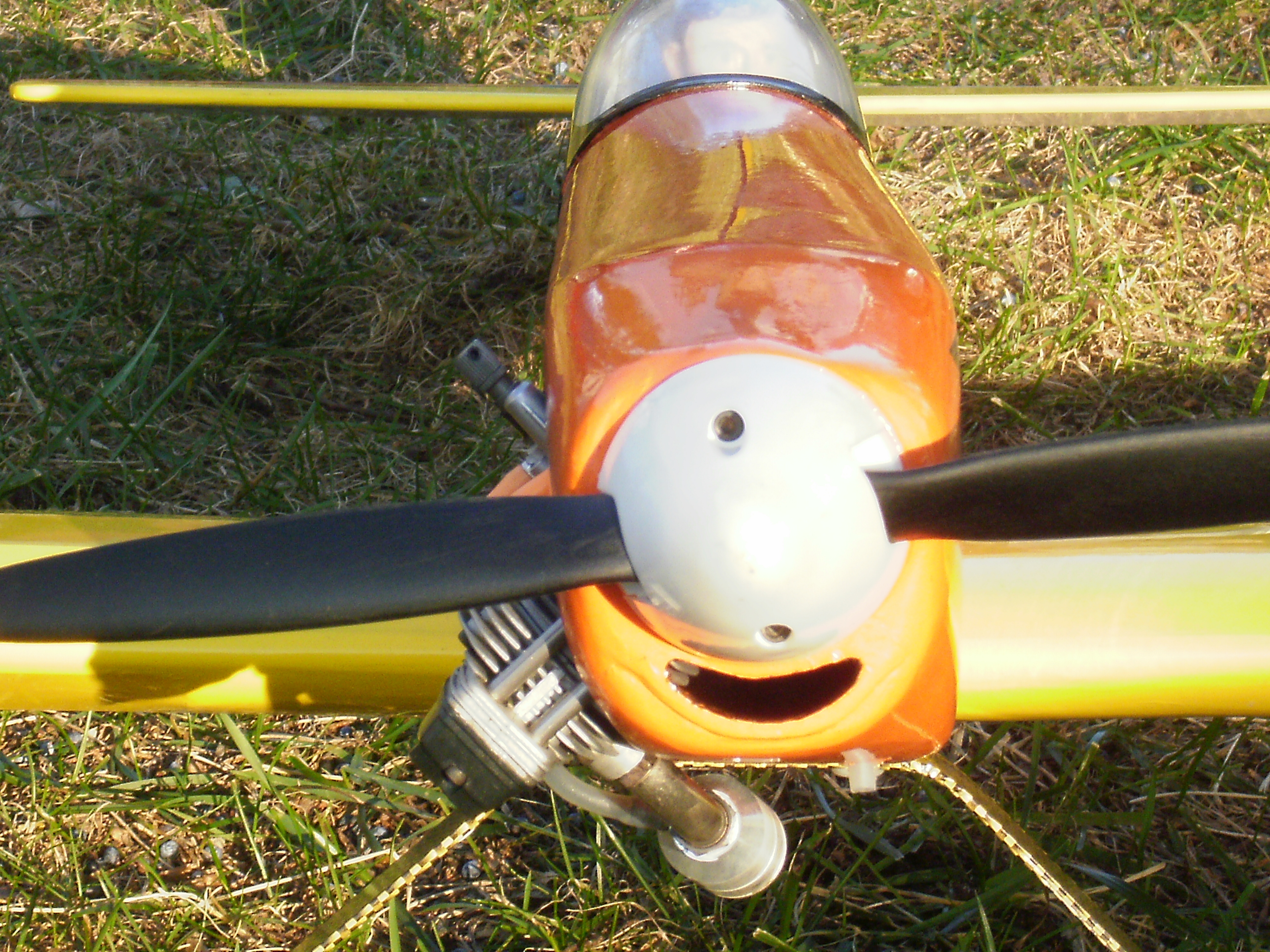

Four star 40 great plane can have a lot fun changing the look -adding winp tips and rounding the corners of
the tail make it more streamline -it can look like a totally different airplanei use a os 52 4 stroke
with 11X8 prop had nice power and good vertical and best it sipps fuel 10min flight about 4-5 oz
mine wgts 4.75 lbs. i added wing tips and ended with about 59in span-very thin ply on turtle deck
for a smooth lookbalsa cowl to cover the engine mounted on a down angle-This a Fast building
plane and very much fun to fly will do all maneuvers but 3DAbove all have fun with a great
Build

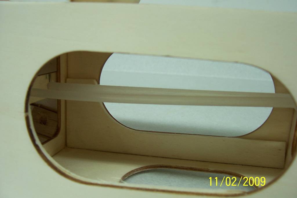

Here's a pic of of my fuse reinforcement ,I just used the scrap ply from the fuse sides..

Wow , moving right along! Before you install the fuse top, preinstall your tank, with the padding on the tank floor and sides, makes it easier toget the holes right. Also it's easier to drill the wing dowel if you have'nt installed the fuse bottom in front of the wing saddle. Line the wing up and tape it in place , then use a longggg 1/4 in. drill bit and drill thru the monting hole into the wing. Be sure to keep your drill level.
Also install your throttle linkage with the fuse top off, makes evey thing that much easier.
