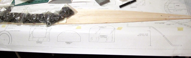

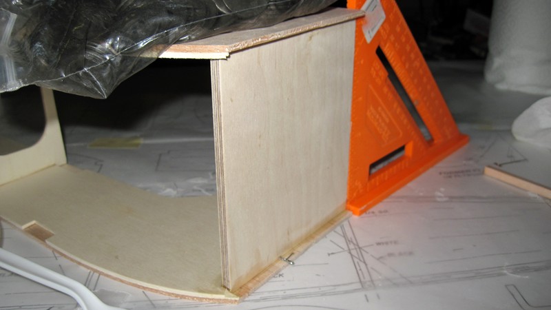

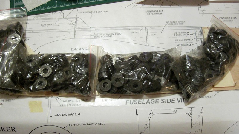

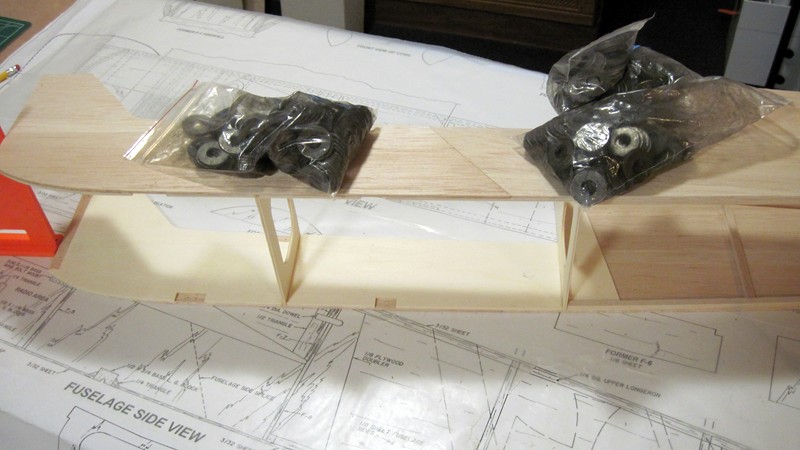

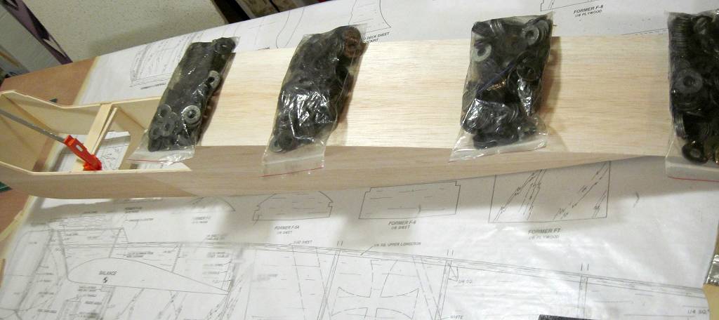

I got my chores done early and did have time to start the build. My first recommendation will be for yall that are used to laser cut kits is, you may have to actually use some sandpaper on this kit. [X(] By far this is the best die cut kit I have ever seen!.
I used medium CA to join the front and aft fusealge sides together and the joint was just slightly different from the drawings. The manual warned of the drawings being different from the actual parts due to the paper being subjected to temperature extreems so I joined the fore and aft right fuse side by fit. It's a good thing I did and I should of thought ahead and layed over the ply doubler before gluing the fore and aft fuse sides. The mark of a good kit is when the dummy gets it right!
I used weights insted of using pins when gluing the ply doubler to the fuse sides. Being a tightwad I used some left over washers from work put in ziplock bags as weights.
So far, so good. I like this kit alot!

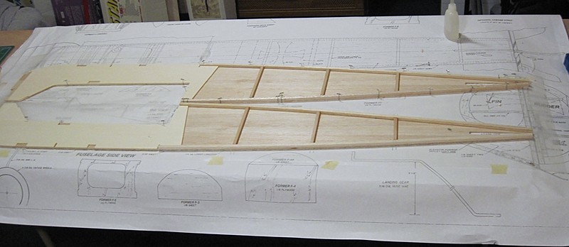

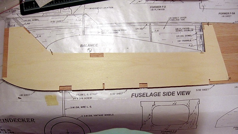

Got the fuselage sides done and theres not much to write about. Everything went very smooth, all the wood is excellent and the instructions are clear enough for even us old dudes. [X(]

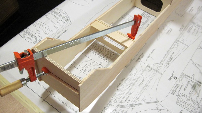

Ok, this is where I ran into my first issue. The instructions call for pinning down the right fuse side on edge while trying to tack glue in F-8 and F-5. I couldn't get that to work for me without growing a third arm/hand. Since the fuse sides are curved and not much of the edge makes contact with the building board, I decided to roll the dice and add F-8/F5 the old fashioned way. Flat on the board using a square.
Hope this doesn't bite me in the heiny later.

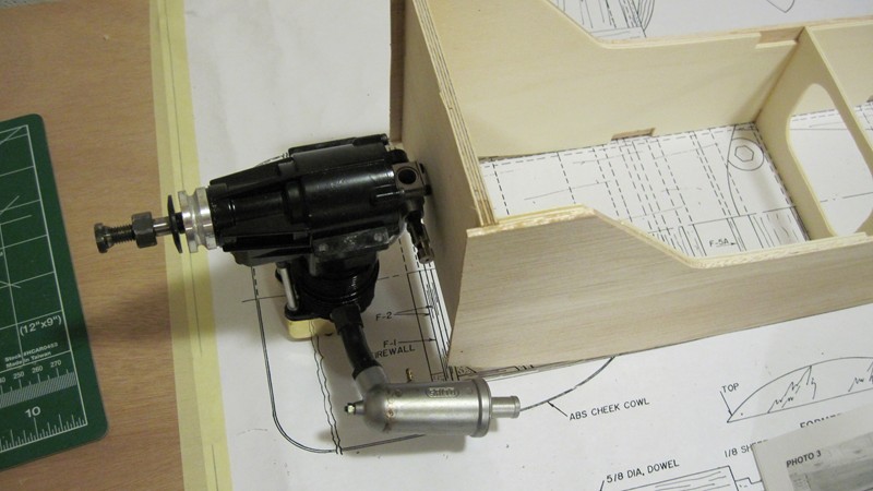

The next step was to glue the F-1 Firewall in and in the instructions they show a bottle of CA in this step, but again, I broke the rules. I used 30 minute expoxy and a square to make sure everything is true, I hope!
The last pic is what a true kit builder does all the time. It's of my finger full of CA smoothing things out and then sanding it to get the paper towel off that I used to whipe it with. lol

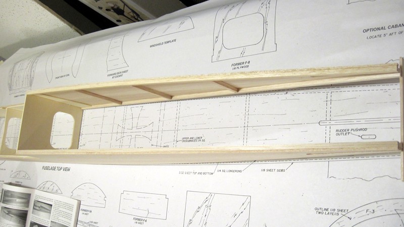

Trudging forward with the fuselage build and a couple of issues popped up which is my fault for not follwing the instructions to the letter. When joining the two fuse halves together I noticed that the right side was allmost flat and the left side had alot of curve to it. I anticipated that and had a plan, and thank the balsa Gods it worked out.
With a little braceing, twisting and cussing I was able to get the fuse sides pretty close to eachother curvature wise and the only thing I'm worried about now is I have a slight left thrust in the firewall. I think I can take that out while sheeting the rear of the fusealge though.

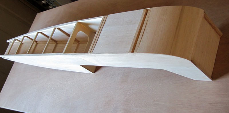

Old 01-01-2010 | 03:50 PM
GaryHarris's Avatar
Joined: Sep 2008
Posts: 2,101
From: Houston, TX
Default RE: Balsa USA Eindecker 90 build.

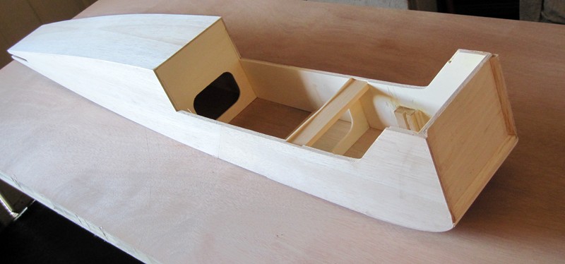

I have the fuselage built as far as I can go untill I build the wings. I ended up with a slight twist in the fuse but nothing I can't tweak out. I have only done the rough sanding and will clean her up more after I mate up the wings and the other appendages. And it warms up outside. Brrr. 54 degrees F. [8D]
Onto the wings.

Some wise Chinese dude once said, shut up and take digital pics foo! [X(]
The right wing is allmost done and I think Ill take the rest of the day off and pick some guitar or something. Ying and Yang, the balance of things, yadda dadda.
