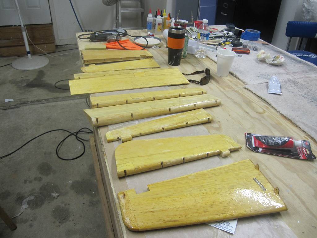

    [img]{akamaiimageforum}/upfiles/481909/Uz69740.jpg[/img]
    Are you using diluted or undiluted epoxy resin?
    [img]{akamaiimageforum}/upfiles/481909/Dz80690.jpg[/img]

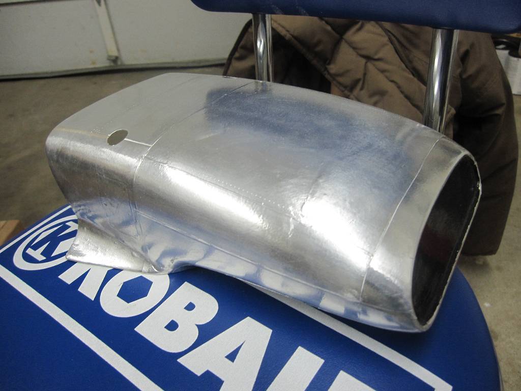

    I found it interesting the radiator was the first area to be covered with Flite-Metal instead of the rear of the wing bottom. Looking forward to more photos as you progress. Did you weigh your components before you started construction? It would have been nice to have learned your accumulative weight as a result of adding features and details for competitive purposes.

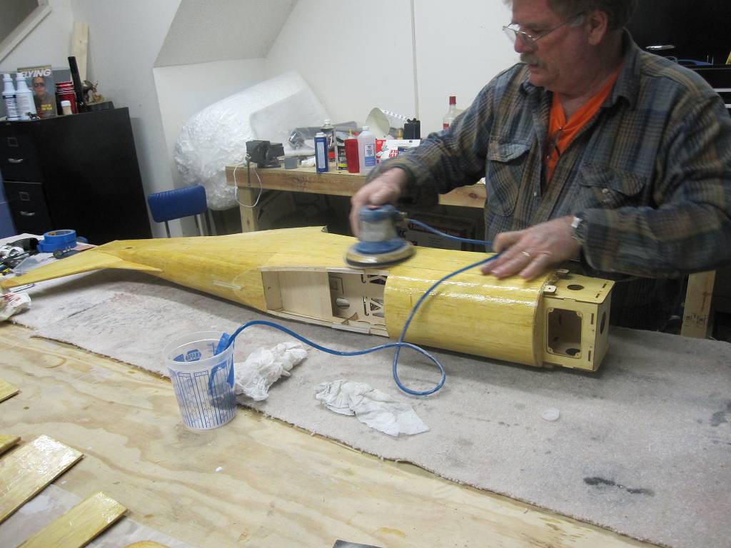

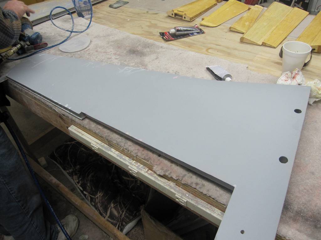

    <p class="MsoNormal" style="margin: 0in 0in 0pt"><font size="3" face="Times New Roman">I started with the radiator because it was going to be the hardest to cover given the complexity of the curves and I would waste very little Flite Metal by screwing this up. I have a couple of blemishes but nothing I can&rsquo;t fix. I also made a few small panels on a piece of hardwood to practice on and it did great.</font><font size="3" face="Times New Roman"></font></p><p class="MsoNormal" style="margin: 0in 0in 0pt"><font size="3" face="Times New Roman">We used diluted Zpoxy finishing resin with acetone around 20%.</font><font size="3" face="Times New Roman"></font></p><p class="MsoNormal" style="margin: 0in 0in 0pt"><font size="3" face="Times New Roman">I have two other guys helping me with the project and we are going to start laying down FM this week. Everything has been primered, filled, and sanded and we are doing the final prep work.</font><font size="3" face="Times New Roman"></font></p>
    <font size="3" face="Times New Roman">We are using an orbital disk sander set at 40 lbs air pressure with a 600 grit wet before priming and 1000 grit wet to get our final surface. Getting everything level and square is all done by hand.
    I have completed some FM on the cowling but can't go any further until I receive the exhaust from Keleo.</font></p>

    Any particular reason acetone was used to dilute your Z poxy instead of denatured alcohol?
    I ask because this is the first time I recall anyone using acetone with "epoxy" because acetone's out-gas during evaporation would in all probablility melt EPS or XPS foams utilized in cores of wings and tail feathers. I mention this with respect to the readers of your thread as it relates to their personal projects...and not necessarily this specific airframe...
    Your viewers may not be aware of the fact the use of acetone could effect their projects and come unglued (literally) with the resulting goo their sheeted components could contain after application of resin diluted with acetone. A 30~40% dilution of 90% denatured alcohol is typically used as it enhances the interlink of resin to cellulose of the balsa resulting in stronger bond and a greater T/C without the threat of melting EPS or XPS.
    The denatured alcohol leaves no residual effect on Z-poxy with respect to its strength because the alcohol evaportates. Its more or less a flow agent used for disbursement and a how rather than how much issue as is the case with most of your project. Hope this wasn't considered a distracting post.
    I more or less was taking advantage of an opportunity to prevent a future Flite-Metal customer's assumptions from creating an issue with EPS or XPS on their project. I believe this P-51 is all built up wood, at least the wing is. Are the tail feathers built up as well?

    This kit is all wood build up. I don't use alcoholbecause of its ability to bond with water and I am not using the fiberglass to add strength. This is just to provide a surface to apply the FM.I have used acetone to thin Zpoxy and applied to 6MM flatfoam wings, make skid plates for my two Starmax F18 foamjets to belly in on grass, and to build the Byron foam wing and have not ever seen any effect to the foam. I am still flying my foamy electric 6MM flat foam wing in combat that is so overpowered the tail flutters at full throttle. I have had many many collisions (as we chase ribbons tied to the tails) and this once all foamy plane is now about 40% hot glue but I have never broke the wing or seen any delamination or melted foam.
    I am also diluting around 15-20% which might be a factor in my success with fiberglassing foam but this is the first time I have heard of any problems. I know of two guys that have flown for Byron Originals and still fly Byron Aircraft and all use acetone to dilute with and never had any problems that I am aware of and you know how much foam they are working with. Doesn't mean what you posted isn't true, I just never heard of bonding problems or melted foam using acetone to dilute with. I do realize what ever you use to thin epoxy with will weaken its bond properties.

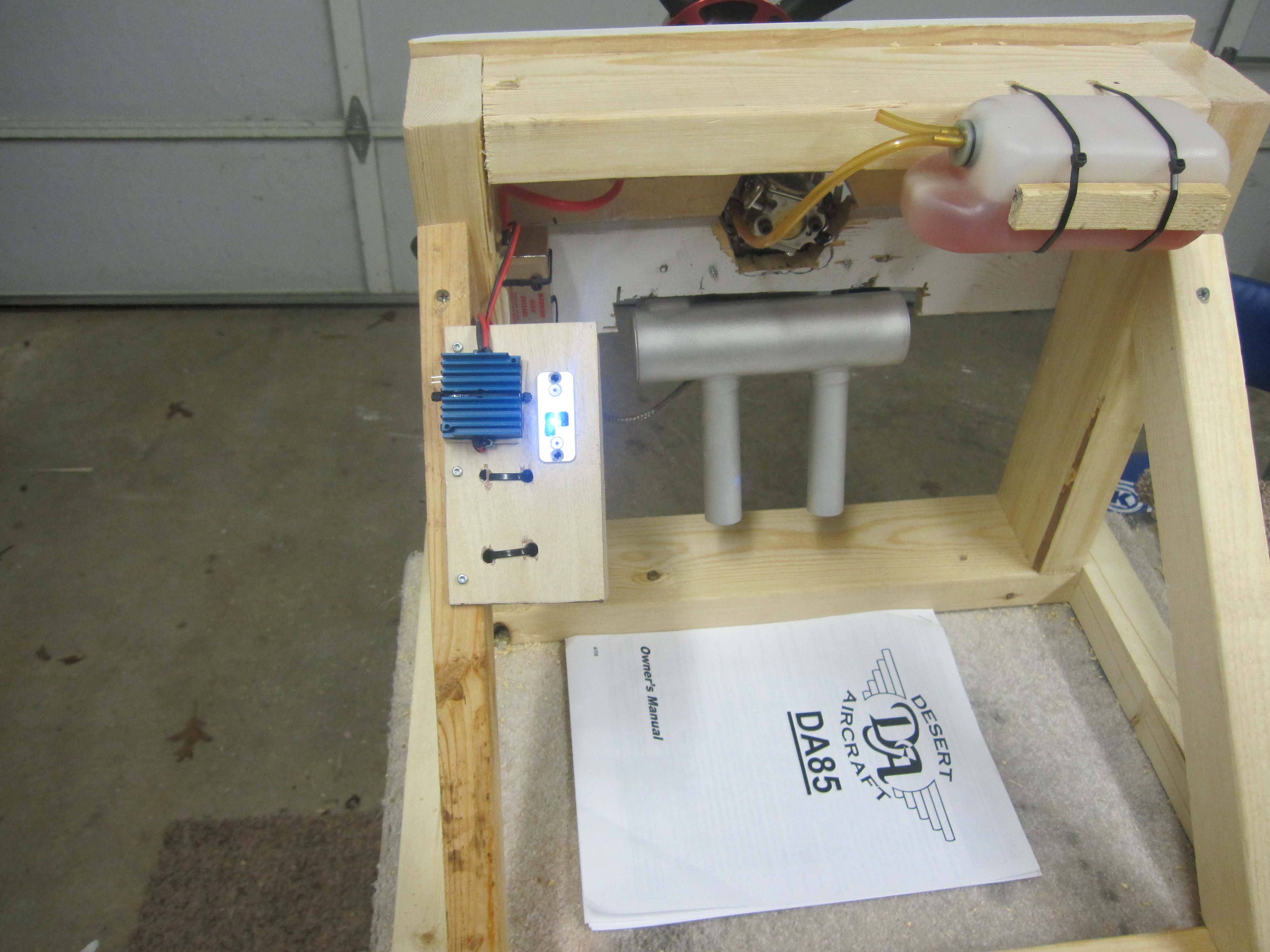

    I decided to take a break from the sanding and have a little fun so I built an engine test stand for the DA 85. I have plans on running it tomorrow afternoon. I will take some video and get it posted when I get home.
    Tru Turn sent the wrong center bolt for the spinner so I had to make a sleeve to bolt the spinner on. They sent a new one that I should have by tomorrow.
    I built a small box for the battery, switch, and voltage regulator.

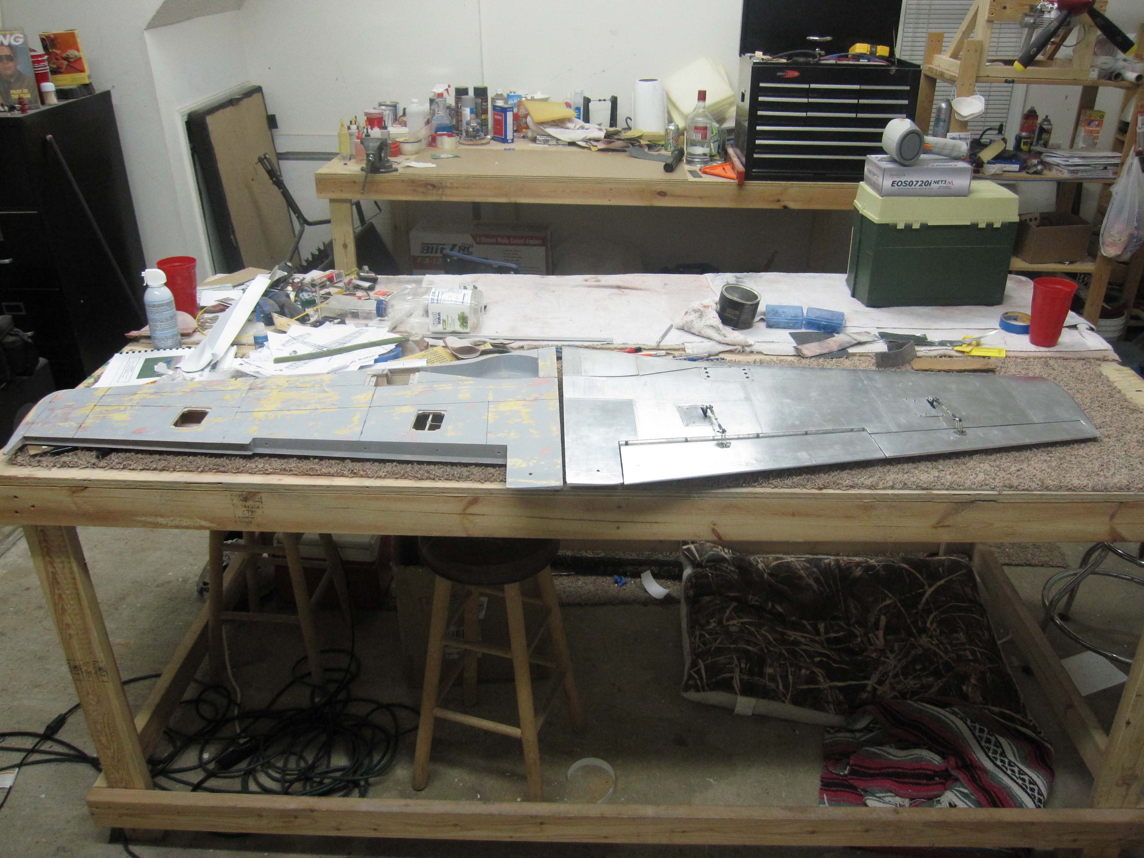

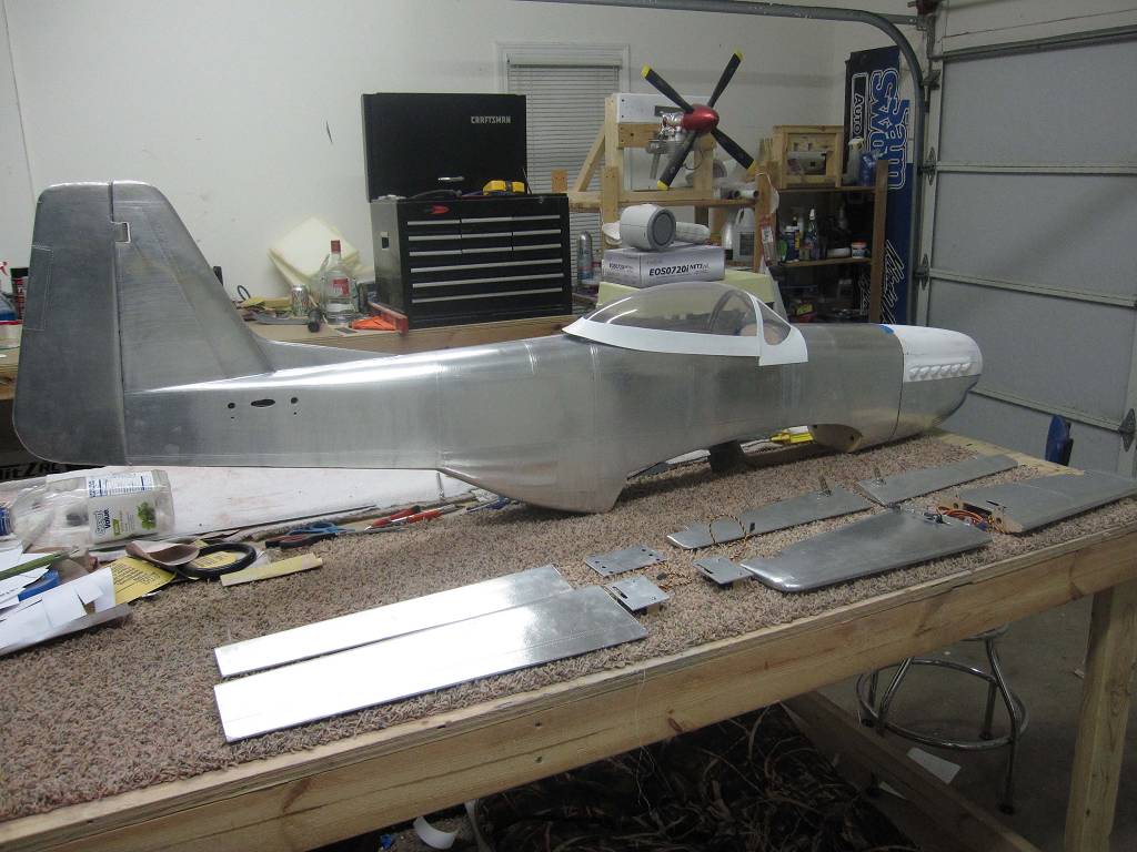

    Just started putting Flite Metal on the control surfaces. Man does this stuff look great. I will have pictures up later. Hey Ed. What is the best way to polish FM to a mirror surface? We used the rivit wheel on each side of the panel lines then burnished it down. It looks so real. Just getting a few control surfaces done has really kicked us into high gear.

    Actually you wet sand with 400 working to 600 and let the slurry stay on the surface during the mix mess. It work hardens
    the aluminum creating a petina that is a slight smokie mirror when high pumis metal polish is used. This does not take very
    long to achieve.
    You should have your documentation handy to create a master polished piece of glassed and primed balsa so you can then
    use that as the measuring stick aka control sample for the proper degree of surface leveling before applying the polish with
    the 400 then 600.
    Some people continue to work their way to 200 grit. Its a matter of how OCD and how smooth you want the surface to be
    when you call it a match to your documentation. Below is Terry Nitsch's BVM F-100 wing with reflection of the fuselage
    markings in a very low light source image.
    Our Flite-Metal Polishing Cloths contain an oxidation retardant providing excellent surface stabilization. Terry's wing as you
    see it in the above photo was simply dusted off after laying in his basement all winter long before being taken to Top Gun
    where he won, again. The surface reflection had not dimenished as it would without the polishing cloth application.
    Joe Grice's Pretty Penny was the opposite. Pretty Penny had "0" antioxidant and continued to look like "The Real Thing"
    the longer it continued to compete. Joe's F-100 was a war weary SEA airframe showing the expected neglect and abuse of
    that environment.
    Joe and Terry are OCD with respect to their art perfecting the illusion of scale. Flite-Metal permits par results with minimum
    time and effort because it is how and not how much.
