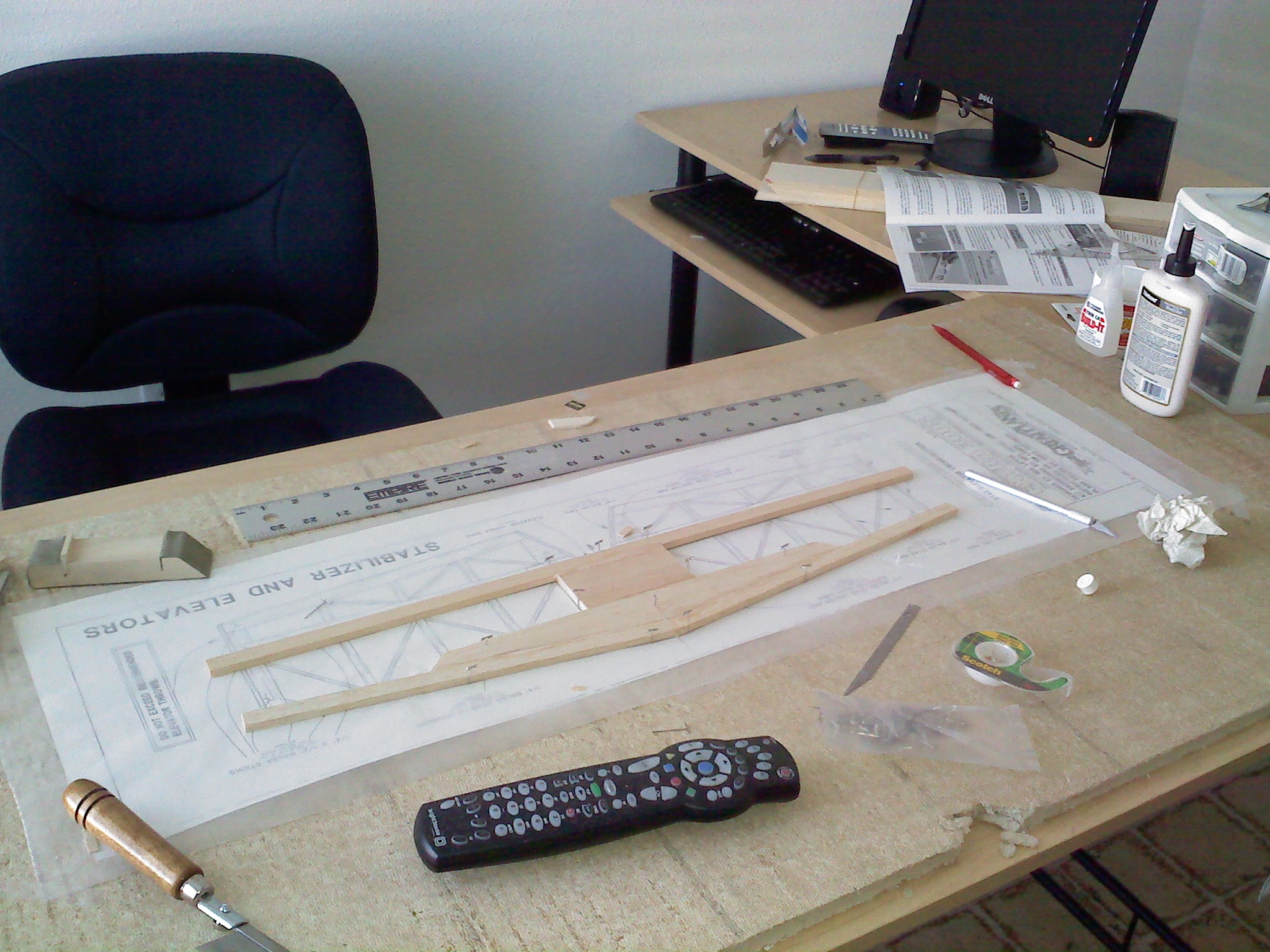

Thanks for the metal ruler idea. O.k I just started the elevator so here are some pics. I would like some constructive criticism please.
Remember I have zero wood working experience.
So far the hardest part has been trying to sand the ends perfectly flat, any tips?

Try this sanding block, makes repeated angles precise and perfectly flat.
[link]http://www3.towerhobbies.com/cgi-bin/wti0001p?&I=LXG876&P=7[/link]

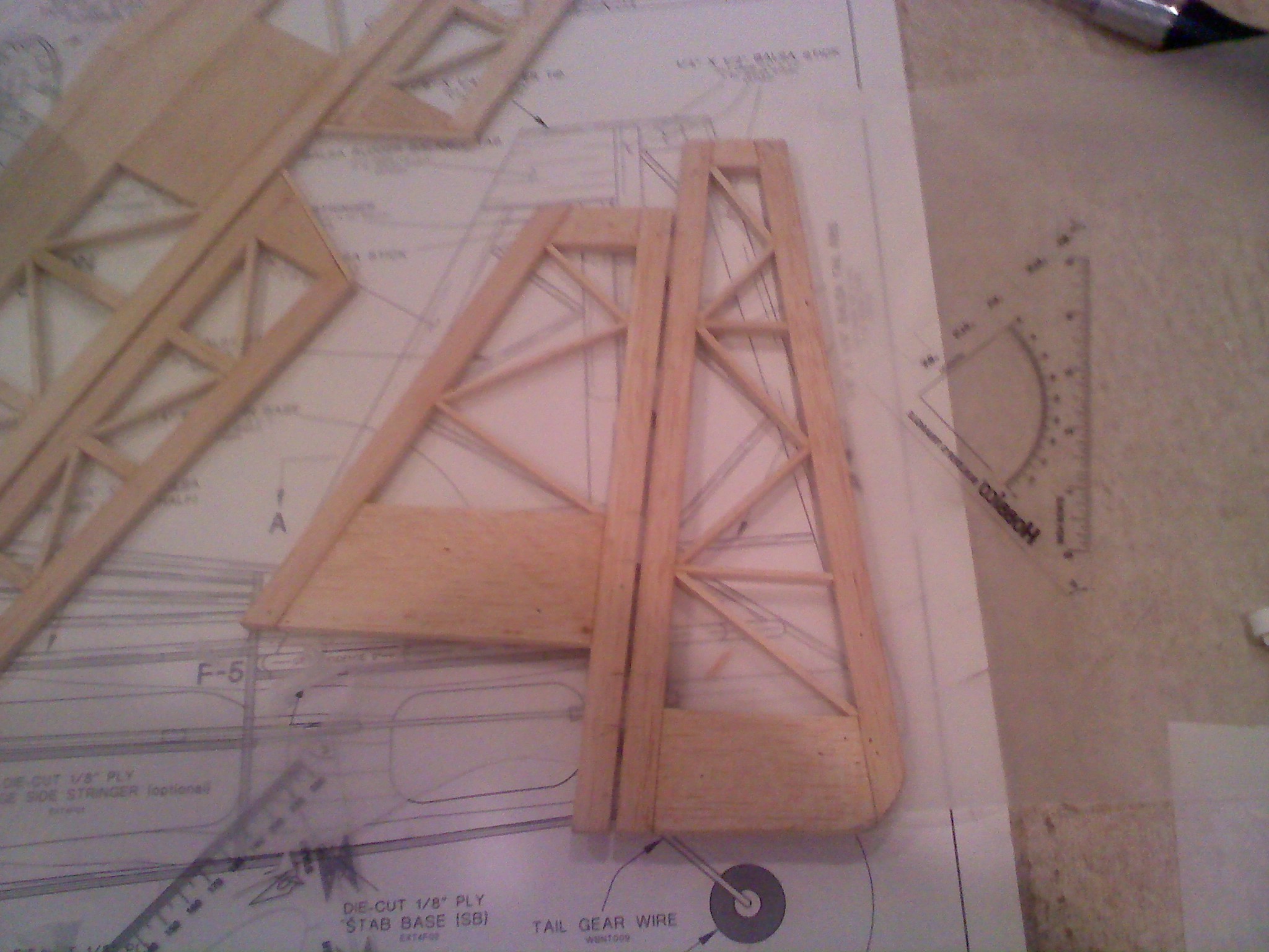

I have another queston about this next part of the instructions:
7. Remove the stab from your building board. Inspect all
the glue joints and add CA to any joints that don't look
strong. Cut the ends of the leading and trailing edges so
they extend past the end of the stab by about 1/16". Use
your bar sander to finish the job by sanding the ends of the
LE's and TE so they are flush with the end of the stab. Cut
the 1/8" x 1/4" tips, then glue them to the end of the stab.
The last sentence talks about the 1/8" x 1/4" tips..... what are those???

The tips are just strips of balsa glued to the ends of the stab to increase strength at the outside edge. Also used on the wing tips and vertical stab. Makes for a nice neat finish to the construction.

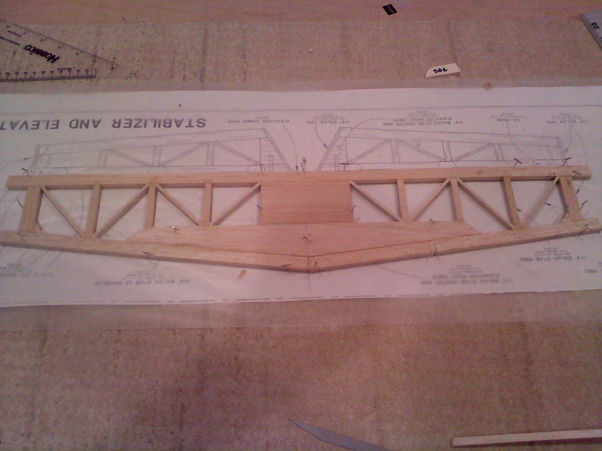

The wingtip pieces that are mentioned are shown on the plan at each end of the stab and the elevators. They are simply caps to cover up the end grain of the leading and trailing edges.
I was going to suggest that you use the pins beside the wood rather than through it, but I looked closely at the pics and I see that you are doing that already. It helps you avoid splitting the thinner pieces.
So far it's looking good, just continue to be patient and work carefully and the plane will turn out great. And don't hesitate to bring the questions here. This a great site for info.

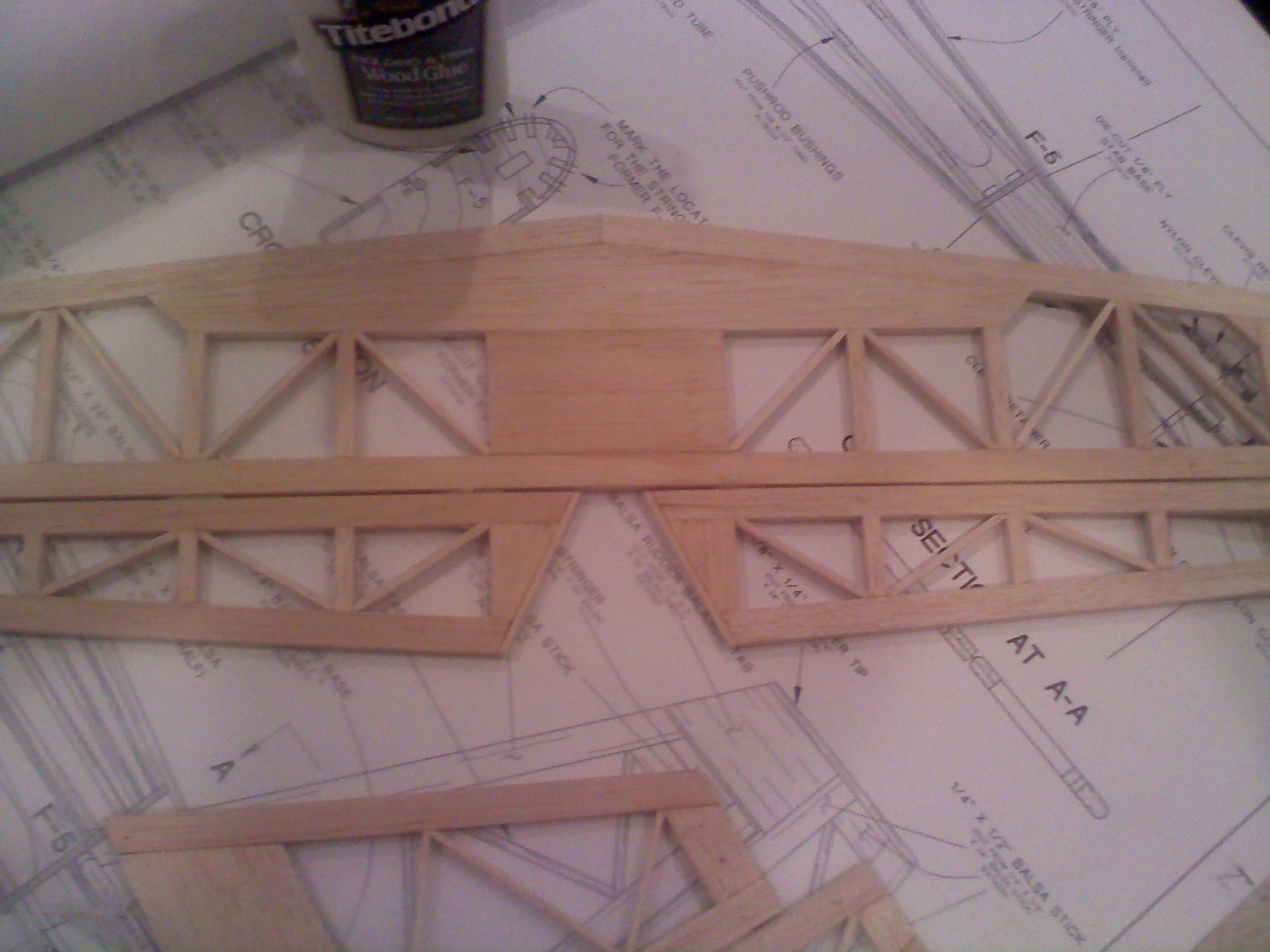

OK I worked on creating the hinges on both the rudder and elevator...not an easy job thats for sure. I also beveled the edges too...
Nest step is to create the rudder balance tab and join the elevator halves

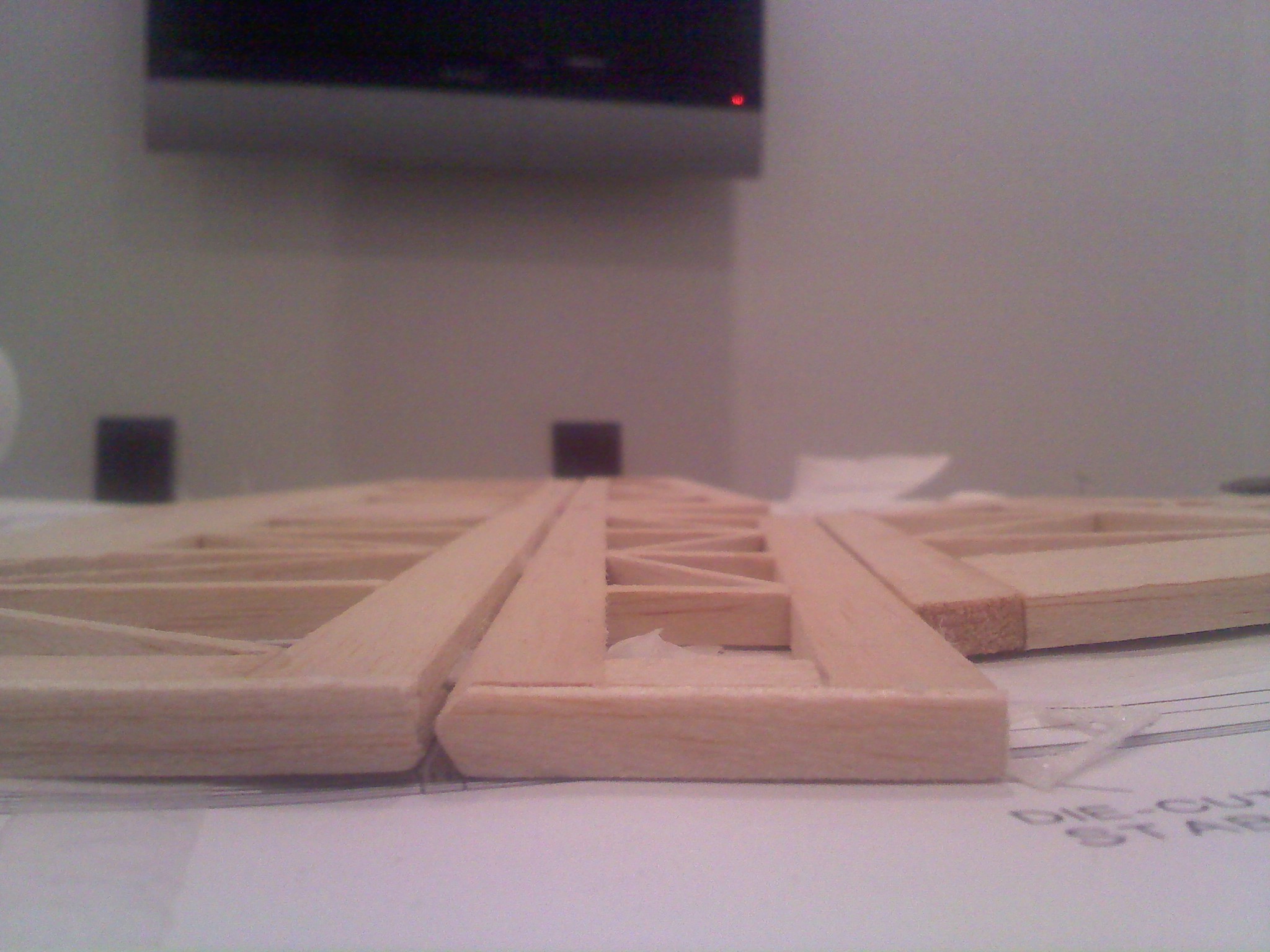

Well I ran into my first big issue in building this kit and wonder if I can get some ideas. I was trying to install the elevator joiner wire and ran into two problems. First, I used my drill to drill a pilot hole (3/32) followed by the regular hole w/ a 1/8 tip. I was unable to drill thru the center and ended up drilling a hole that angled and actually came out thru the bottom of the balsa. Secondly, I must of measured incorrectly, but the other hole was a little too short so that the elevators when joined were a little short.
How do I fix this?? I have a couple of thoughts, remove the angled blockby cutting where it attaches to the TE and part of the LE because the hole goes thru it. Rebuild the block and LE, how will this affect strength? I would have to glue a piece of LE balsa to the remainder of the LE?
Another thought is to somehow make a shallow groove on the upper/lower side of the balsa exposing the canal and then correct it and then create a flap of balsa to glue on to it... It that makes any sense.
Or just rebuild the elevator halves again but this still does not solve the problem on how to drill a centered hole with just a drill... any suggestions?
