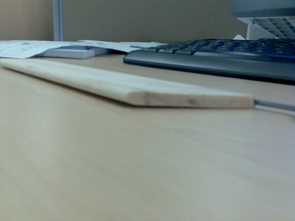

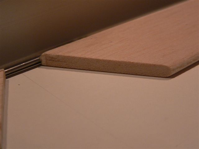

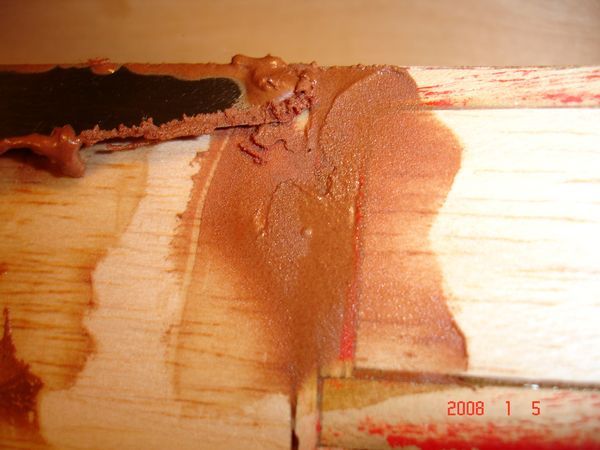

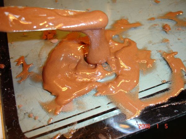

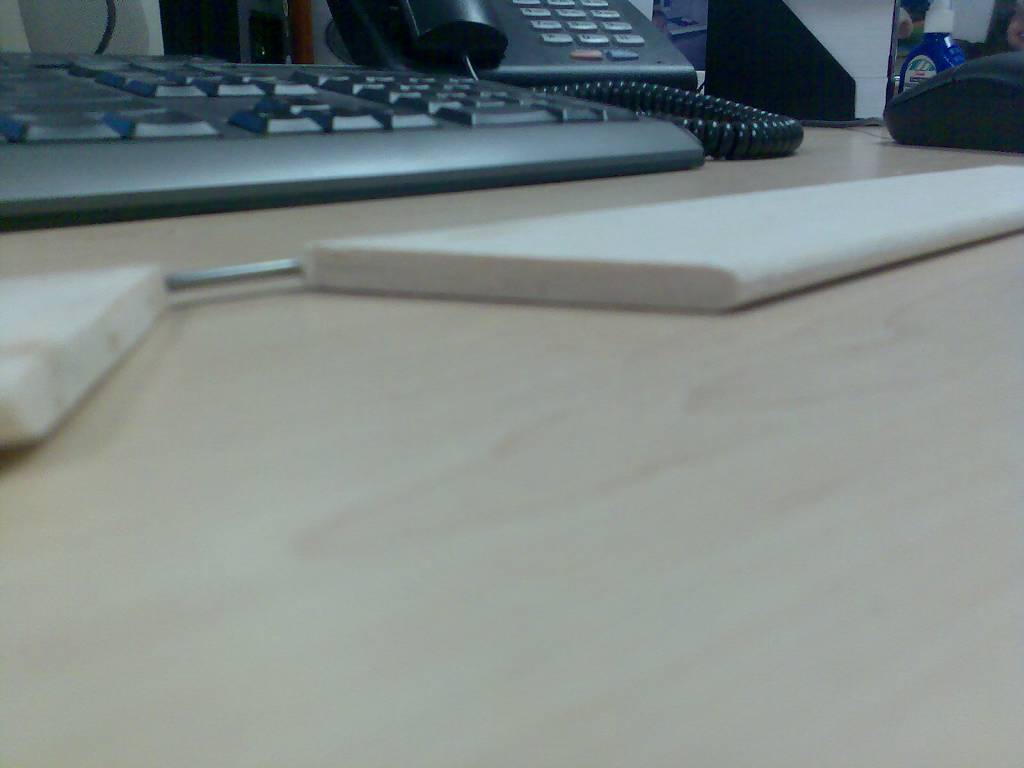

I Had a similar problem when I built my 4*.
What I did was to cut out the upper section of the elevator so that the elevator halves would lie flat and pinned them to the building board. I then filled the hole with epoxy and micro balloons.
Dead straight elevator and been flying for a year and a half.

You can use just epoxy, depending on how big the gap is you have to fill. If it`s too big then you will have to thicken it with microballoons.
The method i use to do this type of thing is to wrap a piece of masking tape around the drill bit (much better grip) and do it by hand where you can see it from both sides.

You can use epoxy only, but the addition of microballoons to the epoxy until the consistancy of peanut butter is reached, improves the sandability.
Microballoons are basically tiny glass beads and should be available at your LHS - I have not seen them anywhere else.
Use 30 min epoxy and not 5 min, the microballoons tend to decrease the working time of the epoxy.

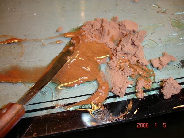

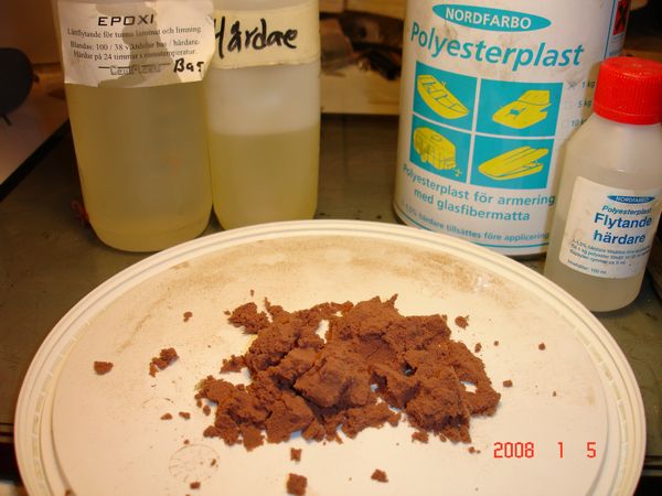

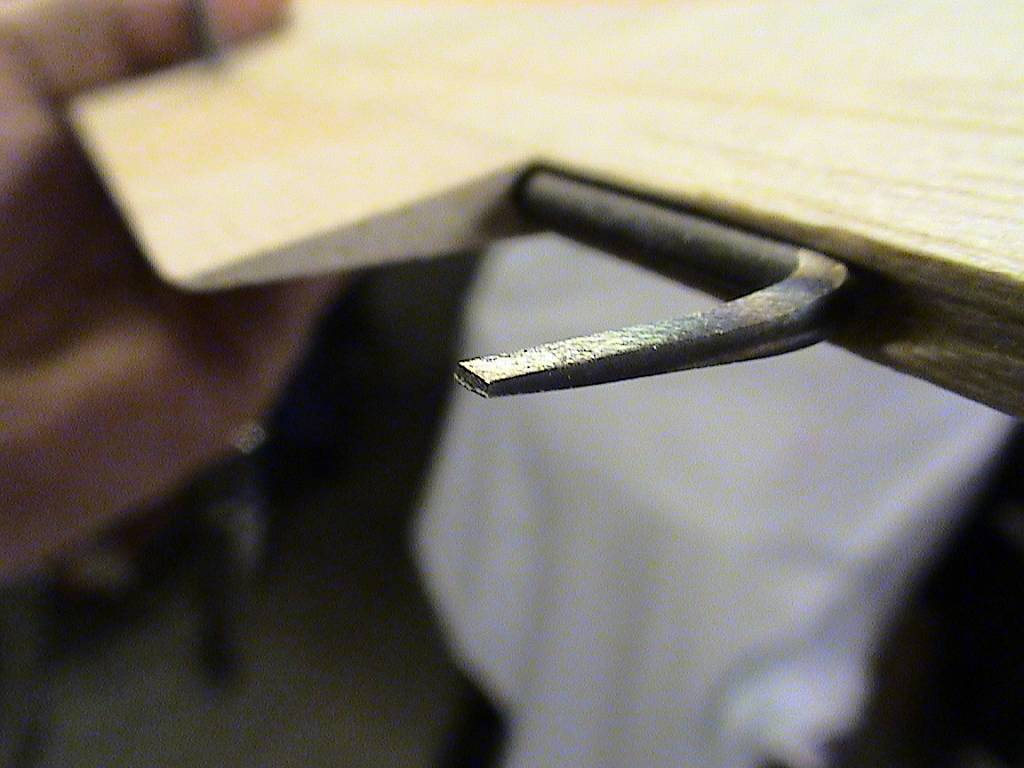

Hi!
Brown colored micro balloons is best!
You use them with either 24 hour laminating (not epoxy glue) or polyester resin.
When mounting the piano wire braze onto the elevators it's best to grind the wire web shaped on a grinder. That way you do not get those blunt wire edges.
