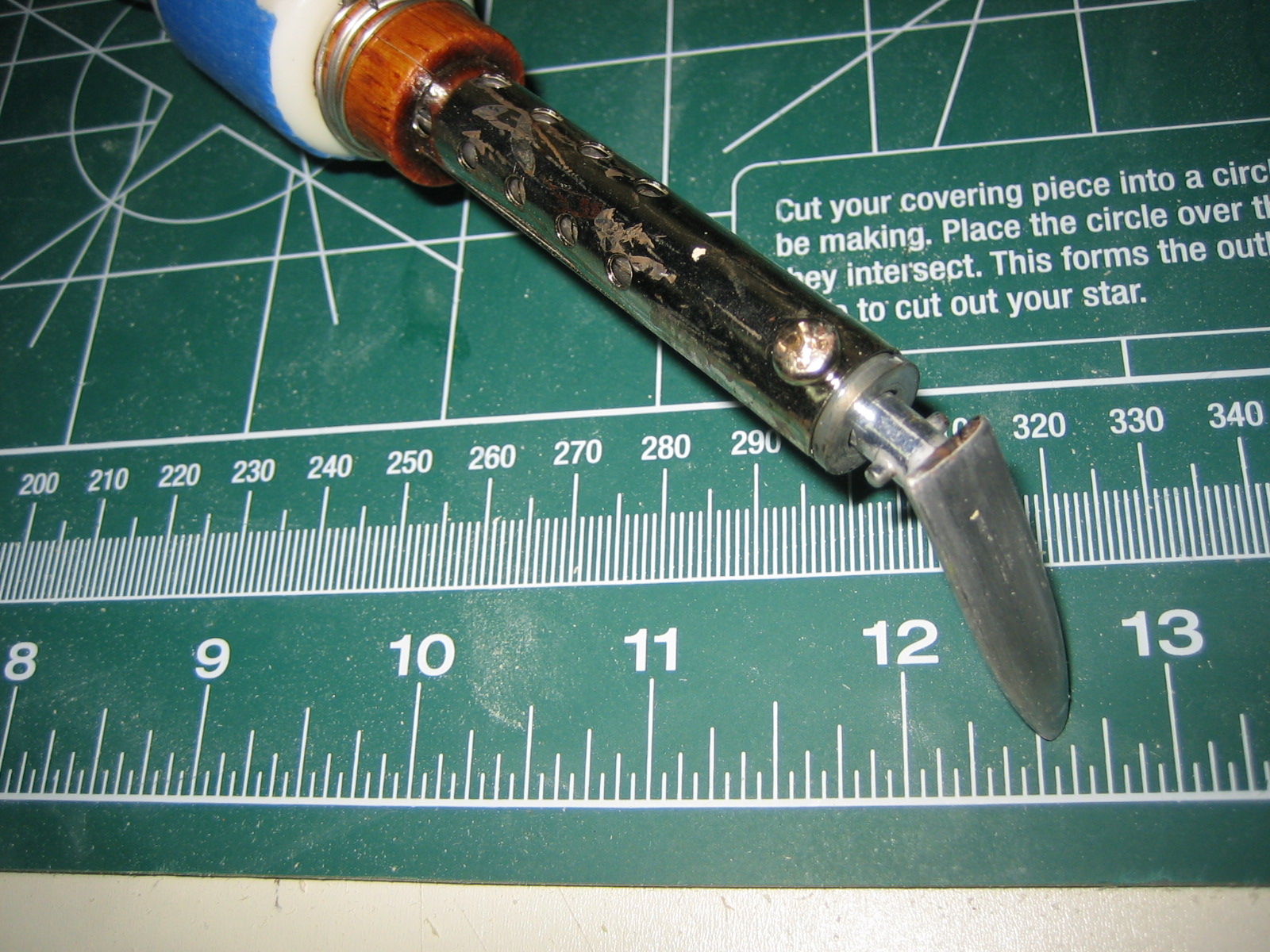

As SeamusG mentioned, always use a sock(cloth cover) for you iron. If you don't have the ready made one, go to some cheap baby store(Walmart, Target, etc.) and buy some baby socks-cotton preferred.
Old 01-30-2010 | 10:54 AM
Posts: 7,816
Received 10 Likes on 10 Posts
From: Upplands Vasby, SWEDEN
Default RE: Ultracote
Hi!
I never use a sock!
A sock prevents heat to be distributed to the surface...no good!

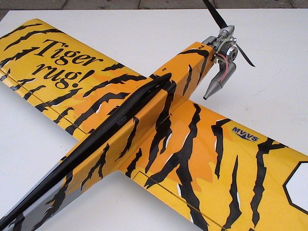

My Ultracote work has been coming out very nice now but I have a question. I have a terrible time where one color overlaps another as if you are applying a sunburst on a covered wing. Where the overlay is over an open structure I use a fine pin and pierce many holes in the primary covering. This allows gassing of the glue and prevents bubbles. The problem I have is when covering over a base film that is over wood structure. I have a terrible time with bubbles. I have tried 190 degrees and working in a rotery motion from the middle. All that helps, but I still get bubbles. I pierce them with a #11 blade tip and iron over, but most of the time that just moves the bubble. Argh!!!

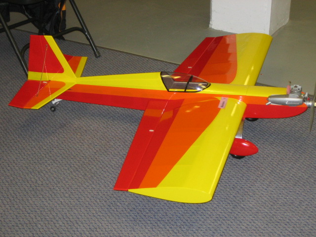

The attached pics are of a 4Star60 that I covered with a base film and trim pieces - no panels were pre-constructed. The SSEin my avitar was done exclusively with panels constructed on a glass sheet before covering the wings, fuse, or tail.

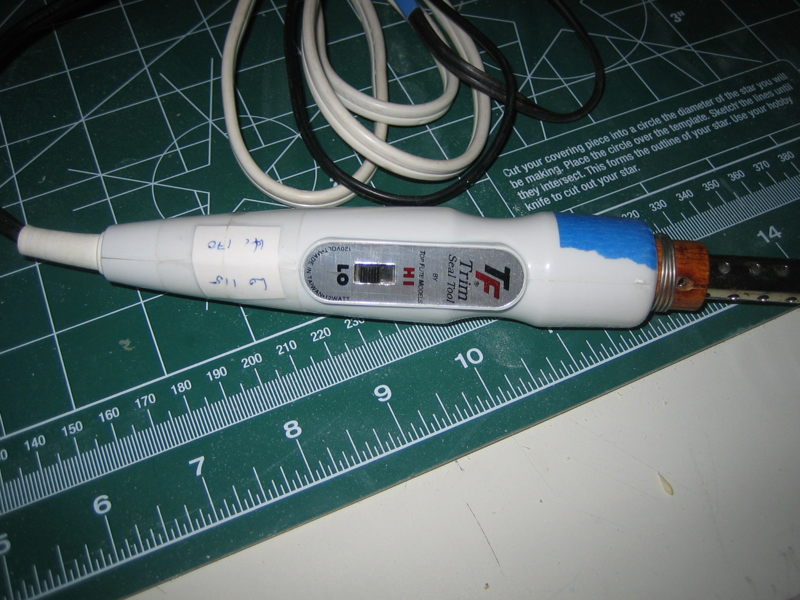

I used a small trim sealing iron that has a 2-position switch - high &amp; low set on low heat. That is enough to just activate the Ultracote adhesive. I did not prepare the base film to be covered in any way. I started at the middle of one edge and simply worked my way out overlapping each "sweep" of the iron with the previous pass. If I don't overlap I am guaranteed to have trapped air causing a bubble. It's slow going so don't try to make it faster.
On applying trim over a sheeted surface vs. over an open area. The sheeted surface takes the most time - aka - go more slowly - because the trim iron has a rounded bottom so the contact patch is relatively small when ironing on a flat sheeted surface. You have to overlap each pass. Bottom line it takes longer. The open surfaces are far easier because with the right pressure on the trim iron you can get the film to conform to the entire bottom surface of the trim iron - bigger contact patch. You still have to overlap each sweep but instead of dealing with a 1/8" contact patch you have a 1" contact patch. Same speed - you just heat 8 times the area in a given time period.
Check the 4*'s wing top out on the tip. Those pearl purple sections are trim pieces. Each piece easly took 30 minutes to apply. The yellow and red went on fairly quickly. Like driving a car - ya gotta go slow in the slow sections of track and fast in the fast sections. Go fast in the slow sections and you're gonna crash-n-burn.
The 4* trim wasn't perfect. An occasional bubble came up. After finishing the trim piece I used a brand new #11 X-acto blade and with the blade flat to the surface it was slid into the side of the bubble - with a low iron pushing the air towards the slit and then just pull the blade as the iron gets to the cut. No pins for me - they leave marks.

My last one came out near perfect, but as you I had some bubbles over the sheeted areas. The fine pin holes on the under layer are done before putting on the overlay and don't show at all because you cover over them. You must use a fine sewing pin though, not a clunky modeling T-pin. Here is a photo of my latest Sumpthin' Extra with a fairly complicated covering scheme.

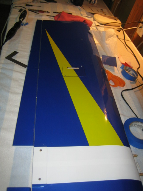

The best way to avoid bubbles is to remove the covering underneath - the larger the overlay, the more important this becomes.
Start by covering the wing, then lay the overlay in place and mark its position (red lines)
Remove the covering inside the lines, but leave some room for overlap
Apply the trim
A better way to do it (and the preferred method as it keeps the seams out of the airflow) is to cover it in 3 steps from back to front

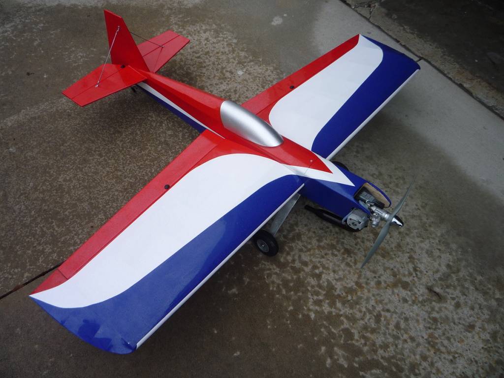

Ihad a similar film structure on one of my SSE - 3 color graphic on the wing top that did not follow any underlying structure. Pic 1 shows the end result. Pic 2 shows the 3 colors after the pieces have been cut out and taped together with at least a 1/4" overlap. Pic 3 shows the pieces after they have been seamed on a mirror. Glass works well for this as it is not porous and will not give the adhesive an opportunity to bite into the surface. Use a low heat that just activates the adhesive to make sure that the pieces are positioned correctly. If not you can pull them apart and reposition them. Once the inital seam is heated follow up with a hotter iron to fully activate the adhesive but not hot enough to shrink the film. Let the seams cool. Once cool the panel can be removed by pulling up from one side. The adhesive has a bit of a hold on the glass but not much. No adhesive will remain on the glass if film is allowed to cool. The panel can be applied to the wing as you would a single piece of film.
Ihave not stretched a panel seam over a wing tip or other similar form that requires some serious stretching. So far I've used a single color to do the tip. On the SSE I used a single piece of yellow and pulled it over all edges providing an excellent surface for the panel to adhere to on the end.
Like always, Ultracote cuts easily with a new razor blade or X-acto knife until you heat it up to "fully shrink" the panel - then it's pretty tough, expecially the pearl coverings.
HTH - yea, I know, my name isn't Mike ...
PS- here's some pics of the bottom panels too. They could have been applied following the LEsheeting, rib cap strips, center sheeting and TE sheeting but Ichose to make a panel instead.
