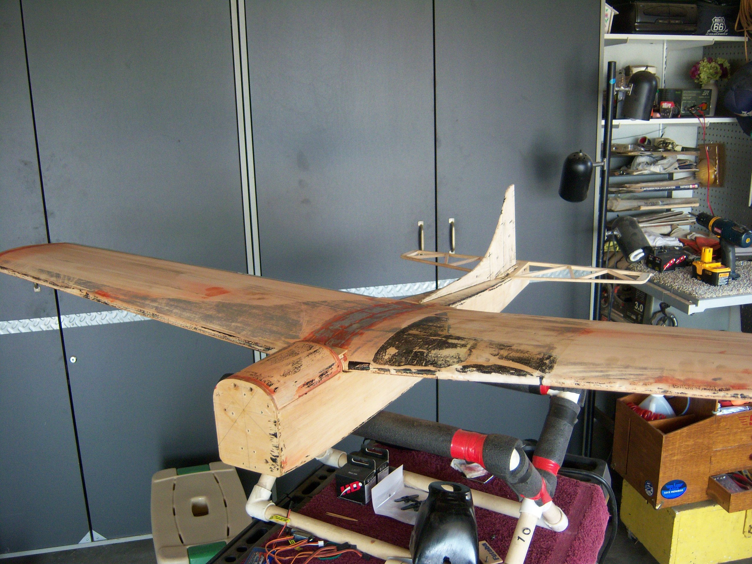

Here's a few "before" pics. I now know really what condition this thing is in. Although reasonably rough.... I'm actually not seeing fuel/oil anywhere... the firewall ares is clean of anything...There is signs that someone was planning an engine install... blind nuts in the firewall and such..... but there's no evidence an engine was ever ran on that firewall..... However, I do see damage on the left wing, crack/breach/break. I'd wondered as there was some splice in the covering.. so.. The repair looks suffiecient, yet puzzling.. and the wing is straight straight. The vertical stab didn't pass my "pressure test"... and I busted that away easily.. that was after I found the dorsal wasn't even glued to the rear turtle deck. After inspection, I found the vert.stab/dorsal didn't match the fuselage/turtle deck angles.... and someone just used a few scabs to make it fit... of which it didn't.
The wing repair is really true and straight though.. as I couldn't feel it.. until I saw the patches.. and even then I can't feel it.. I'm wondering now if this is a donor fuse... or wing.. as they don't seem to add up.. ha.. oh the mysteries of resto jobs right.
So at this point I have an airframe that in my opinion has never seen any air, and wasn't finished correctly obviously. What servo rail system is in there looks to be all balsa railing, with a ply servo tray screwed in.. hmm... I don't remember that from this era of plane.. I never screw a servo tray into balsa... so that will be addressed in time too... After less then an hour, I had most of the covering off.. just by hand... I didn't even need an X-Acto as it just kept pealing very easily ..
This little guy is going to learn what a sanding bar and sand paper is, and I'll make sure everything matches and mates as it should. I'm now thinking I'll go with my OS .46FXi, as it does need a home, and that way I won't have to pull the .70 out of another plane at this point.
So... Here's a Kommander that hopefully might see the sky someday..... probably for the first time for this plane... Wish me luck.

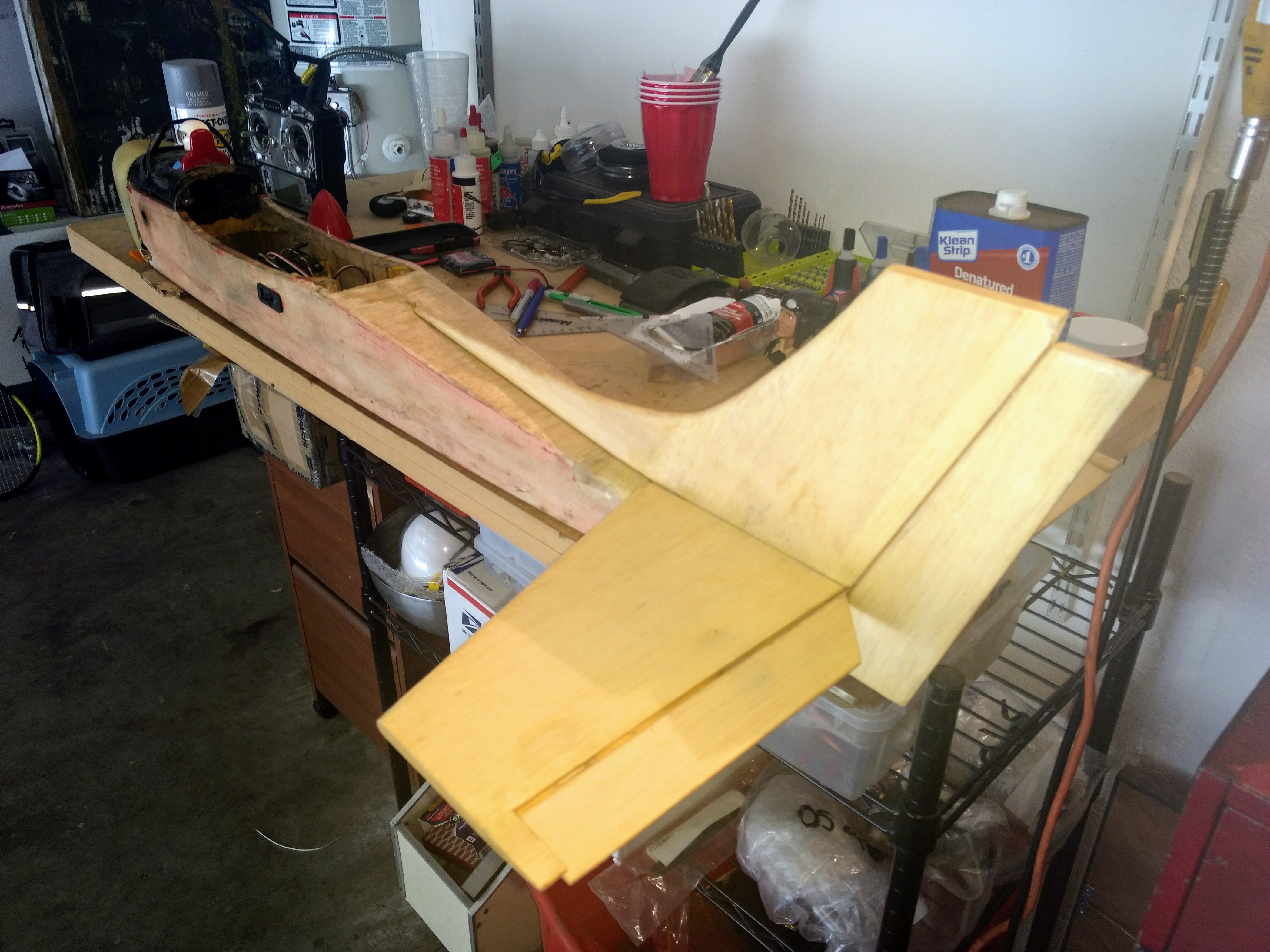

My resto-job is coming out nicely so far I think. I try and work on it a little each day. I'm still in the tear-down stage, and just about ready to build a new hor.stab, as the existing stab didn't pass my test.. Building a simple stick structure like that is the fun part I think. I've got to just pull out some stock to use, it's all simple 1/4" thick sticks, I'm sure you guys know.
I got the new canopy last Friday, great shipping from Park Flyer Plastics, as well as the cowl yesterday.. and again great shipping Fiber Glass Specialties... and the components all look fine.

My Kommander Resto is in much better shape lately, as it cleaned up well. I got it to a stopping point, and shelved it for a bit to work on other planes... but it's definitely going to get done. I've got the new canopy, as well as the cowling too... so I've invested a little into my "free" Kommander... ha. I've got to build a new hor.stab/elev... and it will also get new ailerons... all stock to do so is already on the shelf with the plane... I have tried to use as much original parts as I can though.
