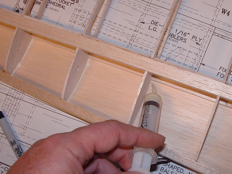

You can also get one of these handy-dandy little oral syringes at your local drug store.

I second the syringes!! EXTREMELY useful for tight places and controlling exact amounts and laying beads.

These work great and you can stick a T-pin in the end and it's allways ready to use.

Between builds, I take the glue out of the syringe and clean it with water.
DURING a build, I just stick the syringe nose-down in a glass of water and it's always clean and ready to use

Hey Guys, Thanks for the ideas. I stopped in a the local Vet. yesterday and picked up a couple of 10cc syringes and a needle. Wasn't sure how hard the needle was but tried a file on it and it did cut. I filed the point off the needle, cleaned up the small burrs and mixed some glue (about 2 easpoons ) with a couple drops of water. The needle and syringe worked great but the glue was a little runny. Tried again with unthinned glue and it worked just great. I thought I would have to thin the glue to get it through the needle, but not so. The needle I got is .050 O.D. and approx .032 I.D. The needle sure makes it easy to get into all the tight spots without making a huge mess. I got a beautiful little bead of glue right where I wanted it. Takes a little practice to control the amount of glue, but this does work very well.

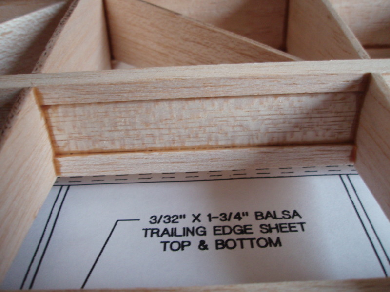

I would recommend not using glue fillets on thin wing sheeting. Especially if the wood is low density contest wood. This is because most glues shrink and you can end up with a hollow "bones" look to the skin after construction is complete. The other reason is that it adds weight and the strength of the glue to the sheeting is more than enough.
I do add some fillets at higher stress areas like where the ribs meet the spars, but in general just depend on a good fit with minimal glue.

Yes, but that picture was to show the syringe. And that is not thin sheeting

Thin sheeting would be 1/16" balsa or thinner. Contest balsa would be under 7 lb/cu foot balsa. The localized stiffness of material is proportional to the thickness squared, so 3/32 balsa is slightly more than double the stiffness of 1/16" balsa.

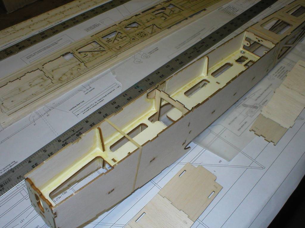

Am I correct in my thinking that glue fillets are a simple way of building a mechanical mechanism to keep a butt joint in place?
Be forewarned that Titebond fillets dry to a dark amber color. If you are planning a transparent covering consider something else.
For what it's worth a local building guru uses aliphatic resin (Titebond original is his preference), a wet cotton swab to clean off all glue residue and finally thin CA on the inside corner of all the joints. Yea, he's pretty anal and goes to the extreme of cutting a dado joint in lieu of butt joints. All of his coverings are transparent - just to show off his craftsmanship. And how much time and patience do YOU have?

Here's my LT-40 wing with liberal Titebond Standard fillets ...
No transparent covering for THISwing!

Joined: Aug 2009
Posts: 420
From: Gunton, MB, CANADA
Default RE: Glue Fillets
Hey folks. I thought I would try uploading a photo for the first time. This is how most of the fillets turned out using the syringe and needle. Of course some of the early ones don't look like this.

Perfect

Actually, the liquid glue left will form a small fillet with the typical curved surface. Too many people make the glue fillet much too large. It doesn't take much. If you're going to make them, the ones pictured a couple of posts up are perfect, as Minn said.
