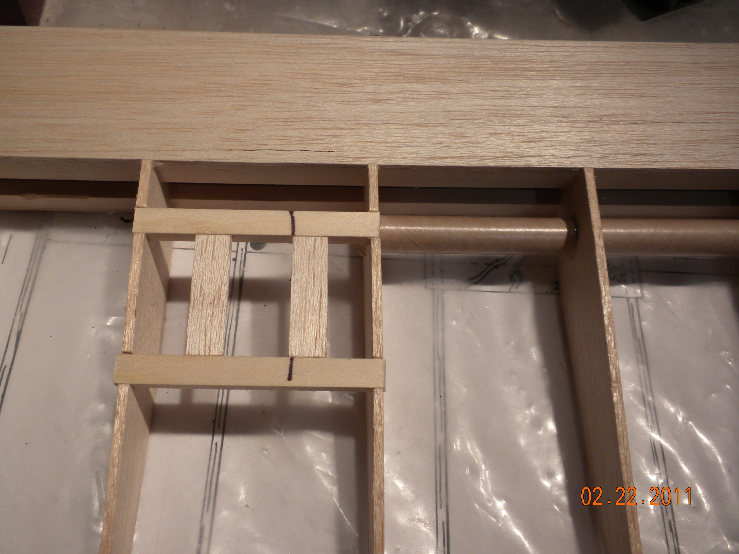

After debating on adding ailerons to the upper wing, I decided to go with it. I followed the information from Jeff Canfield who wrote to Balsa USA in regards to modifying the upper wing http://www.rcuniverse.com/forum/m_66..._3/key_/tm.htm
I purchased some balsa sticks and .5" x 1.5" x 36" ailerons. I was going to use 2" ailerons but it would not match to the lower ailerons.
I don't want to throw any dirt on the company, but I don't understand why they didn't modify the kit, which would make the Phaeton 90 a better flier after they agreed with Mr. Canfields letter. While building this kit, I did find flaws to the kit which includes in the instructions, cutouts, and wood pieces that were too short. I had to purchase an extra birch stick because the birch stick in the kit for one of the spars were short by 6 inches.
The picture of the rib is how I got it in the kit. Apparently, the balsa piece was not set right when the rib was stamped.

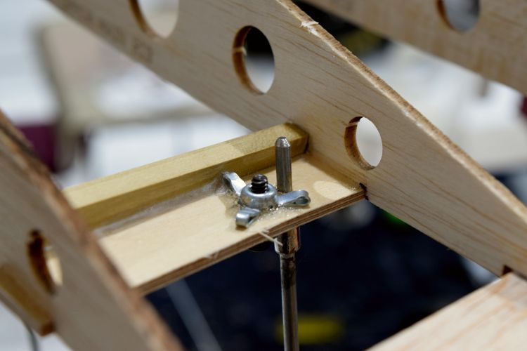

Here are a couple things I did different on mine.
1. 1/4-20 wing bolts, used 1/4-20 flush wood inserts
2. Upper wing center bolts, 10-32. Added wood to mount and installed flanged wood insert nuts.
3. In the past on the N-struts, I have had the 4-40 nuts work lose and fall into the wing. I used 6-32 collapsible rivnuts from McMaster-carr #90186A311 which I also glued.
4. I added a 1/4" hard wood to rear of rear mount.
5. For the N-struts I also used electrical terminals on the end. Easier to mount and solder. I used those on my previous P-90's years ago. Digikey #277-11157-nd
6. Main upper wing mounts were listed as copper but they were steel. I went ahead and welded them on.
7. Top of fues removable to gain access to batteries without disassembling airplane. Was trying to find large straws to run Allen bolts through. Couldn't find them so I rolled some paper and made straws:
