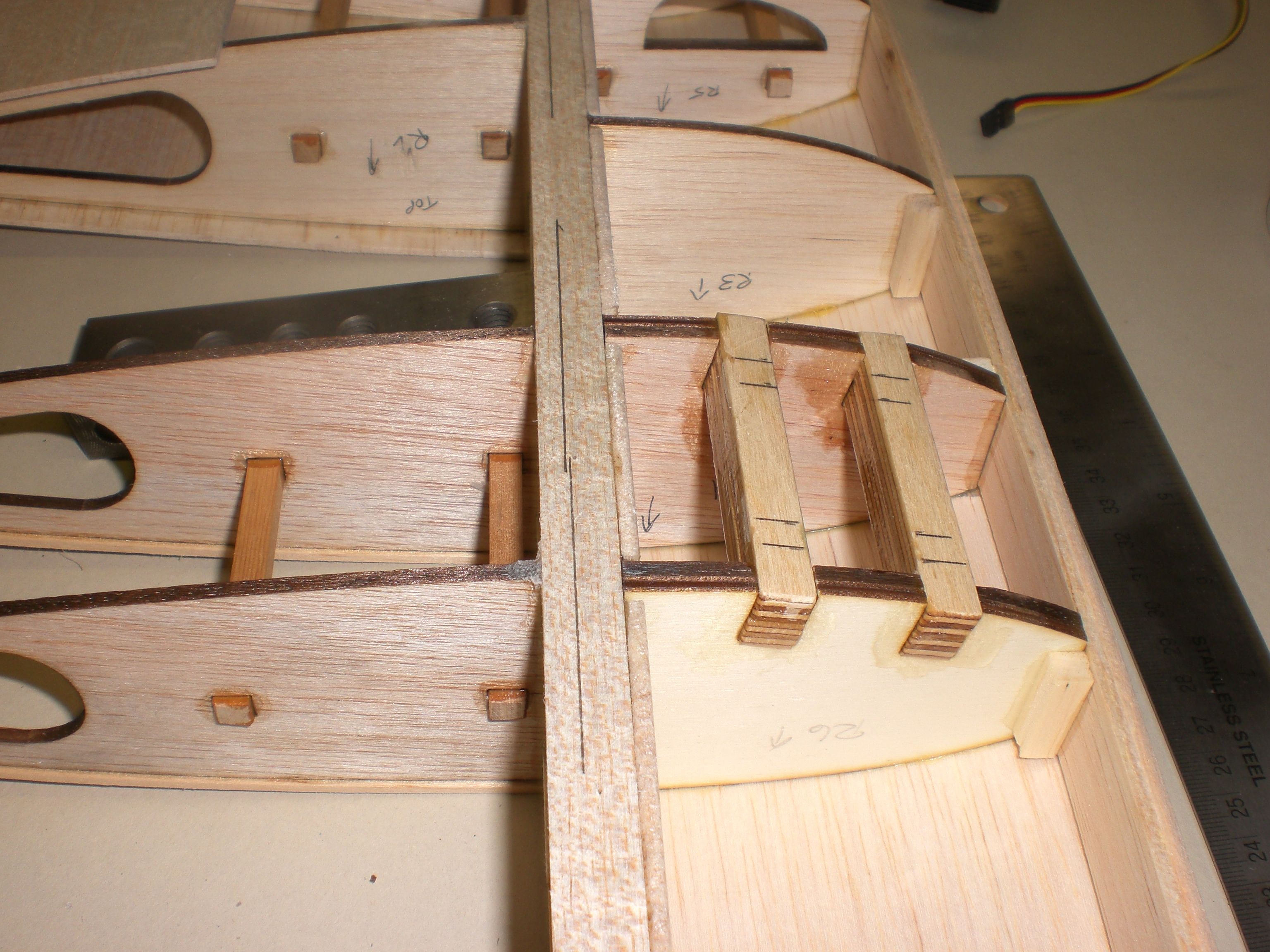

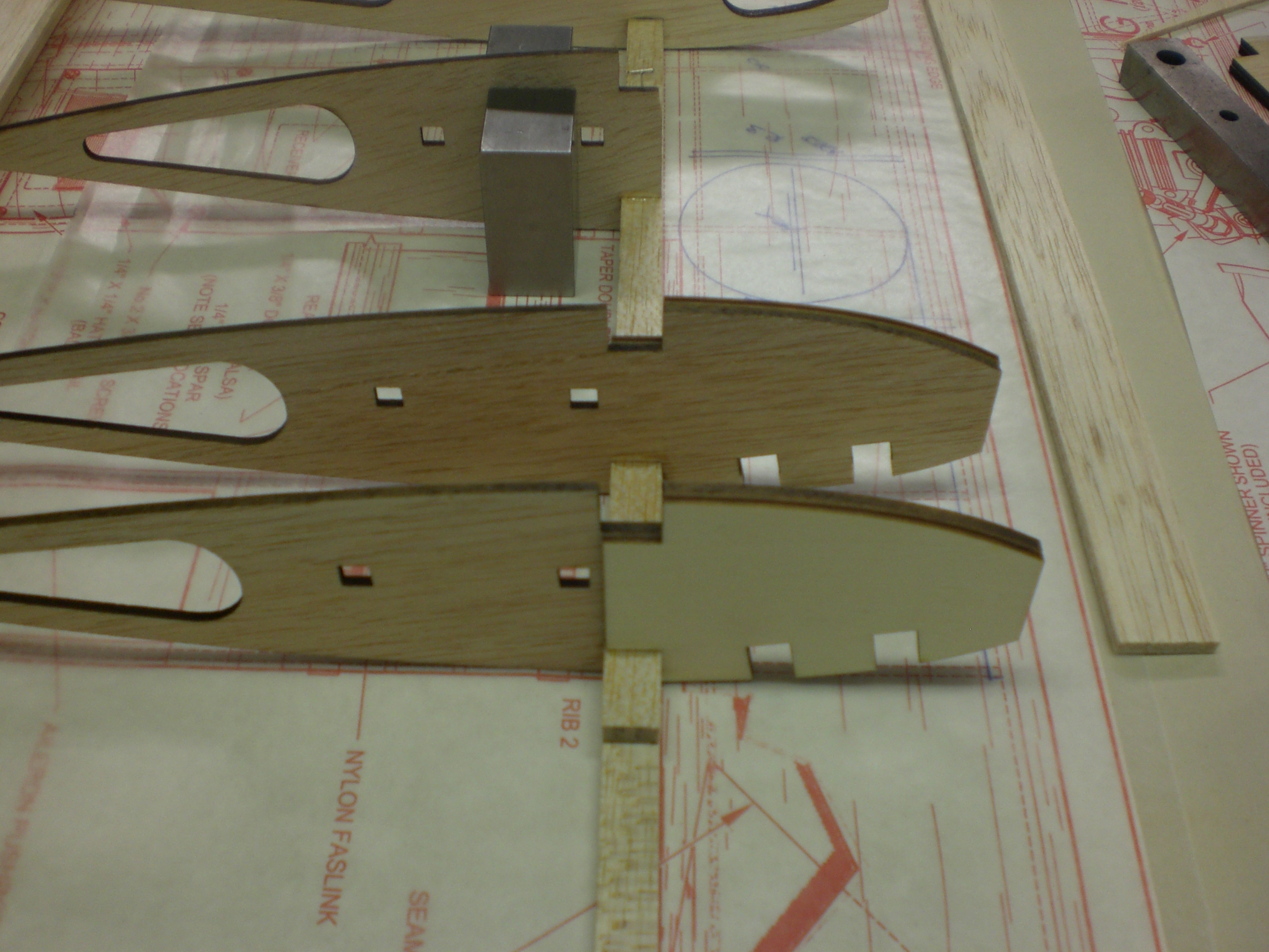

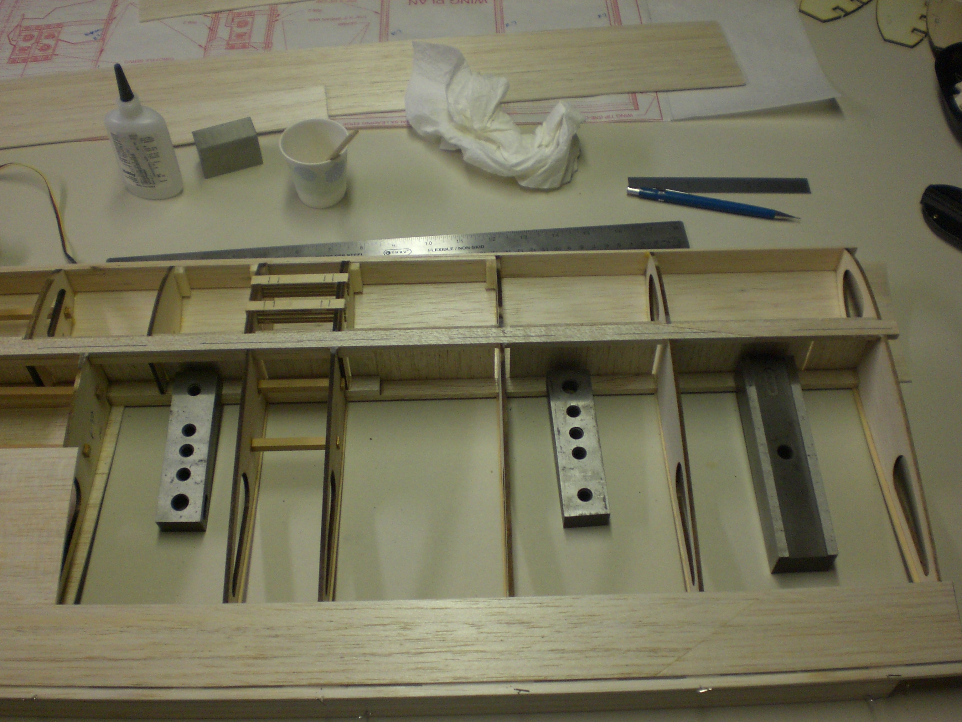

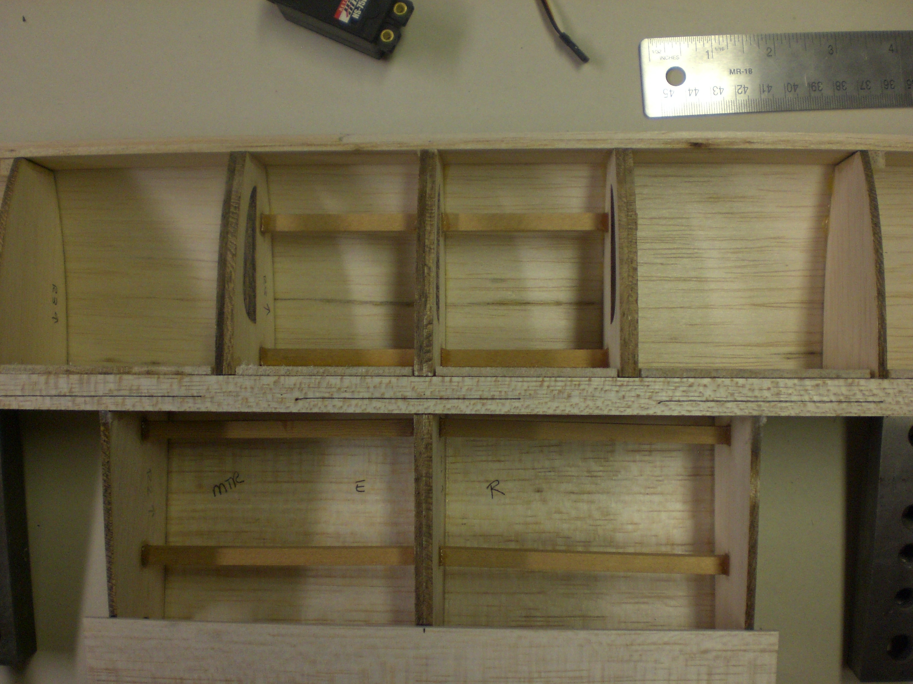

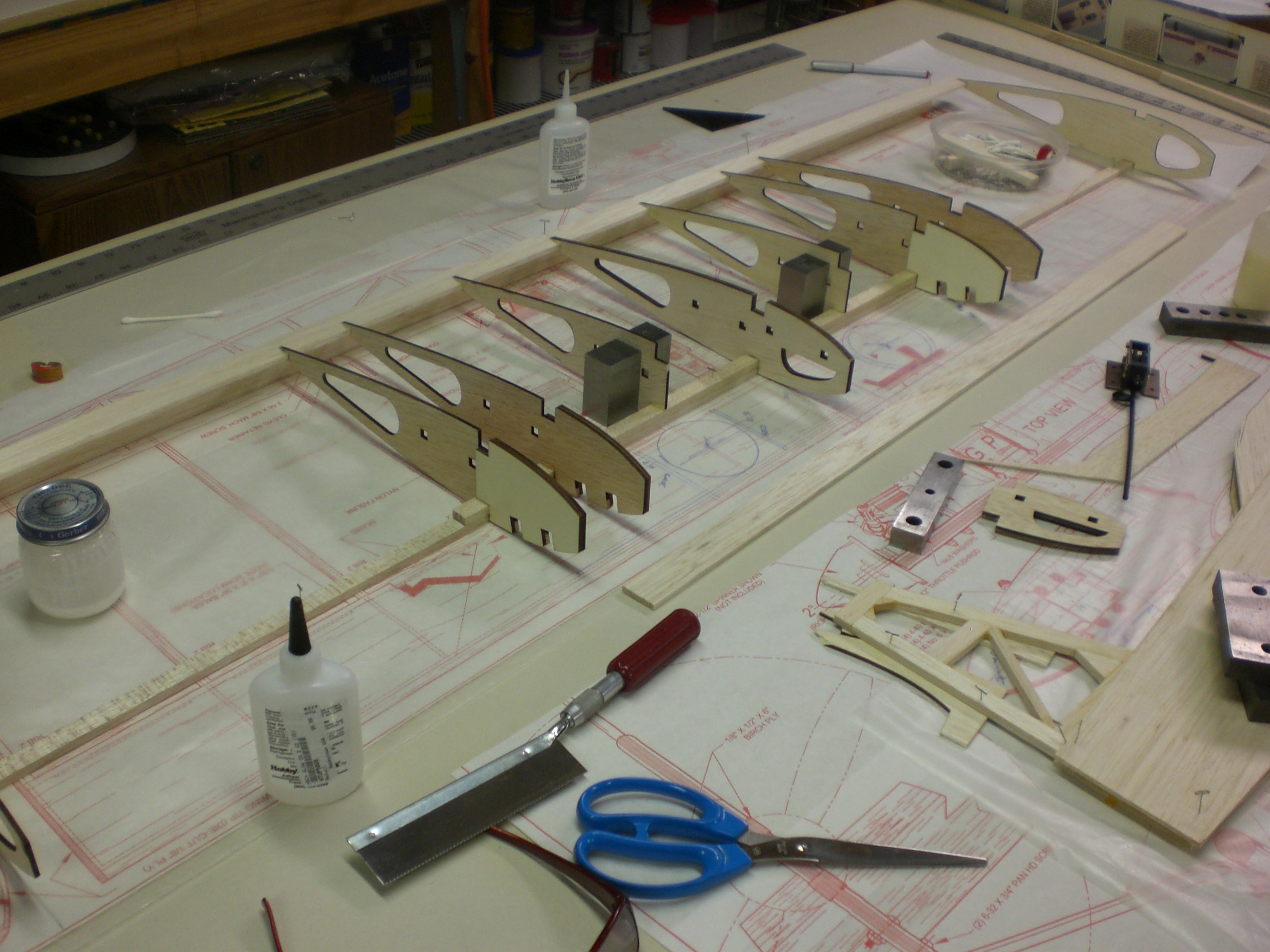

I now have the fuse ready to sand and the wing ready to add the leading and trailing edge sheeting. I will complete the retracts before adding the bottom leading edge sheeting. Around $100 in balsa and light plywood to build this plane. Thinking about blue monocoat with a yellow nose.

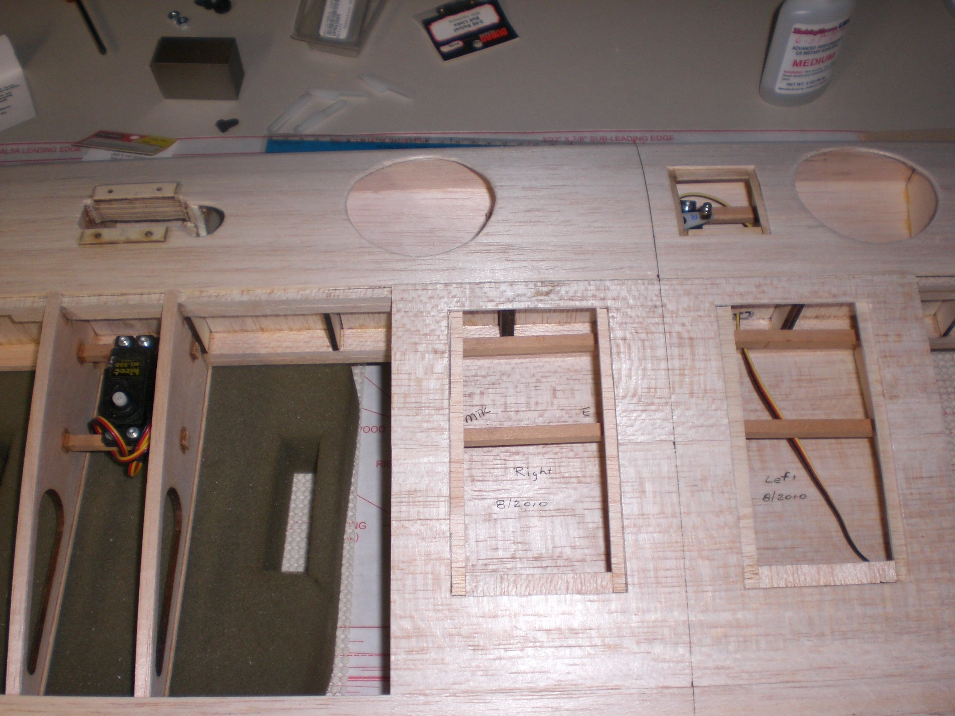

Old 08-23-2010 | 08:36 PM
bps's Avatar
bps
Posts: 1,348
From: Indianapolis, IN
Default RE: Scaled up Tower Fun 51

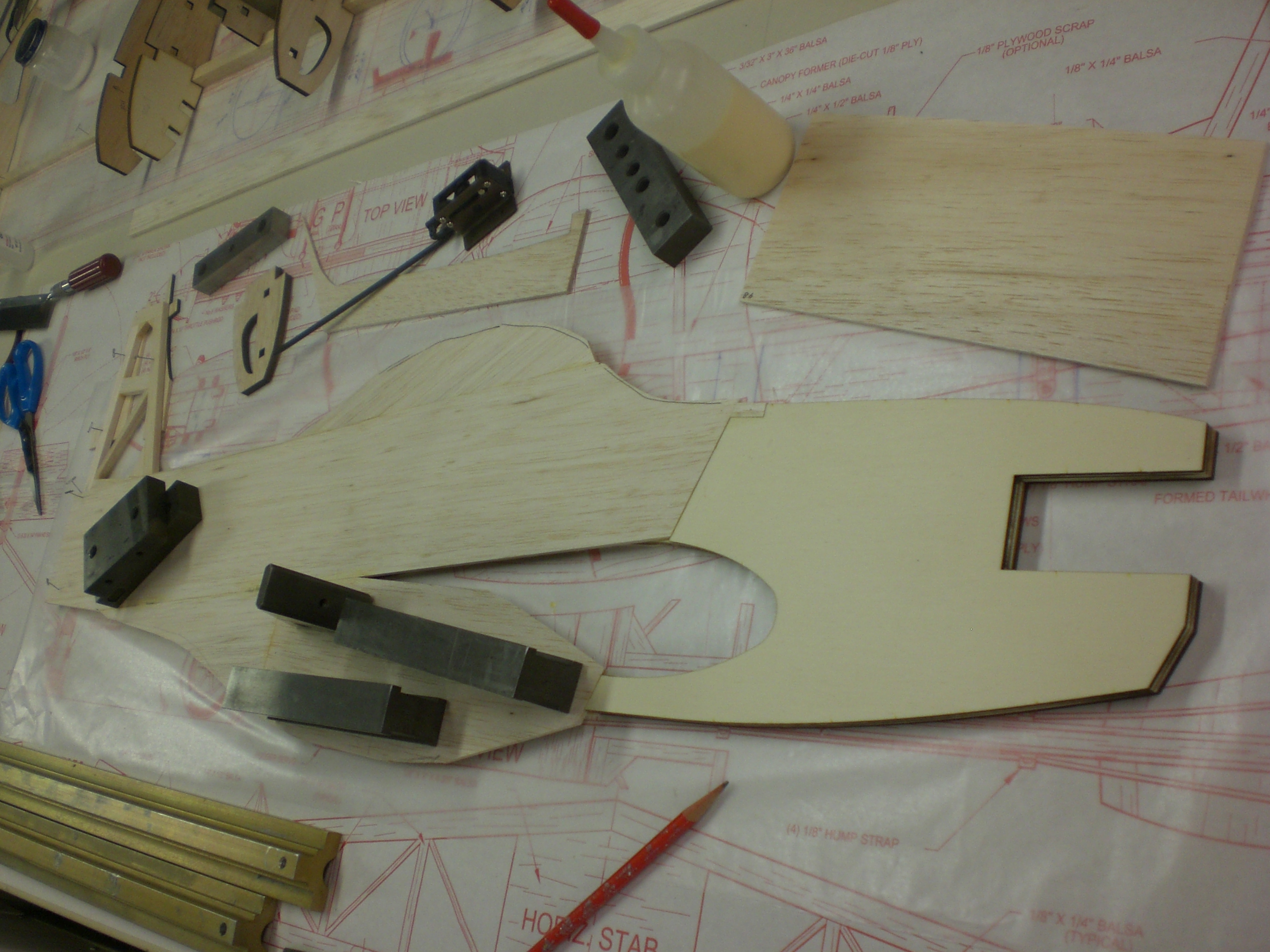

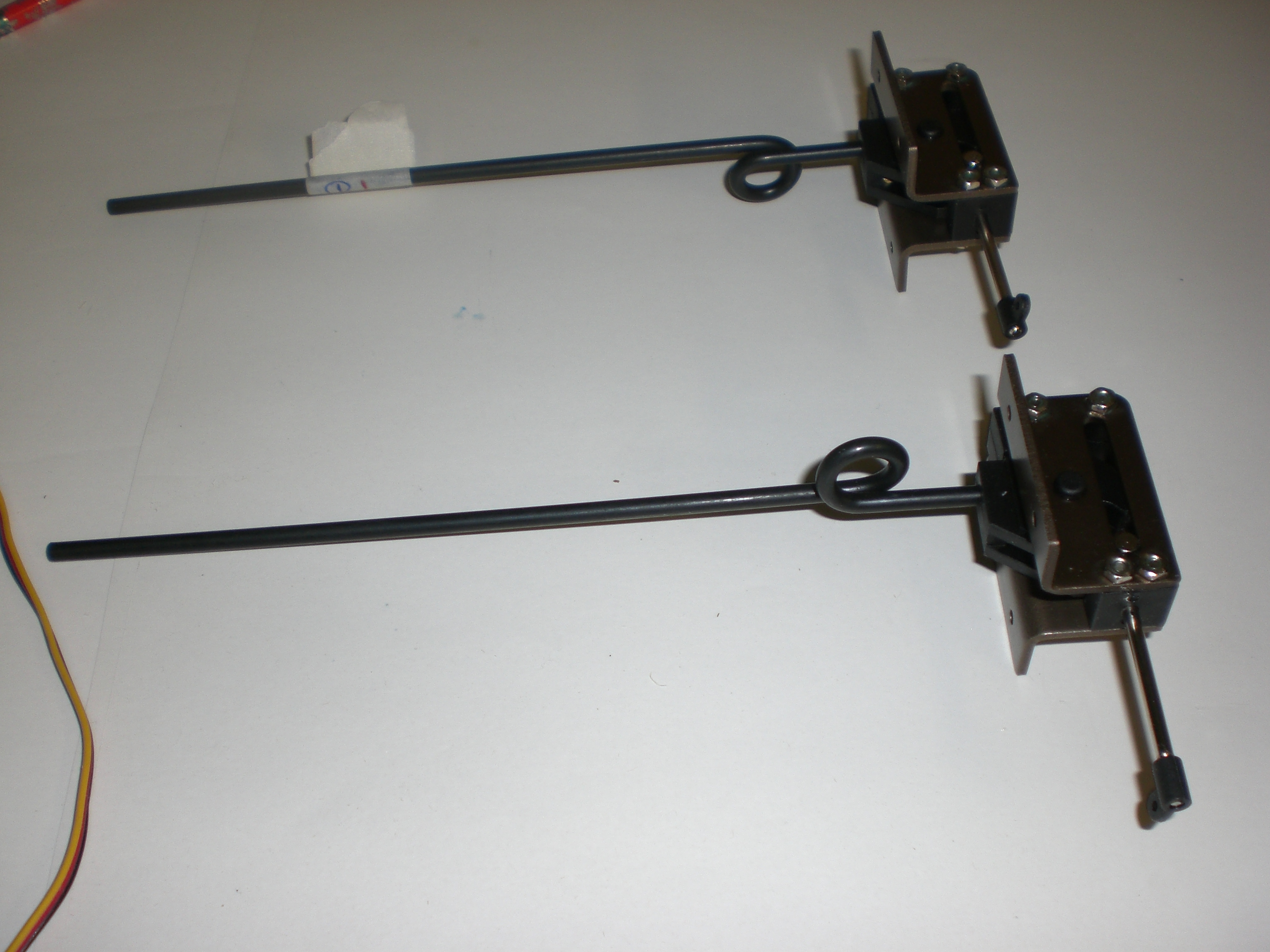

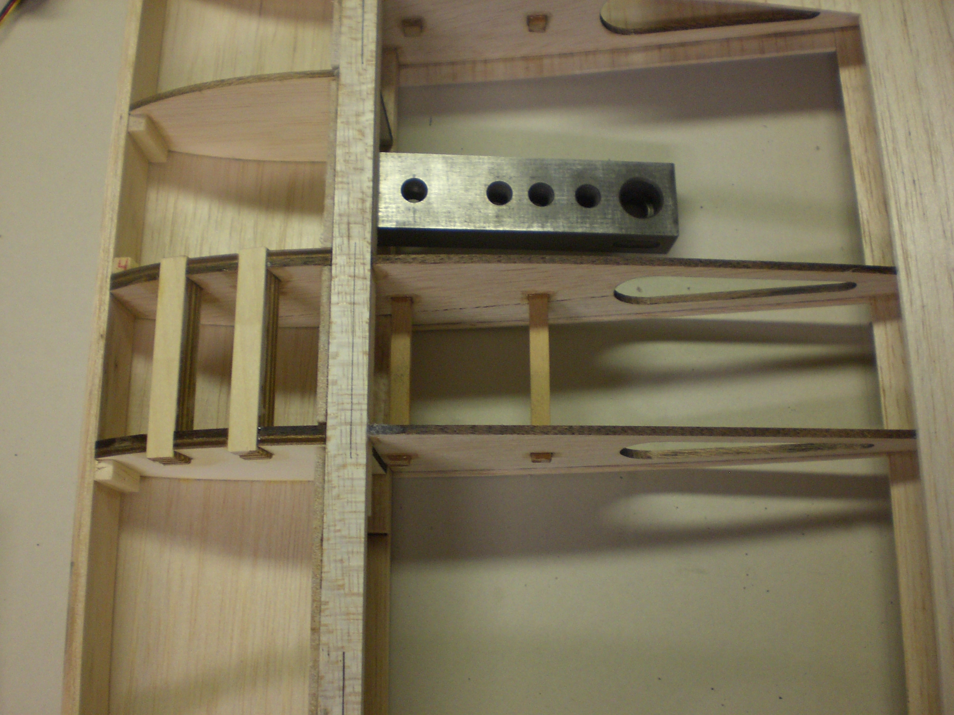

I just about have the wing construction finished. Installed the retract rails and when the epoxy dries then I can fit the retracts and servo. Retracts are mechanical and fit like a glove in the area just in front of the aileron servos. More later.

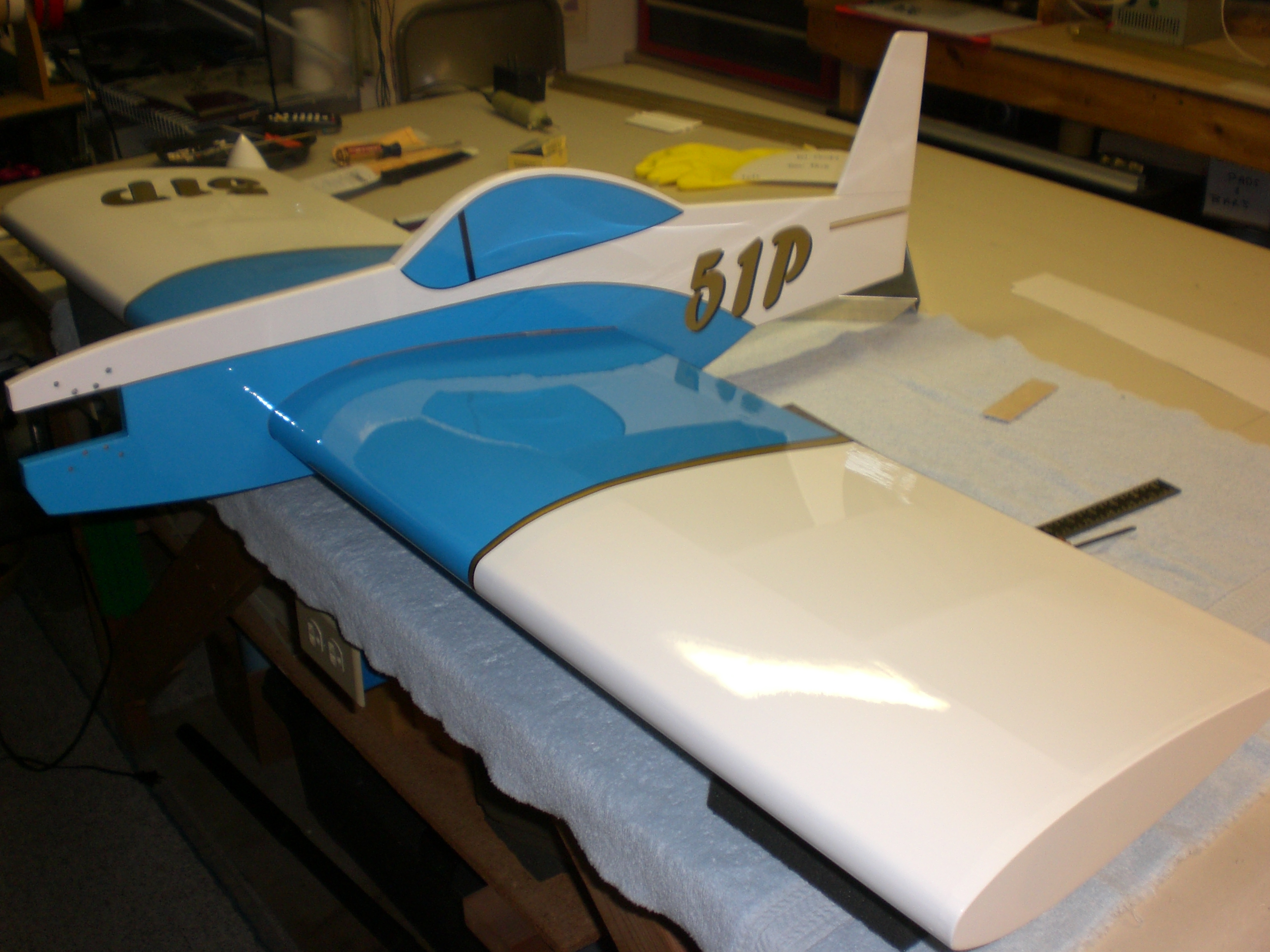

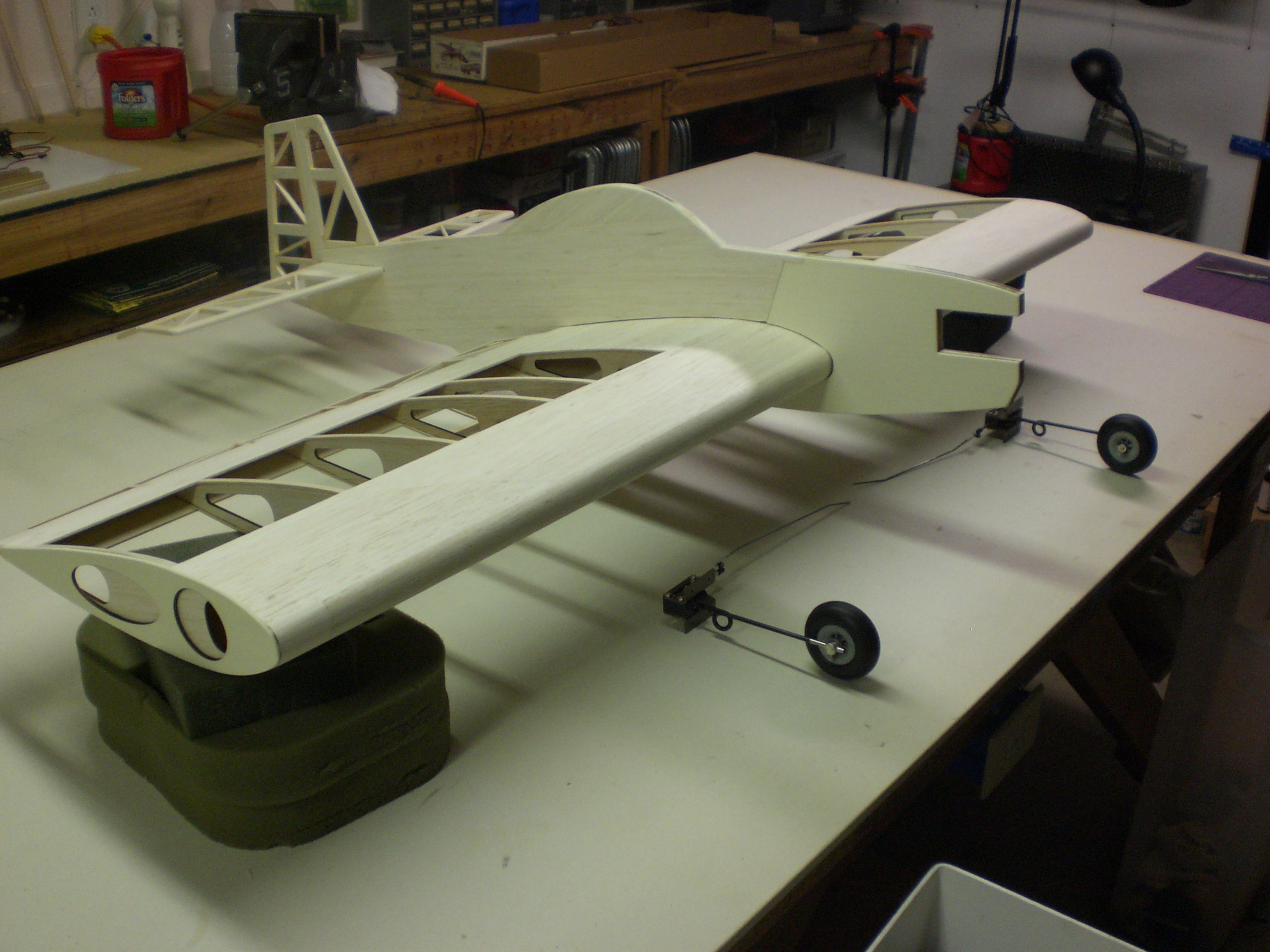

Here is the larger Fun 51 inch wing span just about ready to cover. Retracts have been fitted and the airframe sanded smooth ready for the blue and white cover job pictured below.

A couple of pictures of the plane in dress being assembled. another week or so to go!

They are just adhesive vinyl graphics film. Gold numbers with black shadows. The gold is transfered onto the completed finish using a low tac transfer tape that looks a lot like masking tape. I use this tape for a variety of jobs. Once the letters or numbers are in place then the black shadows are slid in place using windex on the surface. Use a paper towel to squeeze out the windex under the decal and just let it dry for overnight. Smooth down the decal with finger pressure and clean the area with a little more windex and wala! I have a decal and tag business where I make industrial identification products for machinery and control panels. I also have my own laser. Makes life a little simpler! At least it would if the economy would pick up more.

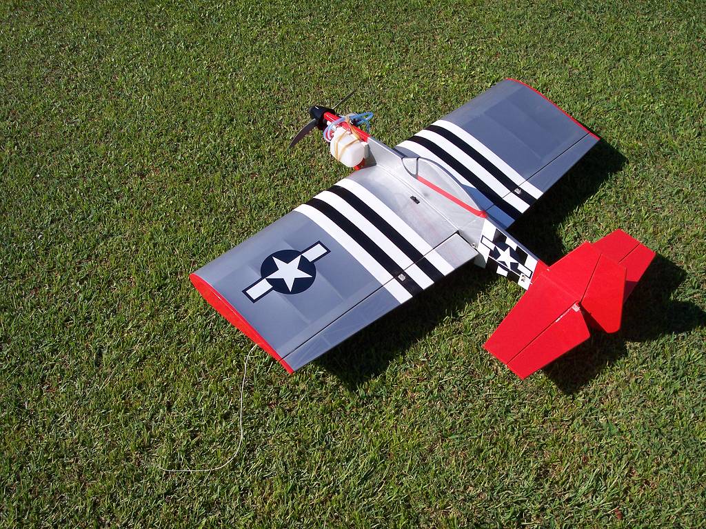

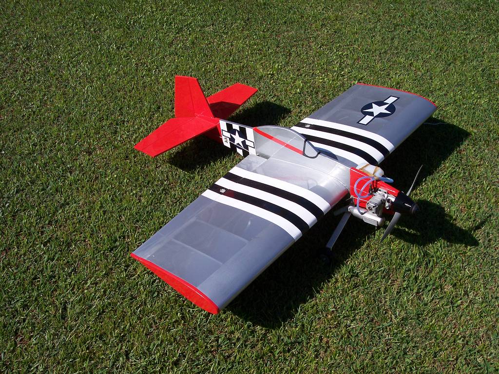

Your build made me dig mine out of the rafters, dust it off & fly it today....Gene

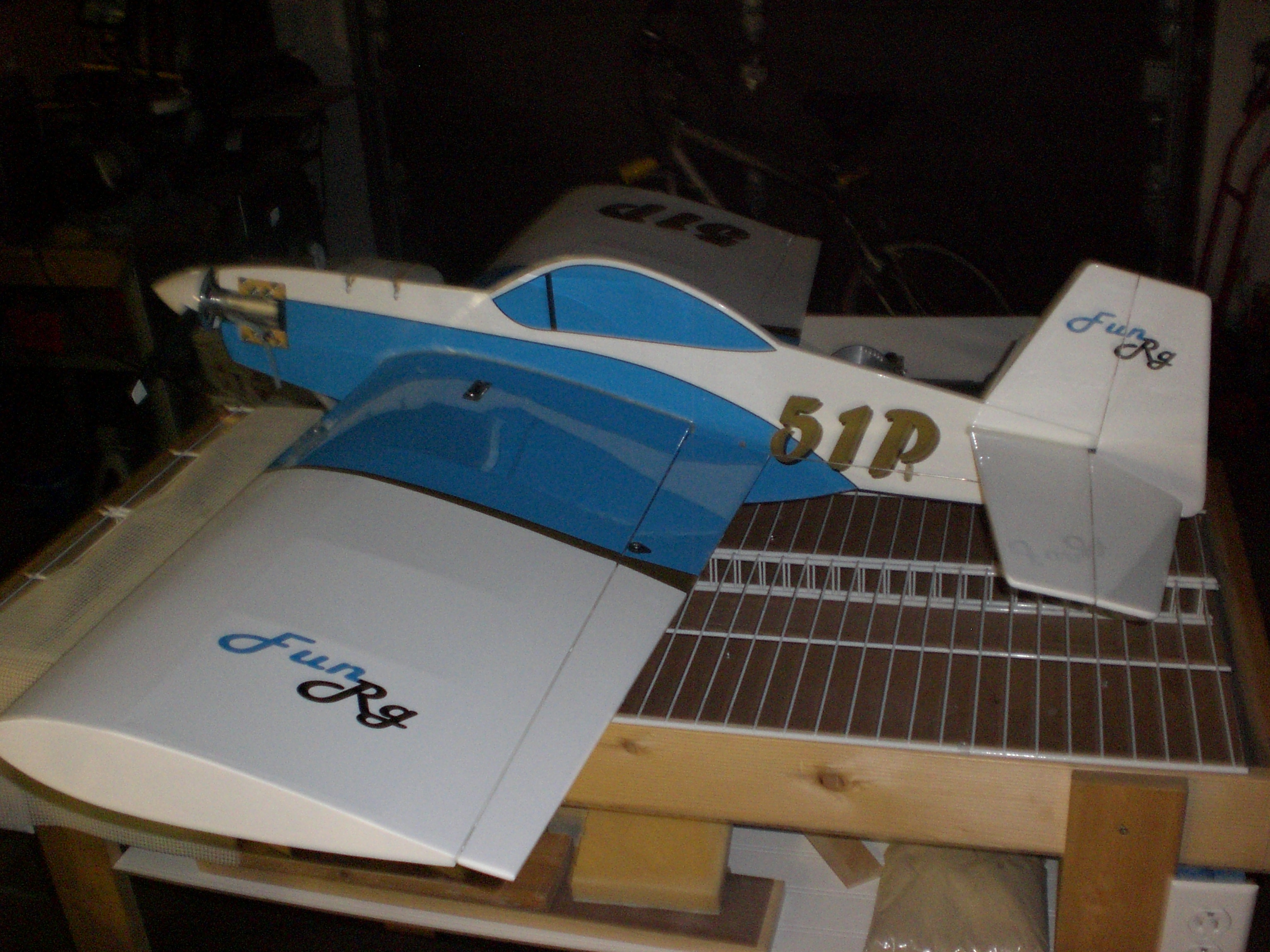

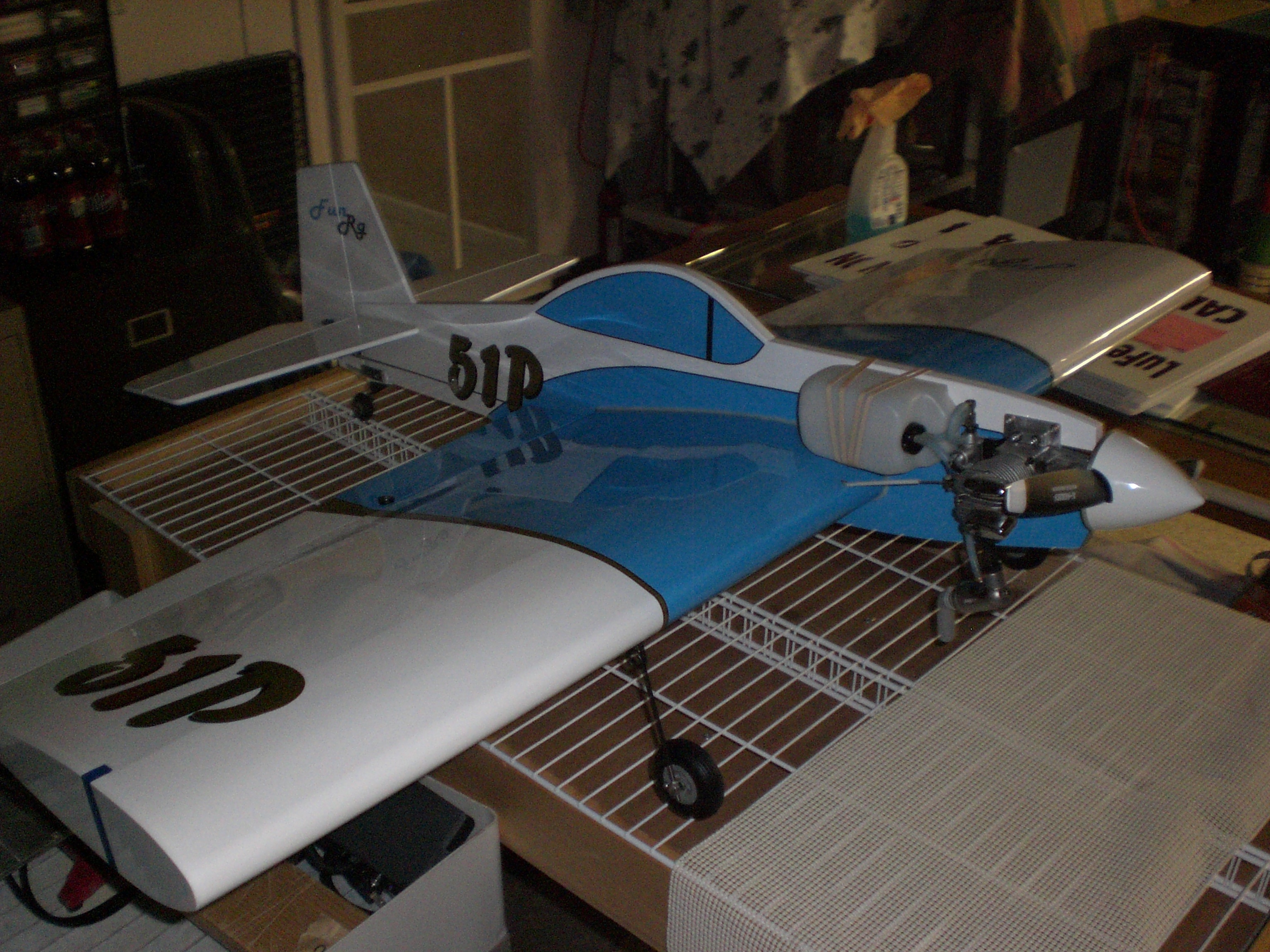

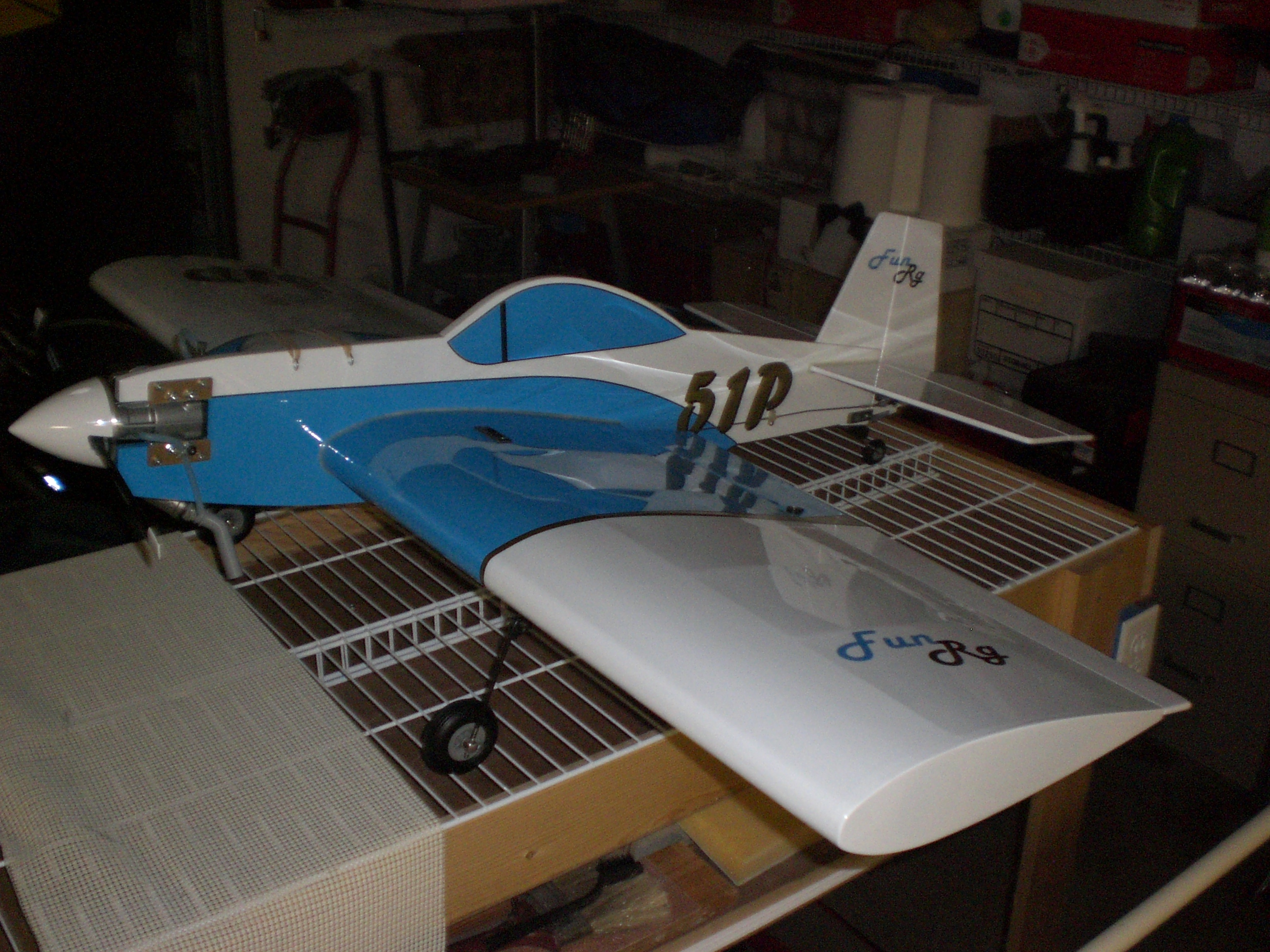

I am finished! Maiden flight maybe this afternoon if the weather co-operates. Would have flown it yesterday but by the time I finished chores it was just to late and the weather was not all that good anyway. With a Saito .82 5 digital Futaba servos, with one Hitec retract servo and a NImI 6v 2a battery the plane tips the scales a touch over 6 pounds. With the battery moved as far rearward as possible I still had to add 1.75 oz of weight to the tail[:@][:'(][&o]. I just hate to add weight! A wise designer once advised me, " If you must add or change something, add simplicity and lightness"! Flight report to follow.

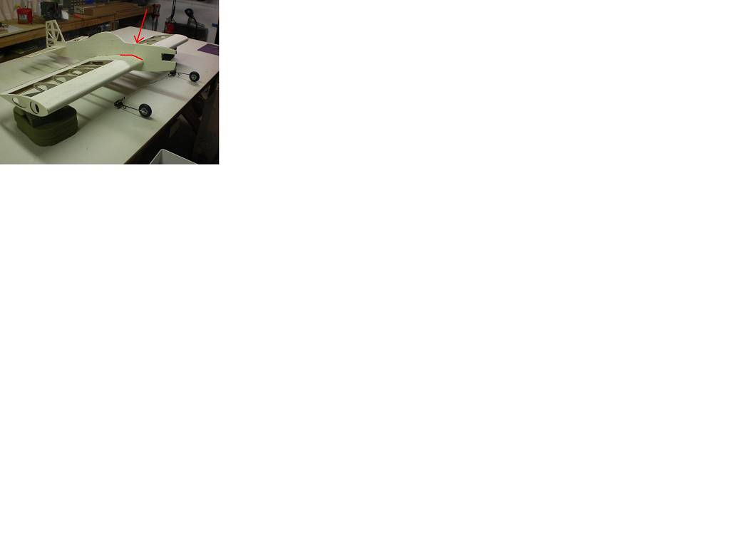

Flew the 51 last evening. The Saito .82 4S is plenty of power and pulls this plane straight up. Gear reatract function just adds to the fun. I do have one big problem though and it will need to be repaired this winter, ending the flying season for this bird. The joint where the fuse meets the wing developed a crack. I think this is mainly due to the vibration that the Saito creates, it is a bunch. Spinner, prop ballanced and rechecked. My fix will be to add 1/4" ply to both sides of the fuse back to the rear edge of the wing. That should stiffin things up considerably.
I am also considering moving the motor back an inch to help with ballance. I did have to add a touch of weight to the tail. With the extra ply on the nose I will need to add more tail weight. Looks like about an inch would do it.
The last modification I plan is to add a tube on the bottom of the fuse to carry the crackcase drain and exhaust. The Saito creates a bunch of mess along with all that power.
I plan on fireing the engineer on this project as soon as I complete these mods! He gets fired a lot.

ORIGINAL: bps
The joint where the fuse meets the wing developed a crack. I think this is mainly due to the vibration that the Saito creates, it is a bunch. Spinner, prop ballanced and rechecked. My fix will be to add 1/4'' ply to both sides of the fuse back to the rear edge of the wing. That should stiffin things up considerably.
Could you use the wing as a stiffener fot the fuse?
The fuse hole for the wing, combined with the distance to the engine, make the section that developed the crack the weakest point from the nose back.
If you could make a solid joint between the wing and the fuse, no additional reinforcement or cover work would be needed.
Just and idea.

Thanks for the suggestion. I think not though. This area was glued with epoxy, then a nice smooth fillet of epoxy was placed around the wing/fuse joint. The Saito just shakes the entire front of the fuse and the needle valve can become a blurr at just the correct throttle setting.
I already have the motor off and the doublers made for the front. Just a matter of stripping off the covering, grinding off the epoxy and glueing the new doublers in place.
Also found that an empty butane container will make a great expansion chamber for the exhaust system. This should collect the oils and deposit them out the bottom of the plane where they will do less damage. I will post pictures of my progress.
