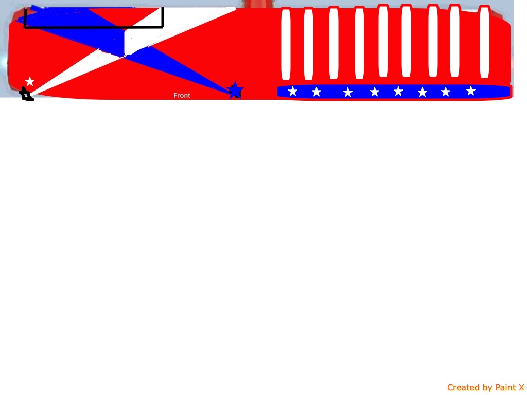

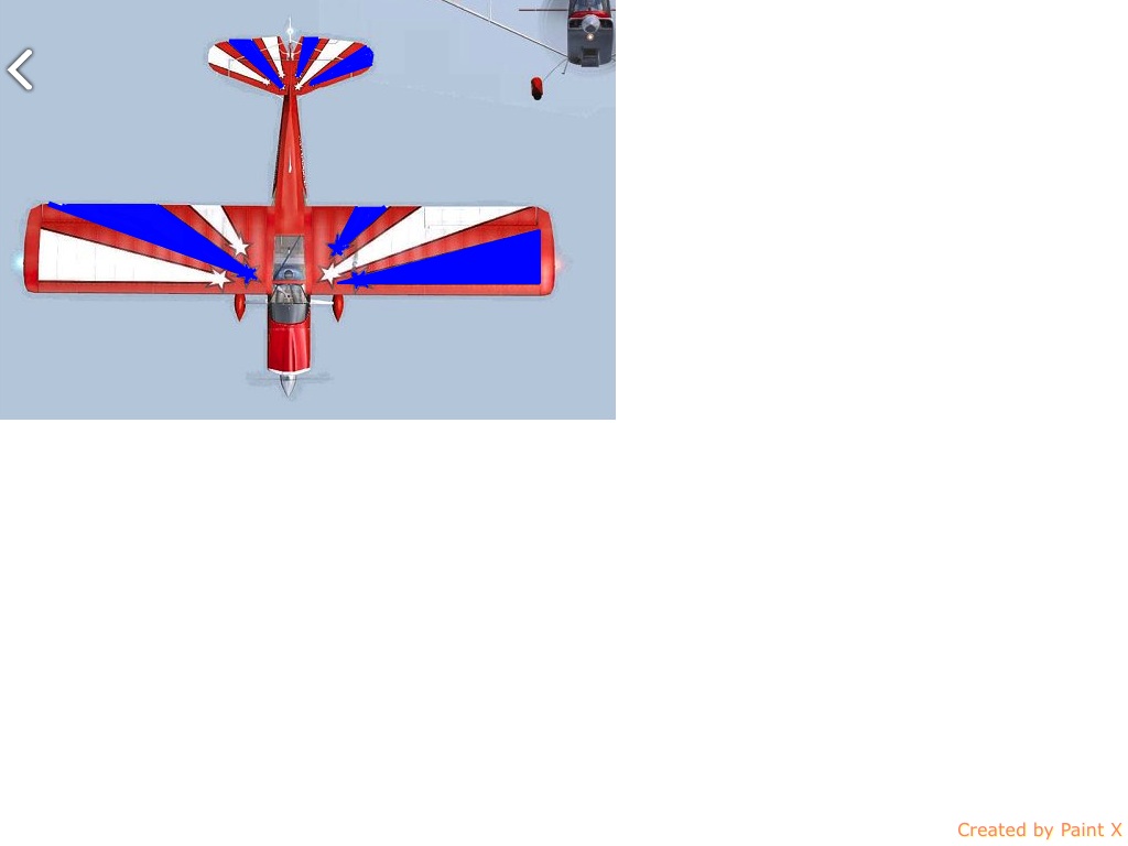

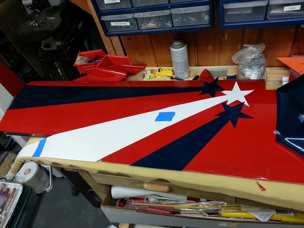

mattnew 11-27-2013 08:37 AM
1 Attachment(s)
http://www.rcuniverse.com/forum/atta...mentid=1942896
quick and dirty paint sketch of what I'm currently planning for the stars. Blue stars will be outlined in white, white outlined in blue. Still says "Decathlon", but its something a bit different.
mattnew 11-27-2013 08:38 AM
Originally Posted by bsheridan2002 (Post 11672035)
Matt,
I've been following your progress and would like to see your covering ideas. I'm almost to covering stage on mine and while the star burst is classic, it is dated. I'm debating some sort of update on it myself. I built the tail to plans with lightning holes, moved the servos to the cabin to move the weight forward as much as possible. Power will be os 200 4stroke
post some pictures! this doesn't need to be all my work...
mattnew 11-27-2013 08:48 AM
1 Attachment(s)
http://www.rcuniverse.com/forum/atta...mentid=1942898
Couple ideas I have for the bottom. I've always liked the look on the left , had it on a sig wonder about 10 years ago.. it really makes the bursts pop out of the wing. the right is a variation on the standard decathlon scheme to make it look like a flag…
I'm very undecided on these parts as of yet...

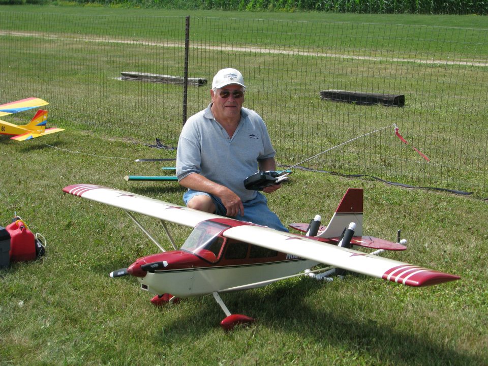

loopdeeloop 11-27-2013 10:01 AM
1 Attachment(s)
Here is my Decathlon with non-traditional paint scheme taken (in part) from a Canadian registered airplane. Mine has been flying since 2010 and started life with a 25cc converted Homelite. I later came by a 30cc Homlite and two years ago installed a DLE-30. I don't remember the weight needed up front to balance the airplane but I made a contoured box out of balsa to hold an appropriate amount of BB's. That box was then filled with epoxy and then secured on the lower edge of the firewall. The box is only 1/2 inch wide and follows the contour of the bottom edge of the firewall so it doesn't look like just a lump of weight in there. Course you can't see it anyway with the cowl on. This model weighed in at a rather hefty 18# but it was covered with Sig Koverall, and painted with Krylon. Although the airframe appears to be over-built as was pointed out earlier, it is a tough bird. Before I had the DLE installed, I had a flame out during climb-out. The inevitable stall resulted in a heart wrenching thud as it angled into the ground. The damage was limited to a bent wing joiner tube, an aileron servo mount pulled loose, and the port side strut mounts pulled loose. Repairs were easy to make and she flies very nicely. If you are flying off a less than smooth field I suggest reinforcing the landing gear by simply making another gear but without the bends for the wheel pants and wheels. Fasten the two together using machine screws. The stock gear tends to bend on even a slightly rough landing -- although if you can bring weight into the 14 - 16# range as the specs indicate, the stock gear may be ok.
http://www.rcuniverse.com/forum/atta...mentid=1942936
kman712 11-27-2013 12:21 PM
Nice change, I vote fit the one on the left as it is different than the standard wing bottom but still ties into the overall design of the model. How did you create these drawings?
mattnew 11-27-2013 01:13 PM
Drawings were just grabbing a 3 view of a decathlon off of the web and then using a paint program… most operating systems have a cheapo paint program installed as part of the "goodies" I just used that one.

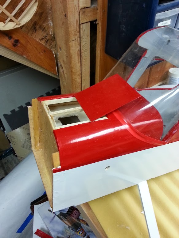

mattnew 12-05-2013 08:49 AM
2 Attachment(s)
@funnotcrazy:
I did something similar with the nose:
http://www.rcuniverse.com/forum/atta...mentid=1944995 http://www.rcuniverse.com/forum/atta...mentid=1944996
The intent here is that I'll mount the ignition device in here and have somewhat easy access to it should it be needed. It may never be needed but the option is there. Its also accessible from the bottom through a drilled access hole.

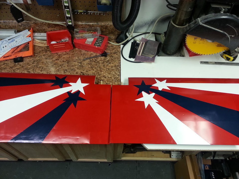

mattnew 12-09-2013 07:22 PM
2 Attachment(s)
http://www.rcuniverse.com/forum/atta...mentid=1946311 http://www.rcuniverse.com/forum/atta...mentid=1946312
starting to line up the stars on 1 wing.. I ran out material for the stars, going to have to get some more… doh.

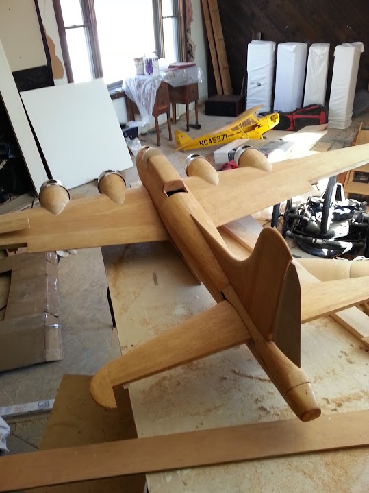

mattnew 12-15-2013 10:07 AM
1 Attachment(s)
Funny, I took about an 8-10 year break that I've only recently broken where the only times I was flying was when I went to my parents and flew Dad's planes. Through college and most of my 20's I didn't have much time for hobbies...Now that I have kids of my own I've started it up again in the hopes of giving them an interest in planes and hoping to pass on everything my dad had given me over the years that we had build and flew together.
The Decathlon is my first "giant scale" and my 2nd full build since I got back to the hobby... I guess by today's standards it isn't giant anymore… but it is my easy build to get a large plane experience under my belt… and larger plane experience when it comes to flying… though that part isn't really too new to me...
I ended up replacing almost everything I had.. I still have it.. but 10 years in an attic is hell on electronics and whatnot… and I love buying new toys :-)
Since you like scale, you might like the other plane I have on my bench at the moment.. I'm trying to get the decathlon finished so I can get this one done this winter as well...
http://www.rcuniverse.com/forum/atta...mentid=1947678
I know I've posted pics of this before… but I love it and can't wait to have it done.

mattnew 12-22-2013 08:17 AM
1 Attachment(s)
B-17 is the old Royal kit. My dad had started it in the 70's and never had gotten a chance to finish it, mainly b/c .19 sized engines just weren't reliable enough back then, and with no engines.. not a whole lot of point in finishing the plane. I'm converting it to e-flite power 15's and finishing it in flite metal ( if my order ever arrives… another story entirely… ) and hoping to have it flying by the spring. 77" wing span, hope to have it come in at under 10 lbs… more likely it will be 12 lbs when finished though.
http://www.rcuniverse.com/forum/atta...mentid=1950079
still have to put outline tape around the stars, but here is the top of the wing, more or less done. I think it came out pretty good.
