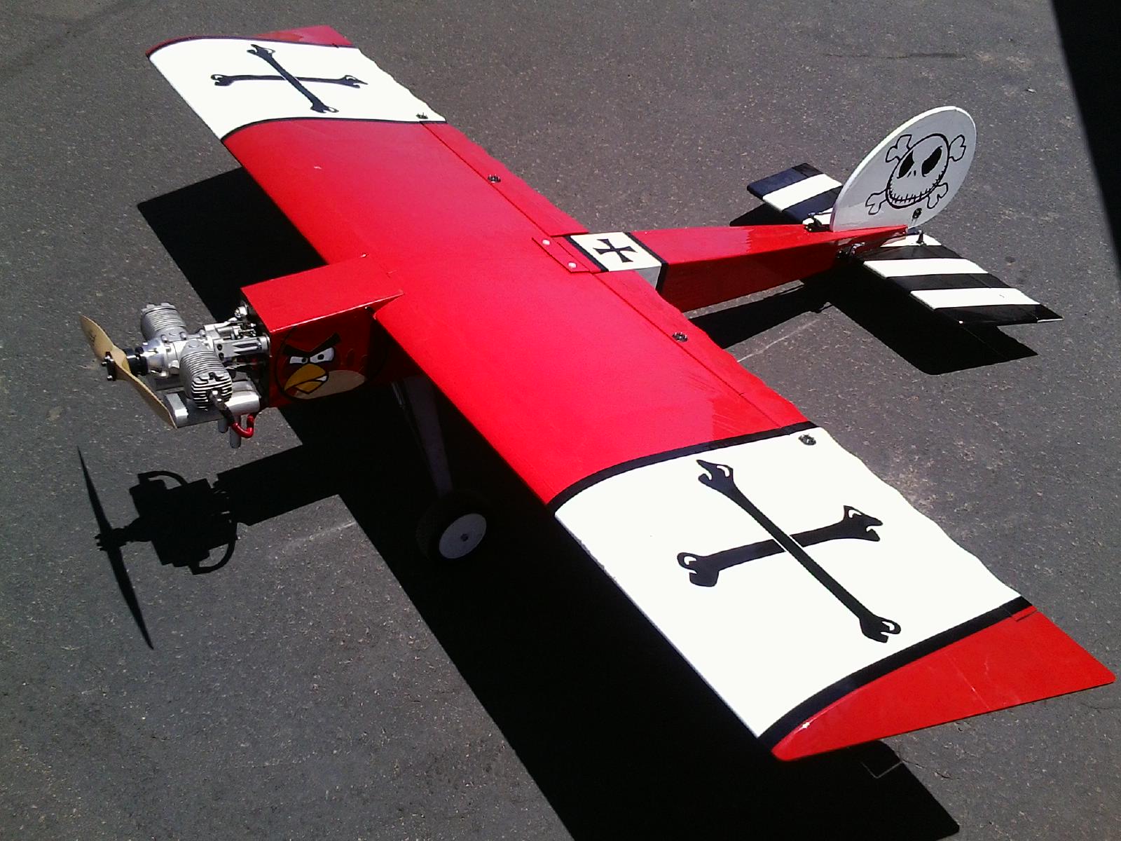

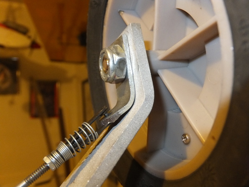

Thanks, that's good to know. Maybe I will do like I did the the GP Giant Stick I had. Its gear were really, well, a joke:
http://www.rcuniverse.com/forum/atta...mentid=2009272http://www.rcuniverse.com/forum/atta...mentid=2009273
Here is what the motor I want to use looked like on that air frame:
http://www.rcuniverse.com/forum/atta...mentid=2009274

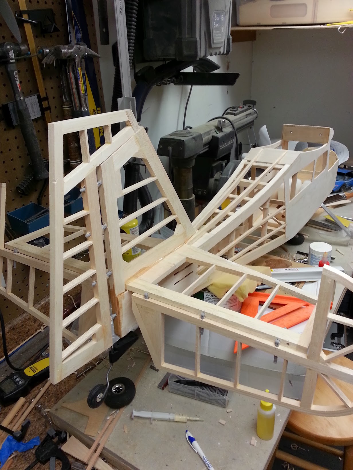

mattnew 01-20-2015 05:59 AM
3 Attachment(s)
Originally Posted by trainermaster80 (Post 11965000)
Mathew, i am getting ready to build a dynaflite super decathlon. Have followd your post. Would like to see pics of your fusealoge build when you get that far.
Having read all the post i could fine on the decathlon i am amazed at all the different engines used. Some
with nose weight & some without. Is it he wood density that makes one guy use nose weight & the other not
trainermaster80 frankie. Get on u tube. "stefan pointner pilot 70 ". He has a blk & white one 71cc must see video. May have to look at side bars to find correct video. Flys knife edge most all the flight. Wow!
:-) When I get that far ....

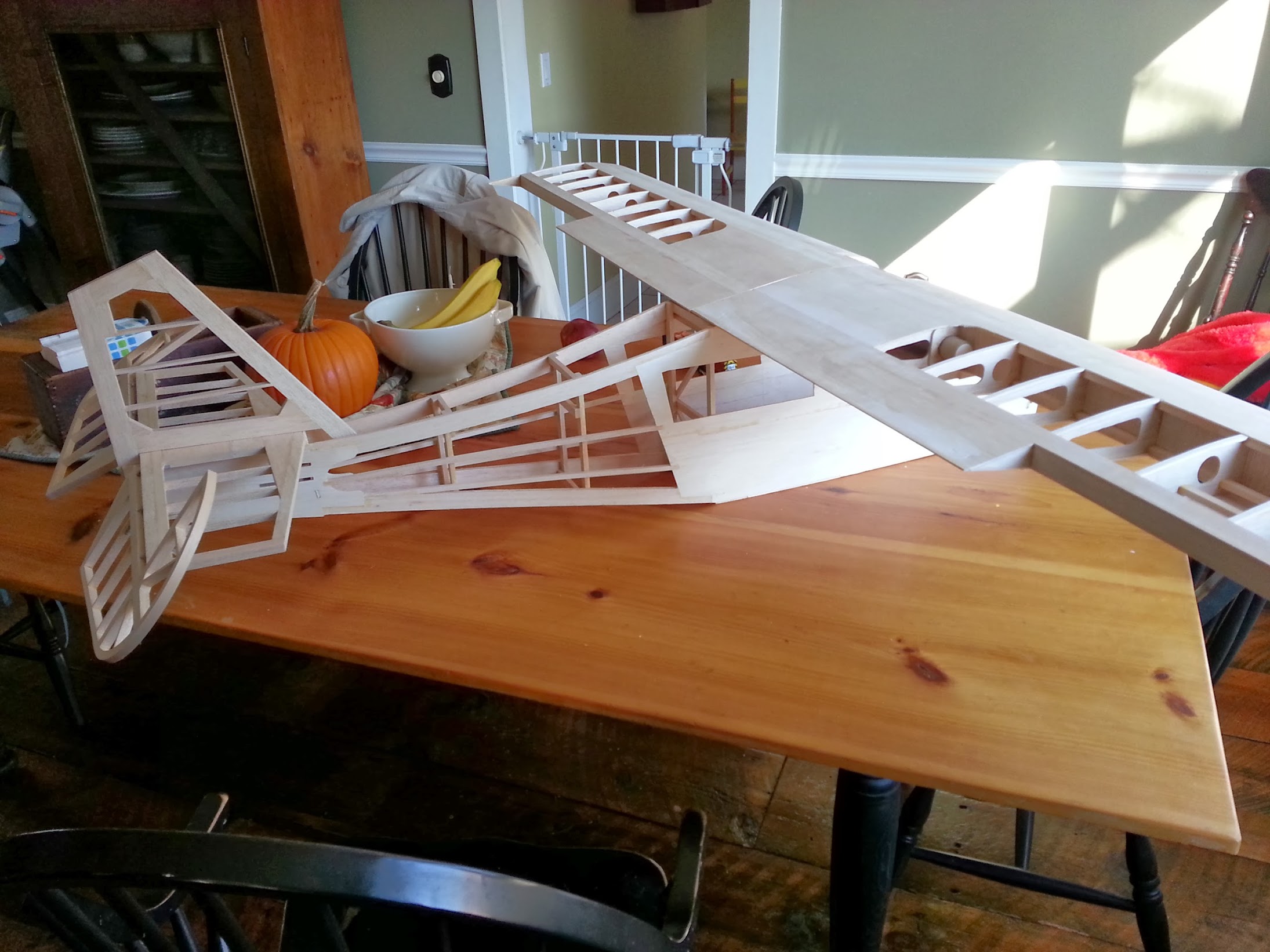

Unfortunately this plane has already seen the air.. and the ground... and a garbage bag. The battery somehow came out of a retainer clip and disconnected in mid flight.... not much more to say there...
For engines, the plane would knife edge loop with an OS GT33 in it, The video you point to is a much bigger decathlon ( RC pilot, not dynaflite ) than the kit you are getting ready to build, so don't put a 70cc engine in it!!

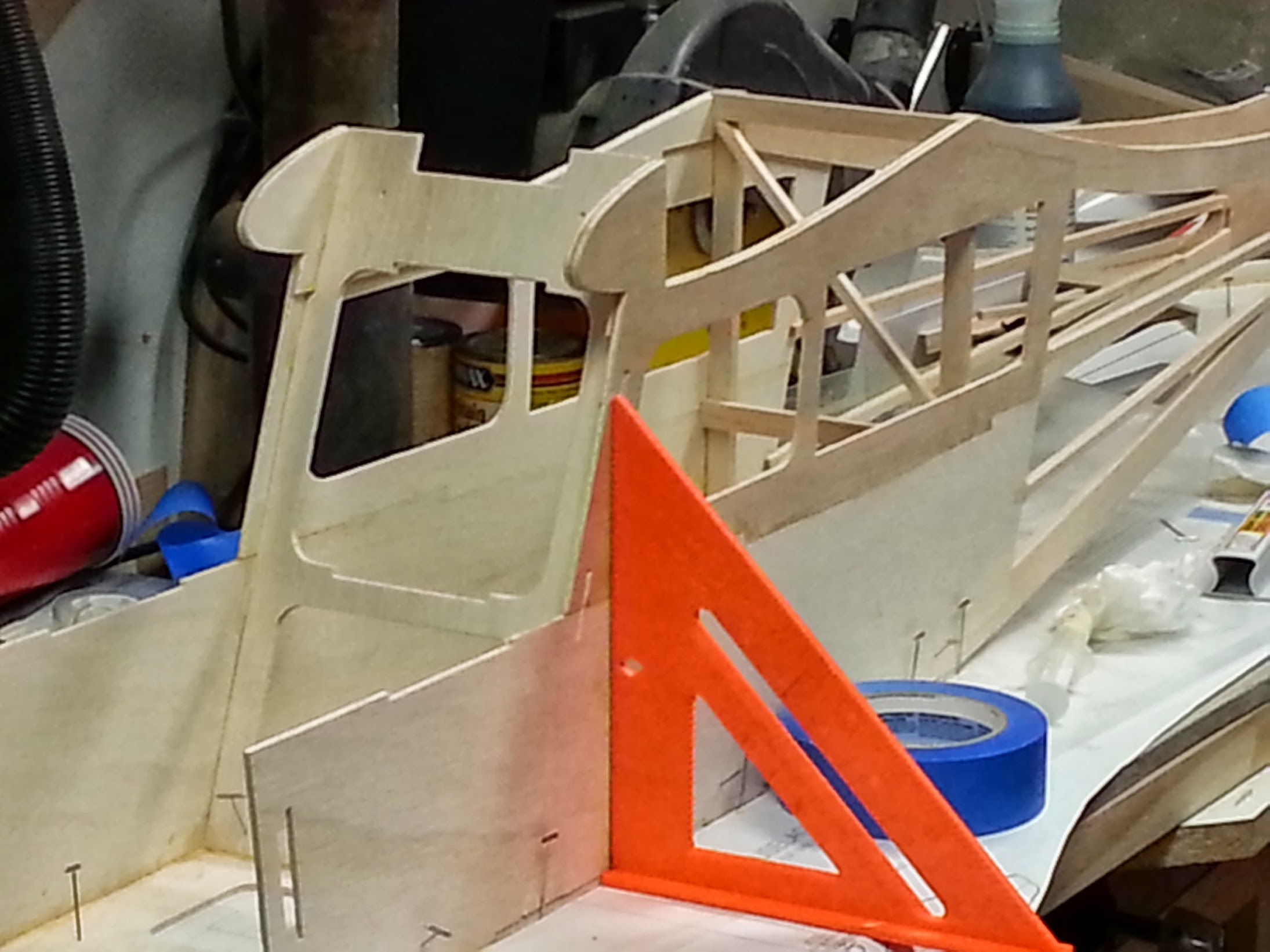

as for pictures, I have a few, please see below. first pic is the plane ready for covering,
http://www.rcuniverse.com/forum/atta...mentid=2065604http://www.rcuniverse.com/forum/atta...mentid=2065605http://www.rcuniverse.com/forum/atta...mentid=2065606

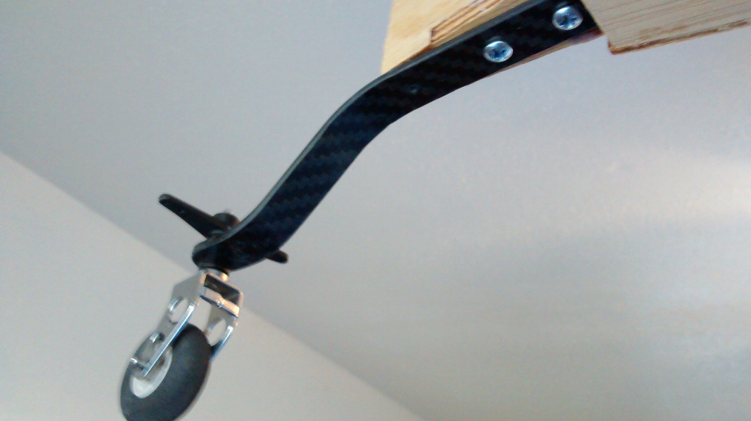

Here is tailwheel assmbly trainermaster. It came complete as you see it out of the package, including wheel & tiller. A fraction of the weight from the heavy metal one included with the kit. I got it from Hobbyking for less than $10. The Saito 1.80 up front weighs only 31 oz. That is the reason for the lightweight tailwheel & the mods I did to get batteries & throttle servo right behind the firewall. Also have the 2 elevator & 1 rudder servo up in the cabin, forward of the CG. It took longer to build than stock, but now I have a really light plane WITH NO LEAD (dead weight) perfectly balanced...
I have included a link for Tetherite composite landing gear.. I fly out of the pasture behind my house so I got the 160 size (a bit larger than stock). They fit the fuse perfectly. Also got some Du-Bro 5 inch air filled tires so it looks like a tundra plane, for my not so perfectly smooth runway. Read too many times that if you don't make a fluffy smooth landing EVERY time, the gear bends out of shape. I decided to spend a few bucks, then added a bit more ply to mounting area, and be done with it.
