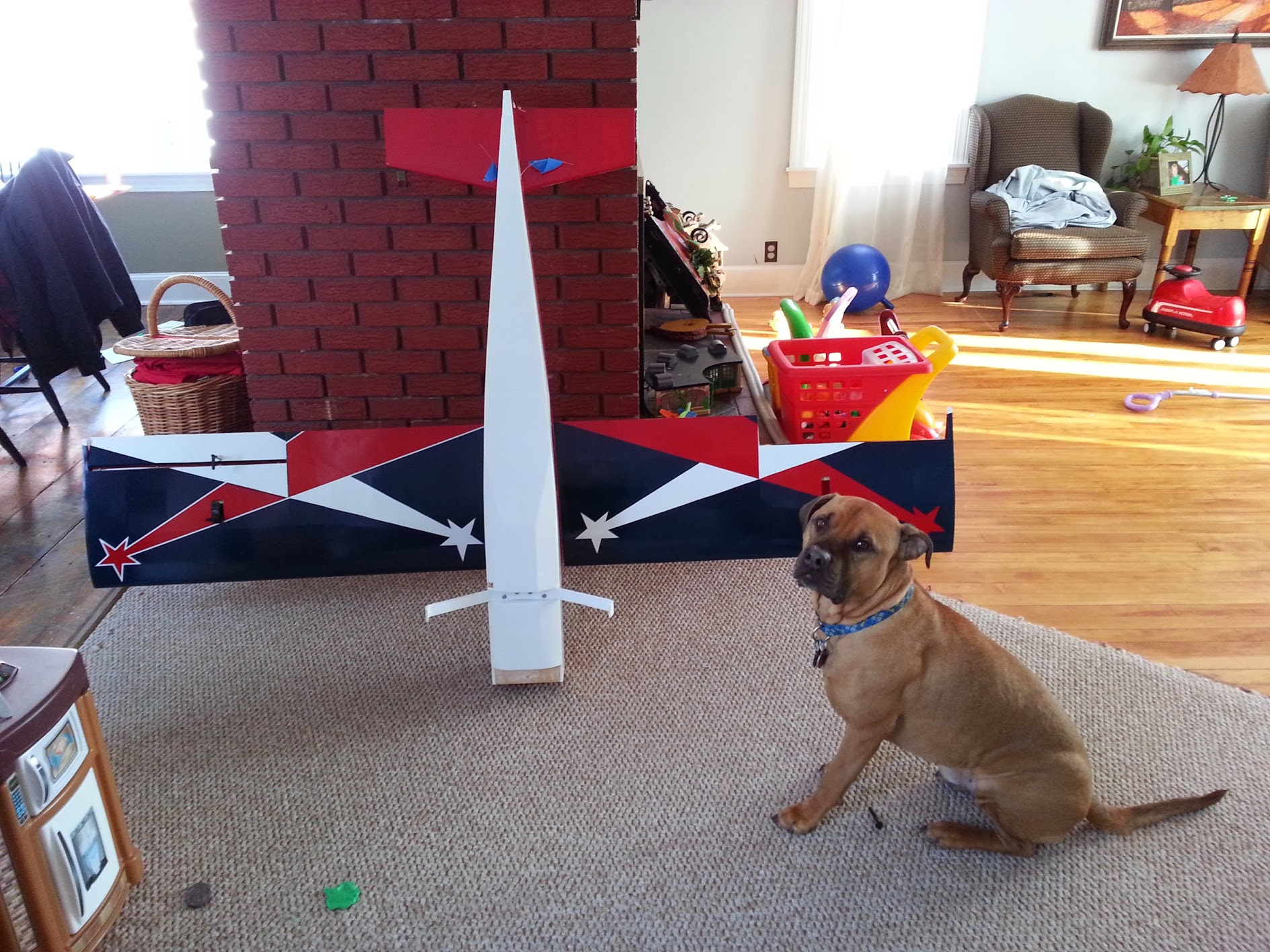

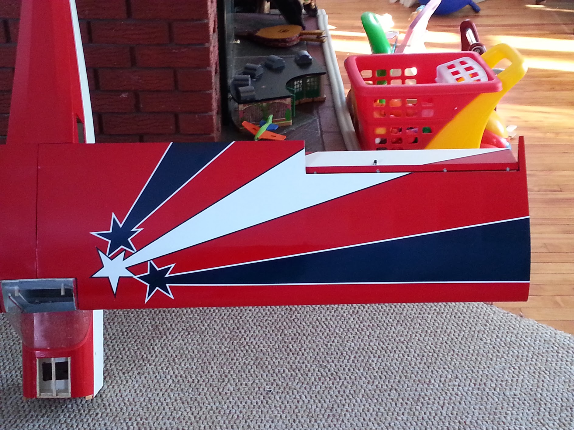

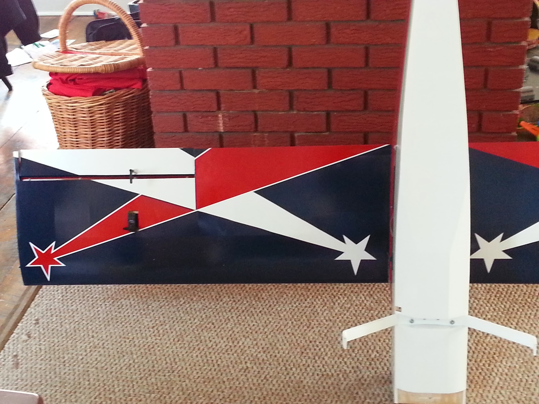

4 Attachment(s)
The bottom side still needs some red trim around the white burst
http://www.rcuniverse.com/forum/atta...mentid=1953923http://www.rcuniverse.com/forum/atta...mentid=1953924
http://www.rcuniverse.com/forum/atta...mentid=1953926http://www.rcuniverse.com/forum/atta...mentid=1953925
not done yet… but just a progress report. I would have liked to have gotten more done over Christmas, but it just didn't happen. Other priorities got in the way.

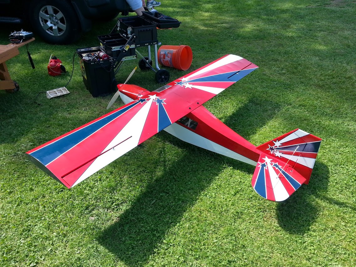

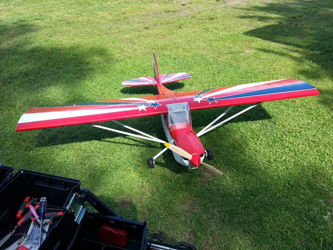

mattnew 06-02-2014 07:00 AM
3 Attachment(s)
http://www.rcuniverse.com/forum/atta...mentid=2000600http://www.rcuniverse.com/forum/atta...mentid=2000601http://www.rcuniverse.com/forum/atta...mentid=2000602
It flies! It floats .. some notes
1. I think I have a forward CG that I need to move back a bit. Our runway is 640' and I had some difficulties slowing the plane down to hit the runway. Greased the landings nicely.. but they were a bit quicker than I would have liked. Ended up looking very scale as I had to setup pretty far out and come in at a shallow angle in order to limit speed on touchdown... looked just like a real plane landing.
2. OS GT33 : great engine. probably overpowered for this plane though. The plane will knife edge loop using the break-in prop to give you an idea how strong it is
3. non-axial rolls, I need to experiment with some aileron differential to smooth those out. Currently we are at 1:1 on the ailerons, I wasn't really worried about this for the maiden flights
4. i need to plumb the rest of the smoke system.....
5. Its a tiny bit floaty, but not so much that it is a problem ...
I like it, its different. Its going to make me a better pilot... not because its hard to fly, but it doesn't give you things for free. rudder is required for flight, and you can tell when the pilot is "yanking and banking" and not flying the plane like a real aircraft. You won't do axial rolls without rudder/elevator input etc... spins come pretty easy but you have to work to get out of them...I've only tried your standard upright spin so far... I haven't tried a flat spin yet ...

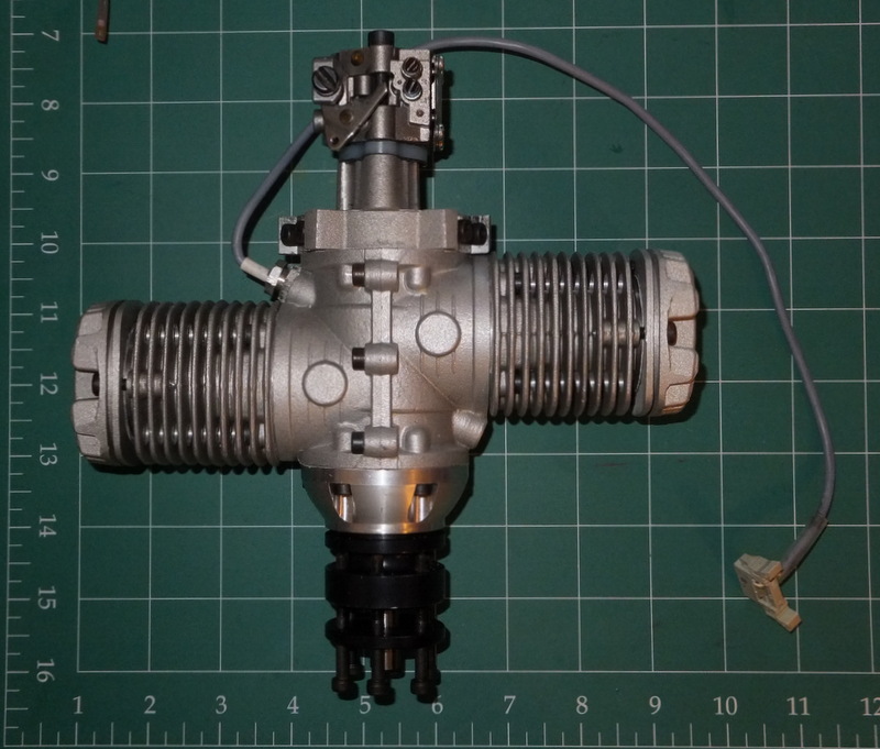

j301 06-26-2014 05:16 PM
1 Attachment(s)
Hello everyone, and great job on the build Matt! I am looking for a plane for an engine I have, an RCS 44 B2 (see pic), weighs about 4 lbs, maybe a touch less, with mufflers/ignition. I wanted a more classic acrobat over an edge/yak/extra for it but the problem I am having is that 1/4 scale (clipped cubs, etc) all seem to take "91 four strokes", then the 1/3 planes take "ZDZ 80's!" Quite the disparity there. I found this bird on Towers site and thought it might work. Any insight (either for this plane, or any other) would be greatly appreciated!
Jim
http://www.rcuniverse.com/forum/atta...mentid=2009070
Black Drape 06-26-2014 05:57 PM
Hey Jim
That would probably be more than enough power, but it looks like it would stick out of both sides of the cowl. I think you would have to do some serious mods to the cowl to even get it on.
Ron
j301 06-26-2014 06:46 PM
Thanks for the reply. I figured the engine would stick out a bit, but I'm running out of options. The pic is a little misleading, the motor is only 7-3/4" head to head, still wide, but not 10" like the photo looks. Of course then there are the cm6 plugs and boots, but there is nothing to be done about those. I figure its likely more power then it needs, I'm more concerned about the weight. I think I read something about these kits having longer then scale noses? If so, cutting the front short would really help. Then I would likely have to beef up the firewall and gusset everything you think? This would also be my first kit build since I was a freshmen in high school. Don't want to date myself, but I think The Breakfast Club was out about the same time! So Im looking for a kit that I could ease back into.
Black Drape 06-26-2014 07:31 PM
Hey Jim
It is a fairly easy kit to build if you have any experience at all. I would throw the plastic cowl away and get one from Fiber Glass Specialties. Mine has been on mine for about eight or nine years now. My windshield did not fit very well either and it is starting to look pretty ragged so I might try to order another one. It is a good flying plane you will like it. I don't think it would be hard to shorten the nose. If I remember right it is balsa sheet with a ply doubler. The rudder and elevator servos mount inside the rear of the fuse, and could be moved forward if the c g is an issue.
Ron
j301 06-26-2014 07:42 PM
Thanks Ron, how wide is the cowl? Think a bunch of motor will stick out? (not that I mind much, kind of a nice looking motor!) How about the weight and power of a 44 twin? Will the air frame take it?
Thanks again for the help.
Black Drape 06-26-2014 09:09 PM
OK
just measured mine and it is 6 1/8 inches.
Ron
beepee 06-27-2014 12:36 AM
Jim,
I like your engine choice too, and the weight should not be an issue considering how tail-heavy the airframe tends to be. I suspect you are going to run into prop diameter limit pretty quickly. I ran a Quadra 42 on mine that could handle a 20x8 (more often an 18x10). I found that the 20" prop would kiss the ground at unexpected times. Yeah, I know, my flying is suspect. Be careful nonetheless.
