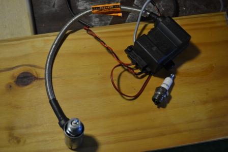

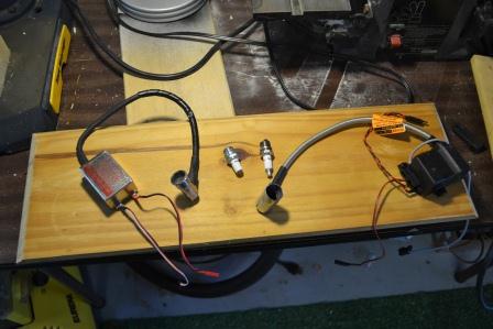

I'm having a major difficulty with the new ignition you sol me for the 45 IRS. According to your instructions "Vlach to ICU conversion Electronic ignition (for 2S LiPo). The ignition has the boot cap for14mm Brisk spark plugs with the Vlach type shielded boot. This ignition can be used to update old Vlach equipped engines to the new ICU ignitions." The problem I have is that the boot on the ignition I received doesn't does not fit either the Brisk plug or the Champion R6J6 original plug. The boot silicone sleeve is too large to hold these plugs.
I'm including photos to illustrate what's happening. On photo 1 you can see both the old RCexel ignition and the new MSR ignitions. Note the booth on the MSR ignition doesn't reassemble the booth shown on the Instruction Manual. This boot doesn't even have the ground wire shown on the manual photo.
On photos 2 and 3 you can see both plugs don't fit the MSR booth, and on photo 4 you can see the obvious difference in internal diameter between both booths. Am I missing something here? Please let me know what's wrong with this picture.

Old 07-19-2012 | 02:54 PM
Posts: 6,571
Received 5 Likes on 5 Posts
From: Arcen, , NETHERLANDS
Default RE: Which ICU for 45 IRS
There is nothing wrong with your pictures. You must use the old Vlach ignition lower boot, and use the conversion ignition and brisk plug with sawed off top. They will fit. Without the Vlach lower boot, nothing will fit.
If you saw off the top of the tapered seat 14mm thread plug, that will also fit if using the Vlach lower boot..

ORIGINAL: pe reivers
Now I'm really confused! What do you mean by the "Vlach ignition lower boot". I don't have a Vlach ignition to start with. As you may be able to tell from photo one what I was using originally was a Rxcel ignition. As I previously explained the Champion plug fits nicely and the Brisk also fits the Rxcel booth except that the sawed off top of the Brisk plug doesn't make contact with the spring inside the booth.
The bottom line is; What must I obtain to make this new ignition fit the Champion plug?
Old 07-20-2012 | 09:54 AM
Posts: 6,571
In your post #1, you said you replaced the Vlach ignition with RCexl? So you still should have the Vlach lower plug boot. The CM6 plug you mention is not standard older type 45 with magnets at 180°, These engines all had M14x1.25 plugs. To fit the CM6 plug, you either had to insert a thread reducer, or replace the cylinder with a new type.
If the cylinder has an M10 plug thread, you need to use CM6 plugs. The Vlach boot must be removed from the ignition and replaced with an RCexl boot for CM6 plugs.
If the cylinder has an M14x1.25 plug thread with tapered seat, all you need is the lower Vlach plug boot. BTW, this is the same lower boot as on ZDZ engines.
See post #3 where I explained this as well.
The ignition I sent to Mr Molina, Peru IN, (is that you?) is the only MSR-ICU ignition that works correctly with the magnets at 180°. It has the Vlach upper plug boot. No other options are sold with this specific ignition.
