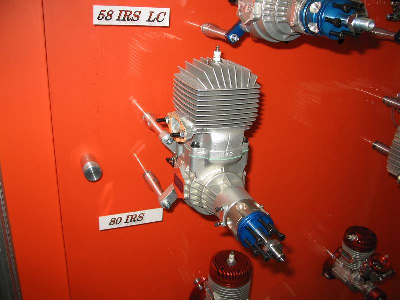

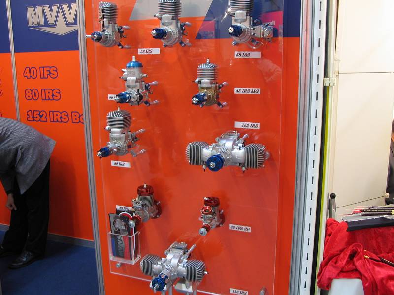

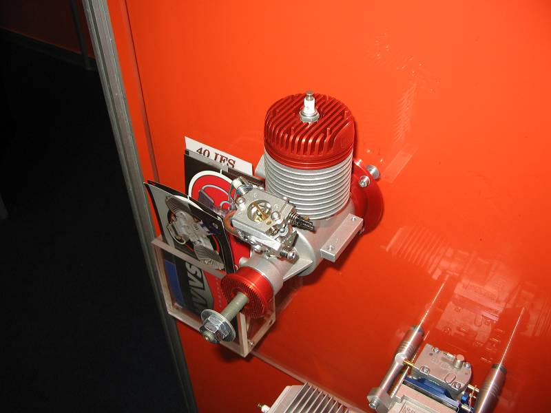

Hi,
I was on exibition. You can see here first picture.

ORIGINAL: janch
Hi,
Jan,
Yesterday, I have been in the MVVS corner looking out for you from 12.00 - 15.00!!!! Where were you? I have met the new UK importer, and others, but not you.
OK guys, here are the scoops:
New:
mvvs26, updated with larger crankpin. now also available with side spark plug (special head)
mvvs 40 Modified 35 with larger bore
MVVS 45, redesigned front bearing lubrication
MVVS 80 new engine, bore48mm stroke 44mm 2220 grams without ignition, props 26x10 to 27x10
MVVS 80 twin spark, new engine, bore48mm stroke 44mm 2220 grams without ignition, props 26x10 to 27x10
MVVS 152, new engine, bore 48mm stroke 42mm, 3530 grams without ignition, props 29x10 to 32x10
MVVS 152 twin spark, new engine, bore 48mm stroke 42mm, 3530 grams without ignition, props 29x10 to 32x10
New side muffler for the 45 cylinders and up, builds more compact and as close to the engine side as possible
And of course, there was gossip, which for the moment I keep to myself.
Most of the engines now have the possibility to add a shot of lubrication to the front bearing. Extra clearance has been added between crank and housing, so more oil can get up front. The 45 even has a special oil bore leading to the front bearing.

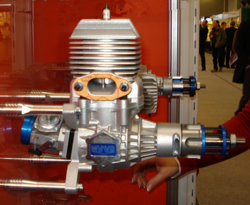

Here are the 80 and 152
Both can have single spark plug cylinders, or twin sparks.

Preliminary data teaser: (not off production cylinders!!!)
Mejzlik 29x12N 3 blades; without exhausts (open port) : 5500RPM ( warm engine )
Mejzlik 30x12 ; without exhausts (open port) : 5800RPM ( warm engine )
Mejzlik 30x12 ; with 58cc muffler INT58 : 6000RPM ( warm engine )
That is not a quick cold engine peak reading! and equates to:
HP:13.42
lbs:73.21 thrust
static-thrust 67.35 lbs (with plane)
That will yank around a 35lbs plane without limits.
MVVS is still working on a muffler for the 80cc cylinders for further improved performance.
Old 03-29-2008 | 05:50 PM
  #50
Posts: 6,571
Received 5 Likes on 5 Posts
From: Arcen, , NETHERLANDS
Default RE: MVVS 152
PS
a very good single cylinder engine will produce ~15 hp per liter per 1000 rpm. (my Kreidler 50cc MX engine produced 9 hp at 12000 rpm)
A twin on common crankcase will deliver ~13.5 hp
6000 rpm standard would be:
6*0.125*13.5=12.31
The MVVS is about one hp stronger than that, meaning it has a very good torque.
