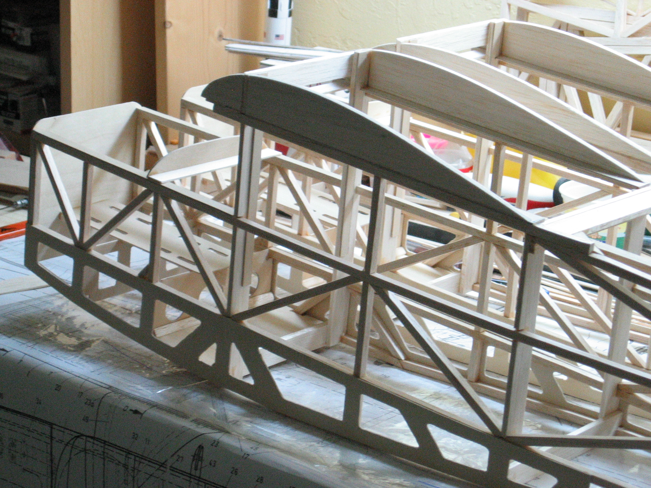

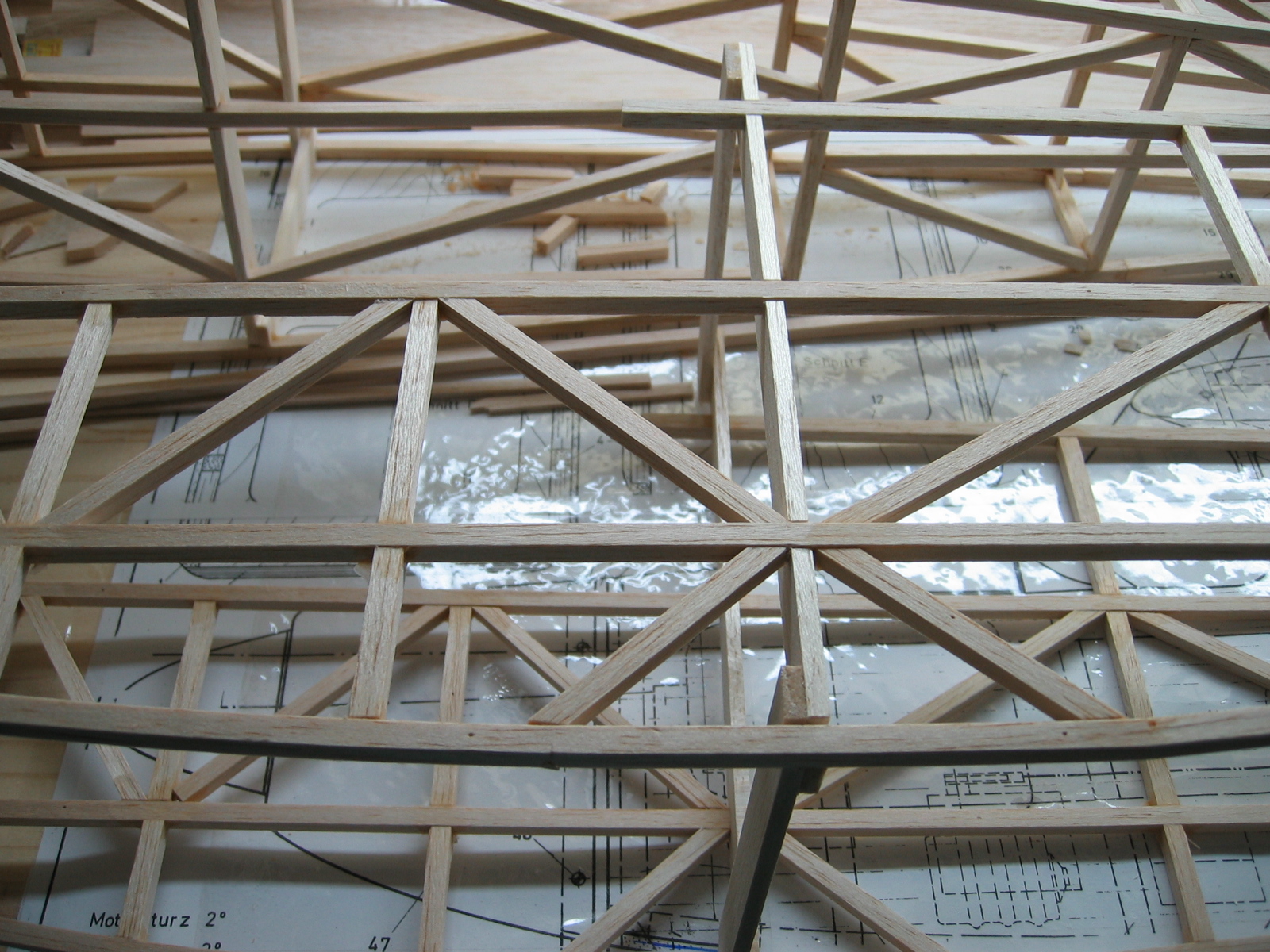

lots of cutting for the balsa sticks to build the fuselage sides.
all are 8mm. this structure builds later stiffness and lightweight at same time.

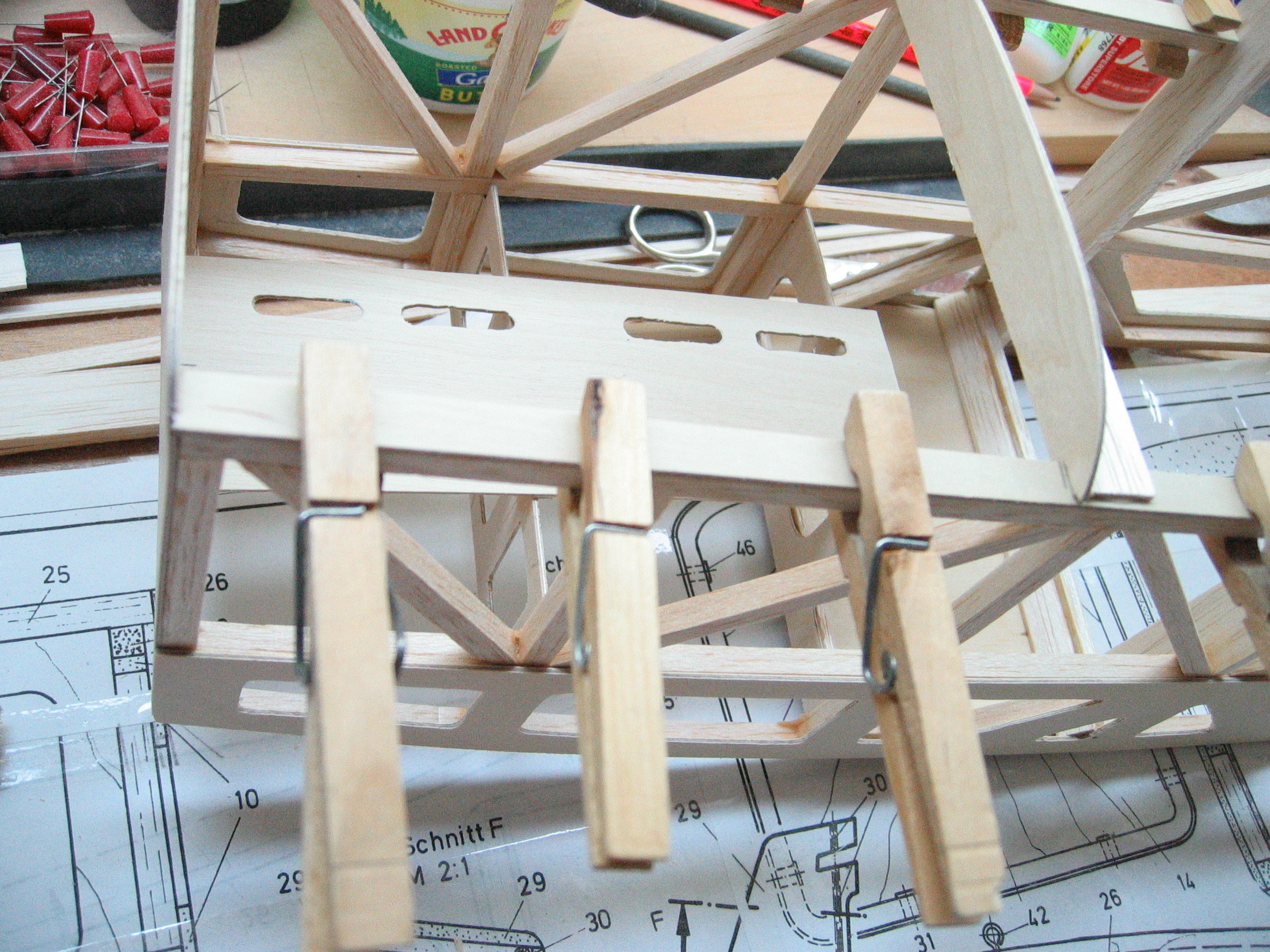

ok today we gonna stick all together. alignment is important.
you can see already the battery tray. there is enough space to put from 3s up to 10s if you need it.
all plywood is 1.5mm. critical positions are enforced with layers of playwood.
most is glued with wood glue. this glue gives still some kind of flexibility other than superglue.

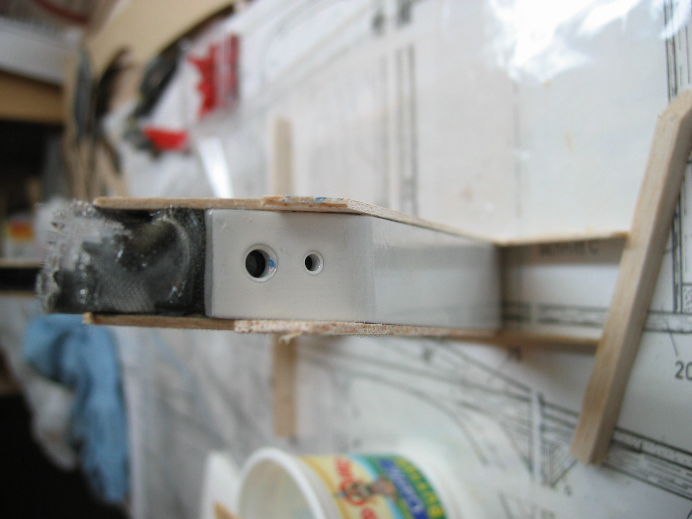

ok in the meantime i build the landing gear.
i took some carbon unidirectional tube und put at least 15 long and 15 horter CF rovings in it.
first i saturated the rovings and then put them all together into the CF tube.
i sounds a messy work but it isnt if u spread the CF tube before putting the rovings in it.
then saturate evrything on ur workbench and put it in your gear molding form.
before put some thin glassfiber to get a nice surface and it will hold the CF tube better in place.

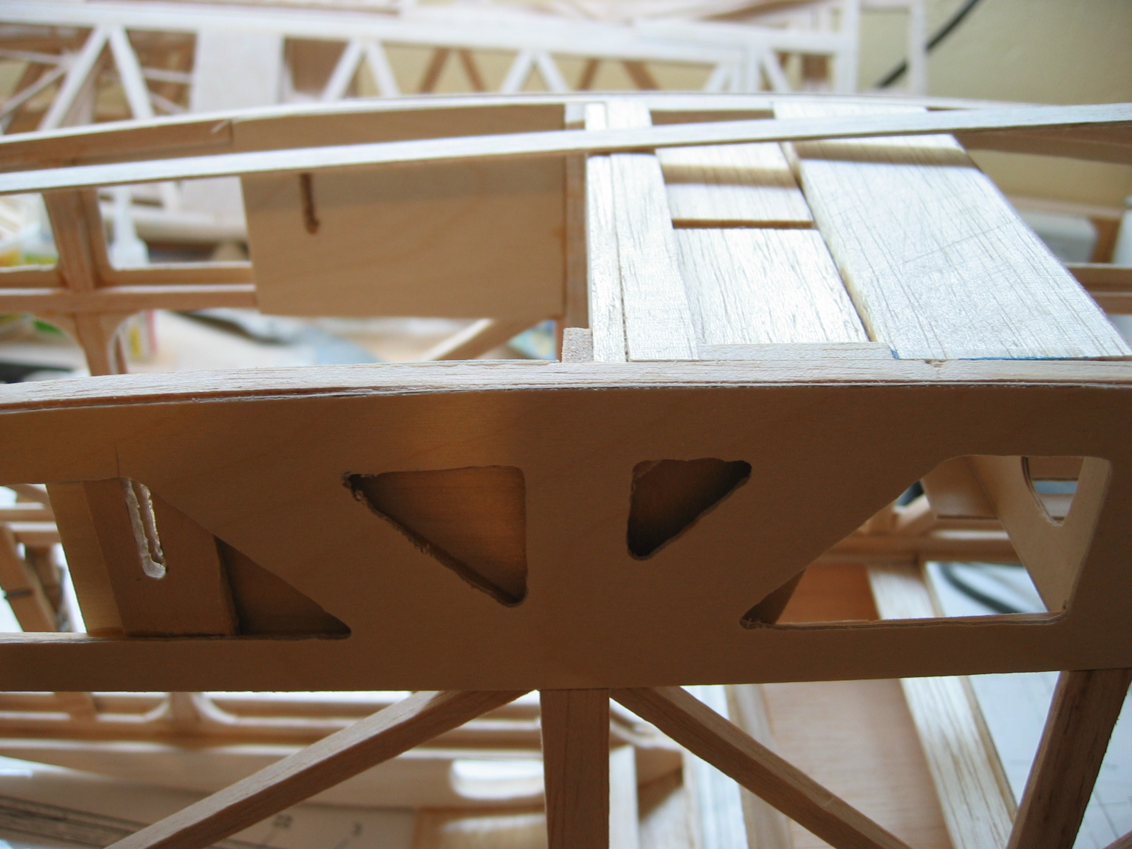

ok back from flying this weekend here only a few details how to build a strong solid fundation for the landing gear. very timeconsuming work to cut all those holes in the plywood side reinforcement. every gramm (ounce) counts for the optimum result.

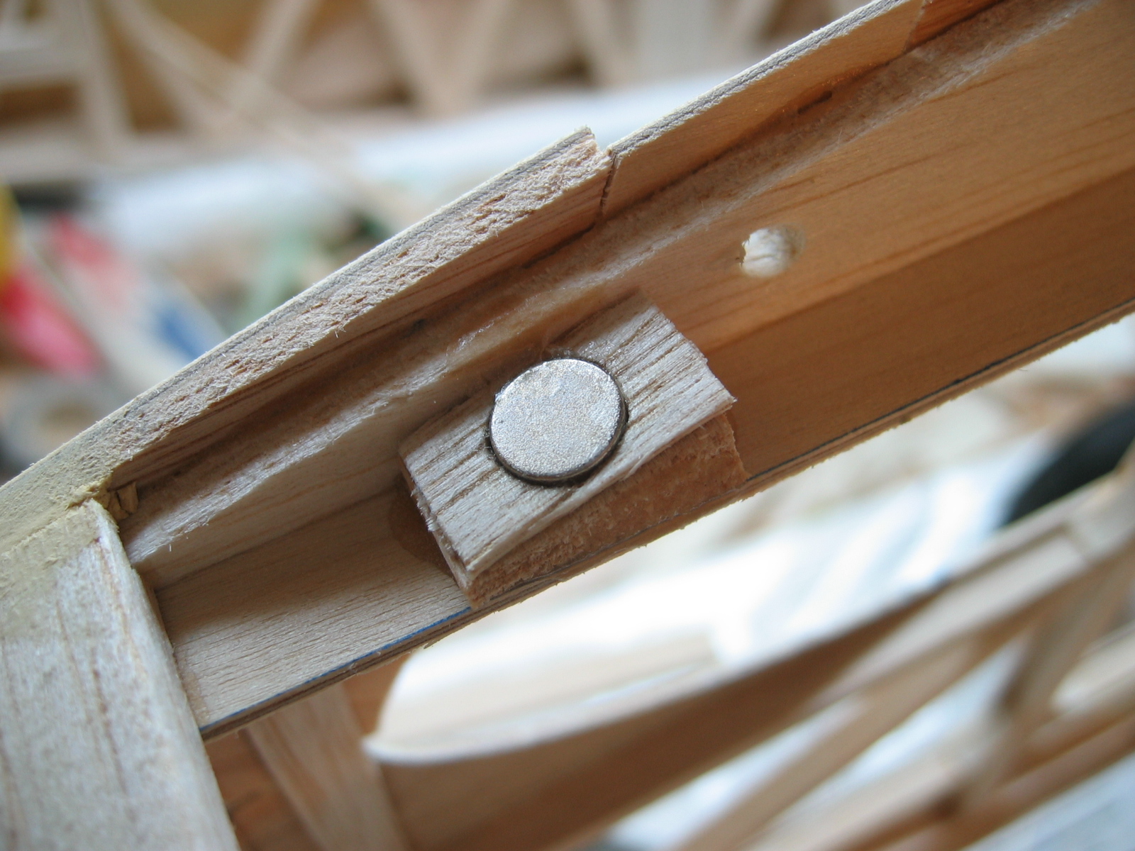

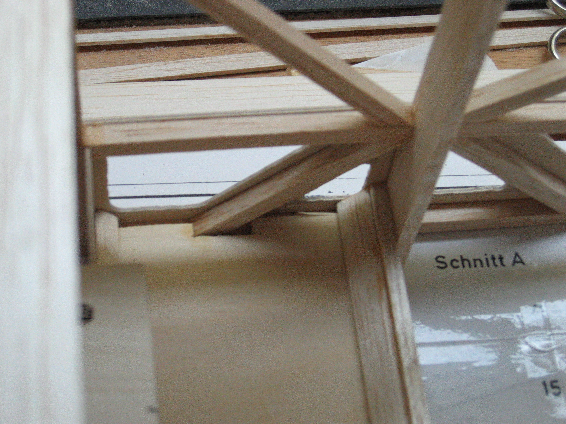

some more details from the fuselage

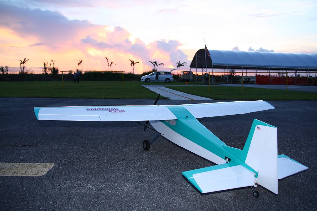

engine and controller arrived
using a Scorpion S-4025-16 332U/V and Kontronik Jazz 80AMP, calculated prop will be around 16x10 or if more thrust needed up to 18x8/10
this will give plenty of thrust from 3kg up to 5-6kg static

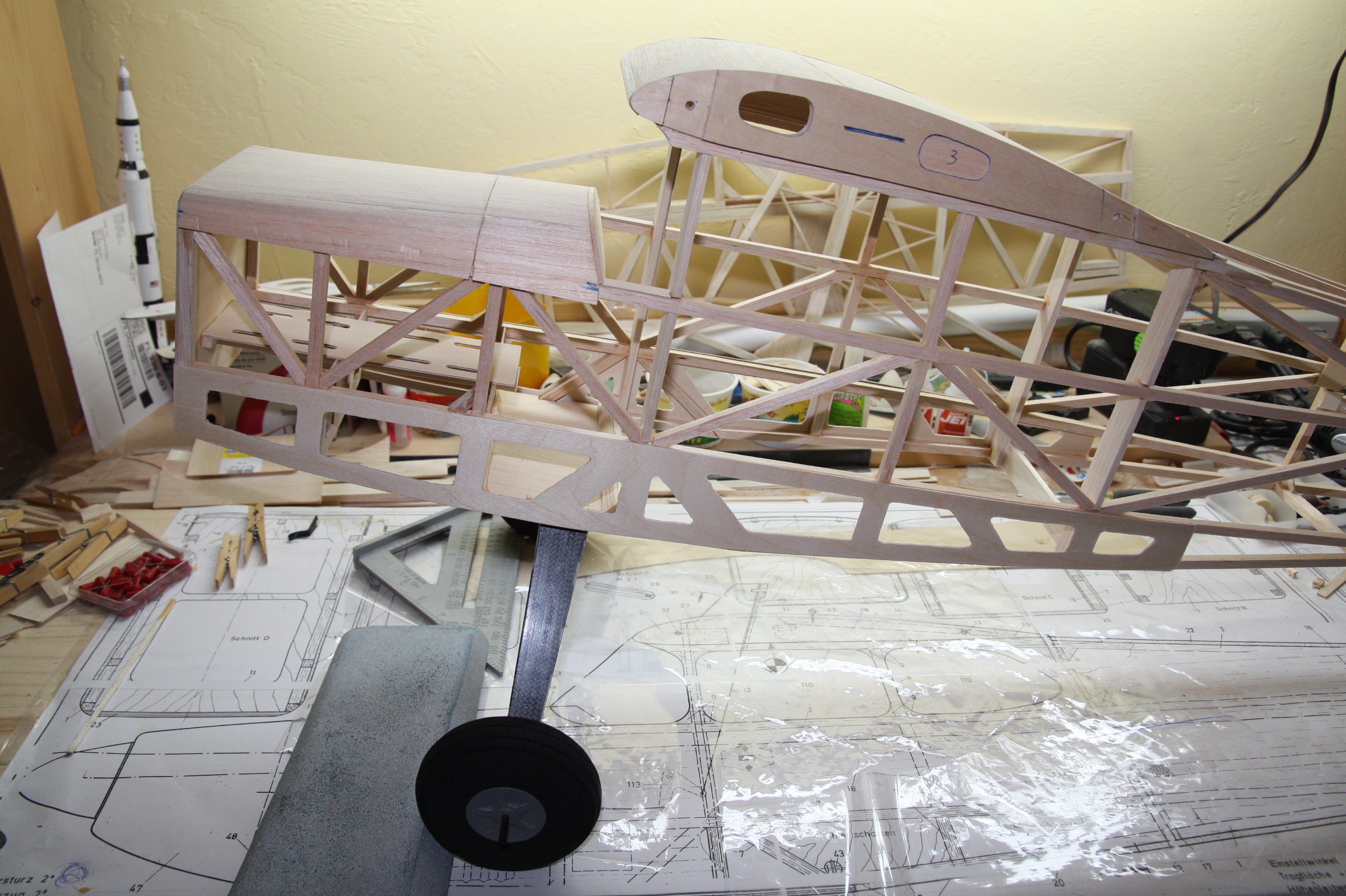

got the fuselage ready. isn't it loking nice?
i had some balsa over, thats why i made two of them... ;-)
