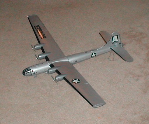

I have the regular NiMh battery from the kit. I just received my B-29 yesterday. This model have a realy nice look! Can't wait to fly it! Hoppfuly on Monday if the weather is ok. This is a 2 channel plane with thrust vectoring, but there is some room inside the fuselage that would easly allow 2 micro servo and a ECS... Here are some picture :

I just had my maiden flight with my b-29 this morning...
6am, the sun is rising and the sky is just a little bit hazy, I have the plane in my hand full engine running. I am a little nervous, don't want to break the model for the first flight. So I take a deep breath and hand launch it... after a slight downward motion to catch speed the b29 start to climb very smothly. I start a right turn and woaw it is so smooth! This airplane fly as good as it looks! I have some experience with other 2 ch model and usually they are a little nervous and unstable when they turn, but the b29 is not one of them! Every thing is smooth about this airplane, it very fidel to the real b-29! I fly around the filed, make some turns, the rising sun reflect on the plane as it turns, it was so beautiful... A silver bird that slide quietly in the morning sky. After a good 8 minutes, I decided to bring down the plane I didn't wanted to push it to the limit the first light . I align the plane with the wind and let him slide down. The control are very precise and smooth. I align the plane on a small dirt road and it make a nice rolling landing. As I pick up the plane I was still a little bit shaking and I thought to my self : " Cool, I just flew a B-29..." As Marcel Dasslaut said : "I nice looking plane will always fly well".. well that true with the B-29. It is realy worth every dollars it cost... I love this airplane!

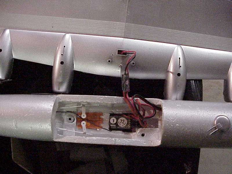

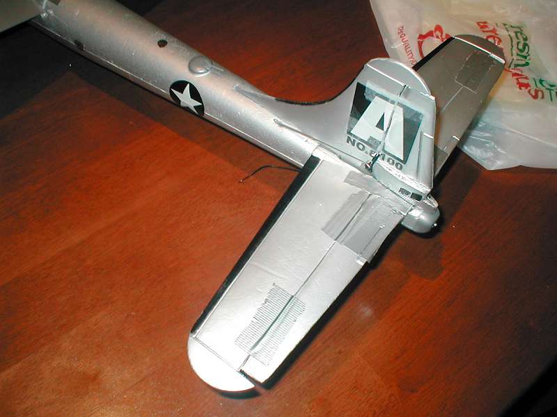

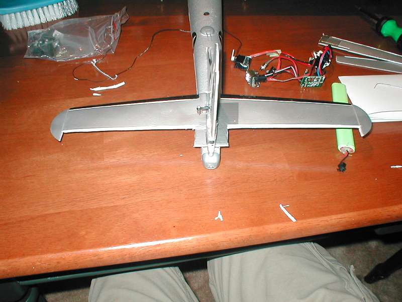

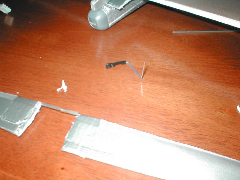

So I crashed my B29 and decided to repair it and convert it to 3 channels.
Here is what I did :
2 micro servos
1 ESC ( a standard cheap one)
1 MINI GWS Rx
The airplane fuselage as definitely enough room to fit every thing. I did not remove anything from the inside, I let all plastic part in place. I use the stock battery, so no change in the battery compartment. The only change in the fuselage is an opening in front of the wings to put the 2 servos ( see pictures). I did that so the center of gravity is the same as before I started the conversion. A small tip to set the center of gravity : without the stock battery the airplane should be able to rest on its 3 landing gears, if you just push very slightly the tail down, it should tip to its tail. Or for the people that like numbers on my B29 the center of gravity is about 10mm behind the motor cover under the wing. The airplane is of course a little bit heavier but it's still able to fly. I made a 3 min test flight and every thing went well. Its a little bit slow to turn with the rudder but if you give a little elevator to help it's not to bad. Also the elevators surfaces are pretty big for the model and far aft, so be very very gentle with the pitch command. When the 4 motors are full throttle remember to give a little right rudder. Here are some pictures :
