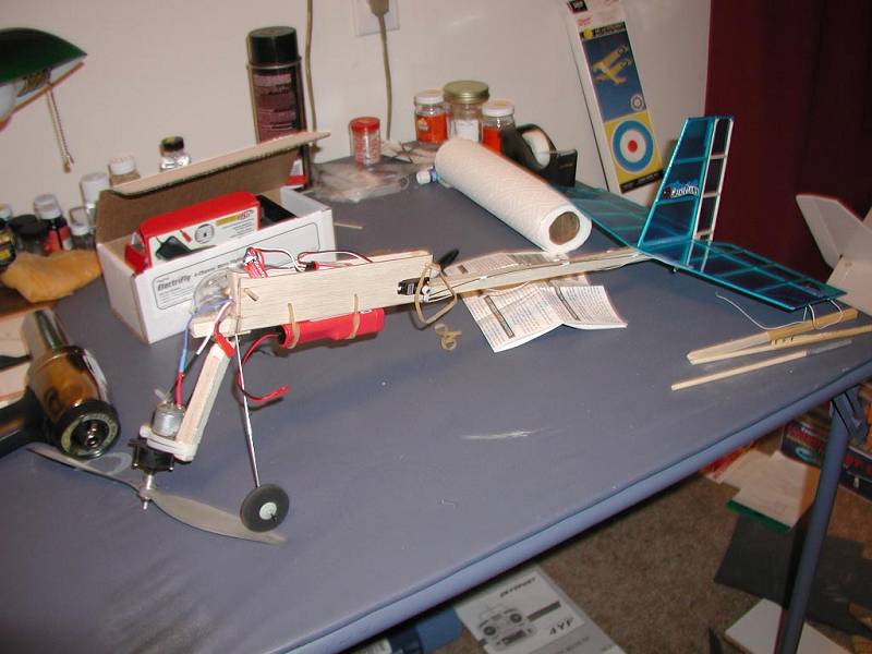

I can definitely post some pictures tonight. I think I will actually have this plane completed tonight as my covering materials just arrived in the mail today. I'm doing transparent blue with silver trim instead of white. I was going to use some black trim as well, but things were getting too expensive...
I'm going to be adding a Dubro micro steerable tailwheel instead of the tail skid the plan calls for. I will couple it to the rudder using a small pushrod. Other changes I made include vertical grain shear webs instead of horizontal, and a "reinforcing strip" that hides a nasty hole I put in the fuse when my the edge of my sandpaper caught [:@]. I also swept the landing gear forward a few degrees using basswood chocks glued to the fuse sides. The basswood also reinforces the landing gear area better than the balsa strip the instructions say to use.
The electronics are all installed. I've been cycling one of my battery packs by charging it fully and then discharging it by holding the plane in place and running the motor with propeller attached at 3/4 throttle. Doing it this way takes about 10 minutes with the motor running continuously. If I get 10 minutes of flight time I will be more than satisfied.
Tonight I will cover the wings and fins, attach the tail feathers to the fuse, connect the pushrods to the rudder and elevator, and find the balance point for the battery pack. Hopefully I will be flying it this weekend.

All sounds good, and looking forward to the pics. Be careful when you discharge a motor that way. Check to ensure none of the parts are getting hot (motor, esc & battery). It's not such a big deal with the BLT because everything is, hopefully, hanging in the wind, but will make a big difference when the parts are housed in a cowl and fuselage.

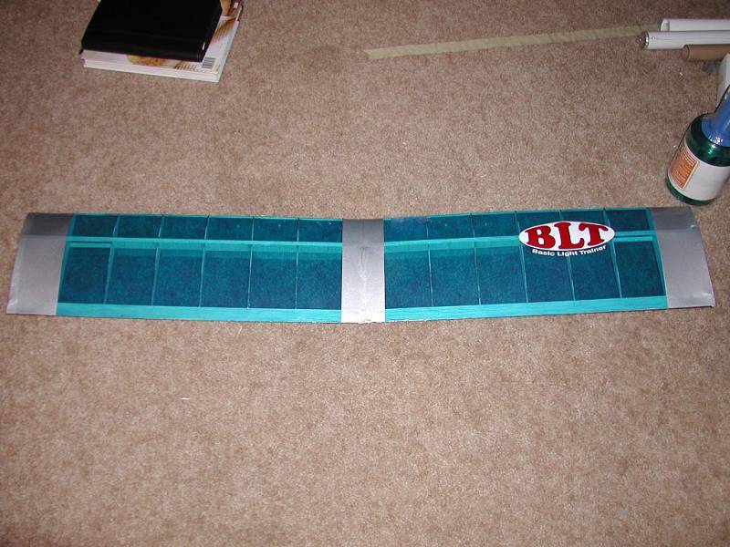

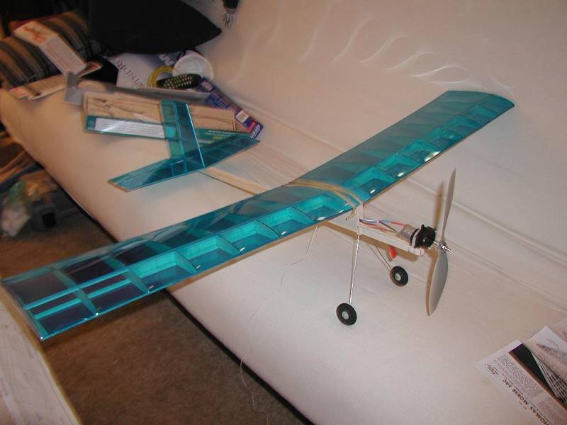

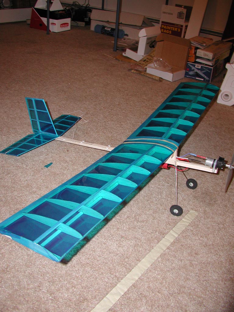

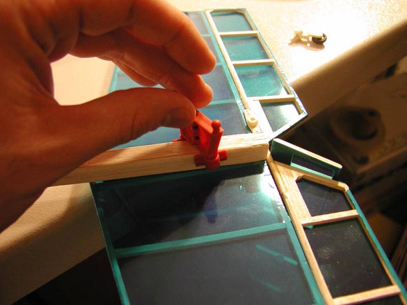

Sorry I never posted any pics of this plane... I put in the tailwheel, but decided not to couple it to the rudder, it just spins freely. I think it is much more durable and attractive than a balsa tailskid.
This weekend the plane flew OK, but I kept feeling like it was too heavy. I wish I made cutouts in all the wing ribs. I also over-sanded the fuselage and made it very weak. I used so much glue and balsa strips to make repairs and reinforcements to it that it is now hopelessly heavy, not to mention what it looks like.
I will build the hollow square stick fuselage again, but this time I will put strips of tri stock in the corners of it. Then I will sand the fuse into a cylindrical shape behind the wings to the tail feathers. The nose will remain square, but I will round the corners to make it more attractive. I think this will result in a very attractive, and structurally strong fuselage only a little heavier than the stock fuse. The nose will be especially strong, as it will stay square, and also have the tristock glued inside. Does this sound like a good idea?
I'm also wondering why it needs such a long nose. It there a reason aerodynamically speaking that the prop needs to be so far forward of the wing pylon? The heavy motor mounted on the long thin fuse is what makes it break so easily. If I shortened this part of the fuse, it would be a lot more durable, especially in a rough bounce landing when the motor weight acts like a lever to snap the fuse. It might not look as aesthetically pleasing though, which is the main thing I like about this model...
Attached are some pics. This was the plane before maiden.
James

![Default](https://www.rcuniverse.com/forum/images/icons/icon1.gif)
You've done a nice job finishing it. Thanks for the pics.
I don't think the cut outs in the ribs would have made all that much difference. As I remember, what I actually liked about my BLT over my Slow Stick was that it did fly heavier. It had a much more solid feel to it in the air. When the wind was more than calm and under 10, the BLT would be the plane I took out.
I do admire all the work you're putting in to making your stick look good.
The long nose has to do with balancing the plane. WWI and 'Old Timer' planes have short noses because their engines were heavier and needed to be in closer to the CG. You could shorten the nose and move the battery back to adjust CG. A bit shouldn't change flight characteristics much. You'd have to ask someone else about what would happen if you mounted it on the pylon. That would eliminate breaking that part of the plane though, wouldn't it!
Anything you do to strengthen the nose will help, but by design, it's weak which is why I finally went to a solid stick just for the nose. It is not a forgiving design in that regard, and because of that, this plane taught me to pay attention, to always keep the plane in control, and to respect the atitude of the plane. It was a good lesson and taugh me the best defense was to land gently.![Wink](https://www.rcuniverse.com/forum/images/smilies/wink.gif)
In one of the pics, it looks like there may be a a warp in your horizontal stab--is that just the angle of the camera?

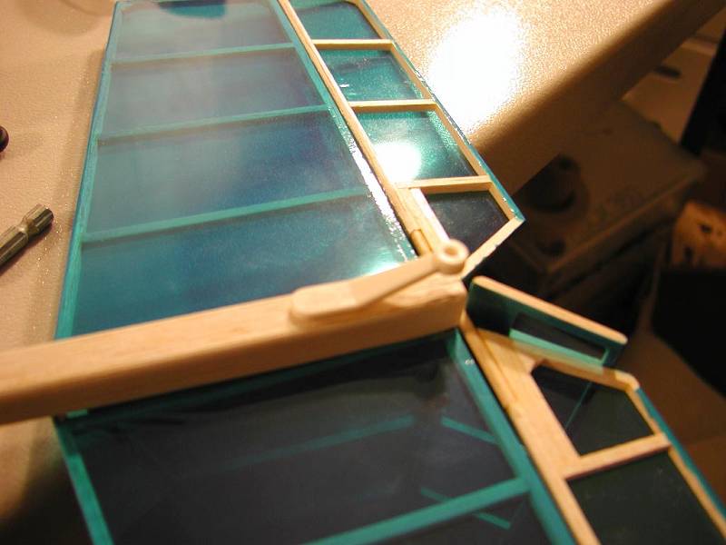

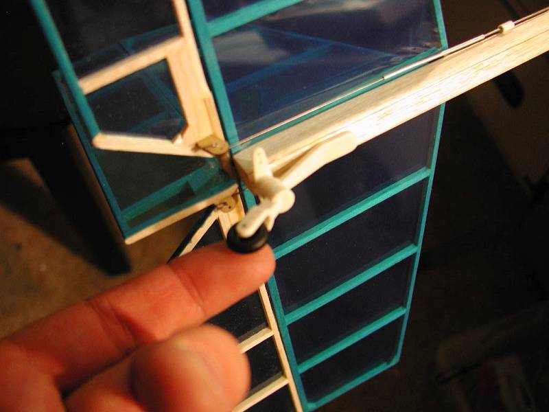

Thanks for the compliments. I am a novice builder, but I am very meticulous and a little OCD about how things look when I build.
That warping is from the pulling of the covering. I got the stab and fin nice and straight with gentle twisting and the heat gun before I flew it. It certainly looks a lot nicer in these pics than it does after I repaired the nose 3 times and the tail once today... The wing never suffered a dent, but the fuse sure took a beating. One time, simply taxiing around my driveway to get a feel for the plane I had a relatively gentle nose-over that broke the fuse in half... very frustrating.
Here are pics of it as it looks right now... You can see the silver trim and decal I put on the wing. The nose broke like this several times today. I finally added strips of balsa all over the place, which made it hold up better. The break here happened in the car ride home actually...
James
