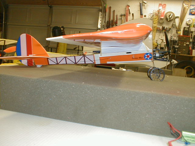

I have a lot of pics of the cm inflight but that doesn't show the details. Currently the cm is down for repairs but I will get a pic to you soon as I can.
Warning to all cm flyers. The standard wing for the cm does not have any glue on the top of the center spar. If you buy a new cm before you join the wing halves check the spar and run some glue down along the top or bottom of the center spar. I was doing some extreme 3d and managed to break my wing. After checking to see why I found the missing glue joint. While a replacement wing is only 12$ the bent output shaft if 5$ and if you are real unlucky and new power unit is 21$.
Anyway Jared I'll get some pics of the battery and wing seat and fuselage next post

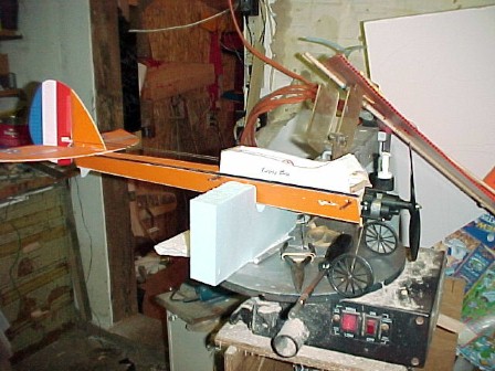

I finally got around to getting a good pic of the cm with the improvement I made

I particularly like the block of white concrete you have cemented to the underside of the fuselage. Ballast I presume?

protects the landing gear

Shouldn't there be a block nailed to the top as well, for those inverted landings?
